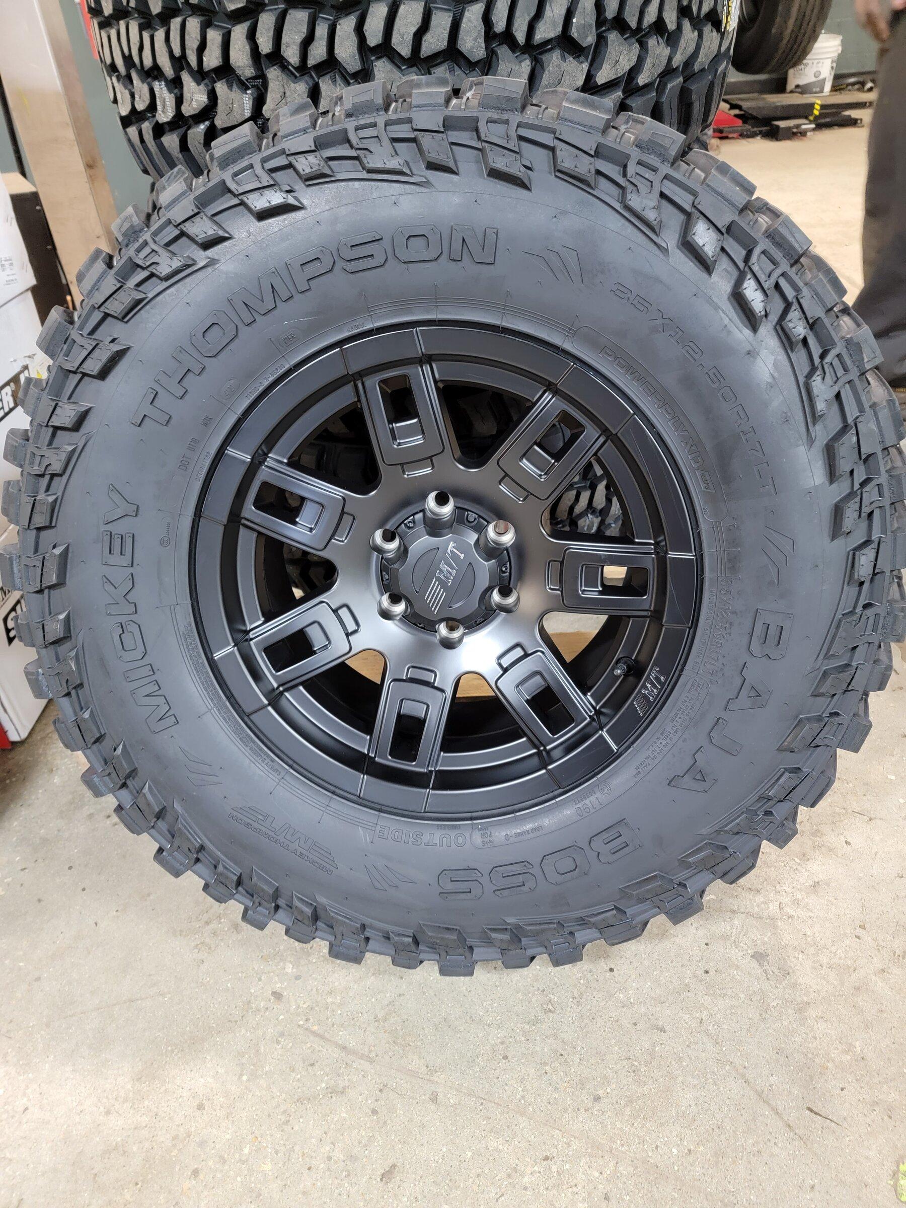

4WP is getting me the Pro Comp 6 lug set of black lugs to go with my new wheel/tire setup. They are the splined style so will have a spline socket in the glove box. I'll see how I like them, may switch out to the McGard's later.

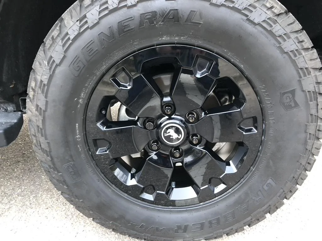

I added the McGards black lugs and locks.
