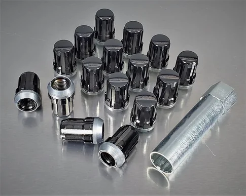

If you're wanting to swap lugs so quickly, I highly recommend the "Spline Drive" line of McGard lugs. The silver seat you see floats, meaning once you seat the lug, the base won't continue turning once you mate the wheel and lug. This will keep you from damaging the finish on your wheels (assuming you bought aftermarket wheels since the lug color is an issue for you)
You can't see the seat once the lug is installed, so the color there doesn't matter. I've used their Spline Drive lugs on my racing wheels with their expensive an thin finishes and these are a superior design and superior materials to even their normal lugs.
Yes, they are more expensive. But you're only buying them once if you buy the right items!

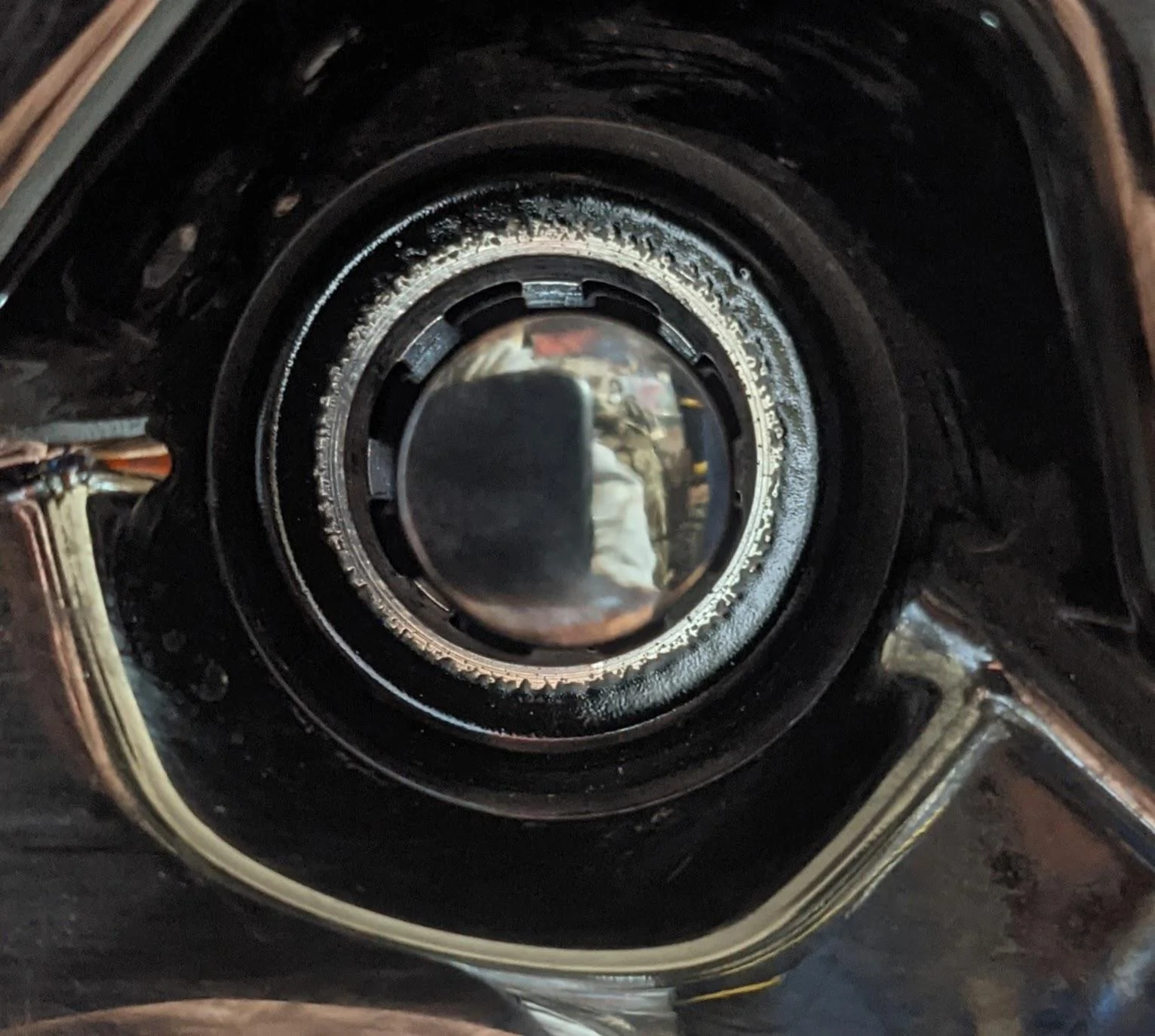

Ford Bronco Black Lugs & Wheel Locks PXL_20210720_164534981
I got a set to validate if they would work better, they look worse than stock due to not covering the bare mating surface below a standard lug.

I am not questioning your findings but I am having a difficult time understanding what I am looking at in your pic.

So the issue with small diameter lugs is that they don't have a large bulge. On stock wheels the lug wells are painted for bulge style lugs. What you are seeing is the McGard spline style lugs installed on the stock wheels (Wildtrak/First Edition) which has an unsightly silver ring around the lug. Definitely recommend sticking with the lugs I mentioned in the original post.

Thanks, Funny how the pic was like an optical illusion to me.

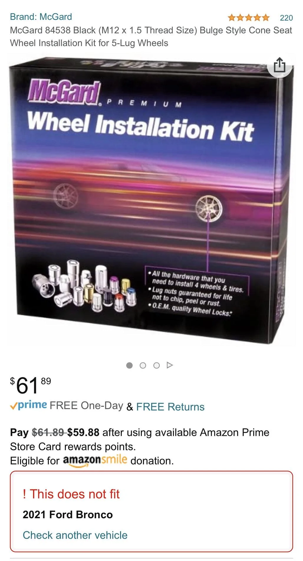

Ford Bronco Black Lugs & Wheel Locks 1A817AB5-94BB-468A-9B03-3AB53A3E8FD4
should I be concerned Amazon says it doesn’t fit?

I'm not. This is the same size referenced by others but I do not have my Bronco yet. Hopefully next week I can definitively say they do.
@GrabberBlue may be able to 100% verify

Following for yay or nay. Also thanks for the link
