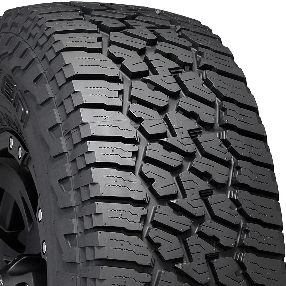

Anyone have some decent Tire recommendations? I want to move up to at least a 33. The 32s just look a little small for the 4 door Black Diamond.
I am running Falken wildpeaks on my tacoma right now. They seem pretty solid, unless yall have something else to add to the wishlist.
Most folks who are switching to 33's tend to think of the BL 33's 285/70 x 17. While this may be ideal for some they may cause clearance issues on trims without upgraded suspension and wheels due to width induced issues. I'm looking at 255/80 x 17, which will fit 7.5" wheels nicely and have fewer clearance issues. They are actually a little taller than the 285's (33.06 vs 32.71) and are available from Falken, Cooper and others.

I have been really impressed with my Grabber AT's on my Ranger offroad, onroad and in snow. It really made my day when I saw the BD came with them from the factory.
My F-150 dd has Wildpeak AT's, they are pretty good too.
I was told the tread makes them worse in the snow ? What have your heard ?
What tread?
Both the WIldpeak and Grabber has the snowpeak rating similar to a KO2. I live on a rural gravel road with a highway commute to get to town. This was my first year with the Falkens and they were awesome.
I don't drive my Ranger in salt but messing around the farm they almost seemed to get around better than the Falkens (on vastly different trucks)
