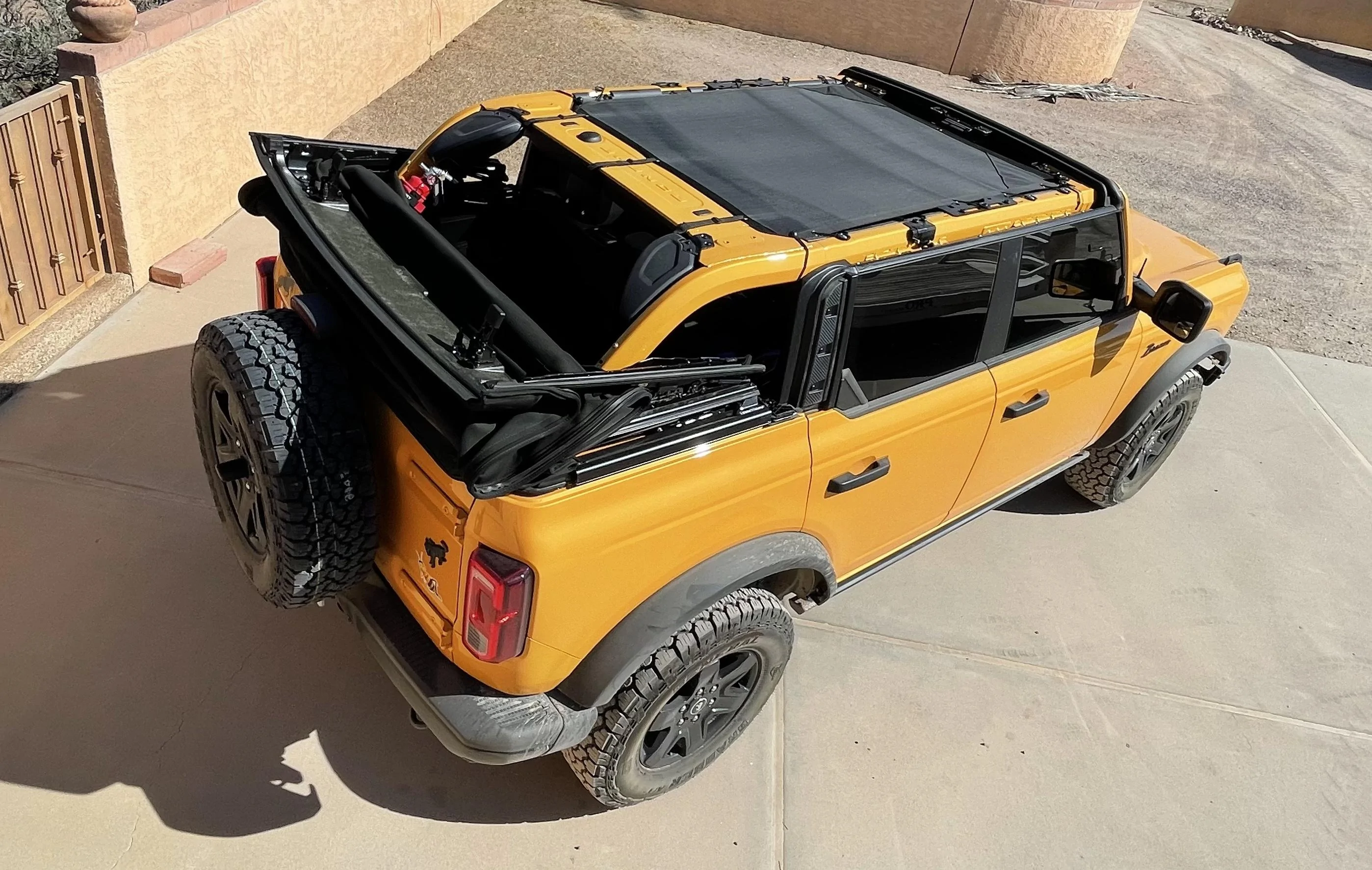

I have a JTop in my JLU and really like it. Besides the quality and coverage, one aspect that I highly prefer is how the design maintains a position at the top level of the rollcage. Many of the bungee-tight designs are they sit about mid-level of the rollcage thickness. Put another way, I have an additional 1-2in of headroom with the JTops in my Jeep compared to the Alien or Spiderweb versions that use bungees.
I'm not entirely sure if that's a similar story with the Bronco versions, but given there's no b-pillar crossbar in the bronco I highly suspect that sag will be an issue to be aware of.

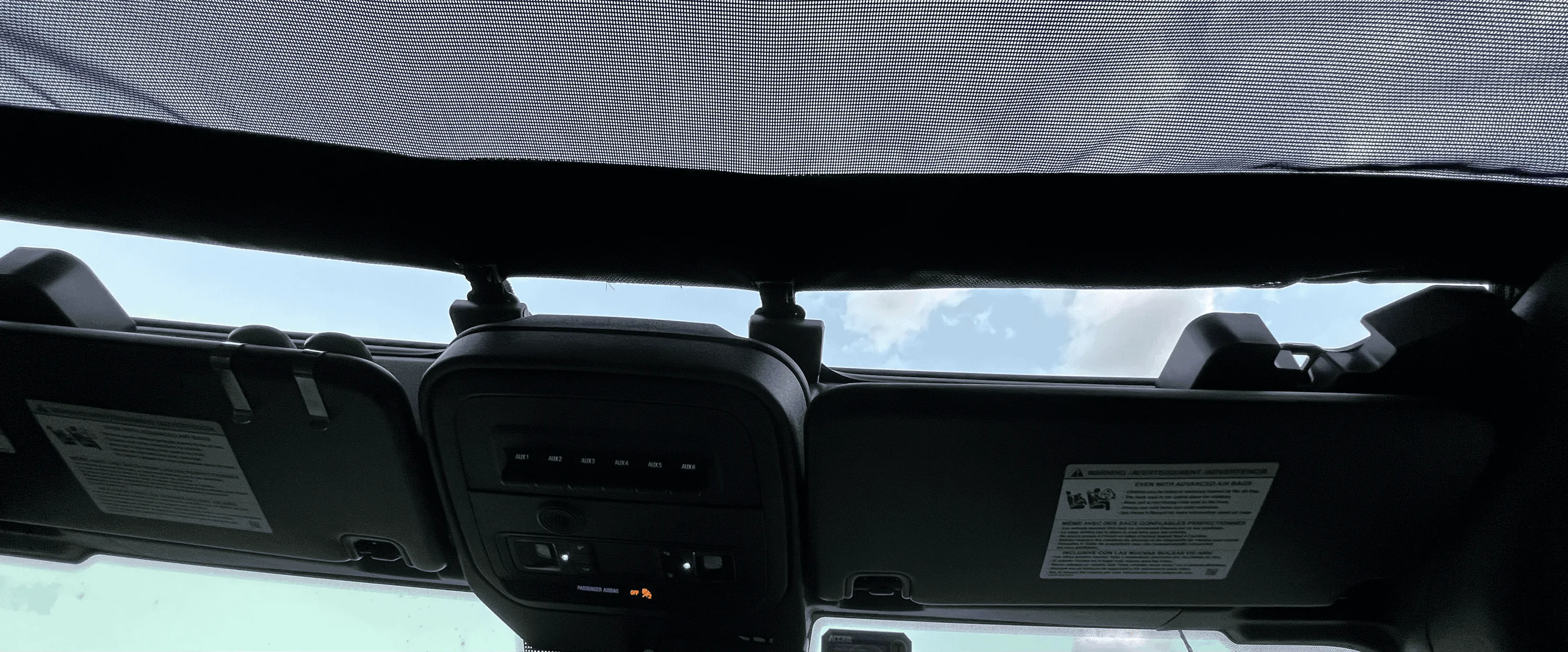

Gear Shade is flush with the top of the cage. Plenty of headroom for me at 6’ tall…

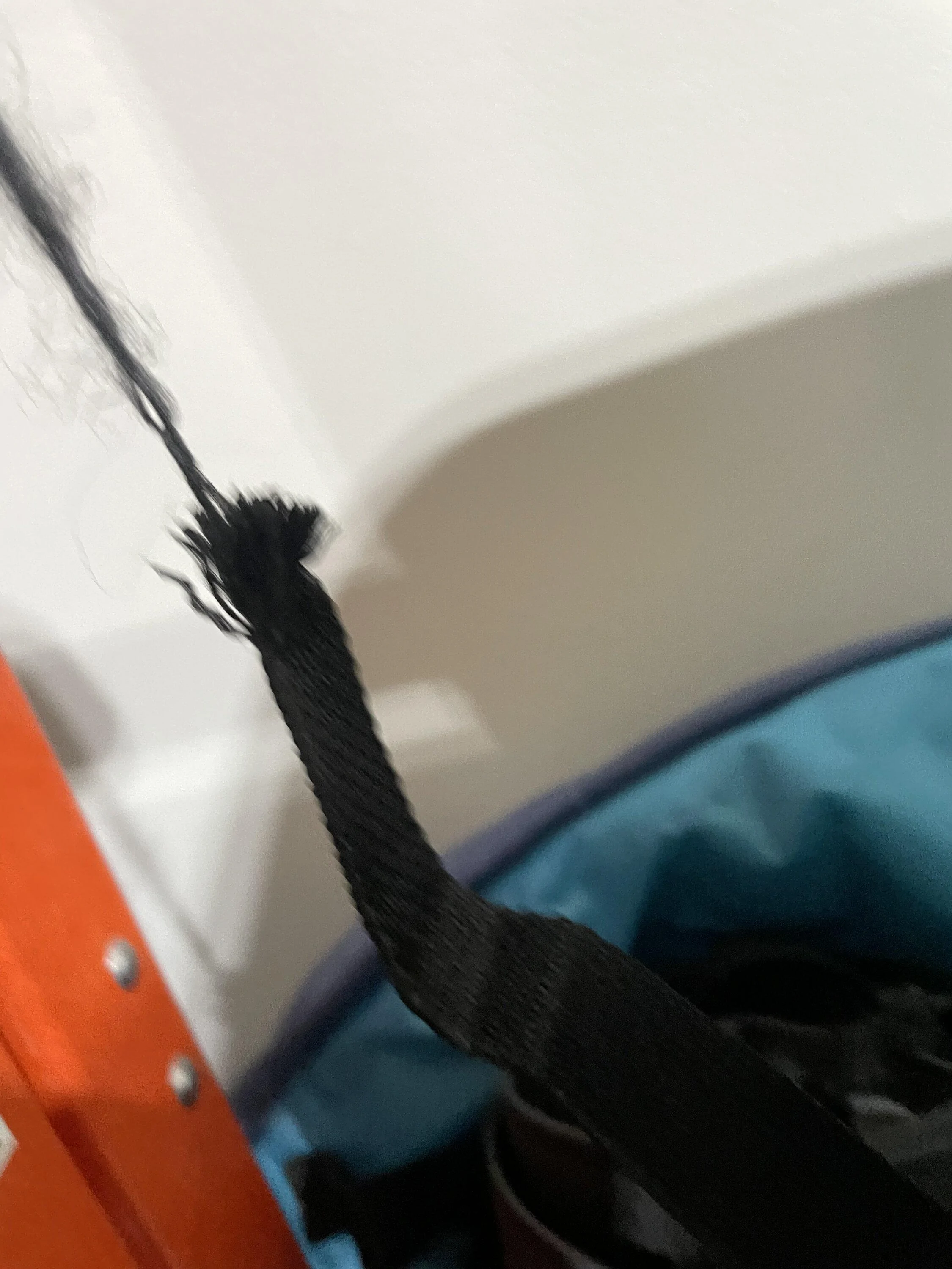

I have the Bestop Bimini shade that I got from Ford Accessories. It fits excellent but after a few days, one of the rear attachment hooks came apart. It uses straps similar to a backpack and the plastic hooks are sewn on. The stitching came off and the strap loosened up and now its loose.
Going to see if the piece can be super glued back together.
I had the same thing happen to mine. Because it was added to the car at time of delivery and was on the Bronco’s buyer’s order it was actually covered under warranty for me.

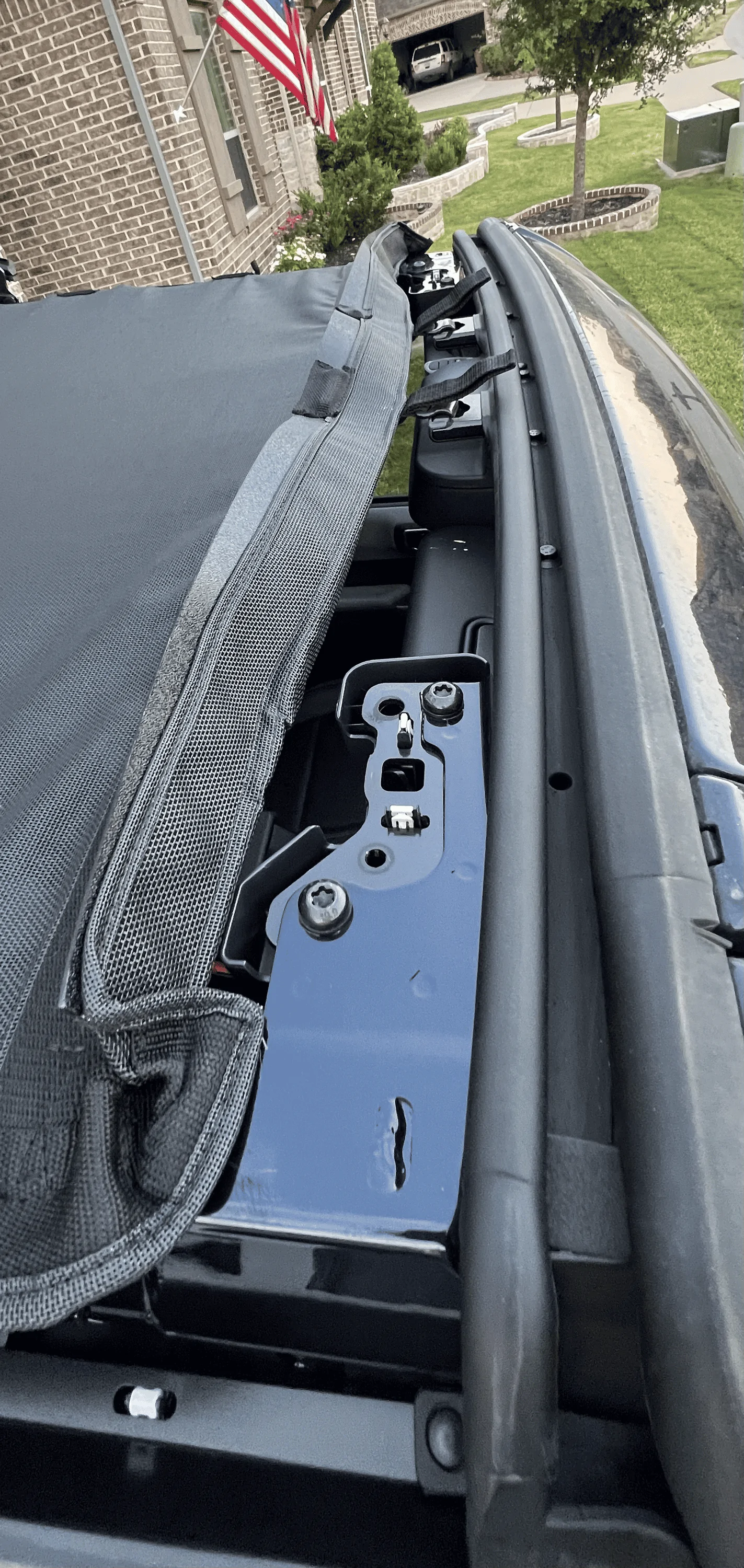

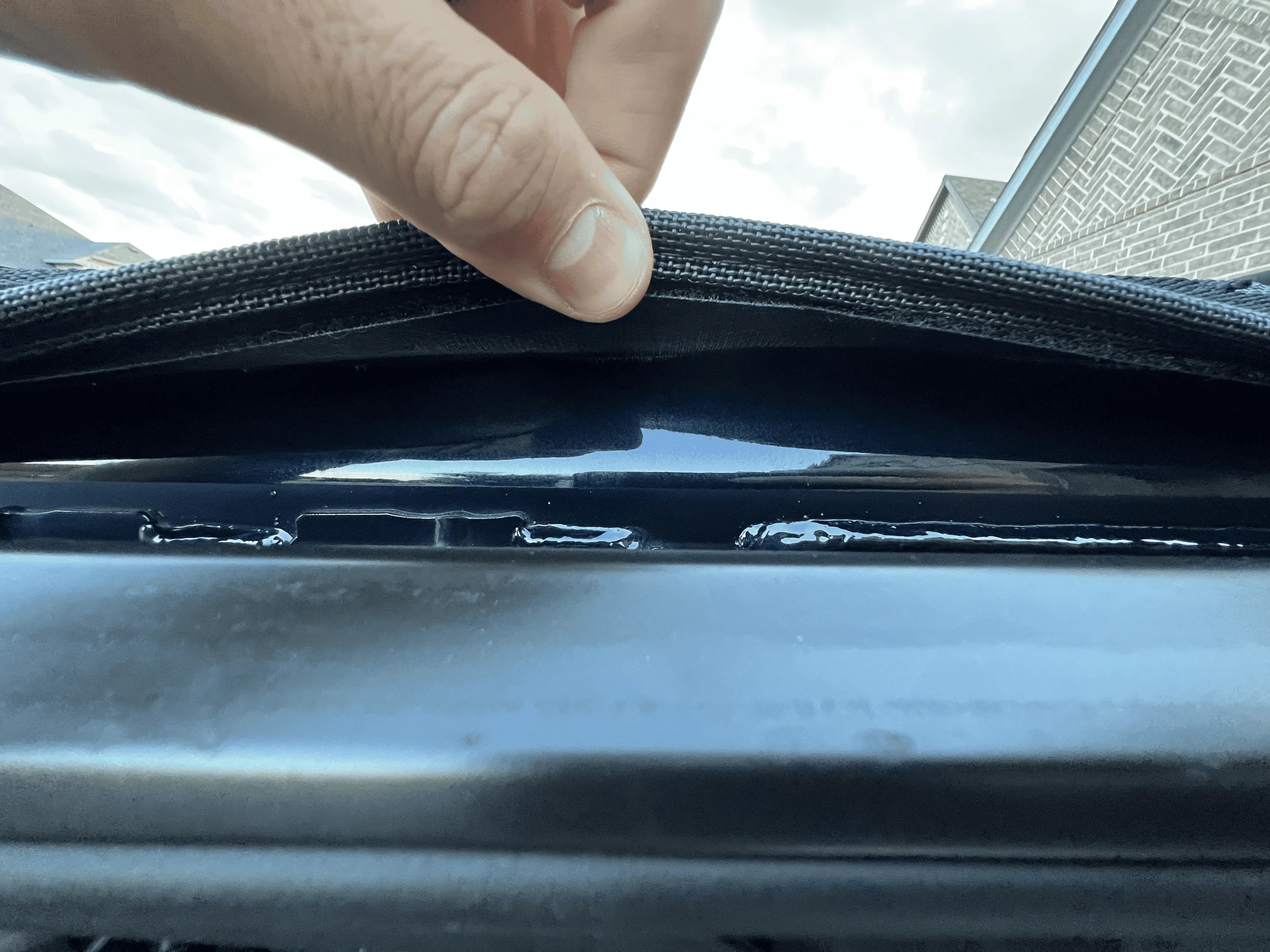

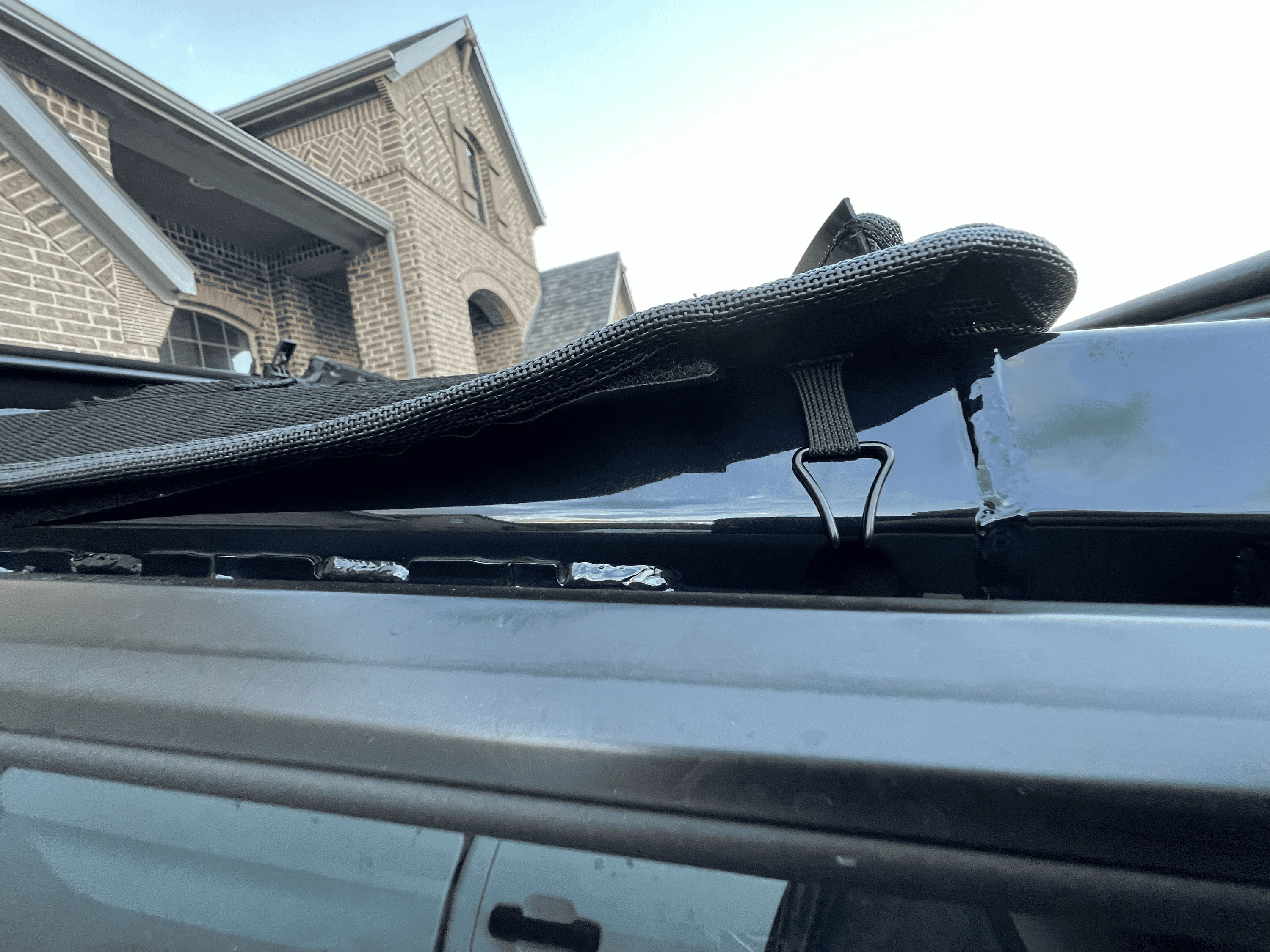

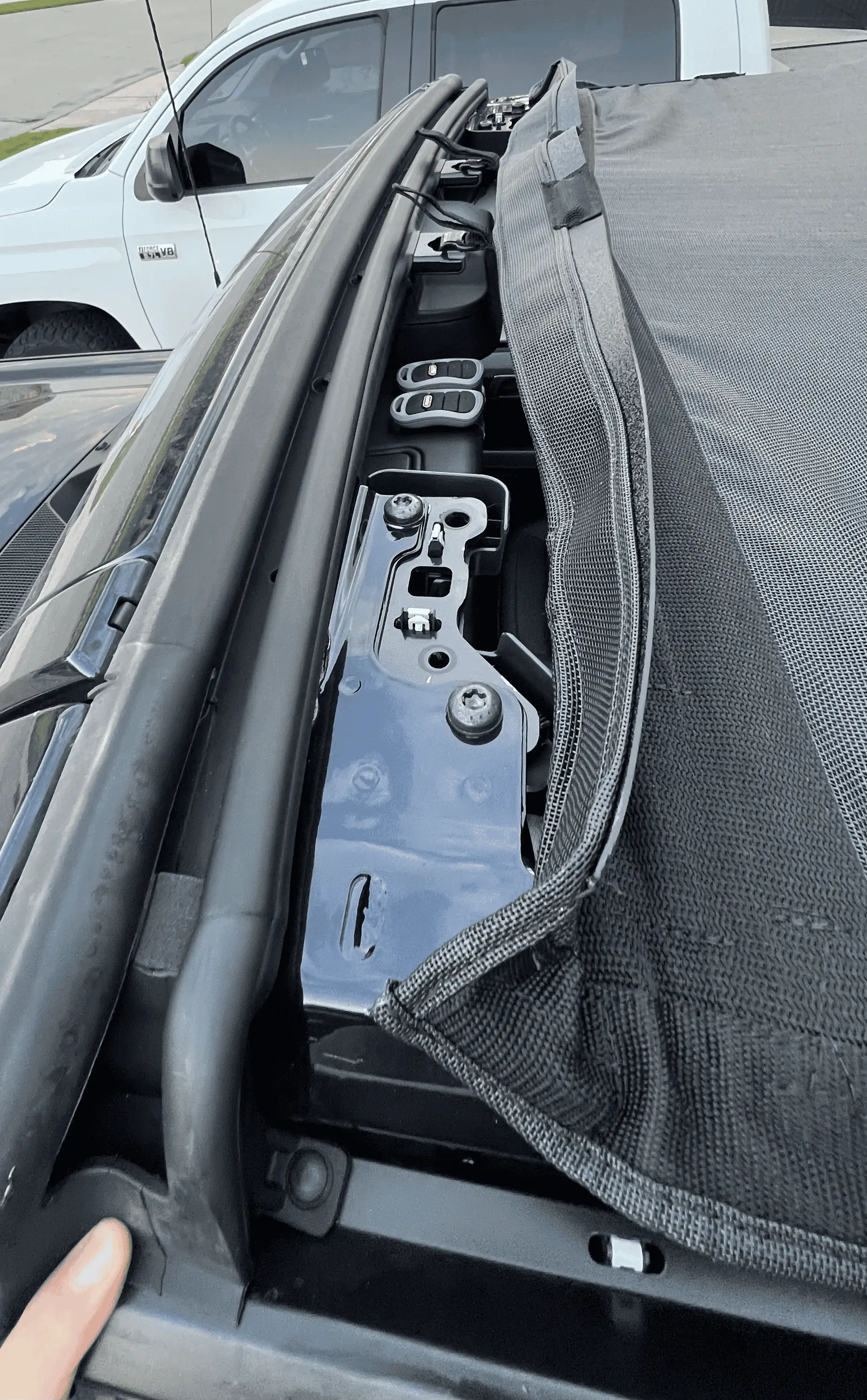

I have the Jtop and I'm partially satisfied with it.
The front flap won't stay down which leaves the gap open and causes additional flappy noise while freeway driving and I've had nothing but issues with the velcro. I've replaced the velcro after it came undone on both sides. I received two new velcro strips from jtops and after cleaning thoroughly with 91% alcohol and leaving the mesh shade off for over 48 hours so the adhesive glue could set, the new pieces of velcro once again came undone.
I ordered the Bimini mesh from Ford 2 days ago. If anyone wants the Jtop shade, it's yours for $200 plus shipping.

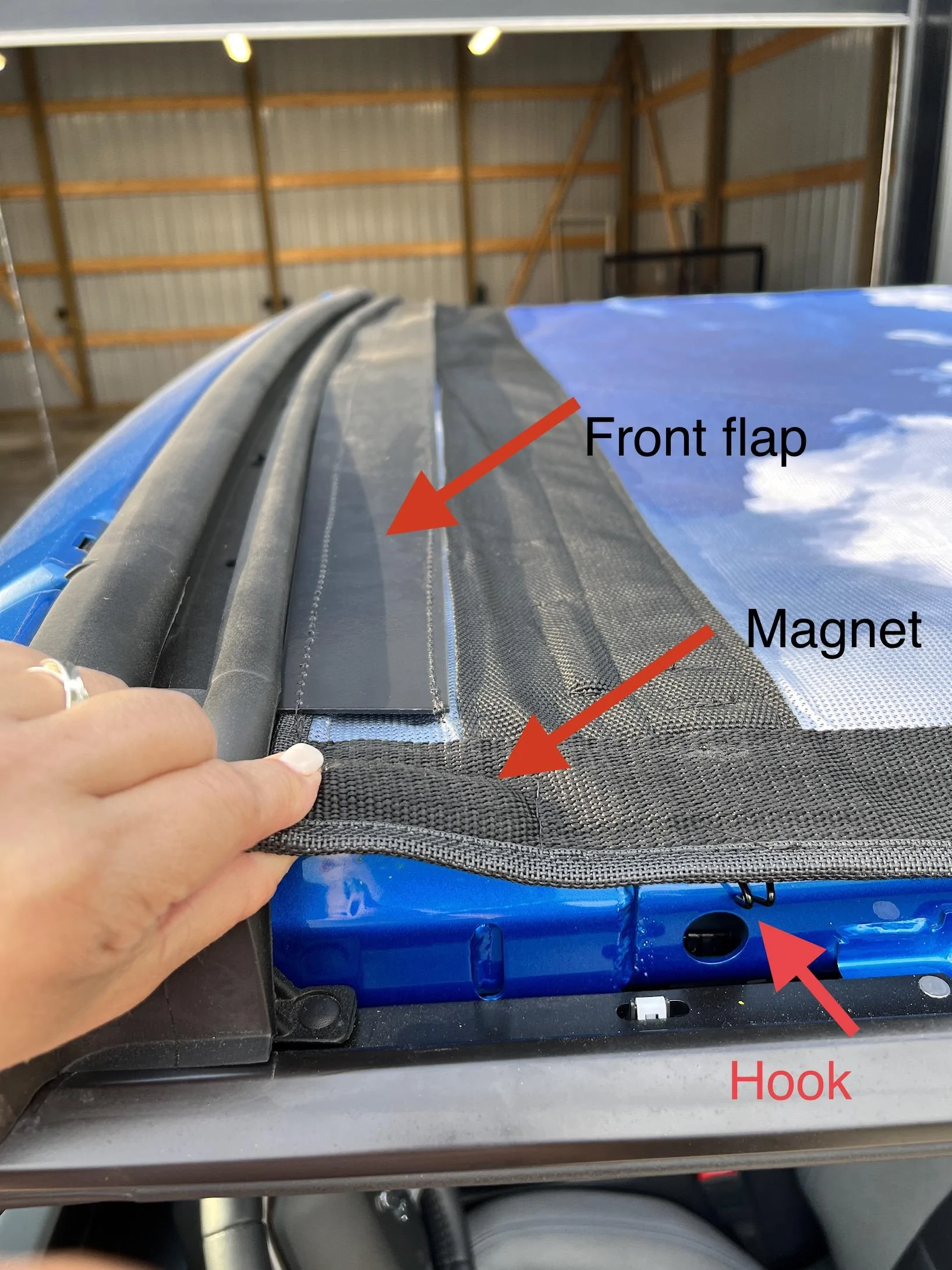

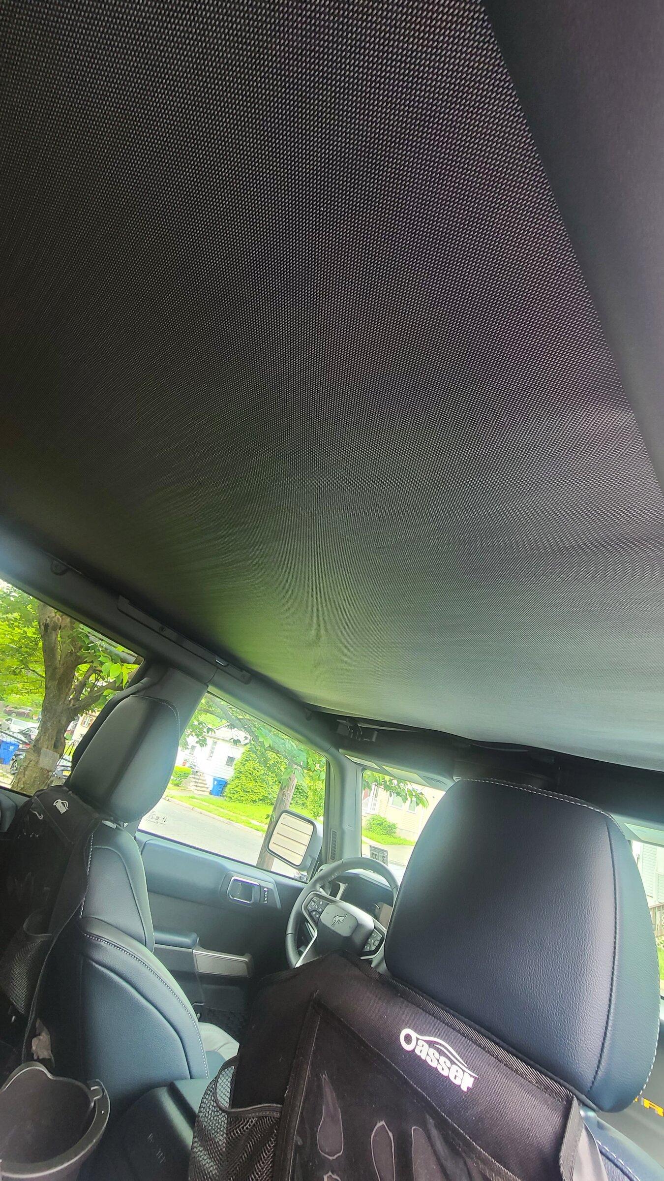

This is Mike with Jtops. There are a couple of issues here and we apologize. There are simple things we can do to fix this.
First the two center front straps need to be cut off. They are hindering the magnets from holding the center down. We eliminated them because they are not necessary. That was pure overthinking when we added them for ease of use. We also have added 4 extra magnets to the front corners that increase the bond by 24 foot pounds. They can be added in the field. All new tops come with the extra magnets.
It’s also important that the top be mounted snug up against the windshield gasket. Looking at the pics the creases in the corners indicate the center part of the shade might have been pulled to hard to the back.
The Velcro issue can be easily remedied with the new Velcro replacement kit and the 3M adhesion promotor. Acrylic glue is very finicky and if when installing it it is pulled up to reposition it will not bond again even though it’s very sticky.
We take these issues seriously and will work with you to fix them. I am also available to help by phone 7 days a week.

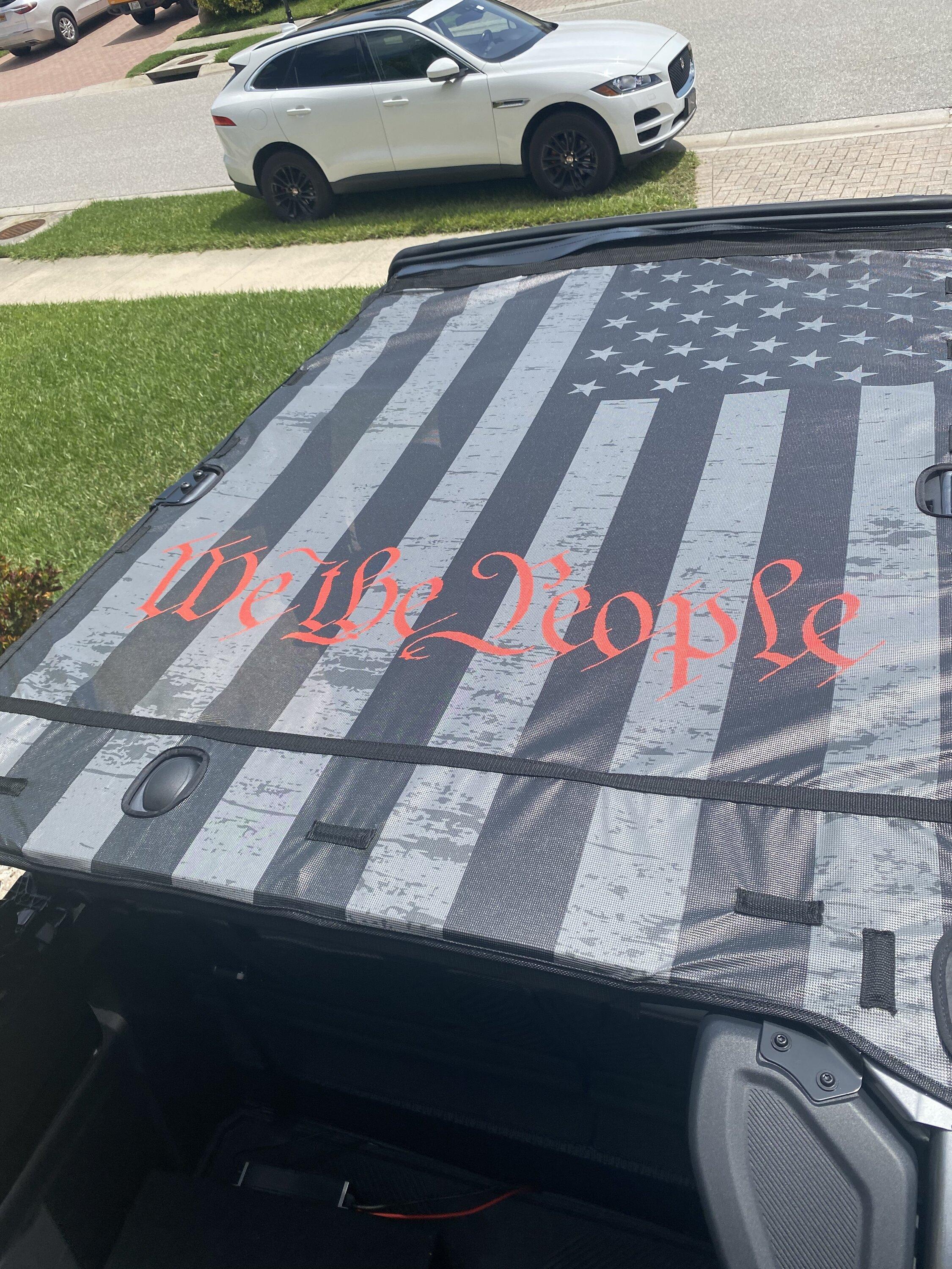

Jtops. Best made option out there and you can get a custom one made. No issues at highway speed and flapping or trying to take off.
