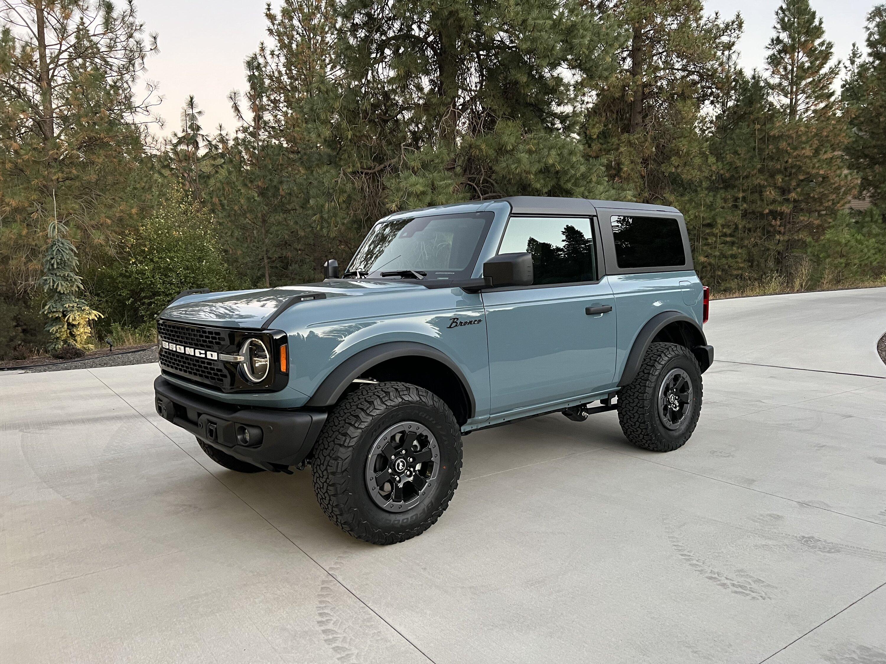

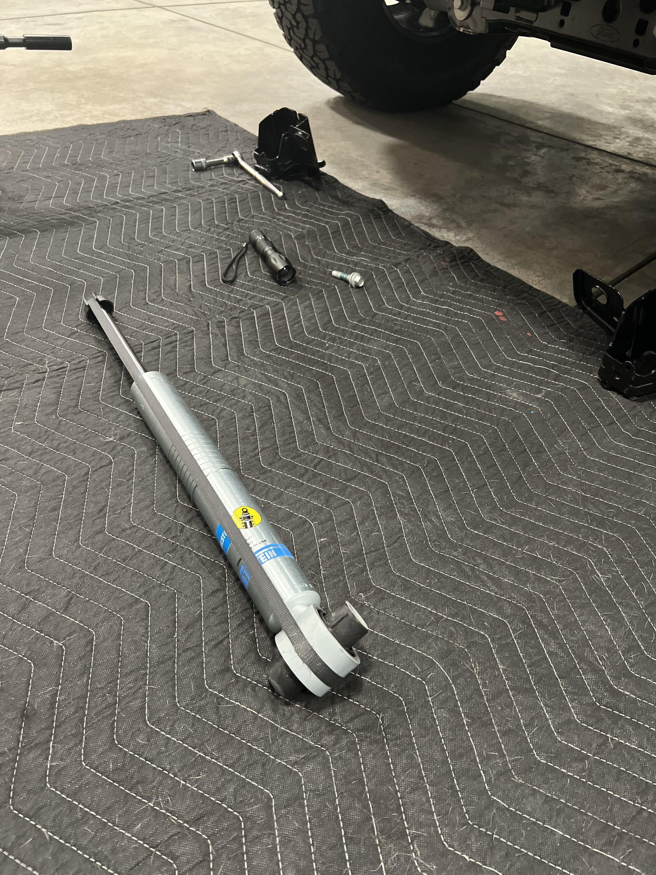

Recently installed 5100’s on my non SAS BB with Badlands 34” Ford Performance Special edition wheels/BFG K02’s. Set at Pos #1 for 1” lift all 4 corners. Not a huge fan of the additional felt road imperfections. Trade off for a daily driver might not be worth the hassle if your looking for plush ride.
