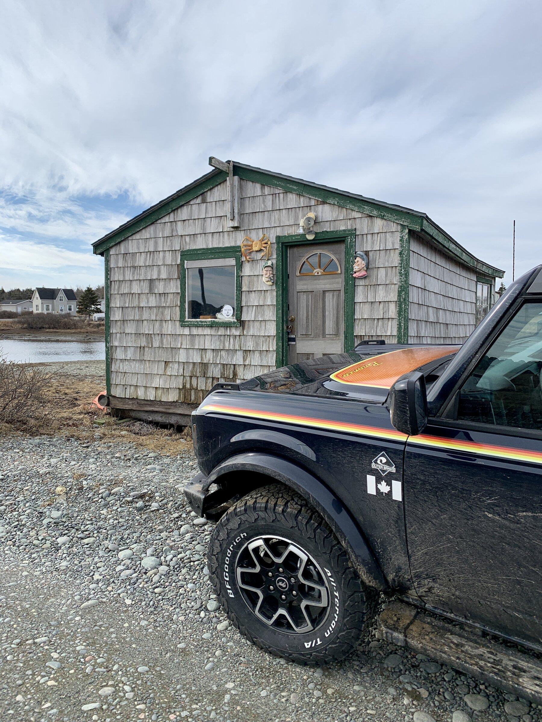

I have an Outer Banks also. The stock tires are 32.1 inch. I replaced stock with BF KO2's sized at 275/70/R18 on original rims. No lift required and crash bars can be left in. No rub at full lock. No poke either.
That looks amazing
