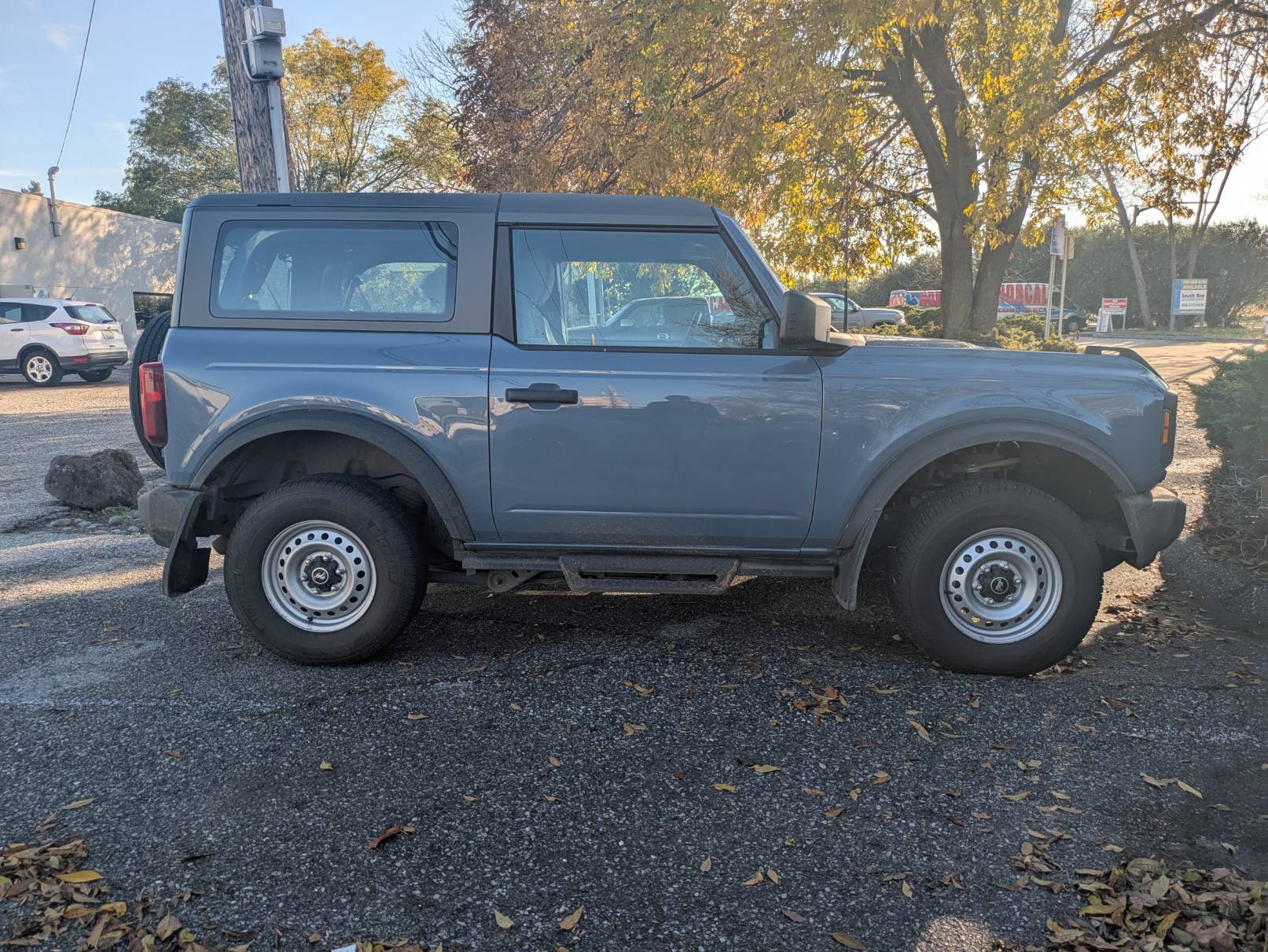

Had my base Bronco for coming up on 2 years now, still running the stock steelies. I actually quite like the simple, classic work truck style of them, but I wish they were bigger. 30" tires on 16" rims leaves a ton of negative space in the wheel wells that looks a little goofy from the broadside.
Ford Bronco Bigger wheels for Base model, questions about fitment PXL_20241217_223619238
It won't be for a while yet but I've been toying with the idea of getting 17" rims which will give me a lot more options for larger tire sizes. I've seen some pictures of 33's and that looks like a perfect balance to me, filling up some of that cavernous wheel well without requiring a lift or impacting on-road driveability too badly. Much as I might like to fantasize about crushing trails, the fact of the matter is the overwhelming majority of the miles I drive are commuting to work on paved roads. For tires I'll be looking at a light truck highway tire like the Michelin Defenders I've got right now, or a road-biased A/T, in 285/70R17.
I've narrowed my search to a few rim options that I think would look good, but I'd love to see some pictures of Broncos with them mounted in real life. Or if anyone who's tried one of these options and found it really doesn't work due to offset, backspace, or other clearance issues that would also be useful information. I've heard rumblings about the Bronco's unusual positive offset, but I don't totally understand what this means in practice when shopping for wheels. You can see below the kind of style I'm going for, so I'm open to suggestions for rims with a similar vibe (in 17x9 or 17x8) that my own search didn't turn up. Oh and what's the go on recalibrating the speedometer for larger wheels? Will the dealership or 3rd party installation shop do this for me, or am I gonna be stuck adding 10% in my head to whatever is shown on the dash?

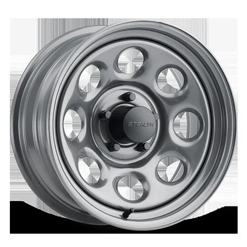

US Wheel Stealth Crawler Series 047
My favorite in terms of looks, but also the most expensive of the bunch.

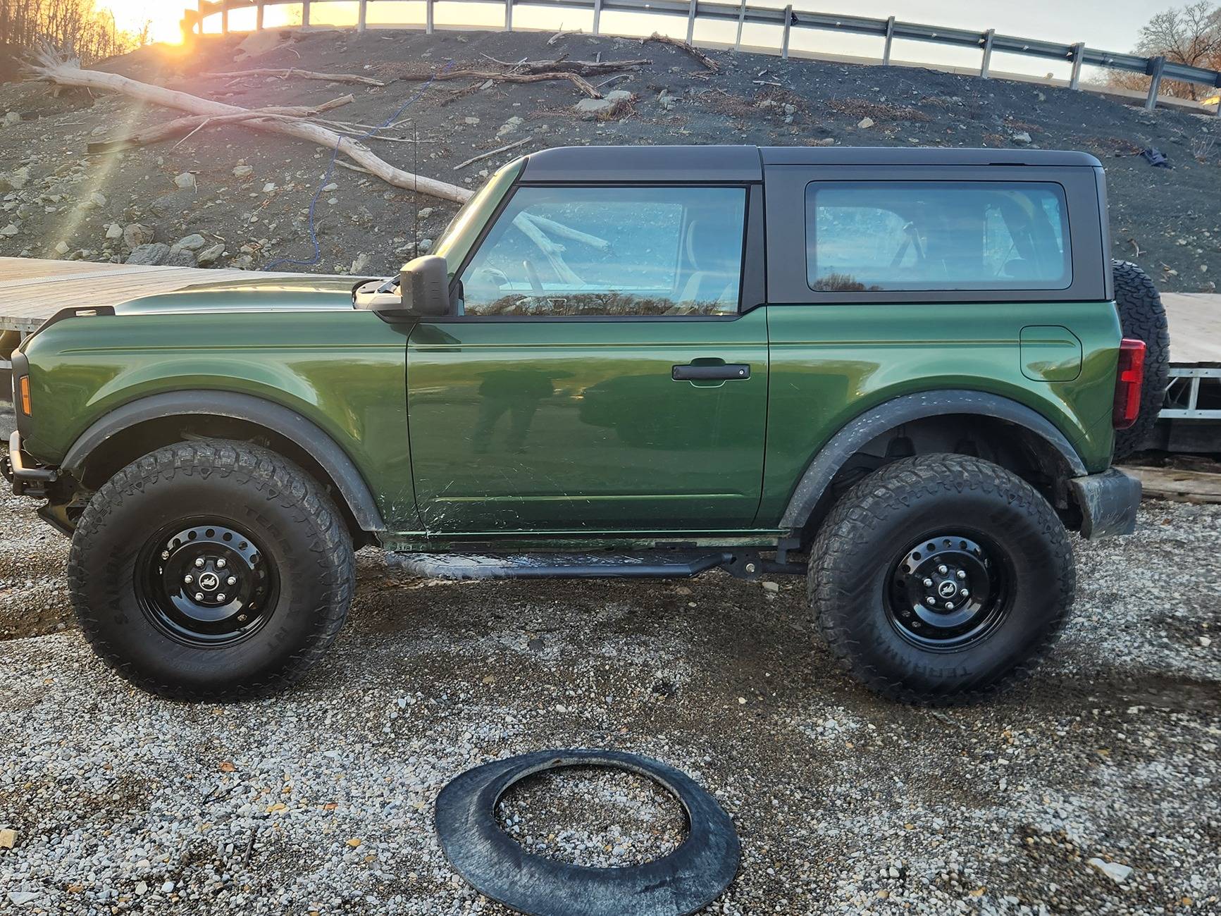

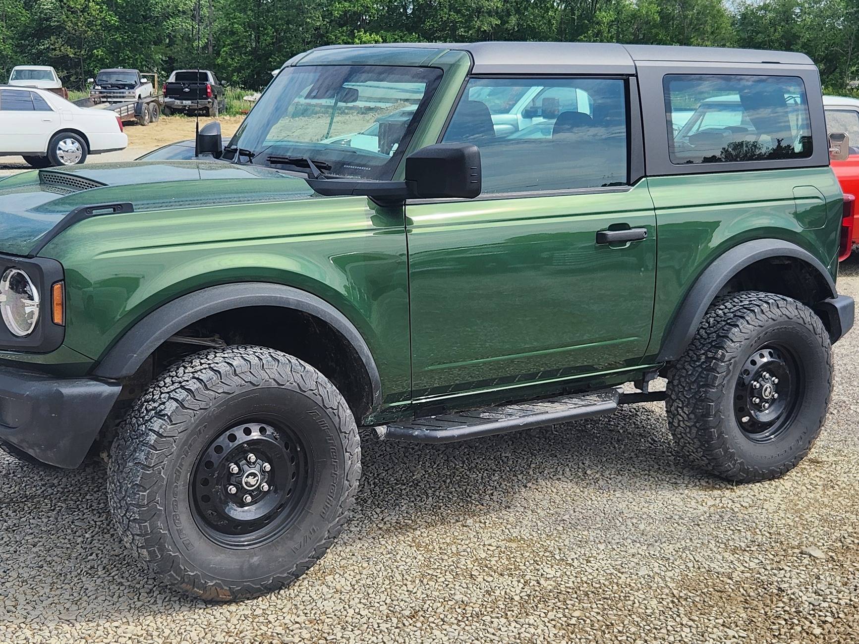

this is with 35a and a 2 in lift now on 37s aame 2 in lift 1.5 wheel spacee its a base
Ford Bronco Bigger wheels for Base model, questions about fitment 1000000873
Ford Bronco Bigger wheels for Base model, questions about fitment 1000000658
