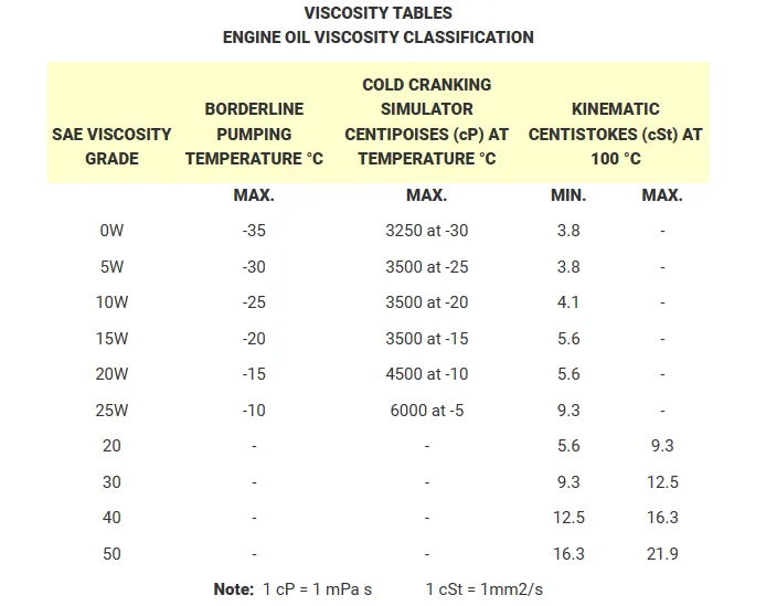

While the friction may be reduced somewhat due to break-in which **may** lead to an MPG improvement there is NO oil on the planet that is going to increase MPG more than a few tenths AT BEST.
Always hilarious to see claims of 3 or 4 MPG improvements based upon an oil change when the only thing that **COULD BE** different is a slight move up or down with viscosity with a given range for a given viscosity between brands.
In this case, for 5W-30, the range is 9.3 to 12.5 cSt @ 100°C and there is not enough viscosity change within that range to enable any substantial increase in MPG.
Last, but not least, there are no "controls" to maintain consistency for testing MPG within oil brands while driving--your right foot, a headwind, increased loading, and a hundred other variables exist that prevent a valid test.
