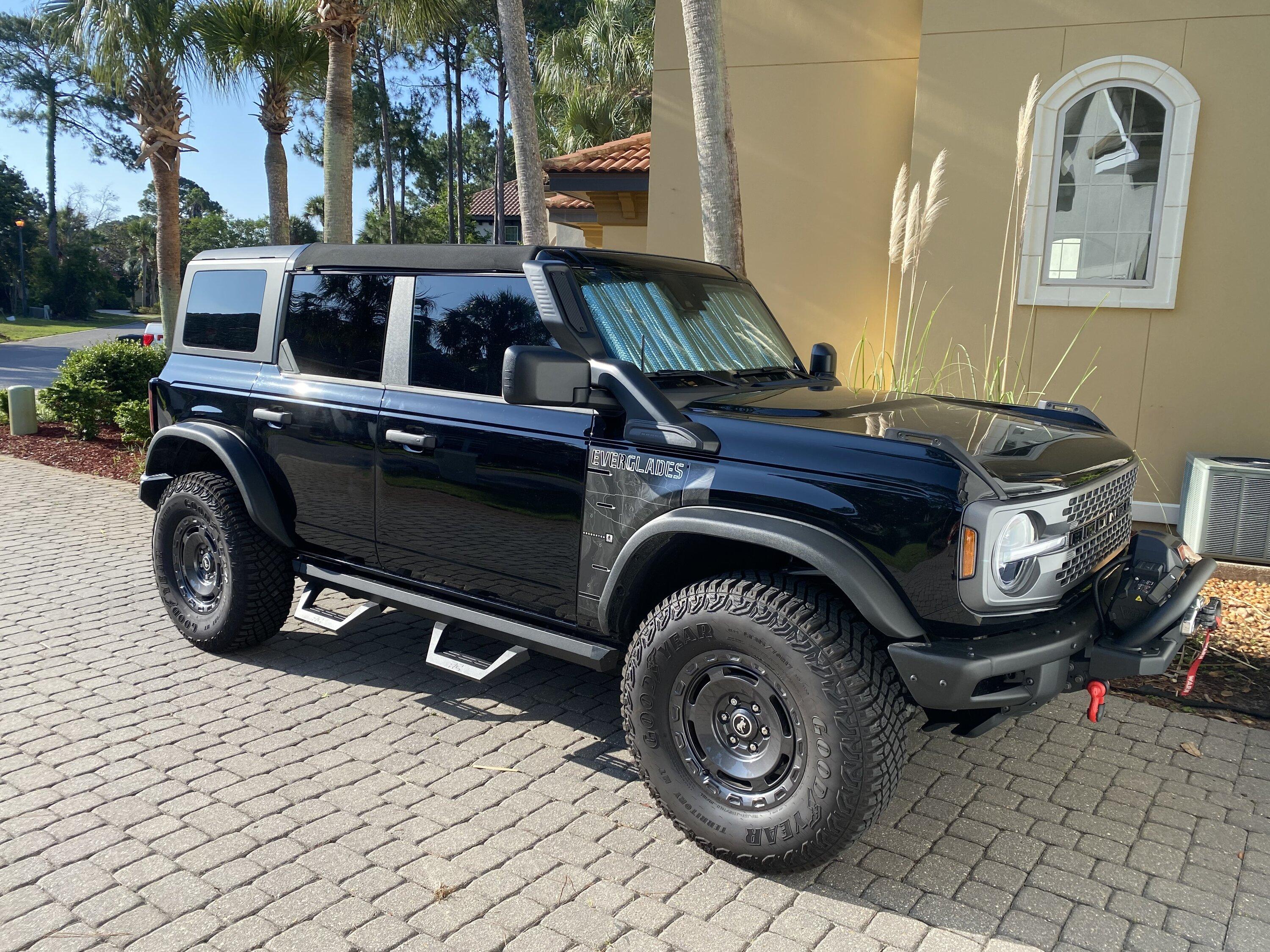

My top came in the mail yesterday and installed today. Same flapping/popcorn noise. What’s this cable everyone is mentioning so I can check. I can definitely stick my pinky underneath on the passenger side

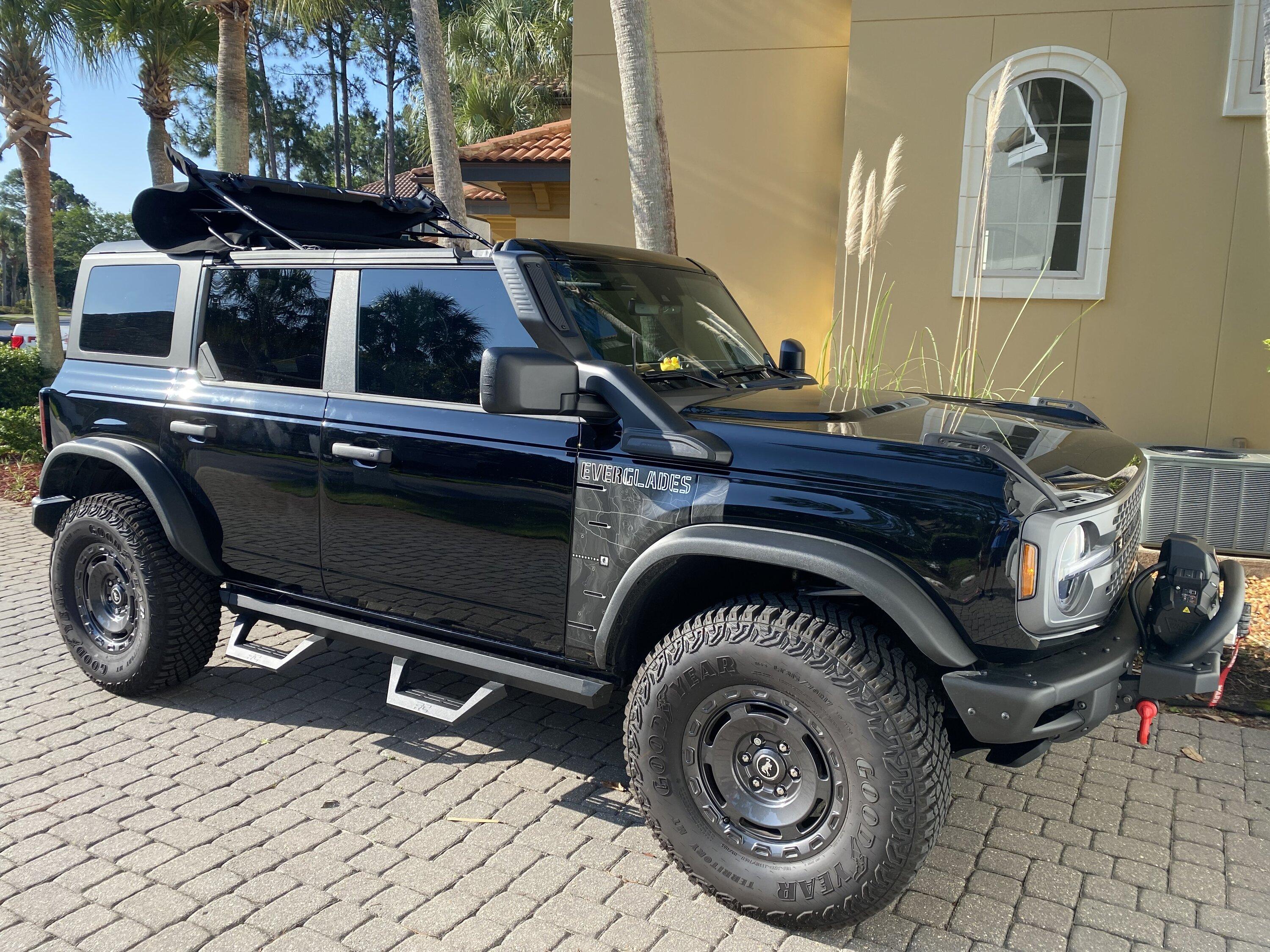

I'm wondering if the cable on that side came loose. Mine makes kind of a popcorn popping sound at high speeds but I haven't seen it do anything like that on either side. Looking closer at the photos something on that side doesn't look right it should be flush with the bottom looks like something is pushing the top out. Compare it to the other side.

I appreciate the feedback. I’m certainly going try and remove the back and check the cables once I get a chance.
The snorkel comment is interesting, as I certainly never thought about how that affects airflow. We shall see after I pull it all apart. Ha!
I just bought a Sunrider and I have Everglades and it does the same thing on the snorkel side. I’m going to send it back because I believe the wind noise from The snorkel is causing that flapping noise..
