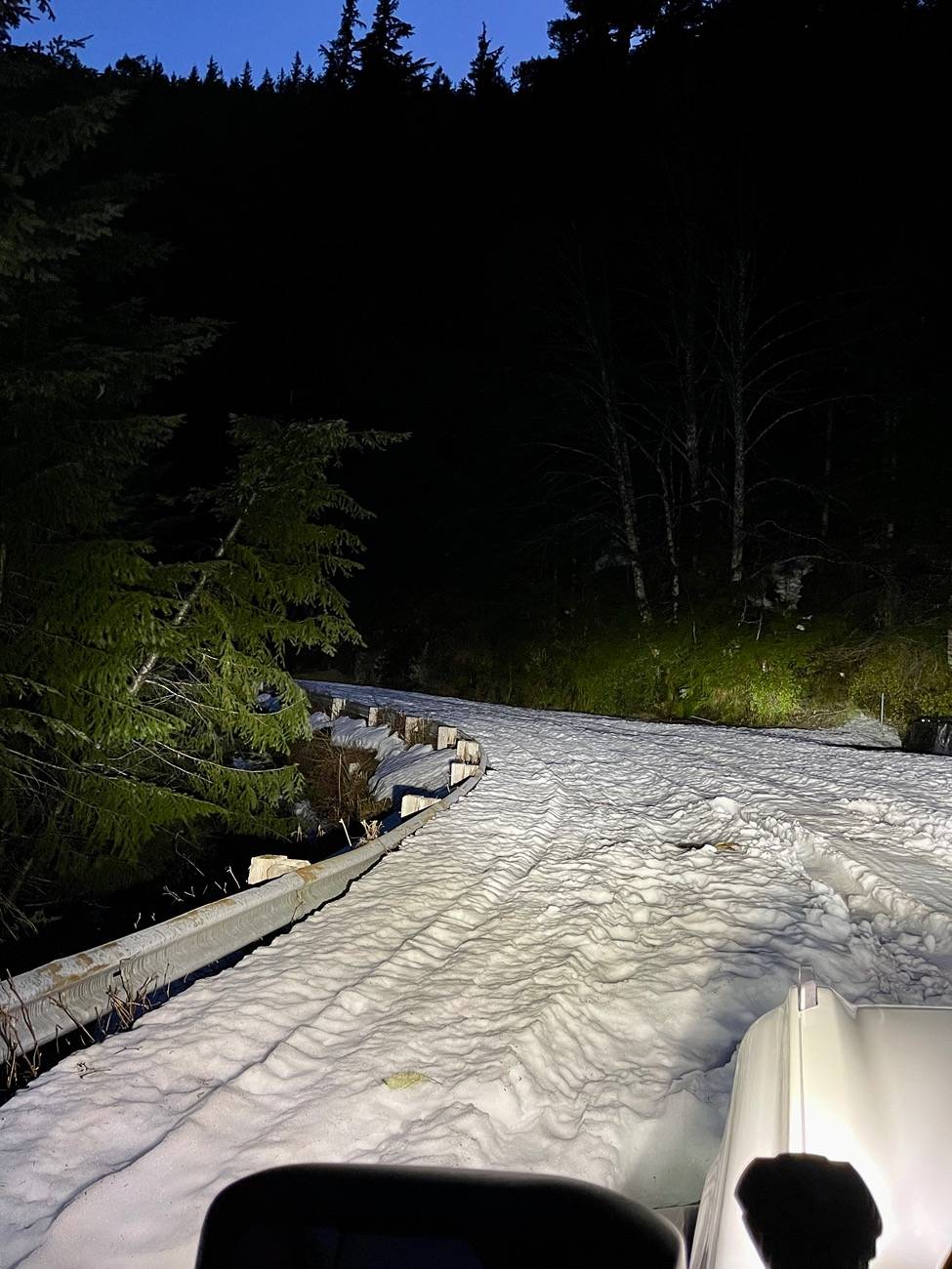

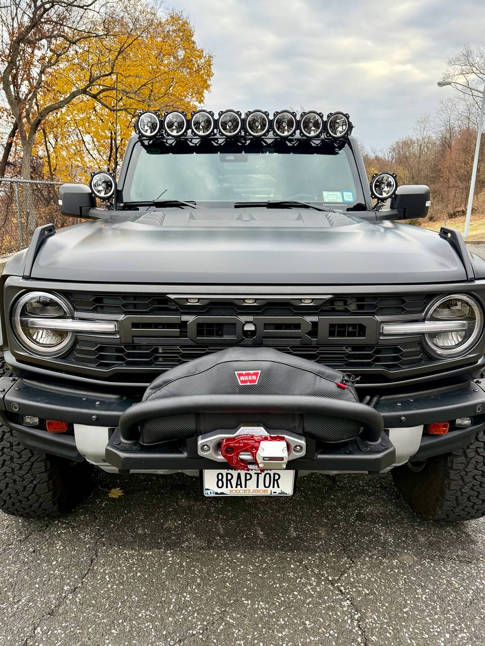

No hood glare for me but, I have a matte PPF. If you are looking for ditch lights that are more for long distance lookout for animals, I would suggest a driving light as compared to a flood or wide beam.
Here is my KC Gravity set up (for night wheeling)
Ford Bronco Best road ditch lights IMG_1037

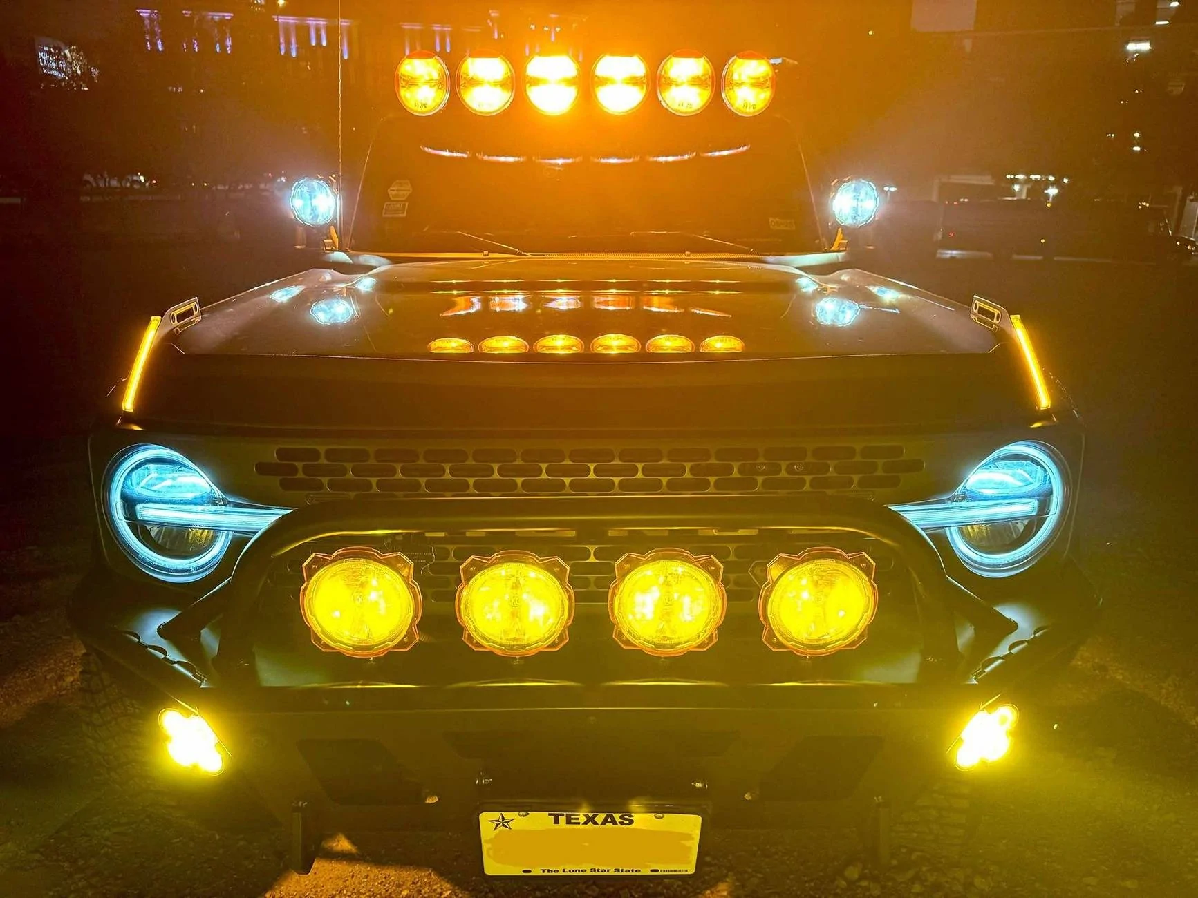

I have a few lights on the front....
Project X Offroad on the rood, KC Pro6 on the sides and front bumper, KC Flex Era 3's in the bumpers (they're bright as HELL too!)
Ford Bronco Best road ditch lights Azuroth 4.1-2
You can also get knuckle pod mounts that actually turn with your wheels as well.

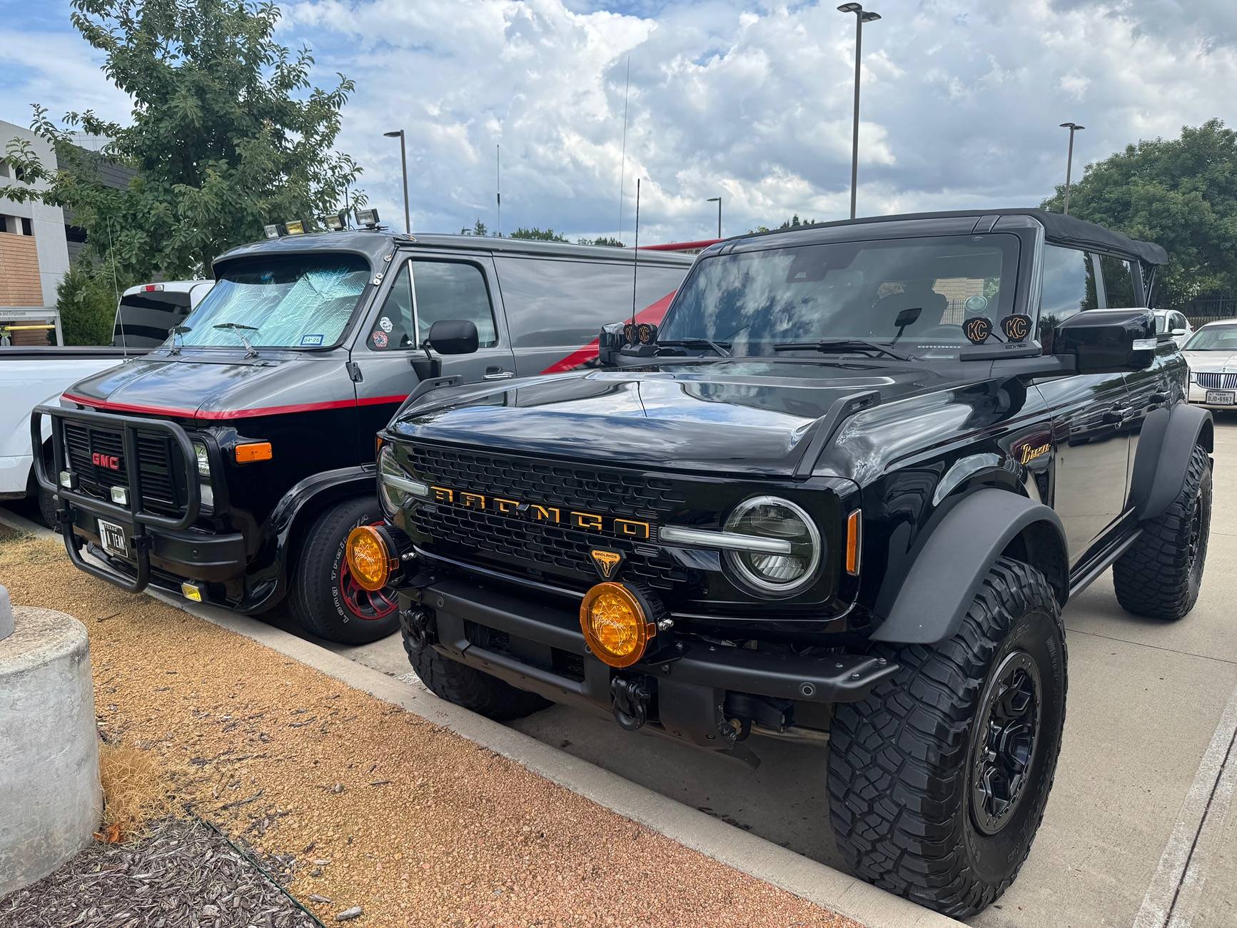

The KC Hilites Flex Era lights are great.

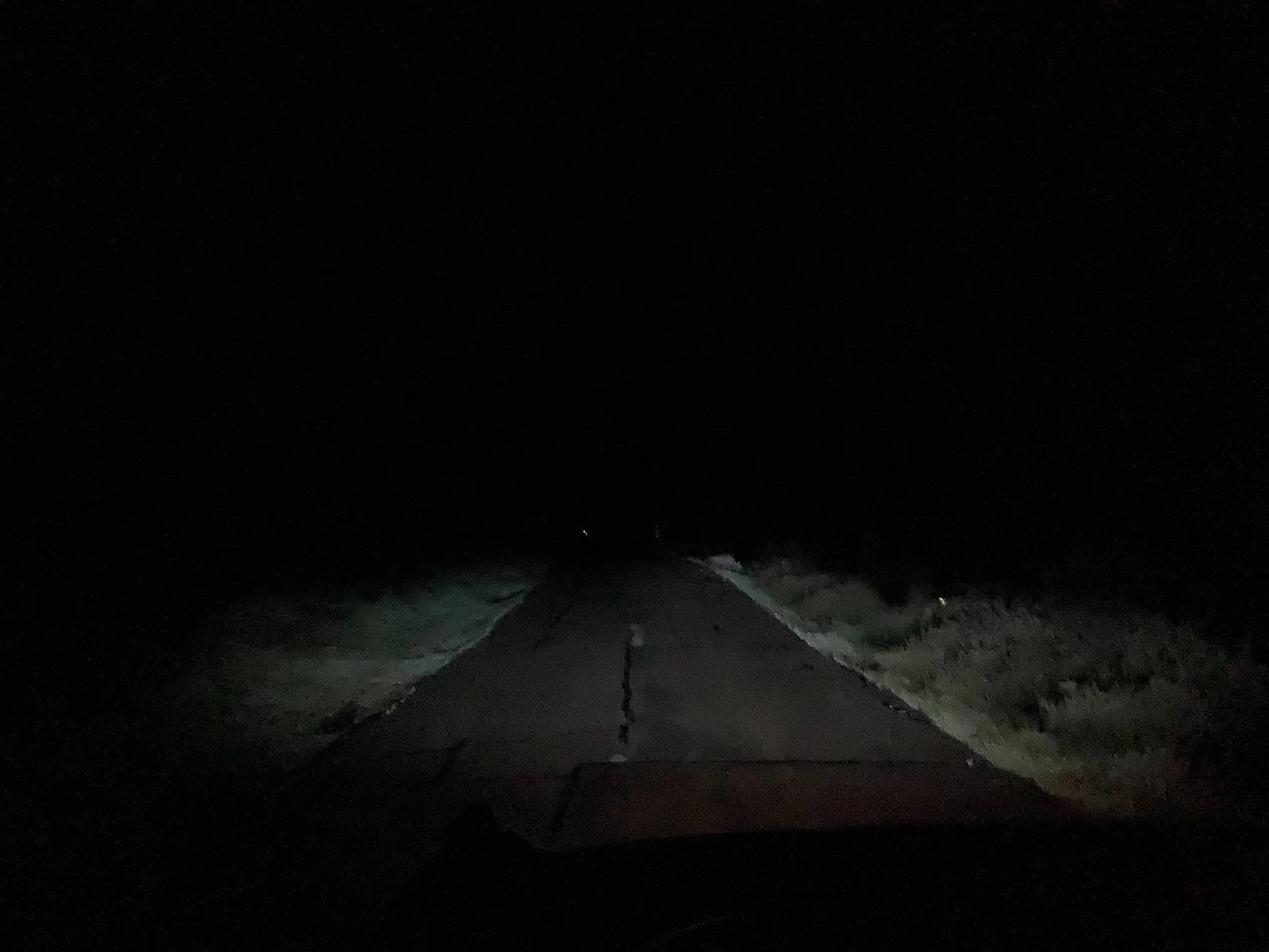

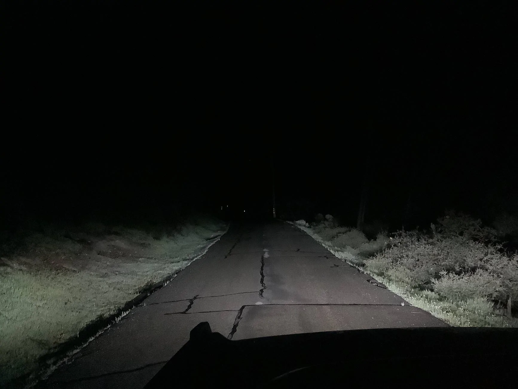

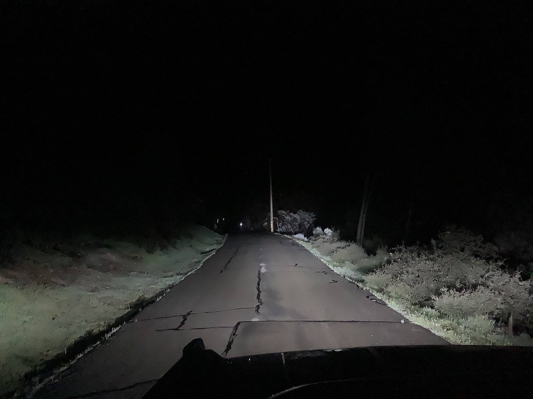

Non SAE lights and non “clearance” lights mounted above the headlights are illegal and can be a dangerously unsafe to other drivers…quality SAE fog and driving lights mounted to the front can greatly increase visibility safely…
headlights

Add DD SAE Fogs

Add DD SAE driving

SAE lights above the headlight are also illegal unless used correctly.
We get a lot of customers who buy SAE Fog lights to install on A-Pillars because they are LEGAL. But they don't realize they are legal when used correctly. On the a-pillars is not correct.
Even SAE Driving lights are illegal on the a-pillars, because they are TOO HIGH. SAE Driving lights, when installed at the height of high beams, and used as high beams, are street legal. But people get confused when they see "SAE Street Legal"

All pillar/“ditch” and/or roof mounted light is illegal on federal highways, period and “for off road use only”…in Calif. they are supposed to have the wires cut and must covered (yes I have been stopped)…I run them with covers unless off road (they can still stop me for no front plate)…you do you…good luck!
