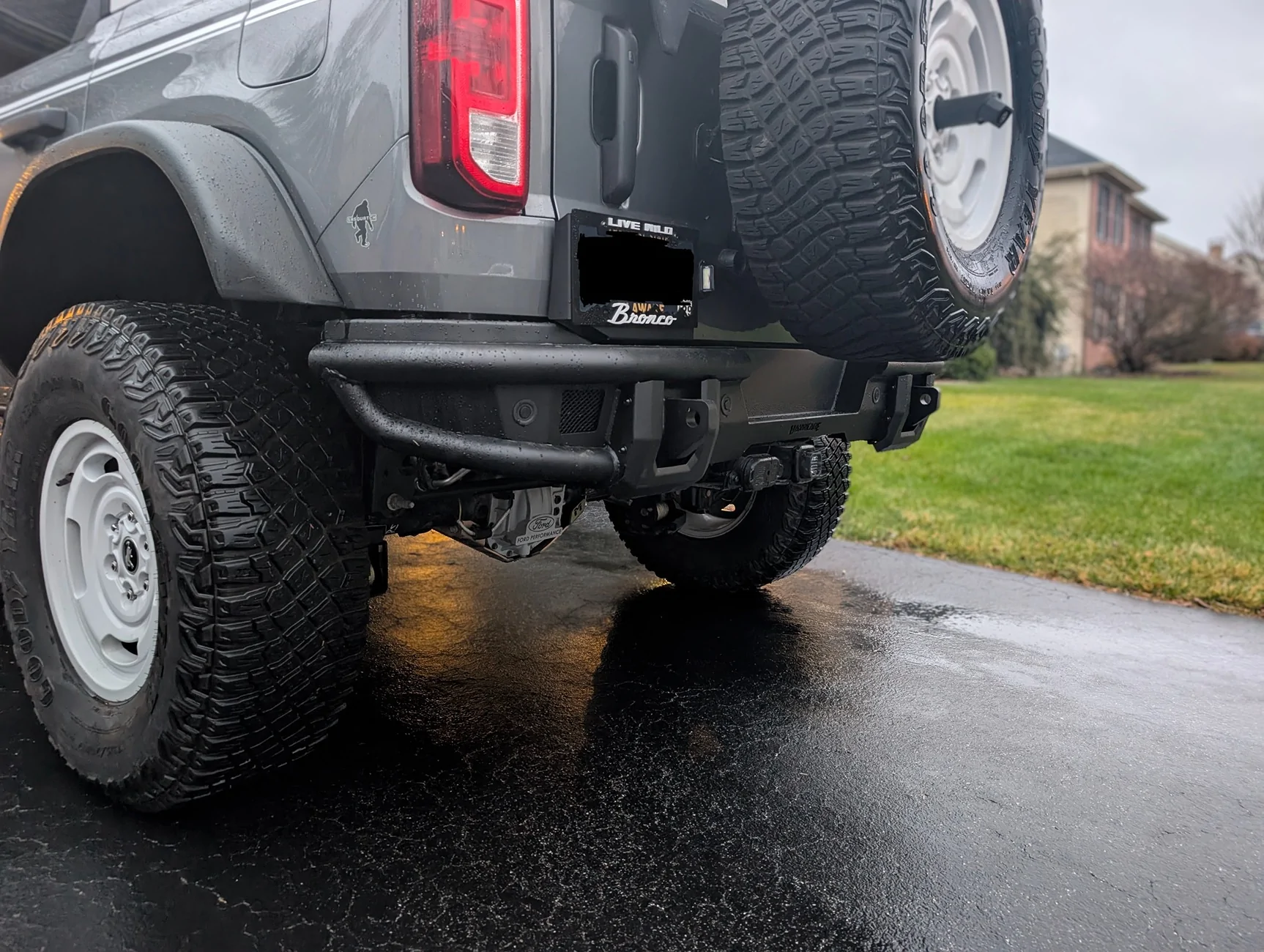

I have the TOR and like it, I choose it because the way it mounts.
Others that I've seen either use the Ford emblem as an attachment point or they use tire carrier mount.
I also have the TOR tire carrier which made an relocation using the tire carrier as an attachment point unusable.
Only complaint I have is the included light is crappy and should be more powerful.

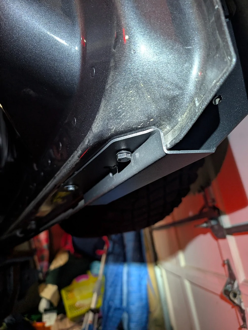

for reference

Ah, I see how that attaches. I thought were using the spare tire mount fasteners. Thanks for that @jsoa. For the light, did you have run wires across the truck bumper the back across in the tailgate?

Yea, the picture doesn't show it as that picture was taken before I installed the light, but it routes through that notch you see, through the tailgate, to the trunk tray where your tire jack is, through a rubber grommet, then over to where the original light wires are. After that it requires you to cut off the original light and splice in the wires.
I added a quick disconnect near the bumper in the event I need to remove the bumper, and also added some foam padded to the bracket that rests on the underside of the tailgate.

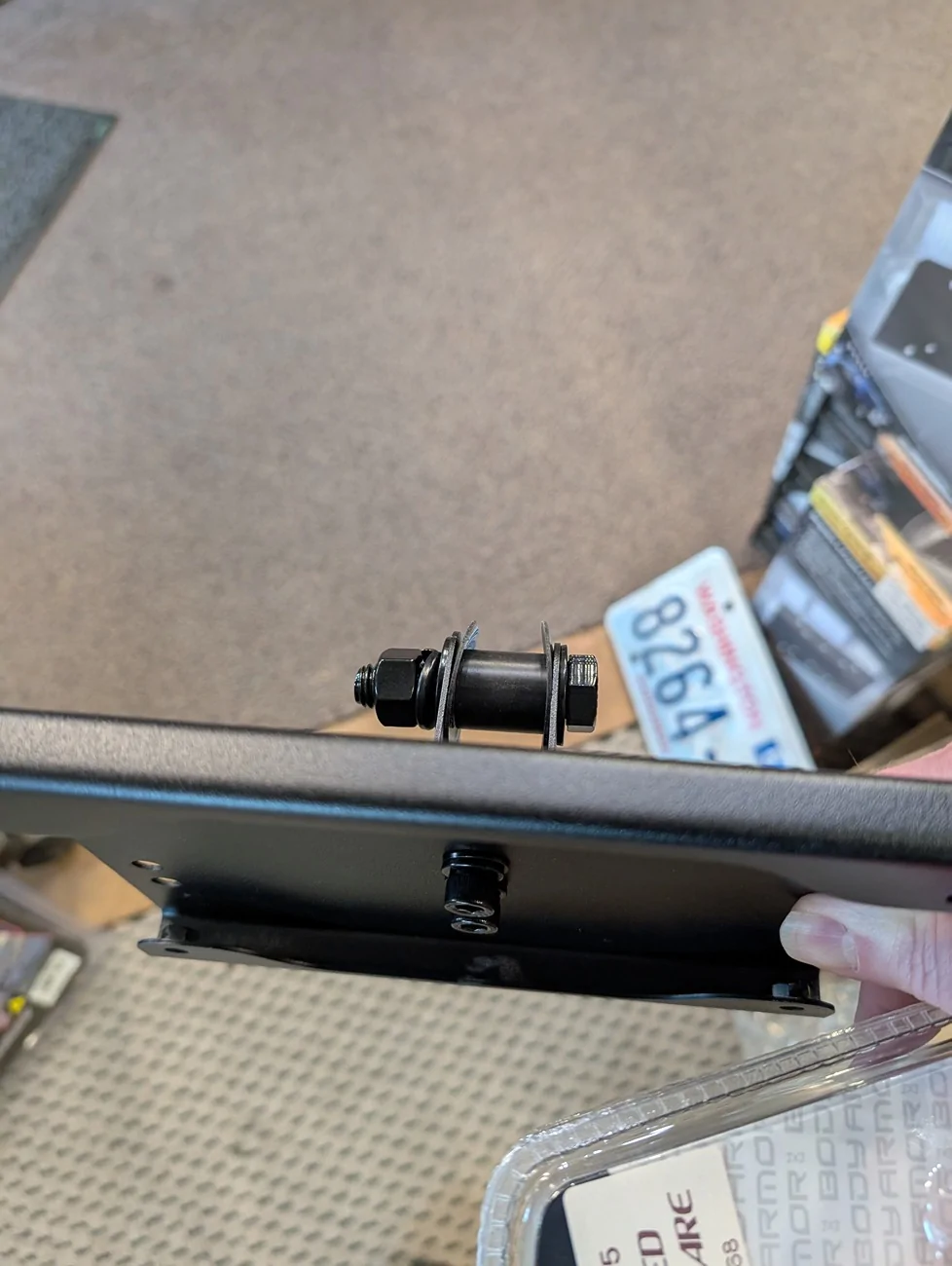

I just saw this mount today at my local 4X4 shop (Billy Bob's Off-road). It's from Kentrol (made in China if that's a deal breaker) but it seems very sturdy. It clamps to a recovery point lug. You'd have to wire in a LP light, but it has holes for attaching a light. That might provide some flexibility.
