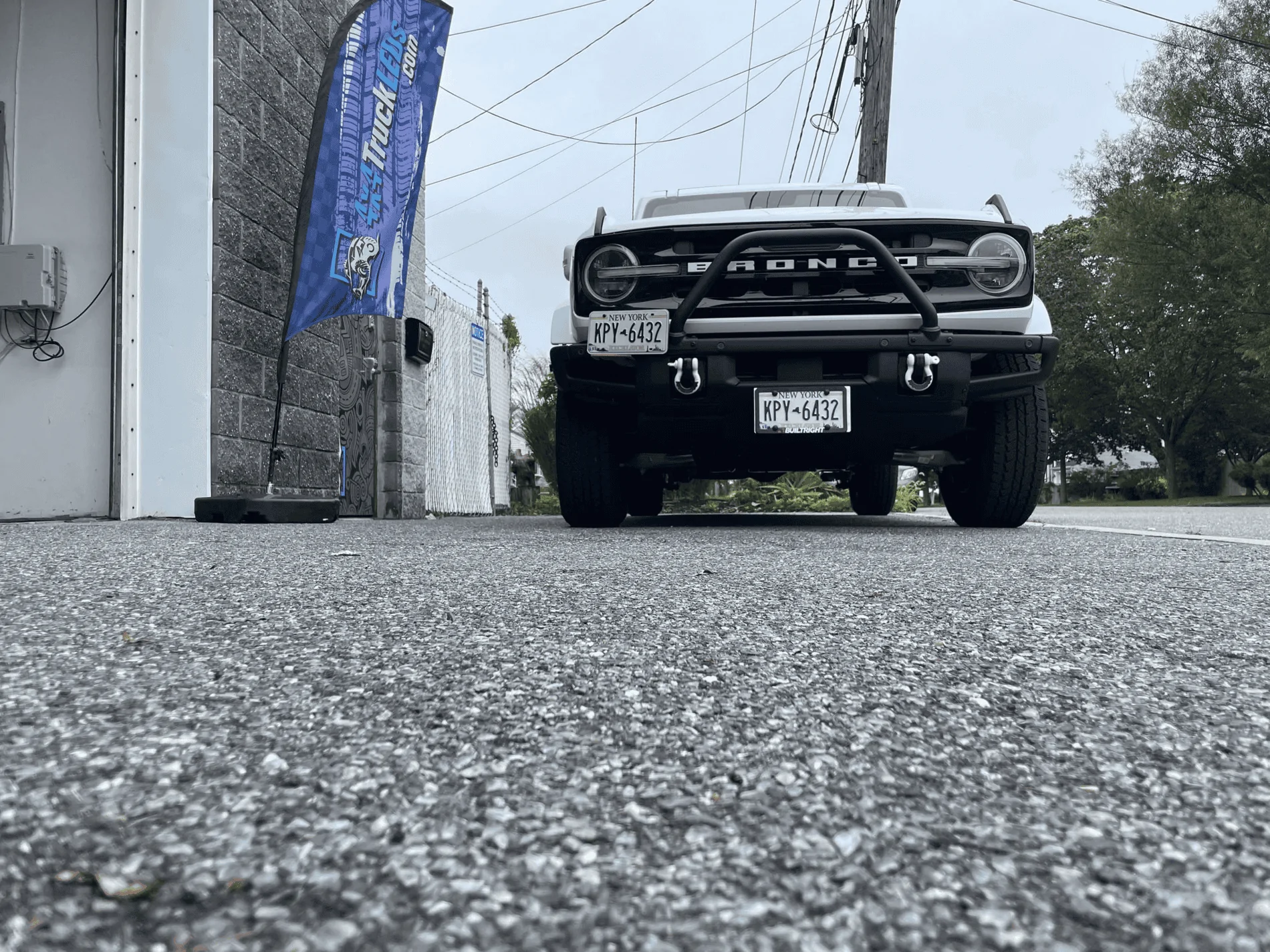

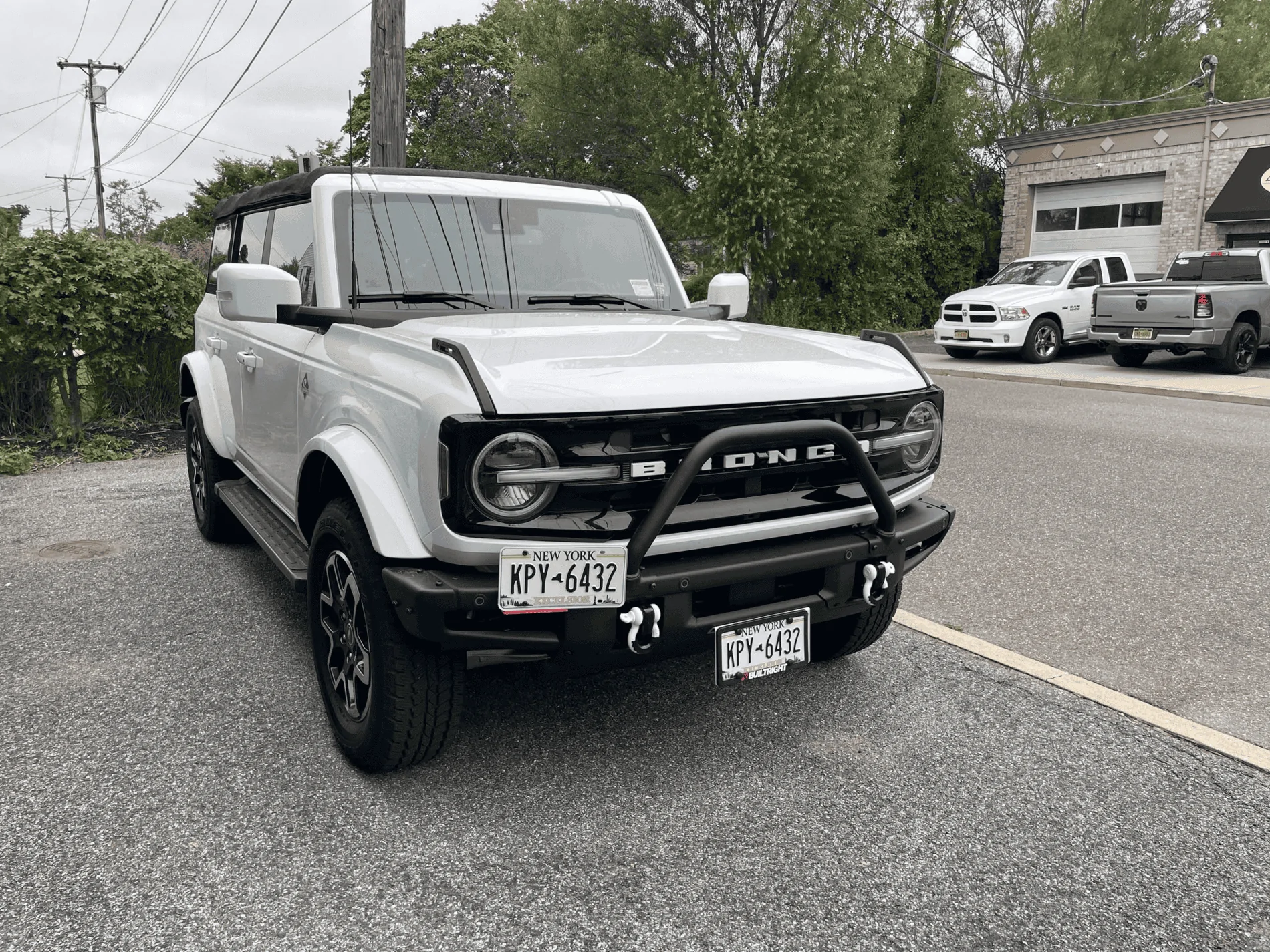

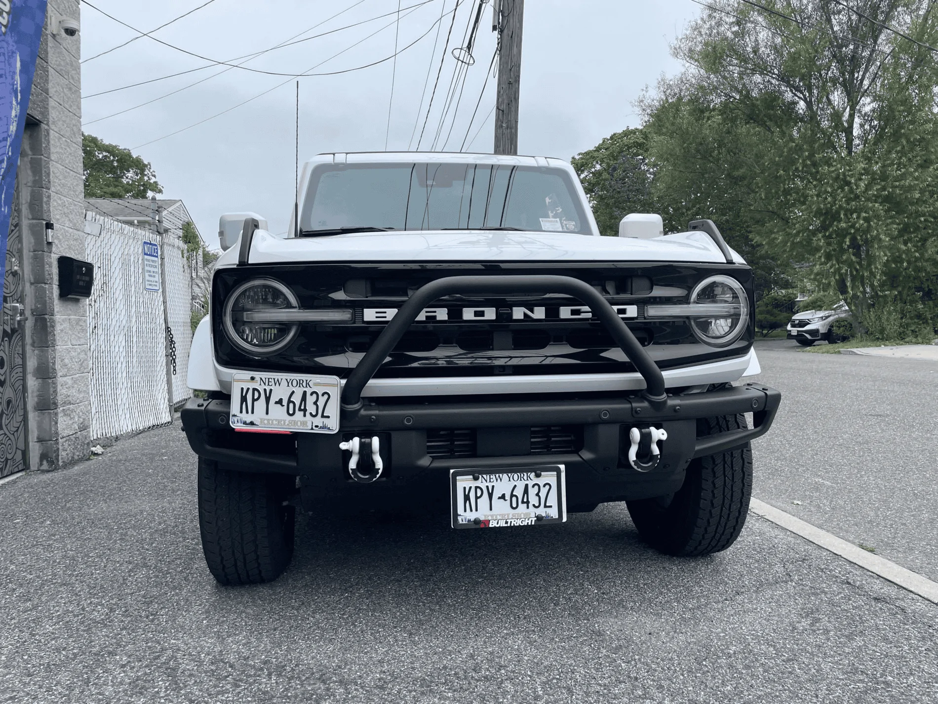

Some prototype pics (it's a 3D printed bracket for now, as we make some final adjustments, as I want to give folks the option to have it sit flush against the bumper OR allow them to have it sit straight on). You can see my other license plate bracket installed as well

Once I install our Baja Designs XL Linkable Kit on the bumper, we'll do some more test fitting. We're designing it to ensure it works with an aftermarket fog light kit AND bumper mounted light bar kit.

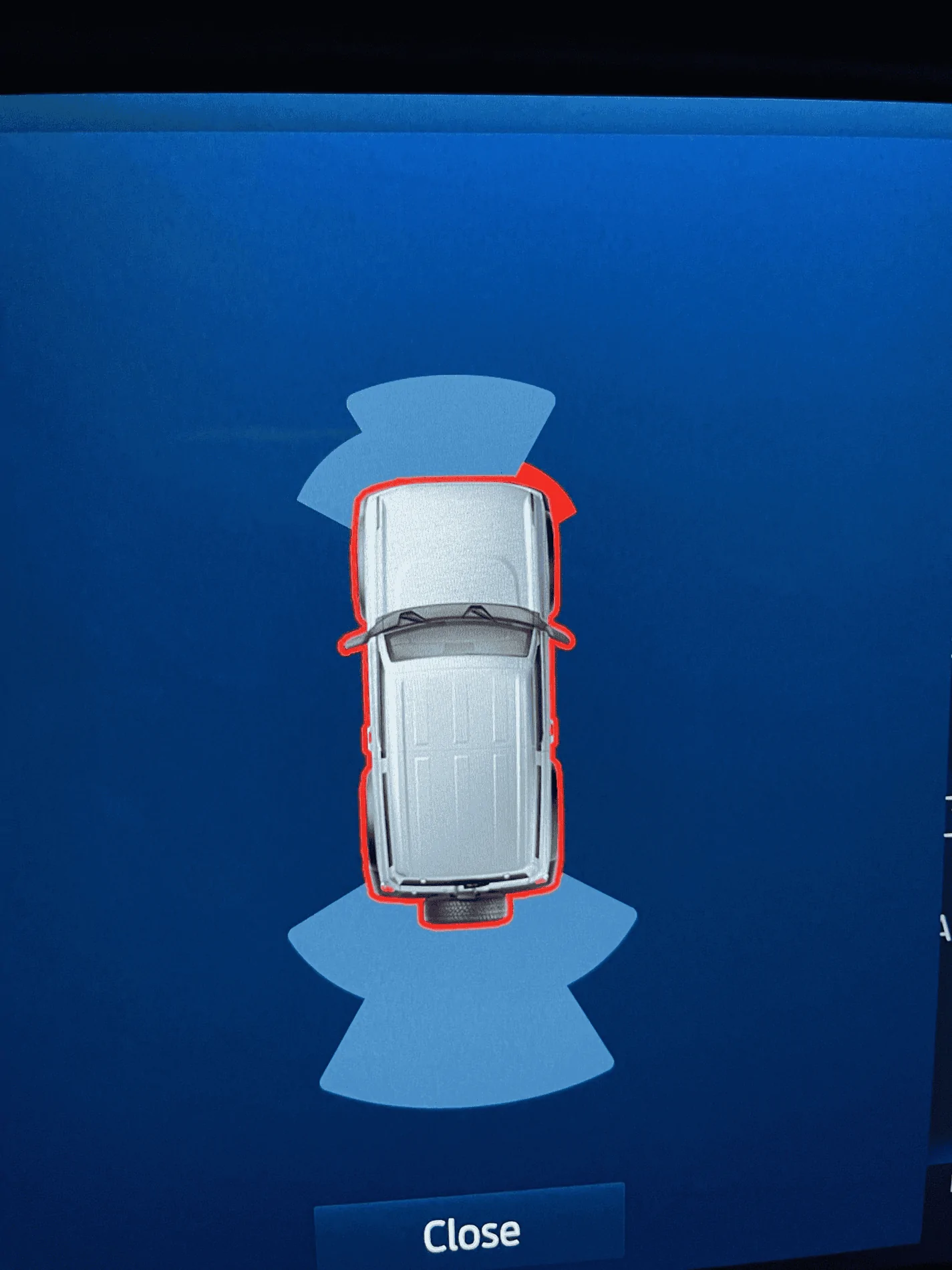

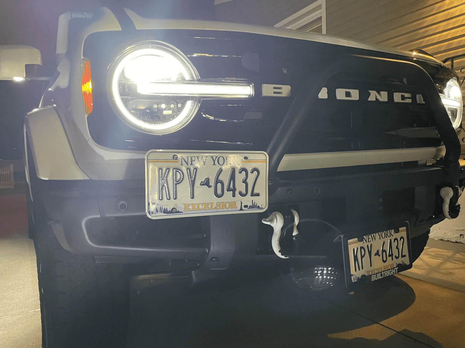

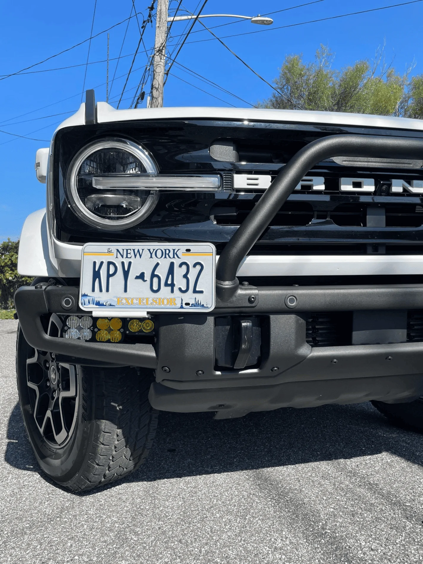

So while I finished the prototype tonight on this bracket, it's sadly not going to work 100% because of the front sensors. The front sensor thinks something is there (and it's not wrong). It sits nice and straight without blocking the fog opening but the sensor detects it. Ohh well. We wanted to have a 2nd option but this might not work as planned. It'll block the fogs if we lower it and where it sits now, the sensor picks up on it.
I could go off towards the center more and I may continue development on this later, but I plant to install a light bar on the bumper, so I want to make sure the plate doesn't block the light bar either.
Ohh how fun prototyping is!

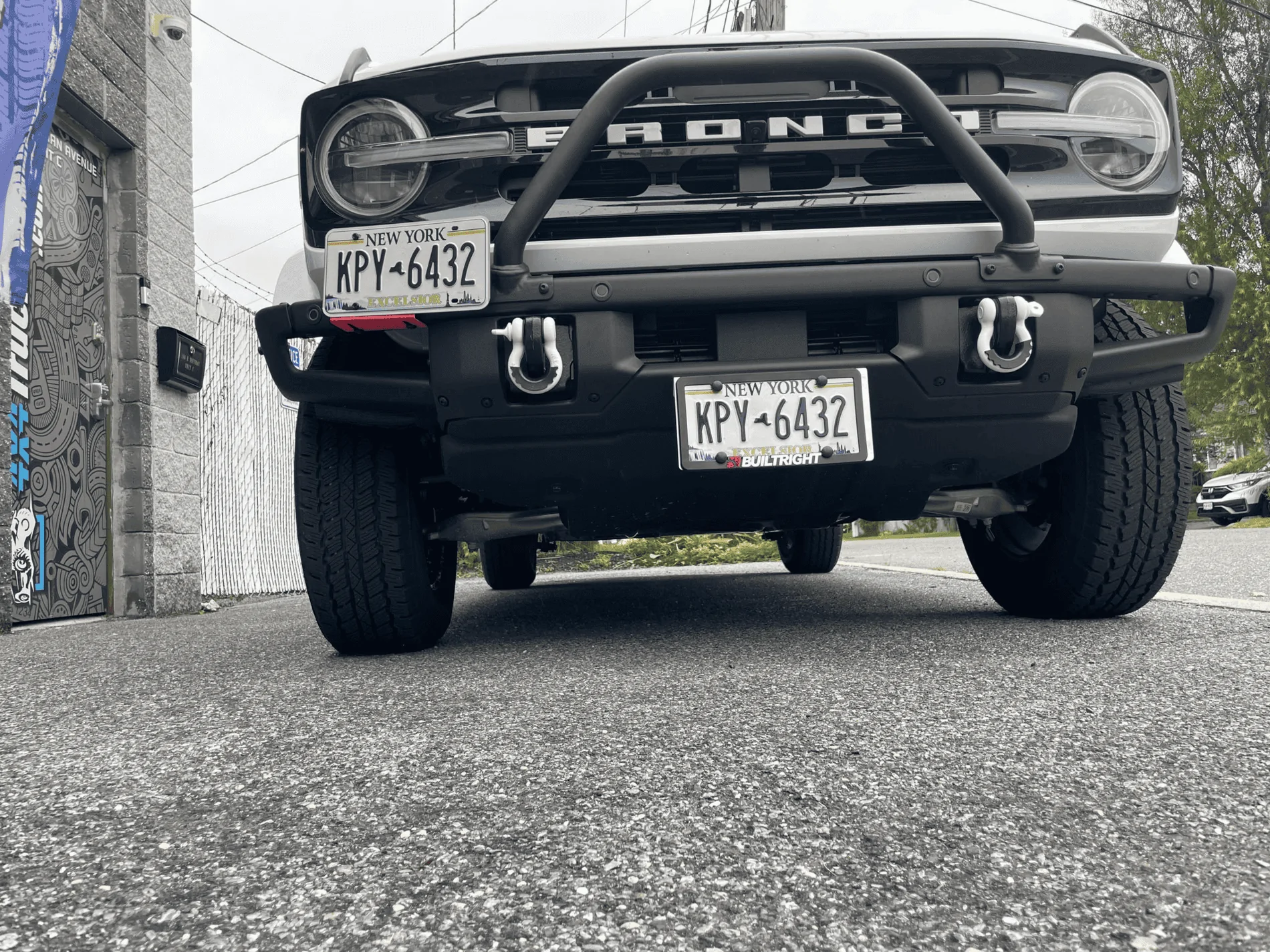

THIS one (the one attached to center of bumper) is still going into production after the recent changes (we made changes from this photo based on feedback from the public). As I said we made some changes where we made the back-plate smaller so the license plate hides it, and made it so you only need 2 bolts to secure it (easier to remove it at a trail head)

Am I mistaken? i am remembering same off-set but top of plate flush with top of mod bumper.

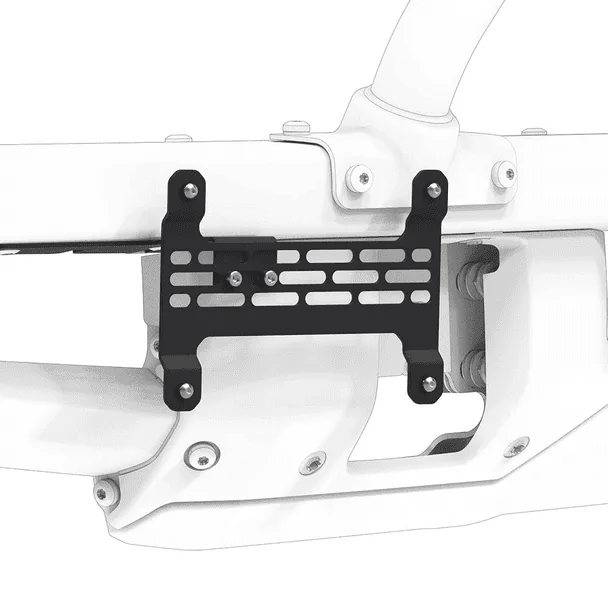

Yes, that’s the one. I preordered this one.
Yeah we're a dealer for BuiltRight so we sell this one on the site. It does block your fog lights though, but if you don't plan to run fogs no problem there

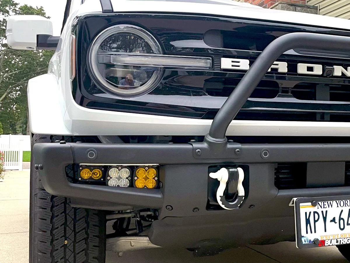

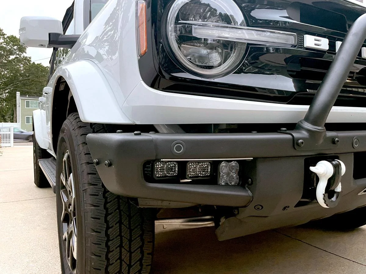

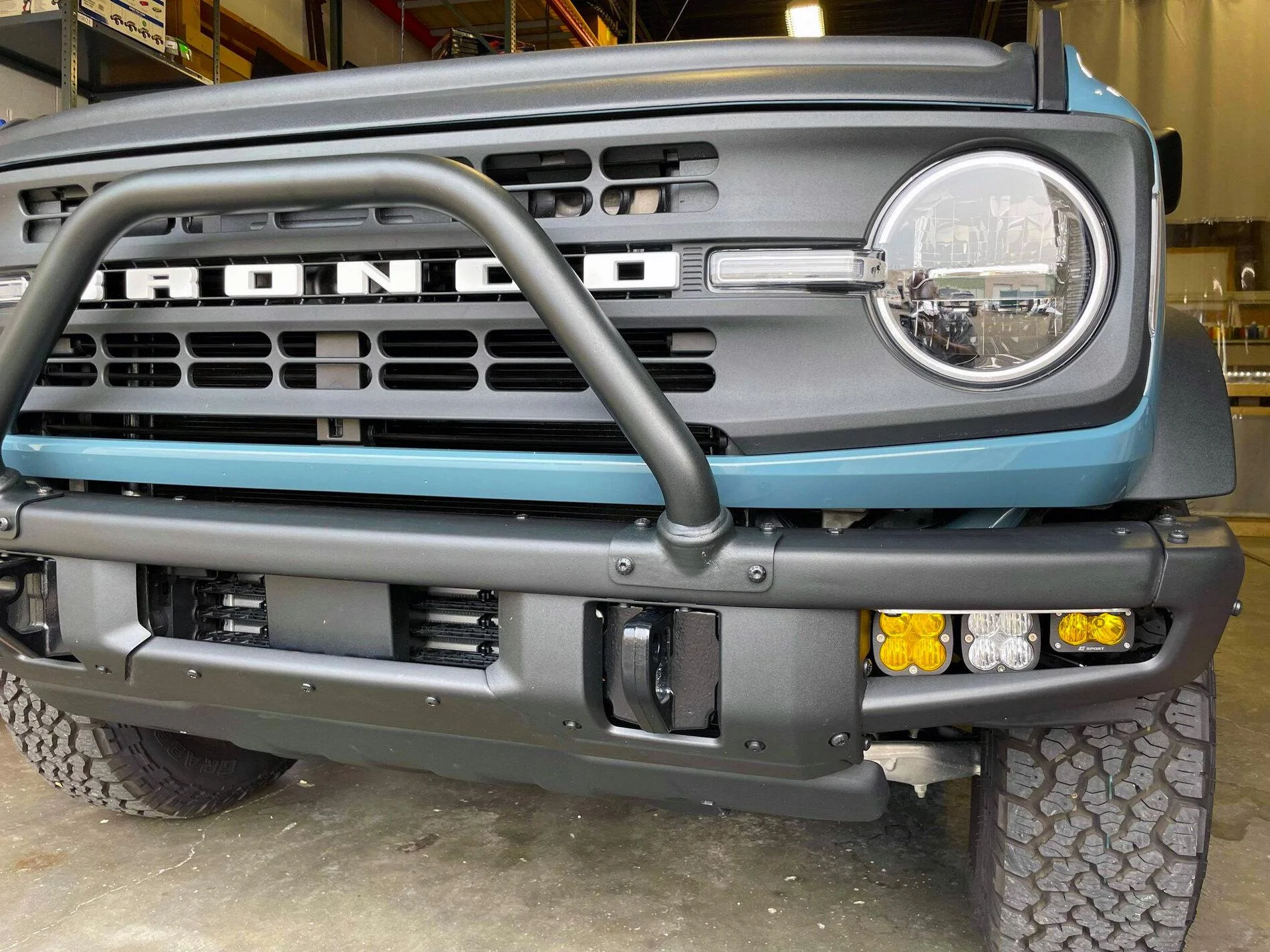

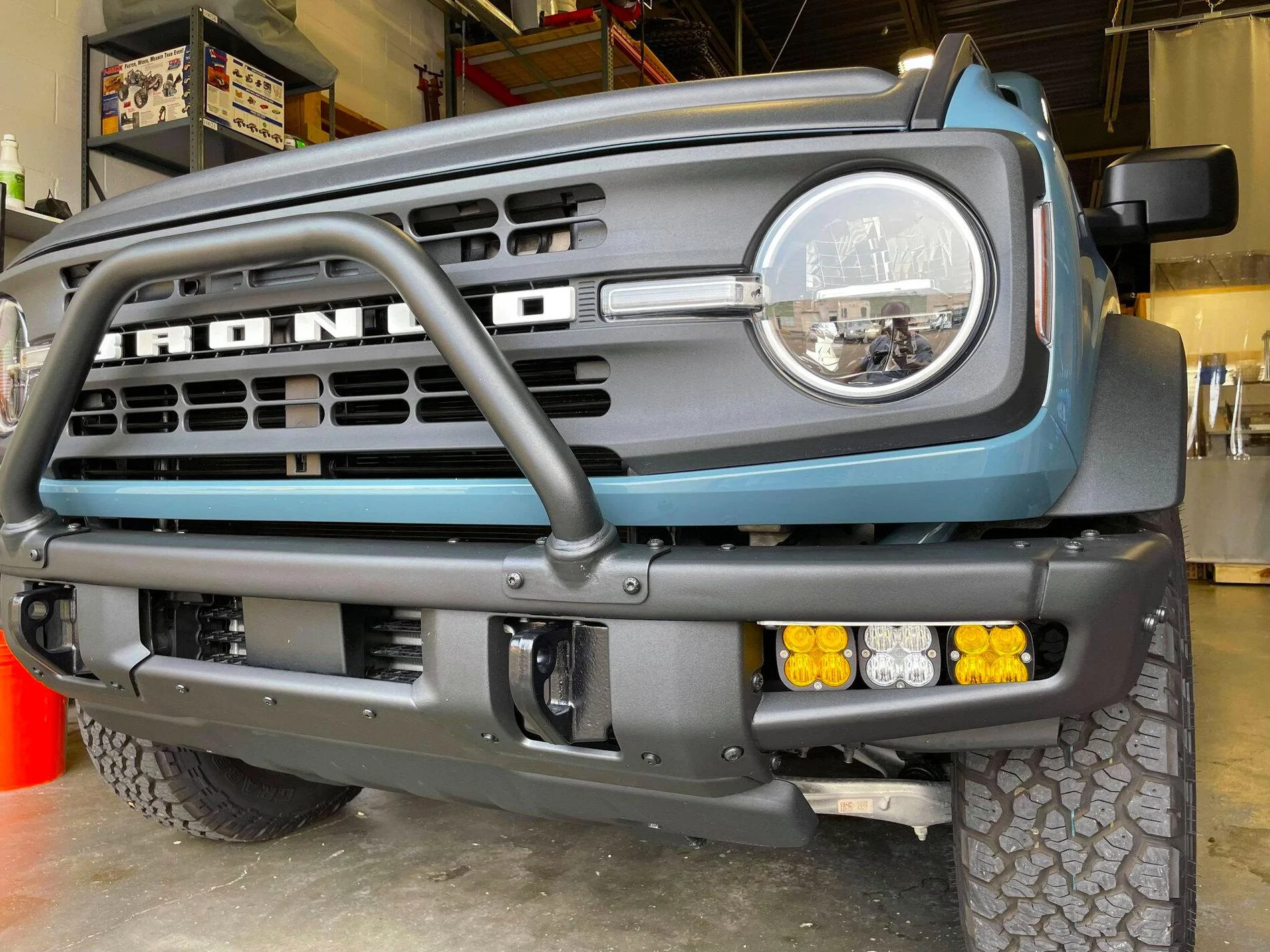

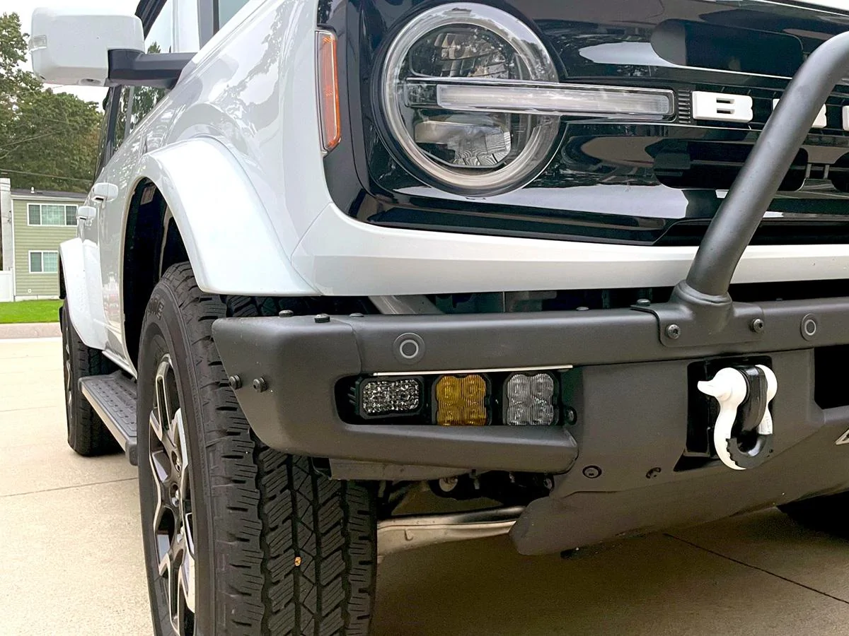

Here's some photos I took with our Triple Fog Light Kit. Keep in mind this again was a prototype bracket for the fogs, so the lights don't go all the way to the outer edge (the final design does, again because of 3D printing we only print part of the bracket to save time, which is why the lights are all bunched up together)
I’m more interested in this configuration of lights. Backwards from other pictures y’all have posted with the small light on the inside. It doesn’t look like the outside squadron is really blocked much at all.

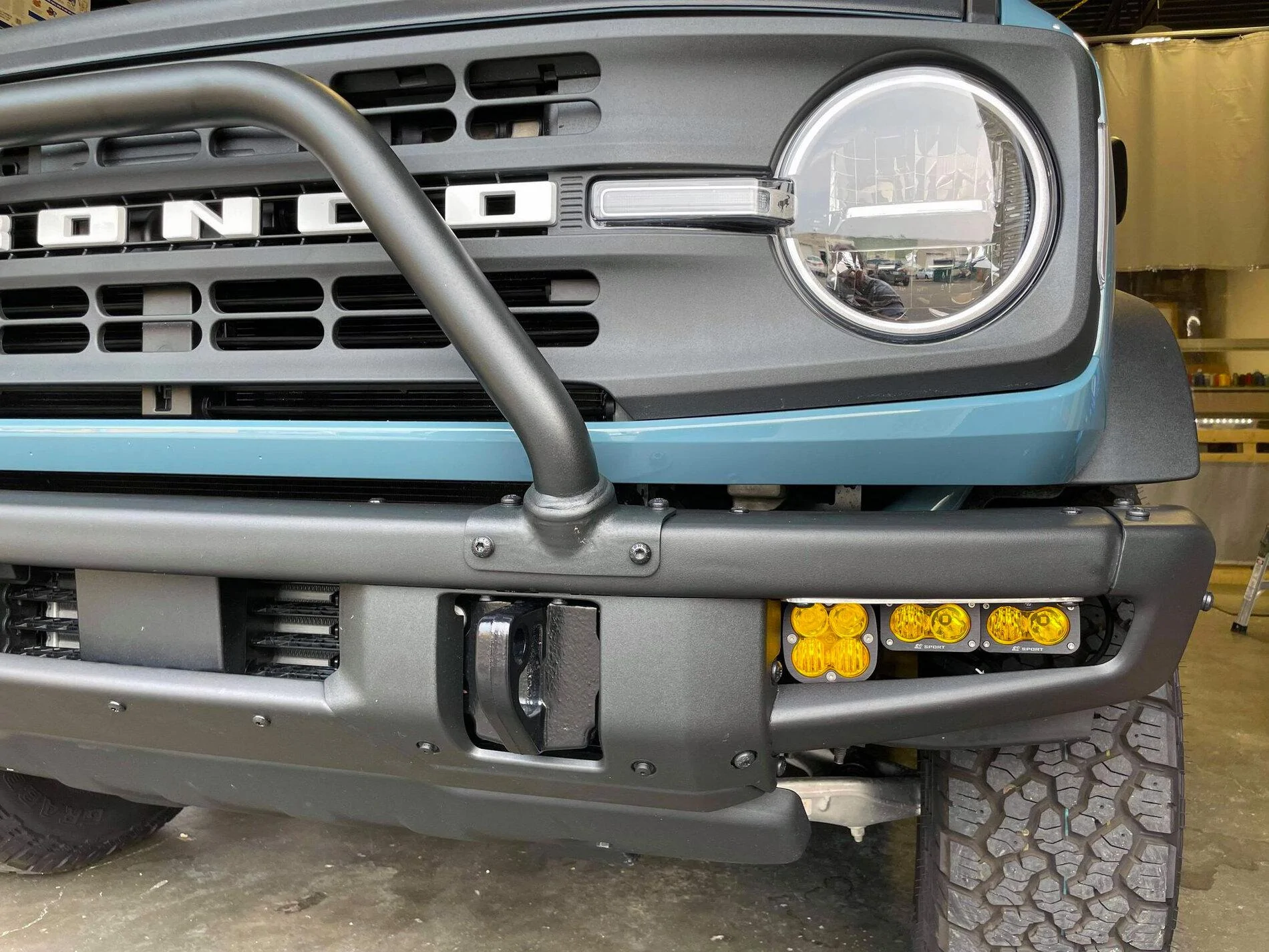

What you are seeing are our KR Off-Road brackets, with Baja Designs (and in some photos Diode Dymamics) lights mounted up. We have an in-house brand called KR Off-Road where we manufacture mounting brackets for lights (and some other doodads we find are necessary). Lifetime warranty, made in the USA, good stuff.
So those are available here actually: https://www.4x4truckleds.com/vehicle-specific/ford-bronco/2021-bronco/
Our brackets are VERY popular in the Raptor world, and now that the Broncos are starting to hit the market, we anticipate our brackets will be popular here. They allow you to mount pretty much any light up to them, and we don't force you into using certain lights. You can select any combination of sizes you want really. Here are some examples:

Yes, thanks! I’ve seen those brackets/packages. I just hadn’t seen any showing the S2’s on the inside of the group, and it caught my eye. It’s usually on the outside, like it is in the pics you just sent

Yeah that's why we developed these brackets. We wanted more options as to which lights and how you set them up. So you can pretty much design any fog kit you want.

try to bend it flush with the skid plate and see if the sensor still reads it.. I think it will be plenty readable with that angle....and all you'll need to do is bend them all...then make one with a bracket like a 74 tailgate plate has.. so you can flip it up if the police has an issue with it bent back....
