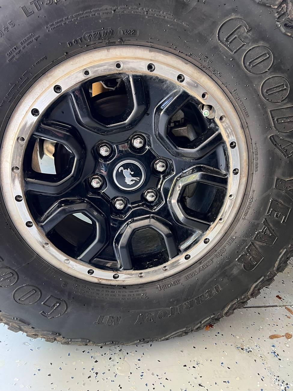

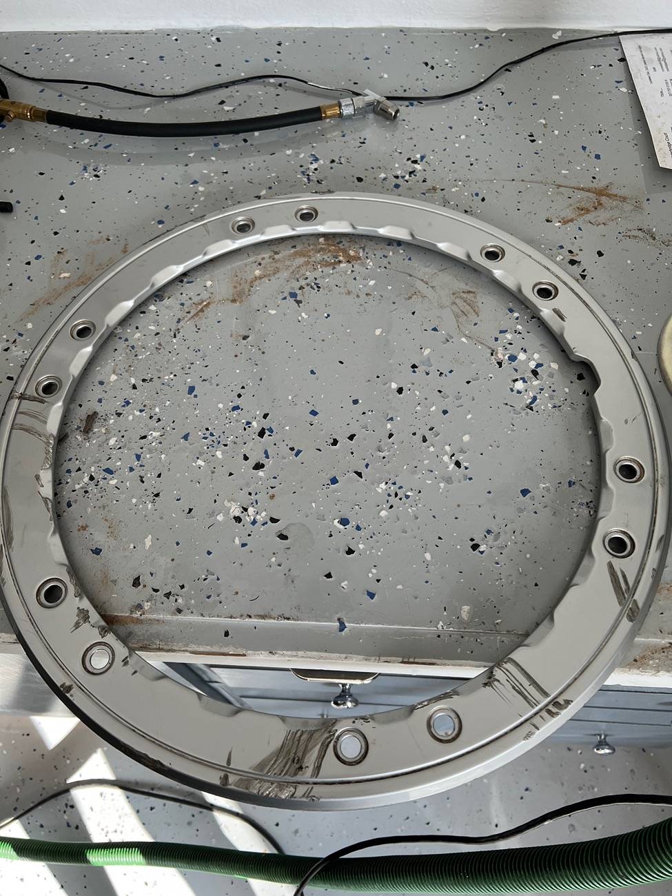

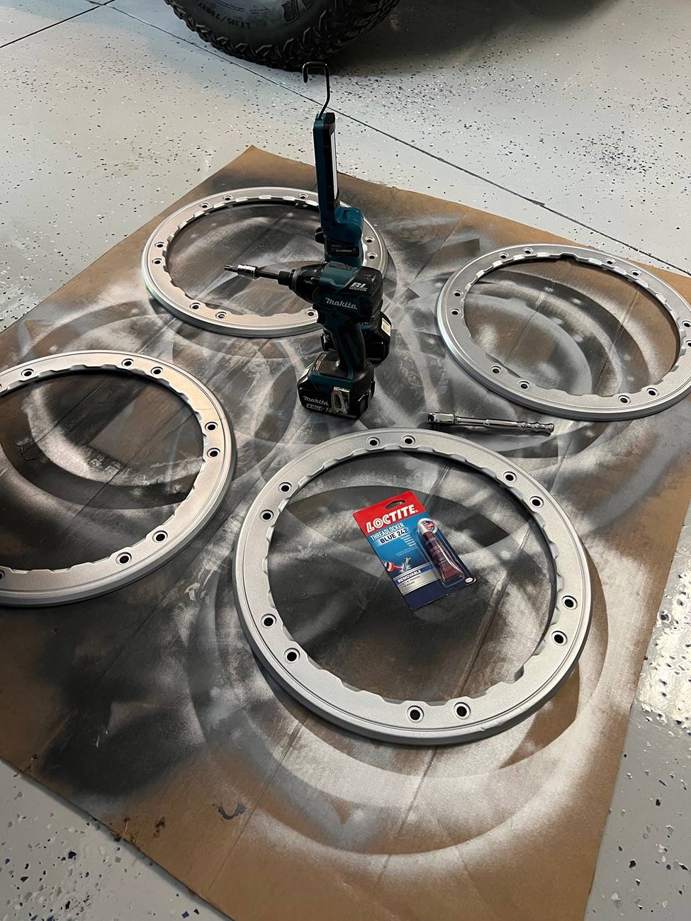

OP, welcome to the forum. They’re faux beadlock rings and easy to pull off and paint if scraped up by wheeling or to change the color. I’ve posted these pics before, but they’ll give you an idea of what I mean. If you look closely at my avatar pic, I’m in the process of scraping both passenger side rings.
