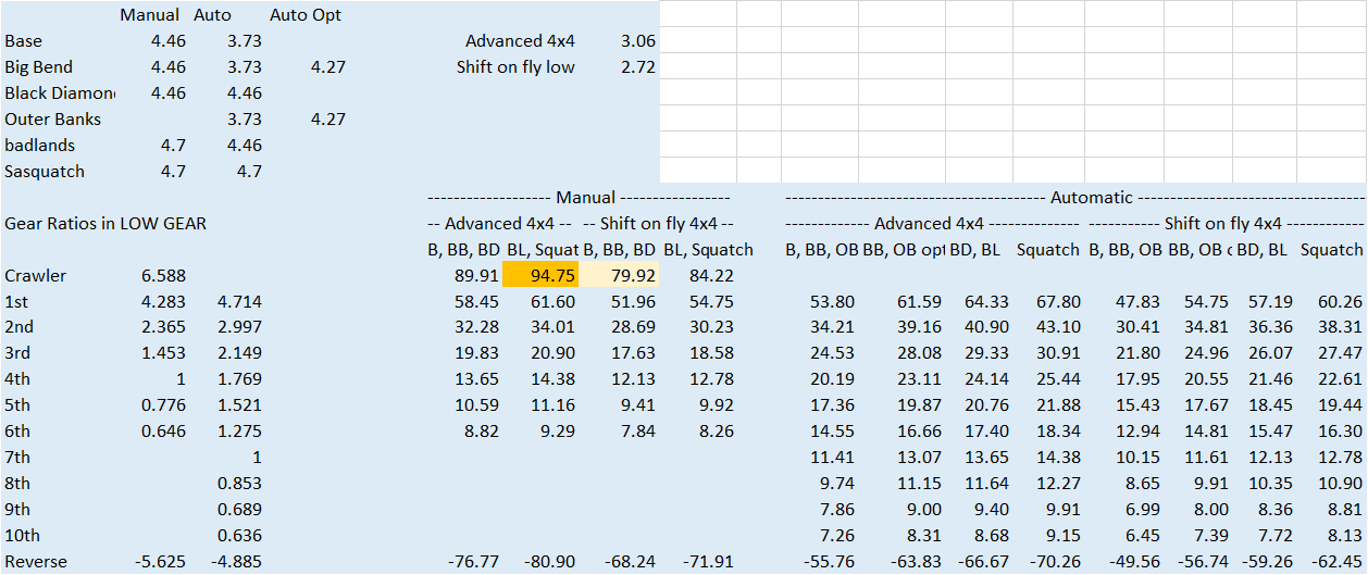

On kind a related issue...I'm going manual + Sasquatch but going back and forth on whether to add the Advanced 4x4. Sasquatch gives me the 4.7 gearing so no plus there. The 4A might be useful on snowy/icy/ rain slick roads but Slippery GOAT mode and sensible driving might make those situations ok.
Opinion/experiences...is Advanced 4x4 worth the expected $1000 on a Sasquatch equipped Bronco?
The Advanced 4X4 is what allows your Bronco to get the 95 94.something) crawl ratio.
If you go with the normal 4X4 the crawl ratio will be lower (story don’t know it off the top of my head).
Tale of the ratios, right here.
In a nut shell, you can buy a Mansquatch without the ATC, or a base 7M with the ATC, and wind up with nearly same effective crawl ratio.
ETA: 89.91 base w/7M + ATC
84.22 Mansquatch w/o ATC

Thanks..That's what has me considering putting the money toward other things like bumpers, winch, armor, seat covers.
