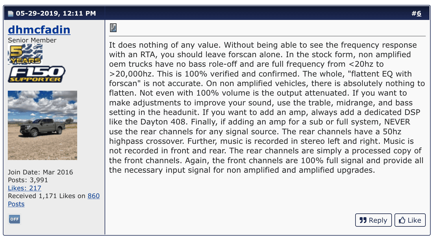

I found this comment on F150 Forum useful in regards to attempting alter the EQ:
Ford Bronco Base Audio Upgrade and Forscan 1637275973549
I'm inclined now to just leave things along back there, and I never intend to add a subwoofer so I doubt any of the more advanced changes are necessary. I am still on the fence on if I'm going to install the kick panel speakers.
Thank you for this. I’m thinking the Bronco could be setup similarly. The Pickens Party of 5 subwoofer install didn’t work well when they were connected to the rear speakers and then came alive when connected to the fronts. This makes a lot of sense if the rears are 50 hz high pass filtered.
Maybe I need to play with my basic eq settings or consider adding a sub. I just haven’t thought of a clean way to run the left and right front channels to a sub in the rear.
