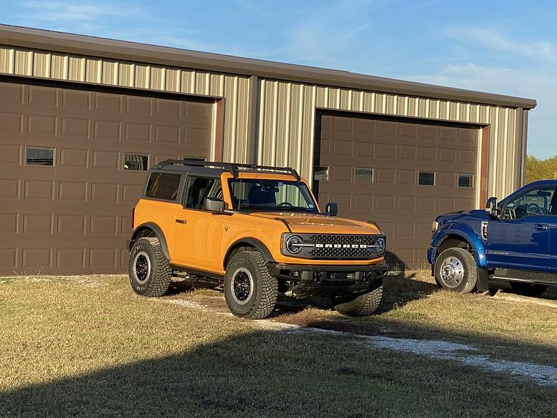

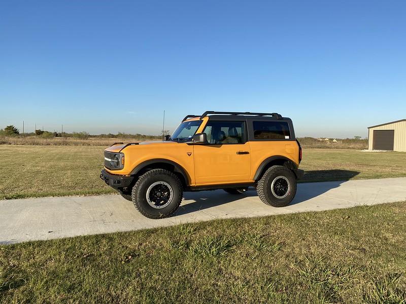

I have SAS takeoffs on my standard badlands now. In normal driving no clearance issues (once the crash bars are removed). Unless you are flexing heavy off road you may not need to do anything. I will try mine on the trails first before deciding to front level, or switch to SAS shocks and springs.
Nice Bronco. More jealous of that garage!!! The space!
