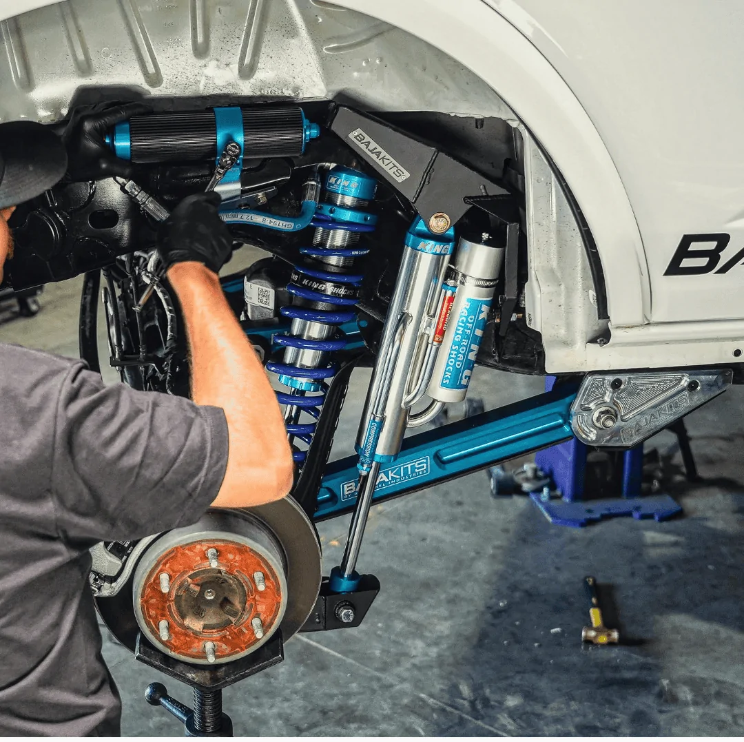

Sorry to disappoint, but a boxed lower control arm is the norm for a long travel kit. I'm not quite sure what kind of lower arm you were expecting?
It is fully boxed so it has a built in skidplate on the bottom. Many people install skidplates to the factory arms to essentially box in the factory arms. Thus eliminating bolts/flanges/cavities that rocks or debris can get stuck on, or in.

So maybe somebody who has an Instagram account can retrieve more info/pics but my friend sent me a picture of this. He said there are pictures of the prerunner kit parts as well.
Coilovers and bypass shocks. Also noticed they have new link pivots installed. I wonder if these are mounted further forward, thus allowing more travel.

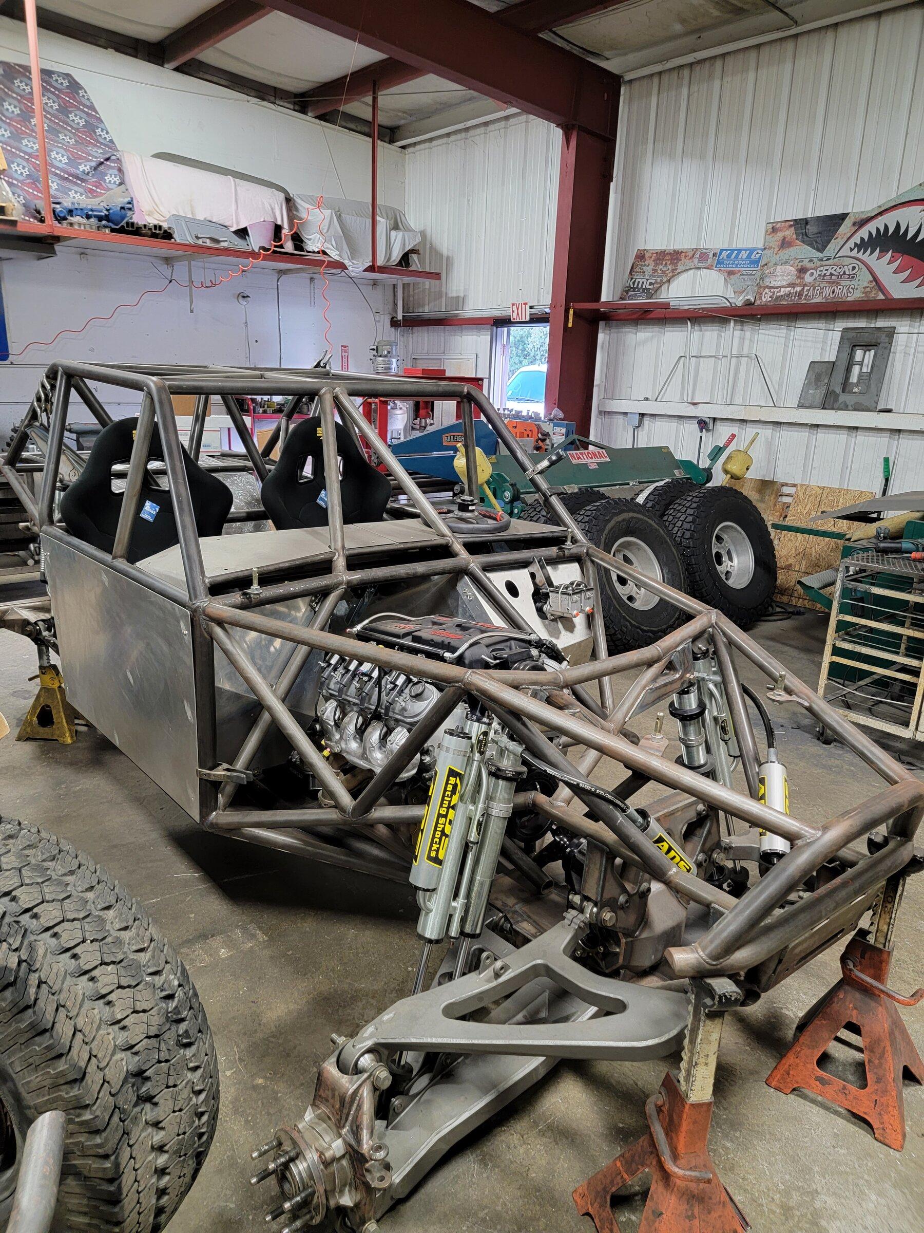

Dang so the boxed lower arms on my ultra4 car are going to hold me up on everything? Good to know! Lol
Nice J arms, who are they built by? Looks like fun.
ADS shocks ............................. I see they have r&d'ed some coilovers for the Bronc. 😁

I guess I should have checked their website first. They have pictures/prices of the prerunner kit, the rear bypass mounts, and billet pivot plates. Also they added fully boxed steel upper arms (stock width). Still doesn't give any info regarding the link pivot locations.
https://www.bajakits.com/c-1459200-...uck-suspension-ford-4wd-bronco-2021-html.html
stock pivot location reinforced with aluminum and a replaceable skid it seems.
the whole package is sick. Except it’s not because shocks aren’t available till 22. Bummer.
Damnnnnnnnnn!
Is that some injected LS iteration with a blower? I don’t know my LS(s) like that.
TT rack?
what is the front differential 9” or bigger?
what is the wheel travel?
congratulations on that setup, that is a dream many can never achieve. Sorry for the questions I’m living vicariously through you.

Lol, its a LS7 with heads and a cam and the msd intake with Holley terminator management. Howe TT rack and their new billet TT pump. Gearworks 10" 3rds, maximum transmission th400 and an atlas race case. Not sure on wheel travel numbers. I bought the chassis and shock package from Jimmy's 4x4 and am having a local shop finish it out.
