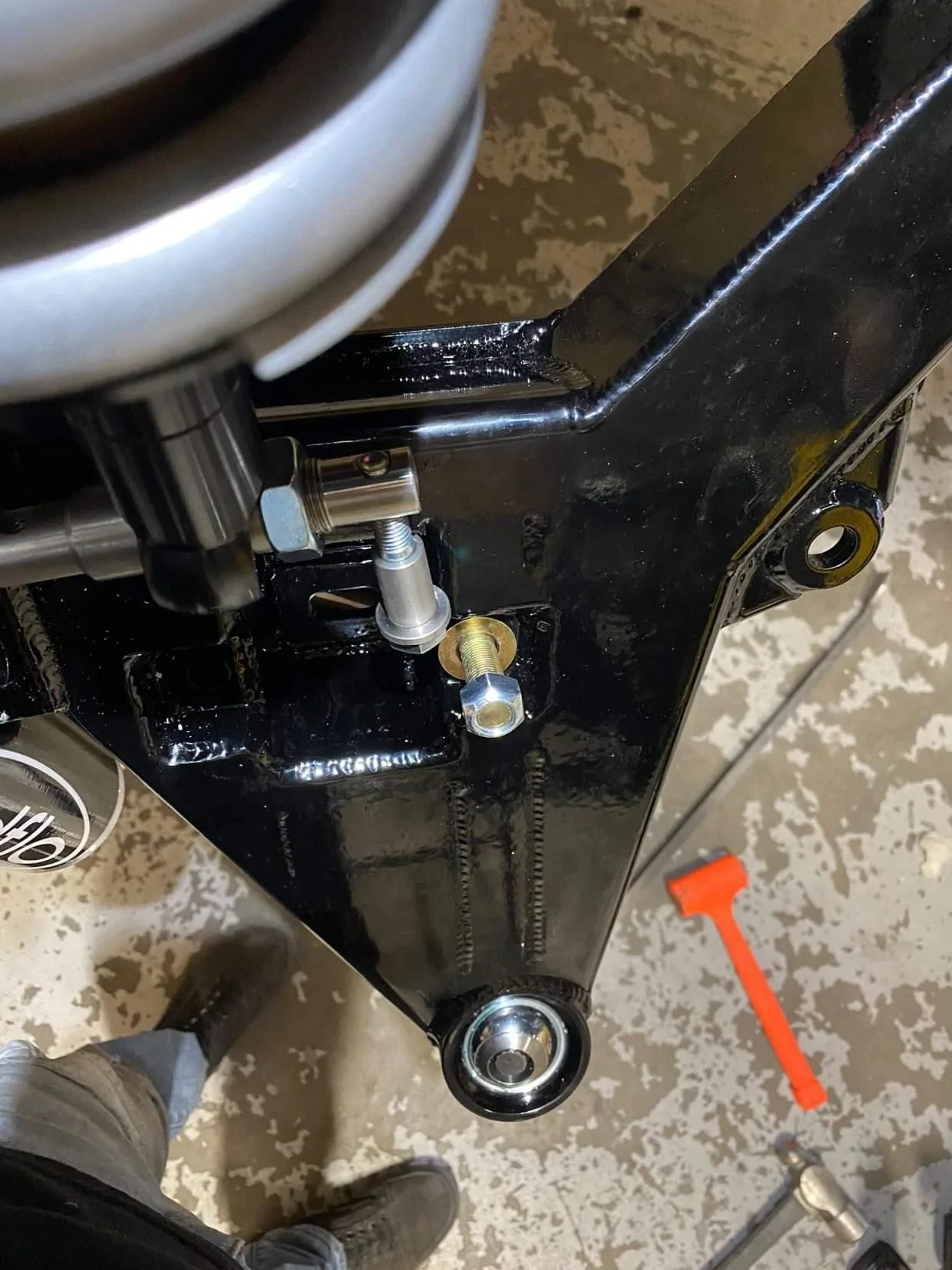

Finally got my baja kits in. And we started installing but just noticed a big problem. Anyone know where I can get different bottom sleaves that will work here. The ones that came with radflo are round with a smaller nut. Need some flat ended sleaves to work. Any suggestions are appreciated
Ford Bronco Baja kits long arm kit with Radflos IMG_20220919_190723_774

Did you ever get this figured out? I’m looking at doing the Radflo with Baja kits
Yes we had to go to a machine shop to make some custom sleaves for longer bolts basically. Has held up perfectly.
