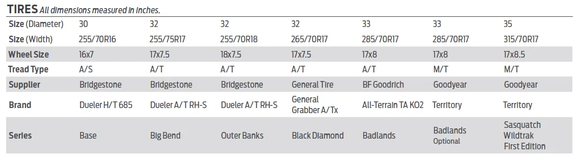

Why is it that you cannot put 35" tires on the standard BL wheels? This is news to me.
Rick, typically a 285/70R17 tire will be on a 7.5"-8.0" wide wheel, while the 315/70R17 tires are typically on 8.0"-8.5" wheels. However, relooking at the Bronco specs, below, the 285 shows to be on an 8" wheel so you may be fine, just check the tire you want to buy for the rim range to see if they are okay on an 8" wheel.
This is a good resource I use, select any 35" tire and look at what the rim range that is allowed for each.
https://tiresize.com/tiresizes/35-inch-tires/
Here are some KO2 examples:
285/70R17
https://www.tirerack.com/tires/tires.jsp?tireMake=BFGoodrich&tireModel=All-Terrain+T/A+KO2&partnum=87R7KO2RWL
Rim Width Range 7.5-9"
315/70R17
https://www.tirerack.com/tires/tires.jsp?tireMake=BFGoodrich&tireModel=All-Terrain+T/A+KO2&partnum=17SR7KO2V2
Rim Width Range 8-11"

Thanks for the detailed info, offroad tires are new to me where fitting track tires is old habit.. I had recalled that the standard Badlands wheel was the same size as Squatch (in width/diameter, still don't know offset) so I figured the 35" tires would fit just fine barring offset irregularities. Glad that is clarified to be the case with simple limitations of offset and tire spec.
Although if I was going to get offroad-specific wheel set to swap in/out for those days, steelies would be preferable for their ability to be repaired in the field as opposed to forged/cast.
