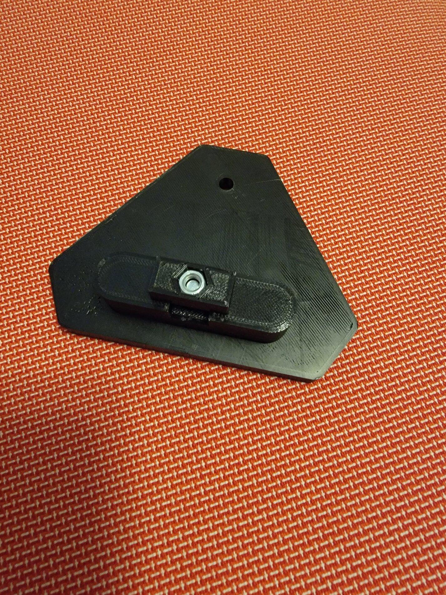

Kit will require (2) M5x30 cap head screws and (2) M5 nuts. I recommend using threadlocker on the screws to ensure they don't vibrate loose.
Assemble the kit by inserting nuts into the small locking bars. A dab of hot glue will keep the nut in place, just thread the screw in first to keep glue out of the threads!
Now put the screws through the holes of the badge plate. Push the grill inserts over the screws with the cut outs facing the rear. Then thread the locking bars on but not tight. Completed assembly should look like the image below but with both pieces assembled.
Next find the right spot on your grill! With the the inserts in the grill, spin the screws 90* and then use a screw driver, magnet, or similar to pull the screw head forward. With the screw pulled forward starting tightening the screw. Be careful not to over-tighten, remember these are plastic parts tightening onto a plastic grill.
With the badge relocation kit properly affixed to the grill, give it a wipe with alcohol and then adhere the badge. I recommend a spray adhesive to help the badge adhere to the rough texture of the 3D printed surface. That's it!

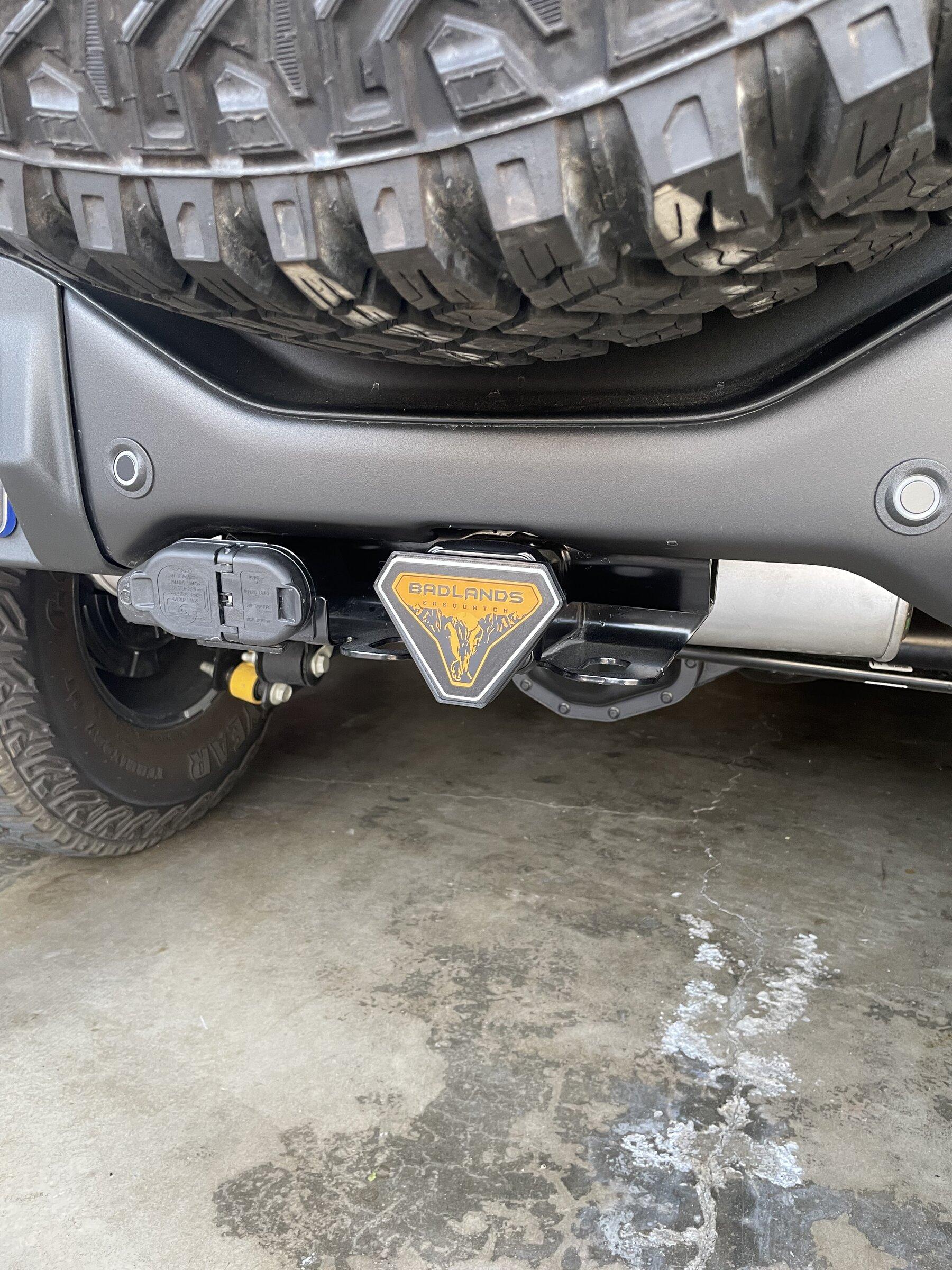

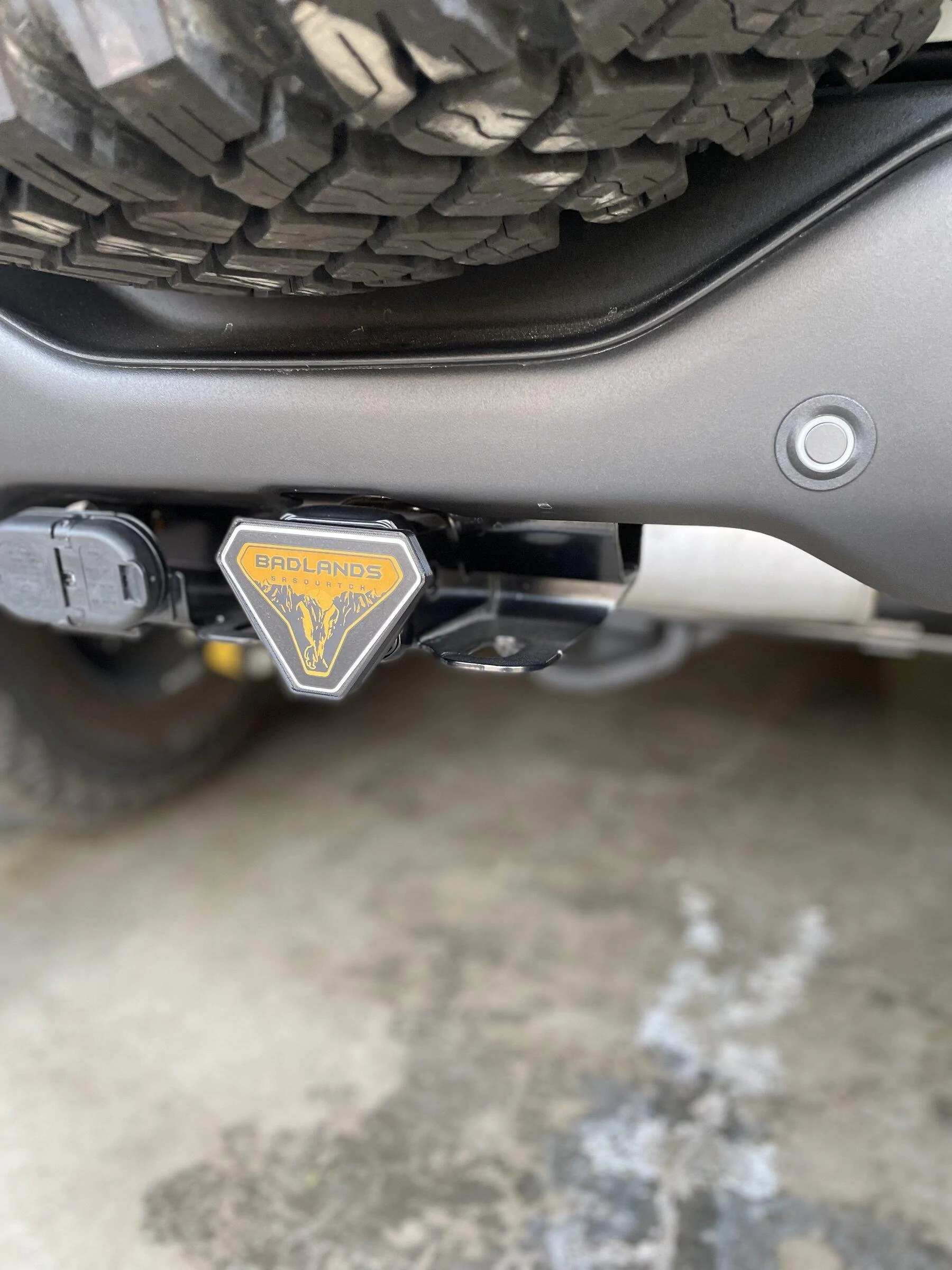

Really like how you added it as a tow hitch cover. Makes me wish I would have gotten the tow package just so I could copy this.!

Is there a hitch cover kit available?
The trailer hitch idea was @jedmisten. He used a hitch plug he already owned and attached my plate to it.
I'm not currently selling a kit for the trailer hitch and don't have plans on doing so. The time and cost to make the part that fits into the trailer hitch doesn't make sense for me to make.
If you'd like to do the same as jedmisten, generic hitch plugs are relatively inexpensive and I love to see people come up with new ideas.
It’s pretty simple to attach the relocation badge kit to a pre-existing tow hitch cover. I had a circular tow hitch cover that I cut using a Dremel to match the relocation kit size. Drilled some holes and attached it with the correct nut and bolt.
