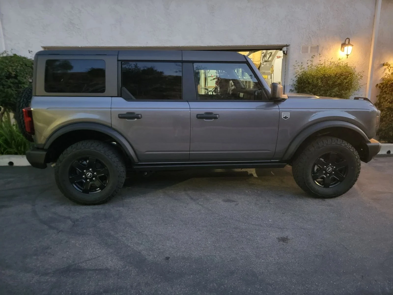

Hi everyone - I am looking for folks with similar rig to provide input for boosting capability of this version. For reference I sold my 2010 Jeep Sport (2.5" lift, 33s, on 3.73 gearing, no lockers) to get a bronco. I was part of a jeep club years ago and did quite a bit of off-roading in the desert and sierras and never felt like I needed any mods. I am not interested in doing extreme trails for fun but would like it to have a solid range of off road capability.
This build is a daily driver and will spend most of the time on road. That said I do get in the off-road back country here in SoCal and Sierras mainly to camp, hike, and explore cool new places that 4x4s offer. I want to boost its capability to fit these parameters.
Current Stats
2025 Big Bend 4dr
2.3l - 10 speed Auto
3.73 gearing - No Lockers
Wheels are BD pulloffs 265/70r17
Installed pull-off rock sliders
I have 8k to spend to boost its capability. Here are some of my preliminary thoughts.
I will likely use 4WP since it is right down the street.
Initial Priority:
- Undercarriage protection (Ford, RCI, ARB???)
- 33" Tires (285/70/r17) and Black Rhino Chamber Wheels
- 1" - 2" lift
Additional thoughts that I know nothing about cost vs effectiveness
- RockJock's Front Antirock Sway Bar
- Rear Air locker
- Re-gear both axles
- 35" tire / Wheel set-up (Light weight)
Please make recommendations if you have some good solid experience. I really appreciate your time and feedback.

So I decided to start with new wheels and 33x10.5 17 tires + just bought the complete Ford Skid set. I will have to mod the front since I don't have the modular bumper that is fits with. Looks like I will be cutting some steel.
