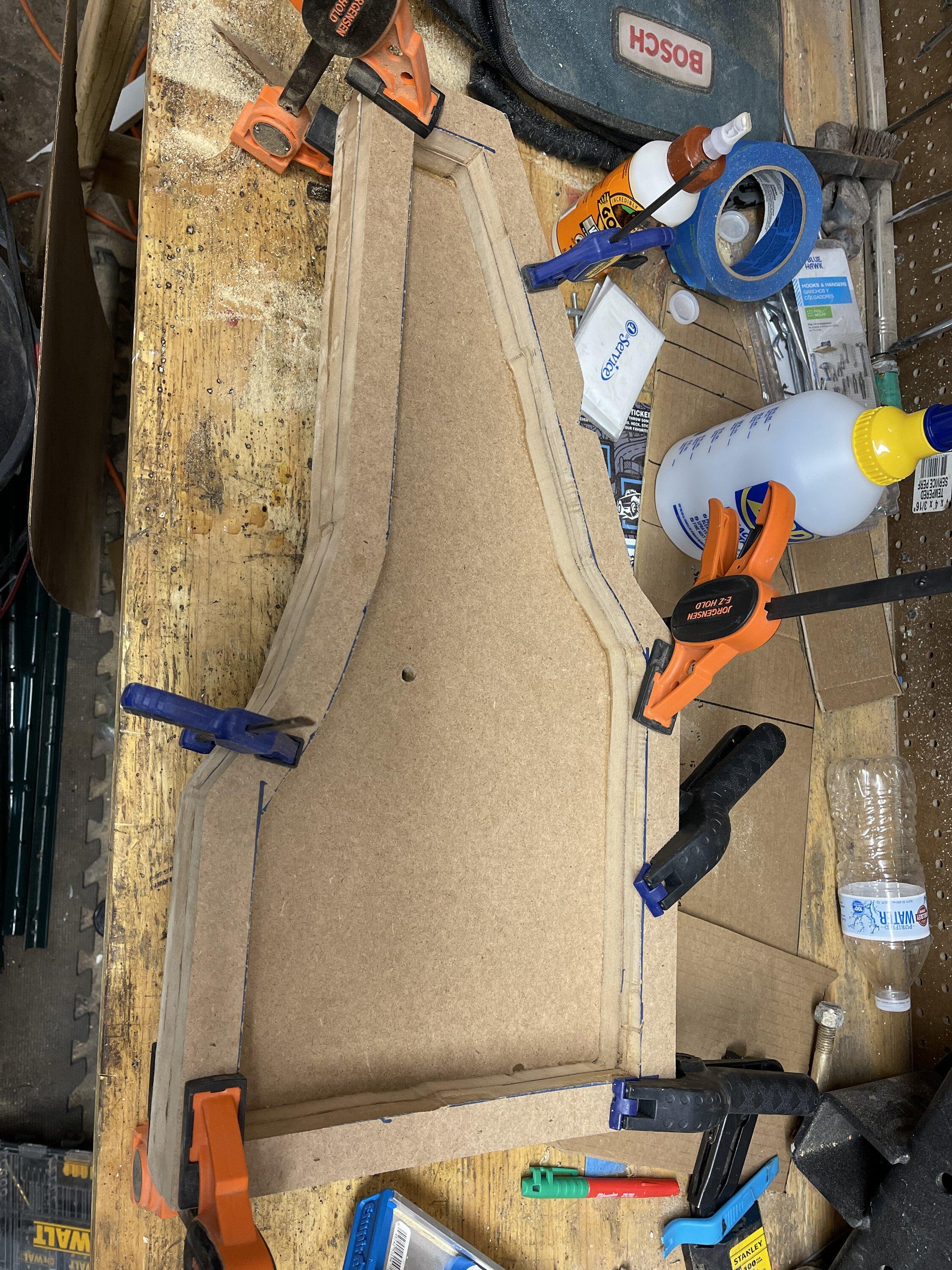

https://srqcustoms.com/product/ford-bronco-subwoofer-enclosure-with-grille/
I have to say, this is very tempting. Seeing as how I did not opt'd in for the B/O sound system...
I am a fan of this. But not 600$. Just by looking at it its extremely easy to build!?
Materials:
Amazon MDF sheets 5x15 are 14.99 or home depot 4ft by 8ft 50$
the sub ( 8” Kicker L7T subwoofer ) 179$
Metra connector 3.99
poly fill 5$
Wood glue/ nails 10$
Optional: killmat 60$
Take off the plastic, cut out the tray (if no B&O)
Cardboard template,
Use carboard to get the first MDF made using a jig saw, then copy that like 3/4 times keep one full the rest hollow out.
Another template (pictures show the next 3/4 MDF are different width)
Speaker terminal far left side facing toward seats (easier to run wire)
add razzle dazzle by using Killmat inside the box.
Dry fit all pieces
Wood glue and nailer
For sub mounting, id install the box put plastic over, mark where the old tray used to be, then using the template included with sub center and route/cut that out.
Polyfill, connect wires
Box is complete then connect your amp to the box reinstall everything.
Thinking out loud and wanting all my things to be flush, you could alter the left side of the box and mount a amp there also. I would be willing to make this myself...... I curse you now.. cuz im going to do this 😂

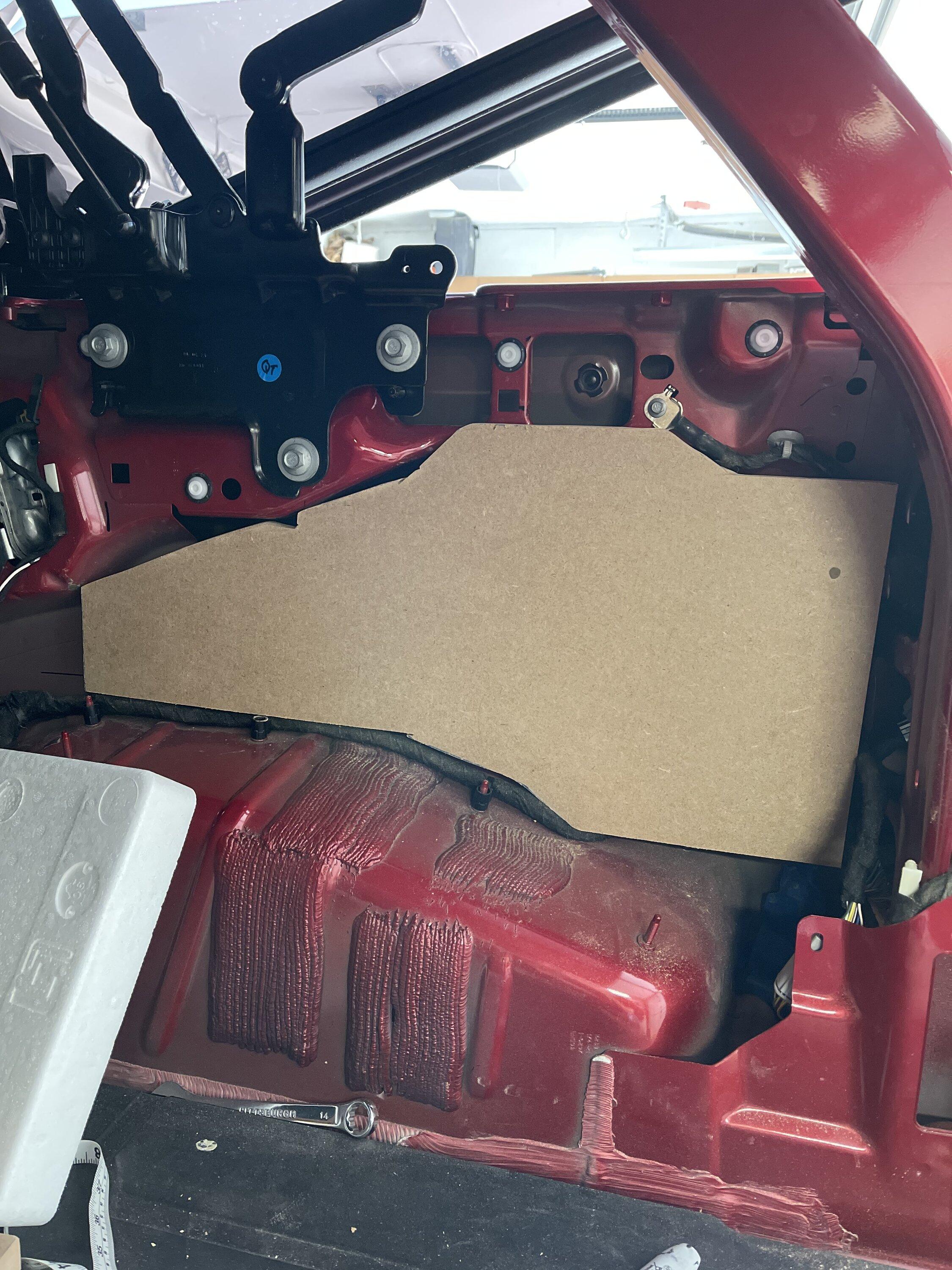

Well, I finally had two days to really dig into this build. I'm only 50$ in. I have most materials. I, like you, am not a professional wood worker/ or builder. I don't even think I qualify To be an amateur. It's still a work in progress but this is what I got so far. I have a video being made also.
Ford Bronco B&O Sub only upgrade? F9F04D90-9754-4413-A1A4-109E7CC8D082
Ford Bronco B&O Sub only upgrade? 686A03C3-DBE5-4492-B840-FB2CB75F6ECB
The trim removal was easy, just go slow. I hope to have it done in the next day or two. The hardest part so far was making the template.
