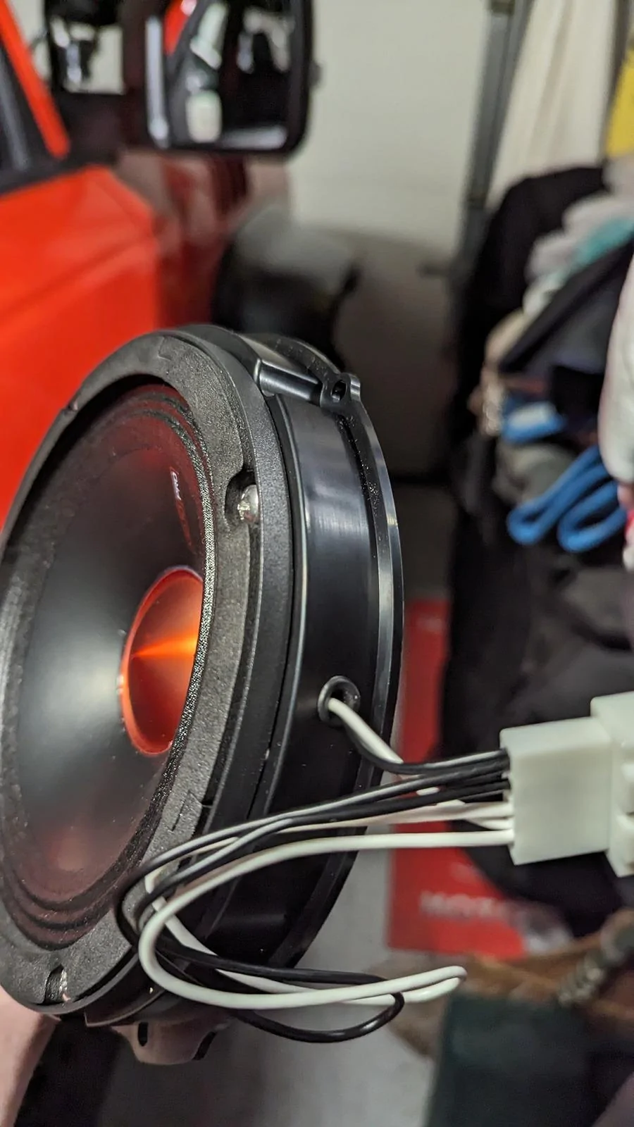

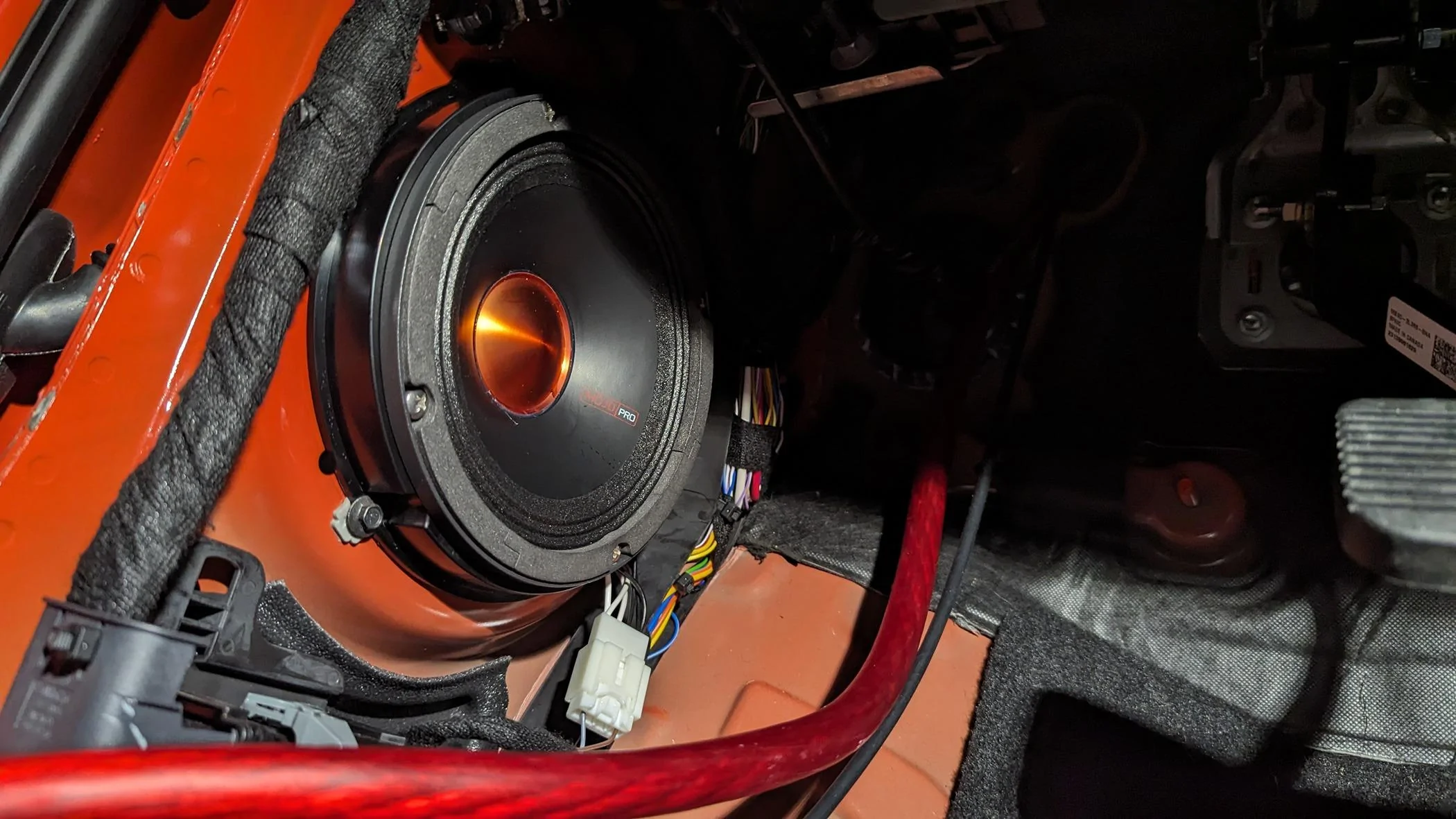

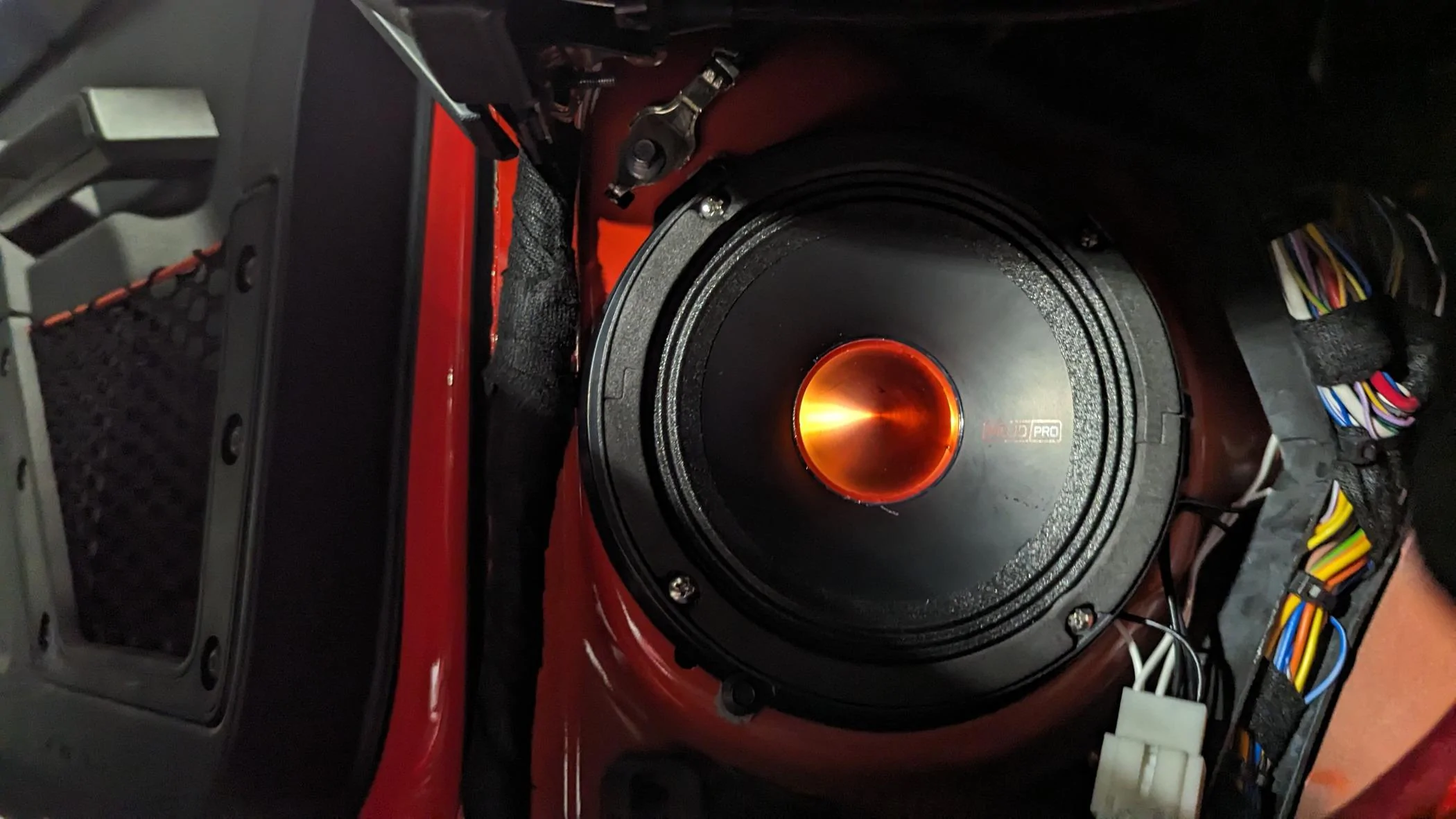

I completed my upgrade with the Memphis MPJ6 speakers for my kick panels - no amp needed these things are great 100db efficiency rating. Need the metra mounting adapters and if you are wiring to factory harness - those also - you will need to drill a hole in the mounting adapter to get the wires inside - for some reason Ford opted for an external wiring adapter on these.
Recap = Infinity Reference 407F speakers all around, Memphis MJP6 in kick panels and Kicker Comp R 8" with a kicker Key 500.1 for the sub. Very happy with the results. maybe $1k all in - self install.

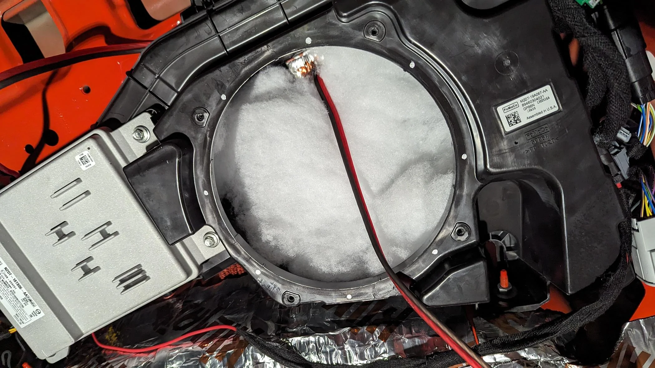

I want to only replace the speakers and poly fill the stock sub enclosure on my 2 door.

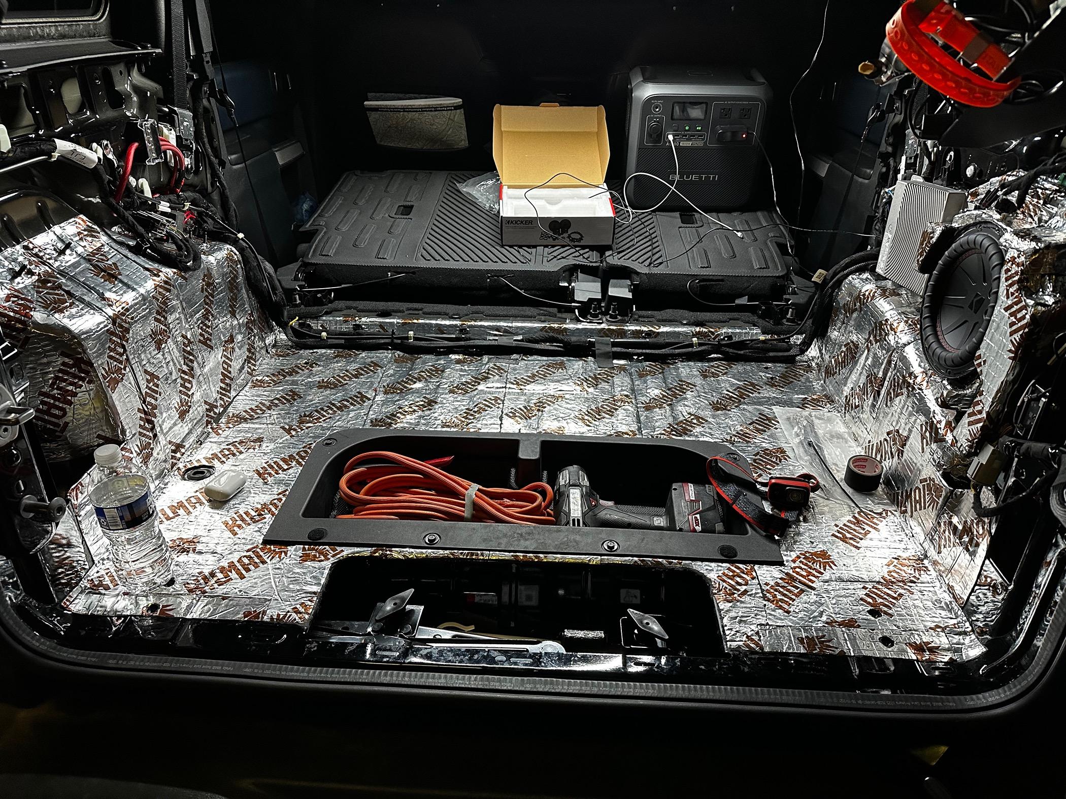

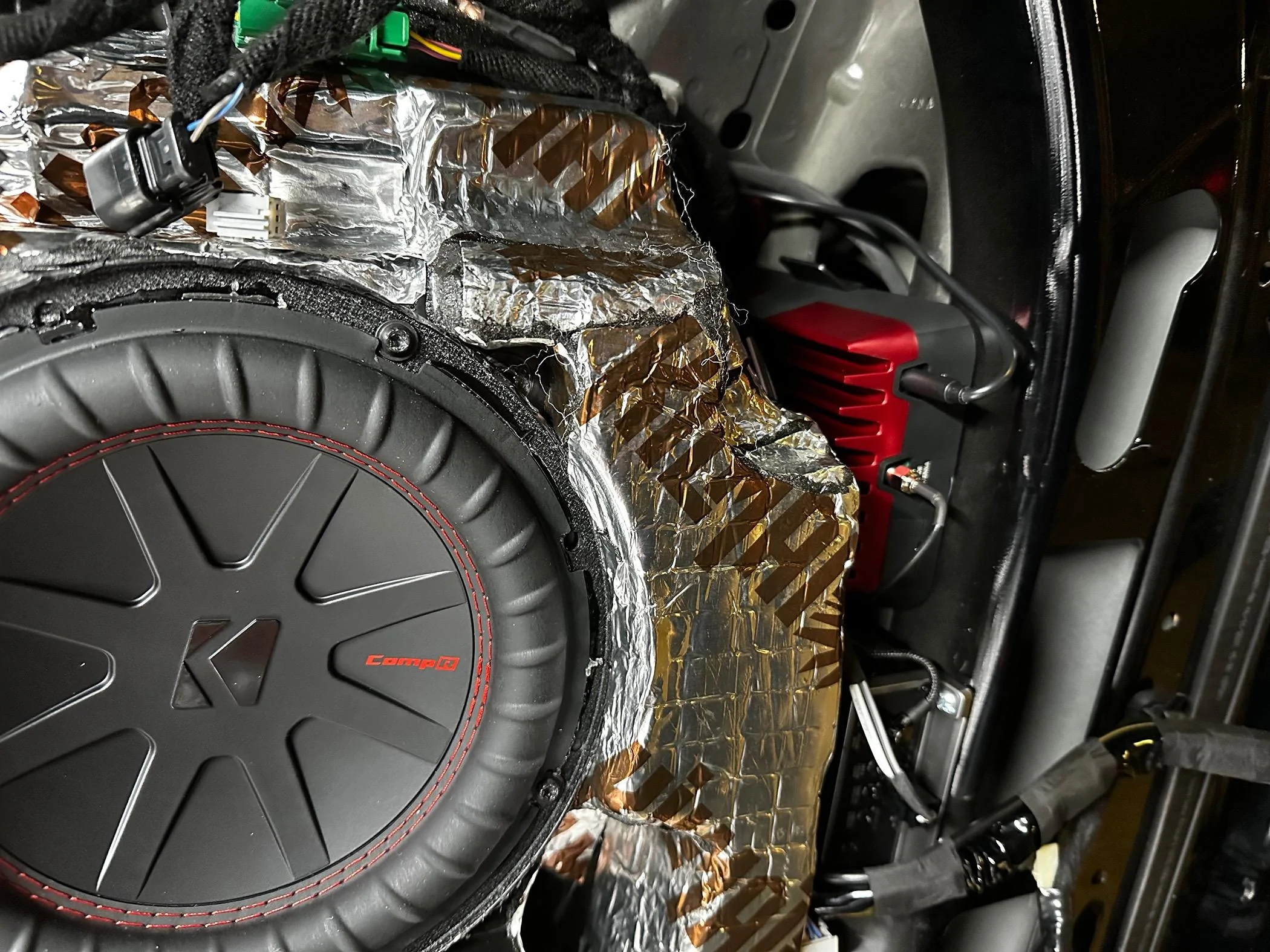

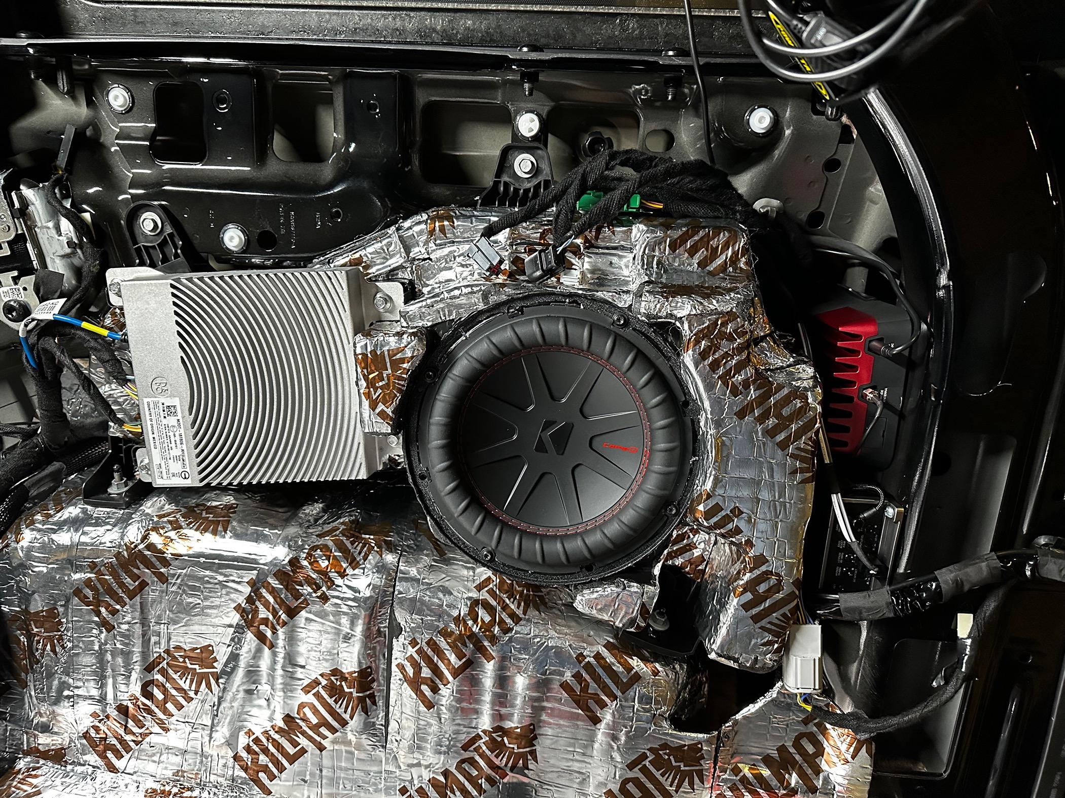

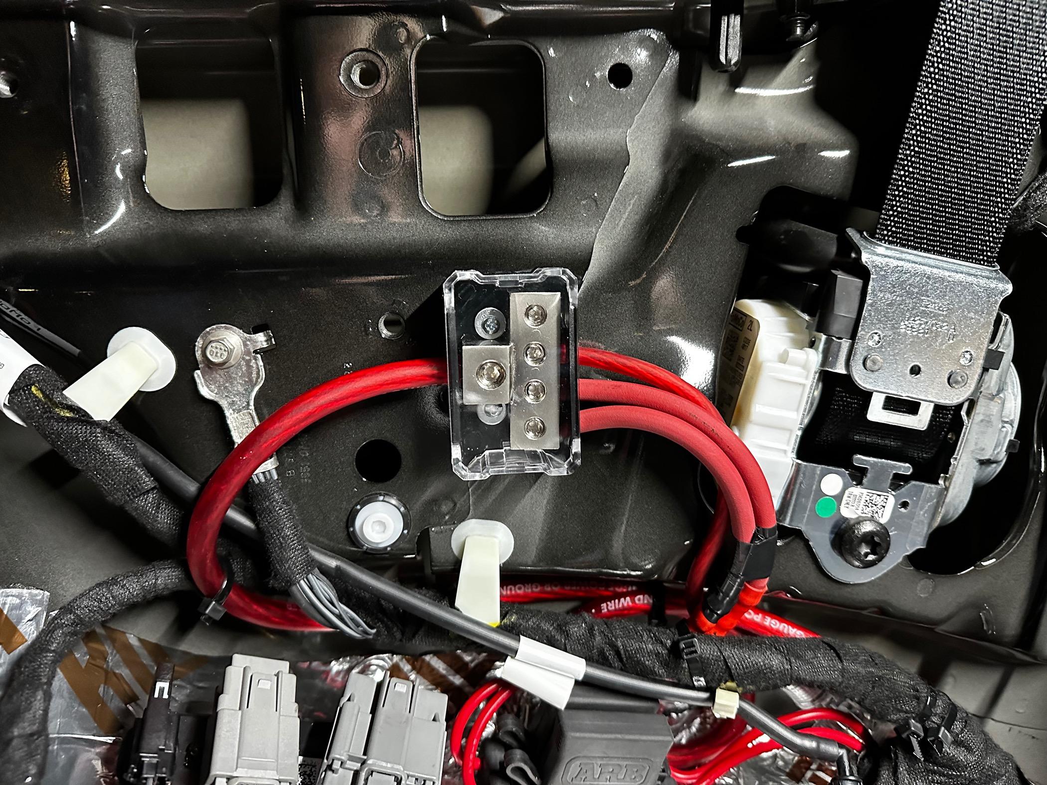

This ended up being a hellacious install. Probably took me 25hrs because I ended up having to pull out my old wiring for my compressor, and remove my tailgate reinforcement and tailgate table to get the new wiring to my compressor as well as the coaxial through the tailgate for the WeBoost antenna. But everything turned out very well and it is all nicely hidden away maintaining a stock look.
I'm going to have to shift the distributor block slightly left because it's blocking the bottom right tab for the little rectangle piece that you can pop out from the plastic panel. So it won't fit flush. You can also see that I was able to barely fit the WeBoost on top of the Kicker Key amp. So that suggestion worked out great!
The sub sounds fantastic and is an obvious improvement. I honestly would say that if you have been reasonably happy with the B&O, you could probably do just to amp/sub upgrade and be totally fine. I will probably still play with some options for other speakers though when time allows. I ran the gain and wave setup on the amp and adjusted crossover based on feedback from this thread and everything sounded fine to me. A bit of distortion once you cross 19/20 volume level.

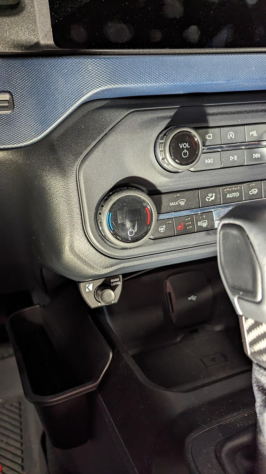

The one thing I can't solve is that it doesn't seem that the volume knob for the sub we've all installed actually has any affect. The sub volume doesn't seem to go up or down when adjusting the knob. So I may not have something correct. Any feedback on that would be helpful.
Thanks again to OP!
As an addendum, I ended up ordering a second box of Kilmat and have over half the sheets left. If anyone is interested in buying some additional Kilmat, just shoot me a PM.

The volume knob should have immediate obvious affect. I would double check all the plugs and make sure they are fully inserted. I seem to remember the plug on the knob itself taking a bit of force to fully seat.
Thanks! I'll double check those connections because atm it is neither immediate or obvious. :p

Mine is set for bass heavy songs around 11:00 and for those that have a weaker bass line or recording level - up to maybe 2:00. And even within that narrow range it is VERY noticeable. Take a pic of your crossover, gain and and button settings - maybe that will help one of us pinpoint something.
I just put the panel back on last night before I saw this. 🤦‍♂️ I did check the connection at the amp and at the knob, and both were tight. But I still need to get under the dash and make sure it's not where the extension cable is connected.
Its working. I did not have a chance to listen last night after I checked the connections at the amp and knob. But checked running some errands today and it’s working. 👍

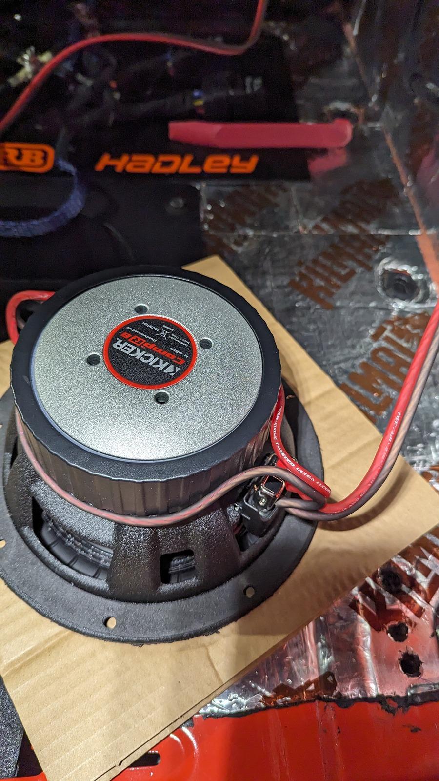

@silentd74 - What was the RMS rating on your sub ? I see several posts where people seem to be using the Kicker Key 500.1 on the tailgate subwoofers which are rates at 400 RMS. I am looking at the MTI Acoustic with the JL10TW3-D4 as a possible option. I like the idea of the 500 as its small and can fit close to the rollbar in the back - I do wonder if I am going to under power it though.....

My Kicker Solobaric 12 (shallow) is 300W RMS per coil, 600W RMS total. The KEY500 is a great match. I do wish I had (2) 12s at times but that's in part because I have (2) Kicker CompR 12s in my Edge ST running on 1000W RMS at 2ohm in a slot ported box. Totally different animal but also a B&O add-on scenario with an AudioControl LC2i Pro for signal.
I wish Kicker made a KEY1000. I have power to run a second KEY500 though as I ran 4ga.
