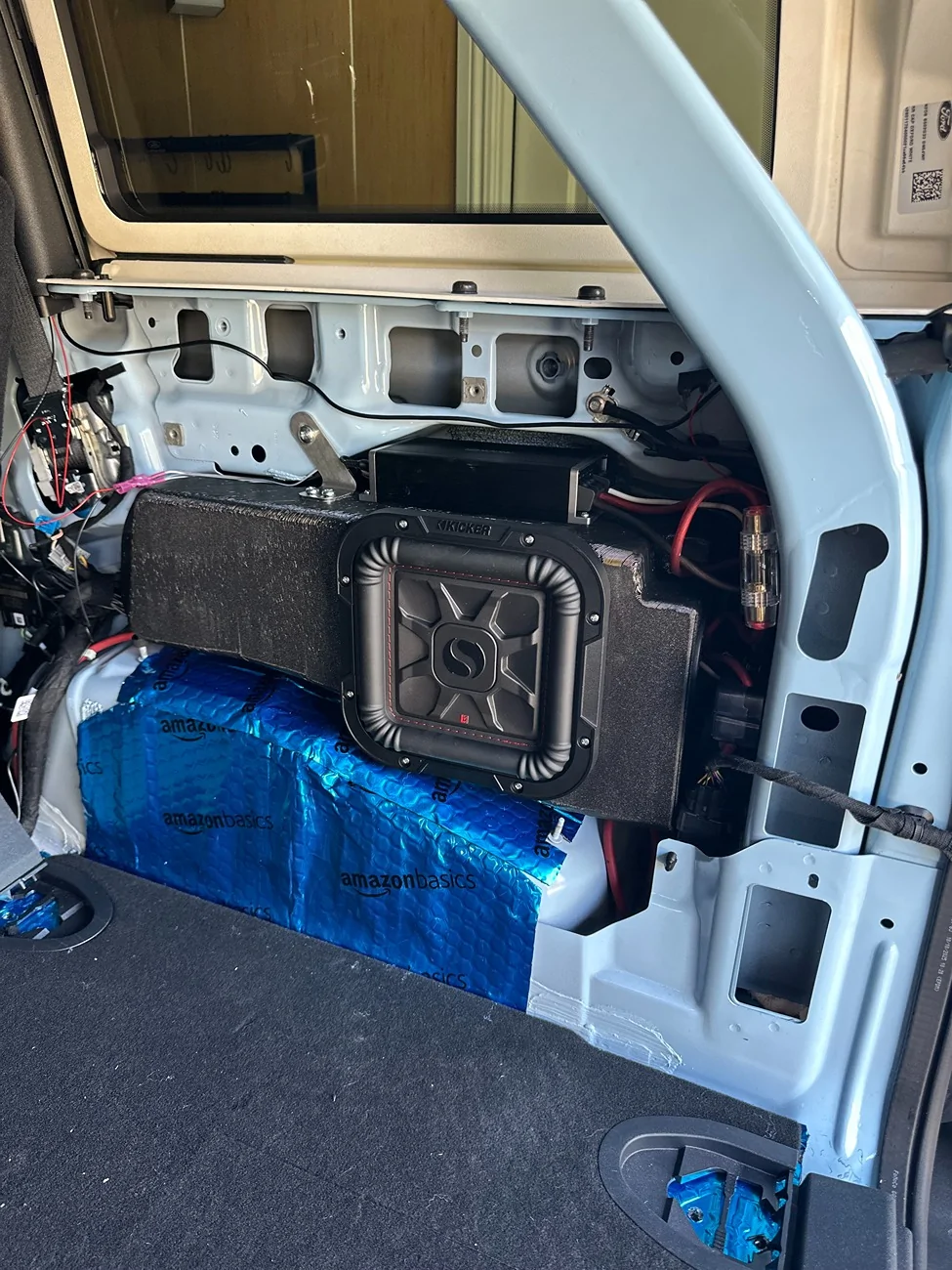

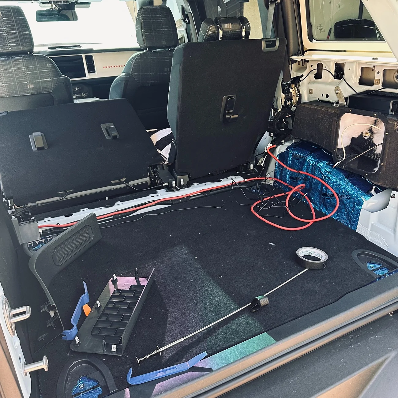

--I just added the GearShade box with 8"square Kicker and 500.1, and it definitely made a difference from my stock 7 speaker (non B&O) system. Will you win speaker competitions? No, but it's balanced and can overpower the Memphis mids and Alpine coax tweeters I put in the dash.

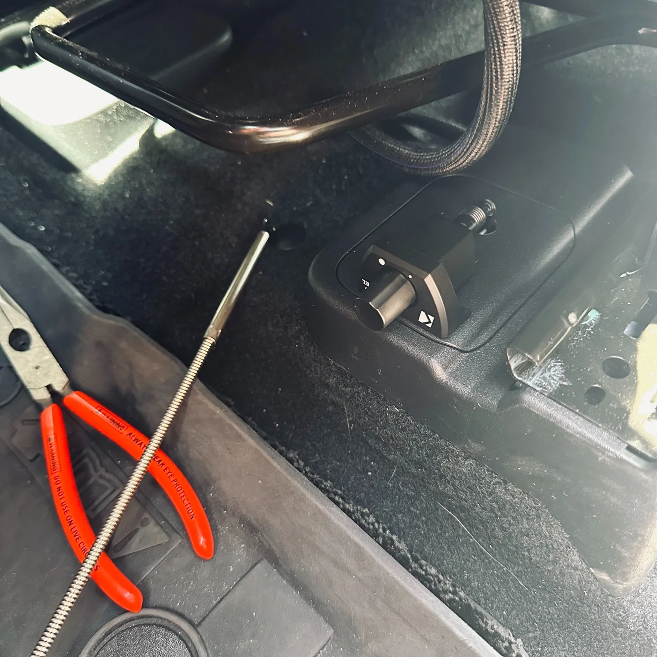

I can't speak to your dash system as it's got an extra speaker. With the Kicker 200.4, bi-amped, I did get a little clipping at sound levels that I'd never listen to anyway so I never added a LOC to fix. BTW, power was routed down the driver's side by the frame and then up through the drain hole by the passenger door sill.
