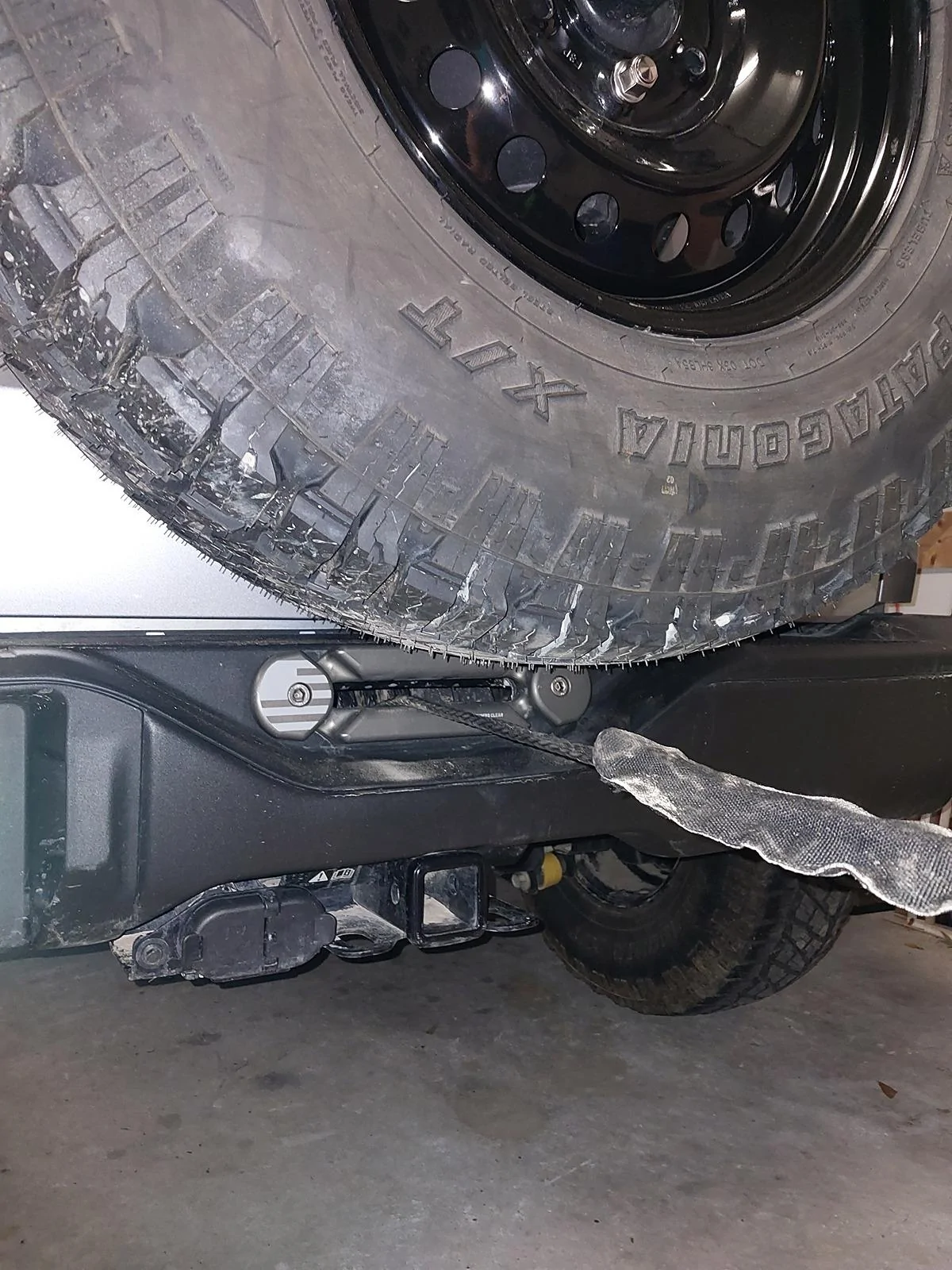

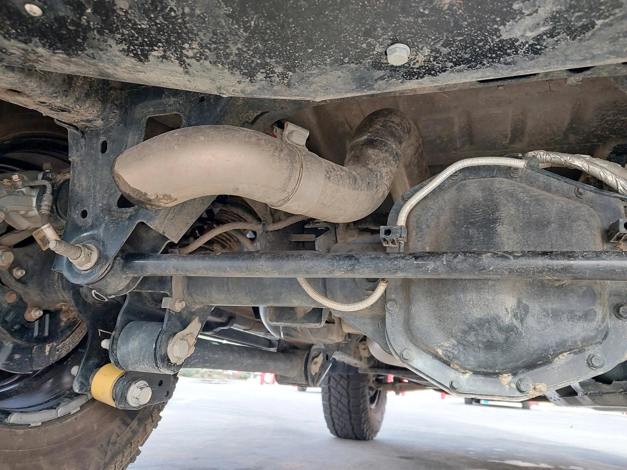

The Borla Touring Climber catback can be easily modified to work with the APG rear winch. The last weld can be cut and re-clocked a little. It's tucked up really well, and I think it sounds nice and suttle. Since these pics I have rotated the tailpiece down a little. Sorry my pics suck.
Also the 4WheelParts spare tire bracket got my tire up and out of the way. At least with my 34's.
