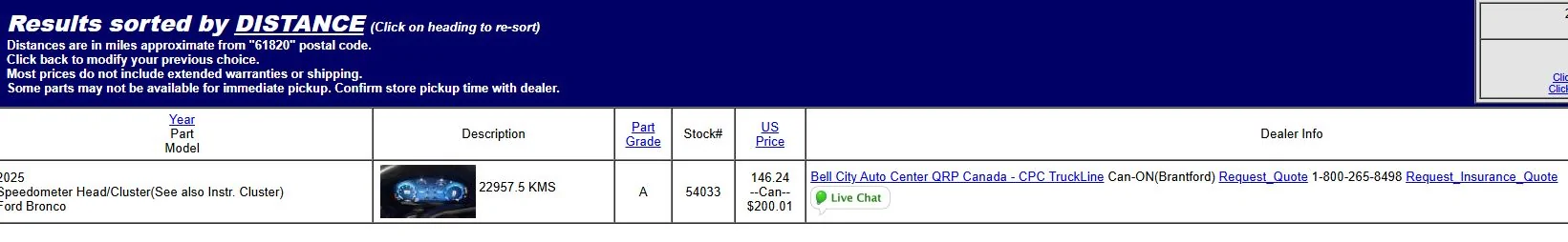

For anyone looking to swap to a newer digital cluster, one is available on car-part.com The catch is they can't ship to the US, so only available if you're in Canada.

You can change it with forscan.
But one very important note when buying a used cluster: You can only raise the mileage/kilometers, nothing will allow you to lower it.
So if you buy the used one in the OP, make sure your current actual mileage (or kilometers in this case) is above 22957.

I'm jealous. I called them about it and that's how I found out they won't ship to the US. Thought I had found a steal at $145 :sadface:

Well that’s a win, thanks OP. I managed to get this delivered less than 250$ CAD. Now to find the bezel and wait for some warmer weather to do the swap!
Just glad someone could get it. That's a steal for sure.
