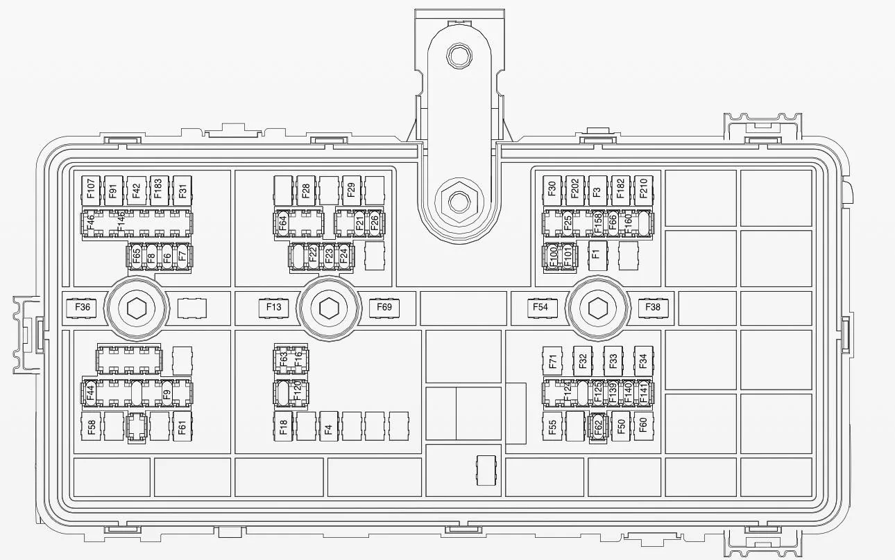

There is a lot of conflicting information for this.
The best way to know is to check your fuse box. They should be 10 amp
F63, F64, F65
Ford Bronco Auxiliary switch amperage IMG_6280

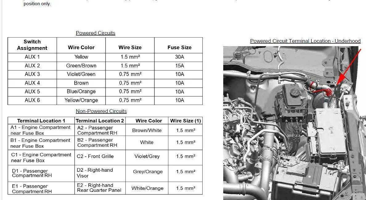

From the Bronco Equipment installation guide
Ford Bronco Auxiliary switch amperage 1738375824352-h
Ducati1098
10,007
23,276
Midwest
That’s where it gets conflicting.

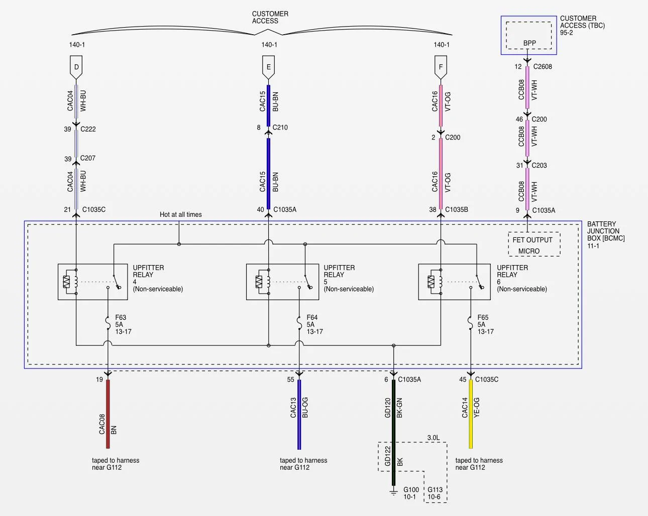

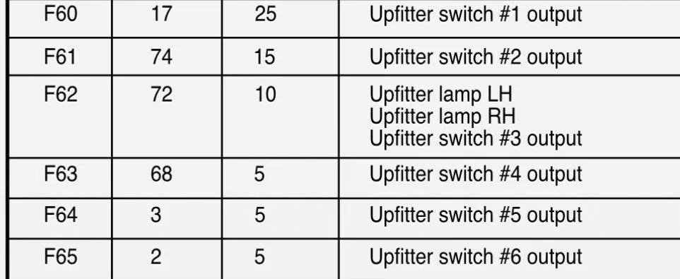

While I agree that it’s 10 amp, here is Ford’s official wiring diagram lol
Not sure why it’s so hard for them to fix this stuff after 4 years 🤦🏻‍♂️
Ford Bronco Auxiliary switch amperage IMG_6281
Ford Bronco Auxiliary switch amperage IMG_6282
