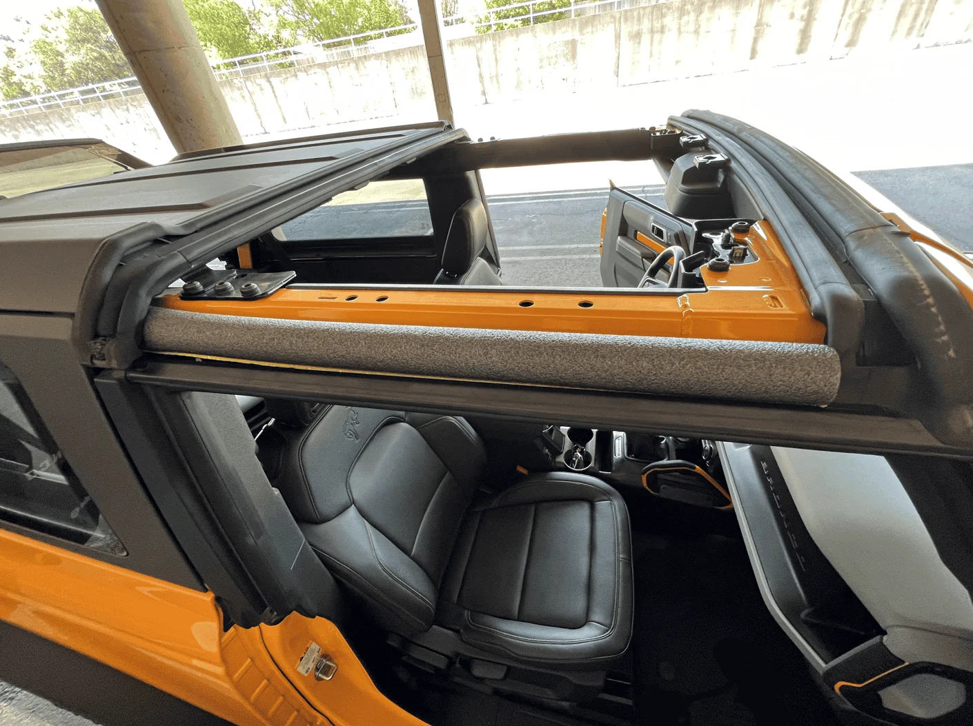

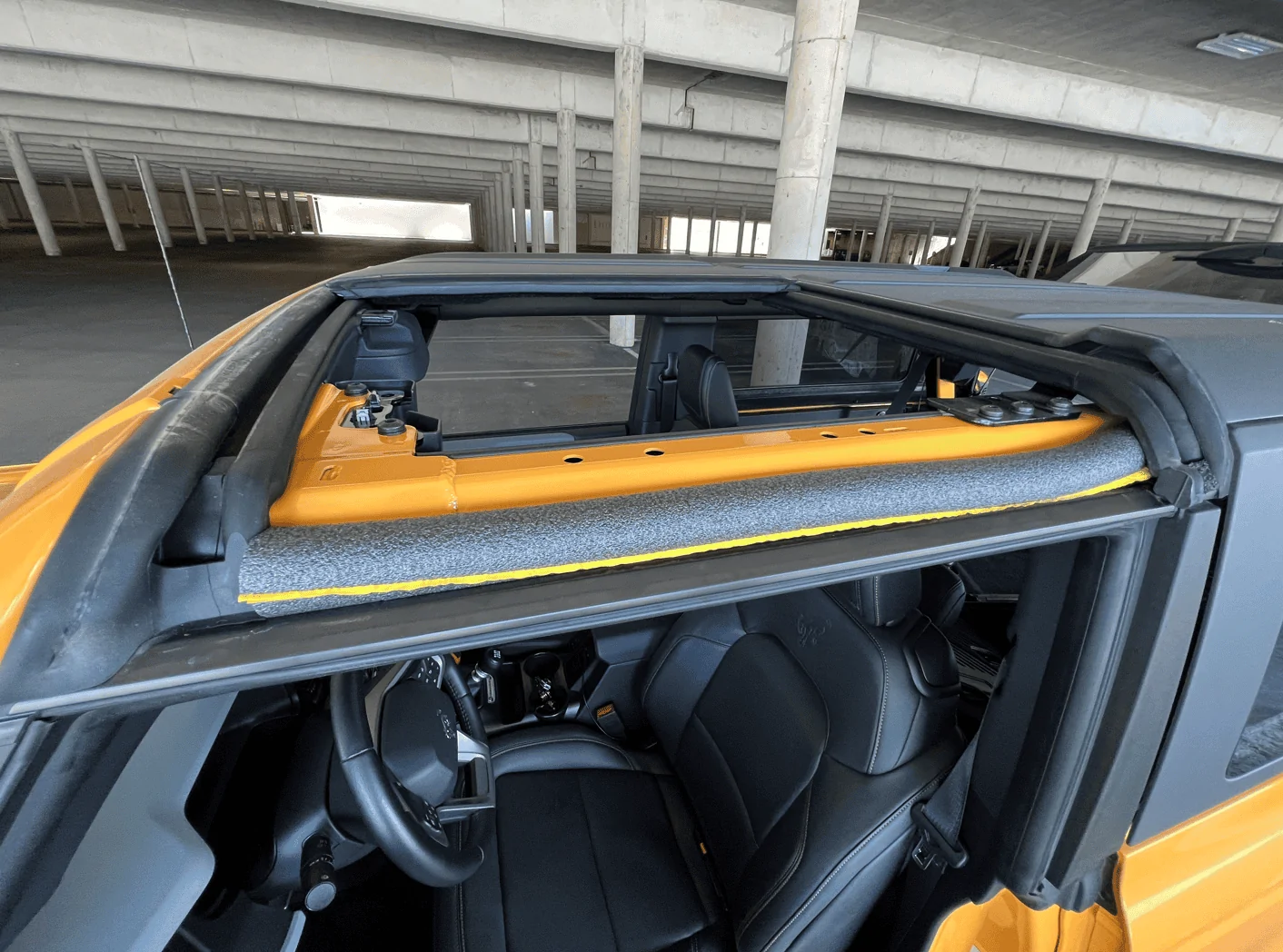

So:
Ford Bronco Attention MIC Hard Top Owners - Wind Noise Reduction Hack 1655054322617
Ford Bronco Attention MIC Hard Top Owners - Wind Noise Reduction Hack 1655054386871
For my 2 door I just used 2 6' sections and pushed them towards the back. No trimming necessary.
Took it for a test drive and....
Ford Bronco Attention MIC Hard Top Owners - Wind Noise Reduction Hack 1655054439714
Yes. It makes a difference. Going at 40-45mph I was like... maybe I'm just driving with a smooth tail wind and that's why I'm only hearing tires. Get up to highway speed and there's wind noise, but not near what it was. Noice.
Out of everything I've spent on the vehicle so far, this is the best $8 of it.
