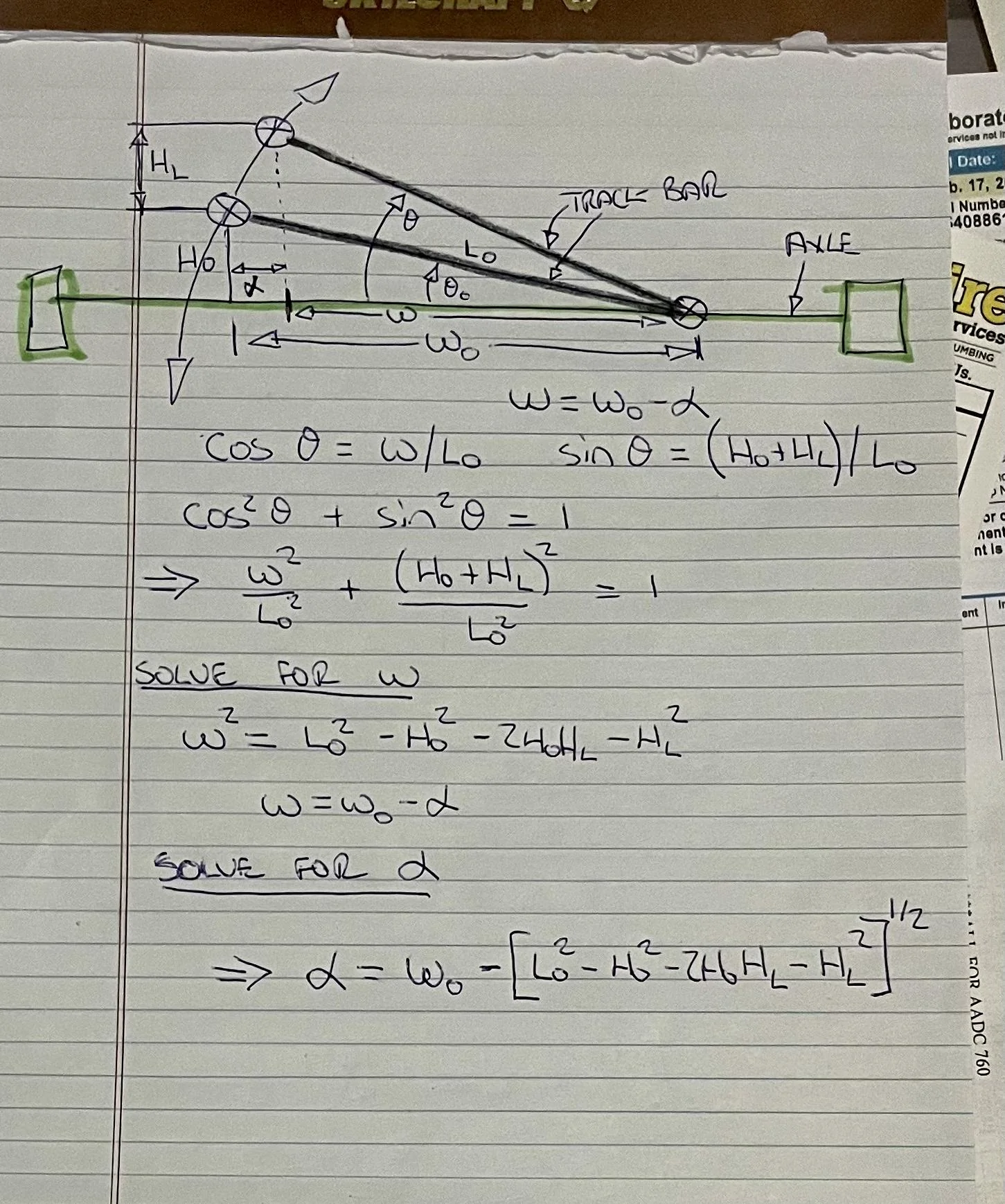

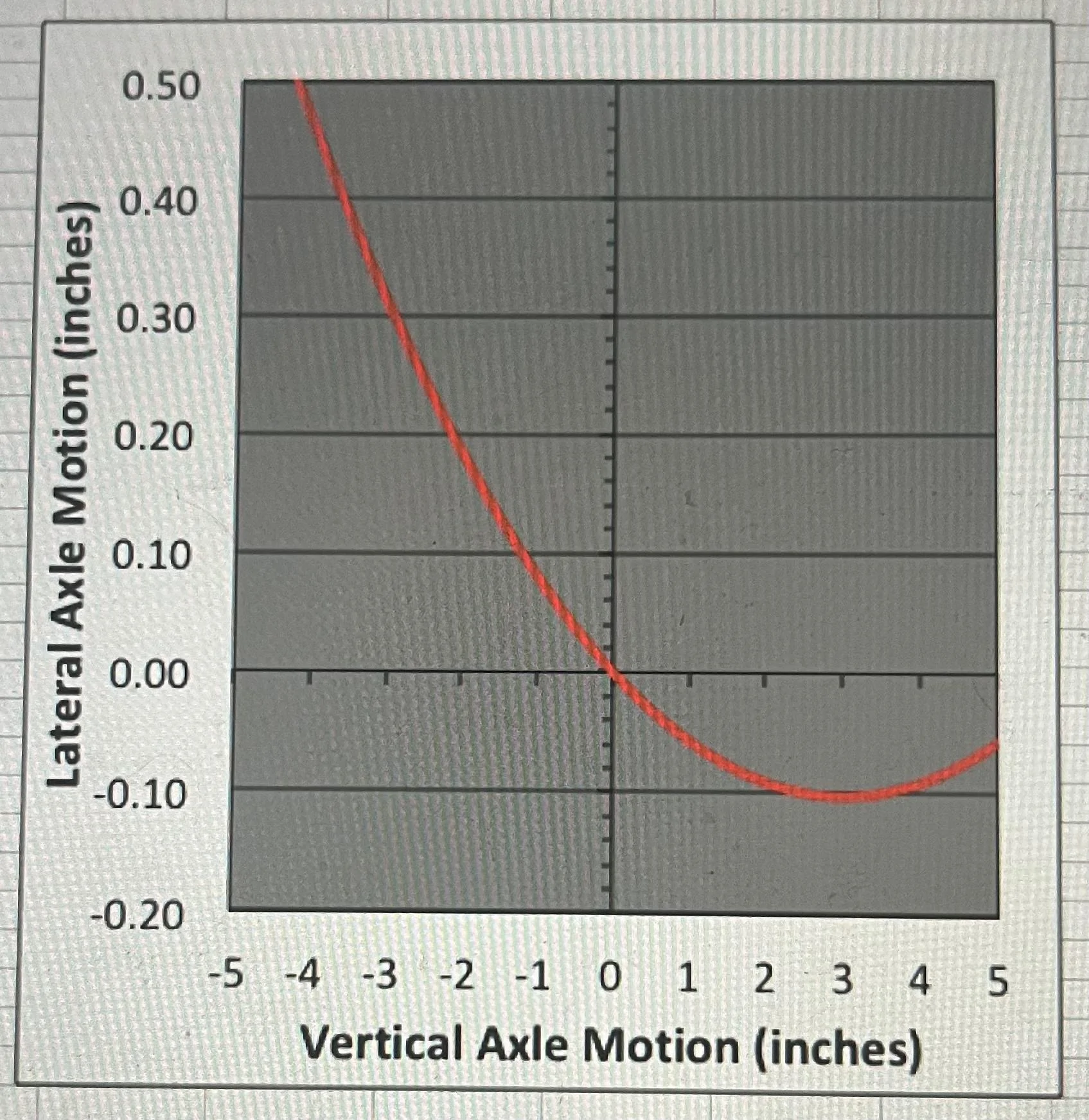

This is the axle motion math from track bar that makes sense to me. Track bar length (Lo) is 44” and track bar height (Ho) is about 3” on my rig at ride height. Ho will vary based on lifted configuration. I am close to SAS lift.
track bar sweeps an arc and moves axle left to right as axle moves up and down. Figure attached shows later motion of axle (negative is towards drivers side). Notice as axle moves up it also moves towards passenger side, until track bar is perfectly horizontal (3” of vertical motion for me). Then axle will begin to move back to drivers side. It sweeps an arc.
a 2” lift for me will move axle down 2” wrt frame and cause <0.2” of axle movement towards drivers side. Very minimal lateral axle movement.

The relationship is non linear, but from the curve above… a typical 3” icon lift moves the axle maybe 0.3”, so 3/16 for rule of thumb is about 0.2”. Seems reasonable rule of thumb. But just not likely very necessary. These are small numbers.
probably best to have track bar as horizontal as possible. Track bar resists lateral loads from axle. So any vertical component of loading will result in uneven rear axle roll when turning left versus right. Best to minimize vertical track bar loads by keeping bar nearly horizontal.
but none if this is likely necessary for a minor 2” lift. Both axle shift and vertical loading are small numbers.

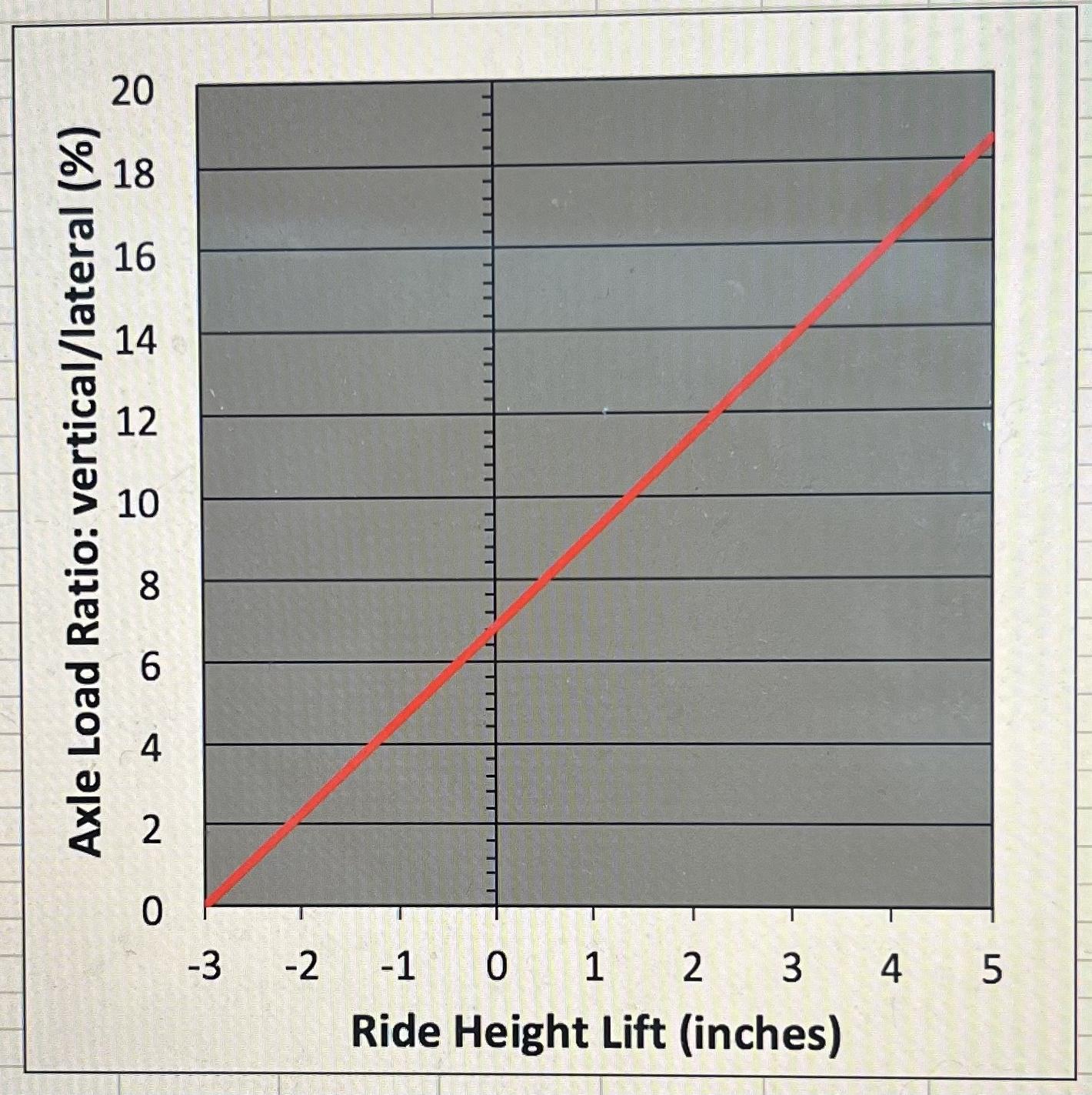

Asymmetric rear track bar vertical load can produce unintended consequences for suspension. Track bar resists lateral loading of rear axle and will induce some corresponding vertical loads, since bar is not perfectly horizontal. Ratio of vertical loads to lateral is proportional to track bar angle and linear wrt lifted ride height.
figure shows rear axle vertical to lateral loading ratio as related to ride height for my OBX which is sitting near SAS lift. So 0 lift in figure represents near SAS ride height, which produces <10% vertical load component. Notice a 4” lift starts generating significant vertical loading. Increasing track bar length helps to re-center axle but does not decrease vertical loading. Since track bar angle has not changed. Track bar relocation to near horizontal is required to reduce vertical loading.

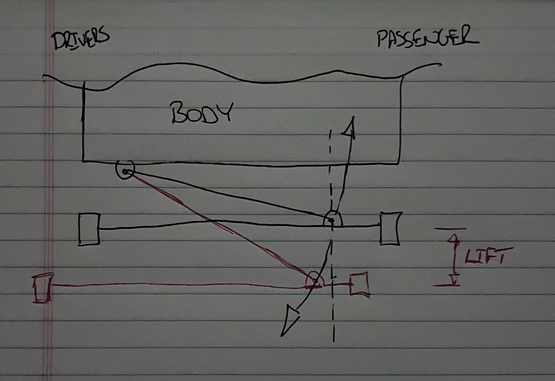

Track bar with stock mounting locations will kinematically move the axle towards drivers side as rear body is lifted. To center axle then the bar must be lengthened.
track bar with relocation bracket is a different story. As bar becomes more vertical it must become shorter to center axle. Shortest bar length kinematically occurs when it is perfectly horizontal.

Not sure I completely understand. If the axle is shifted to driver side from a lift the track bar would need shortened to pull the axle in to the passenger side. Isn’t that right?
87-Z28
Andy
Sep 1, 2022
1,301
3,194
BMW
no that is not correct. I added a figure to my response to illustrate the kinematics.

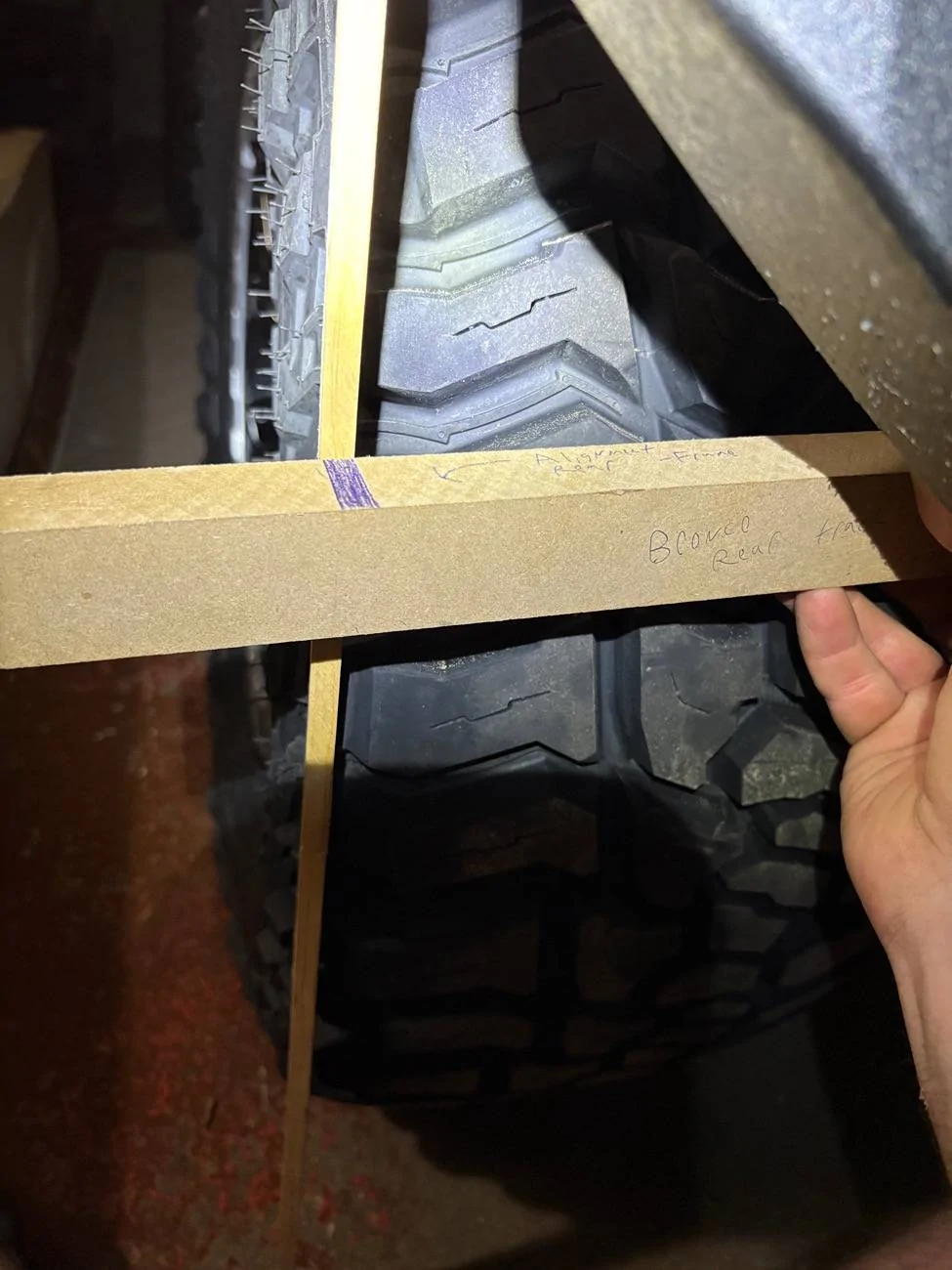

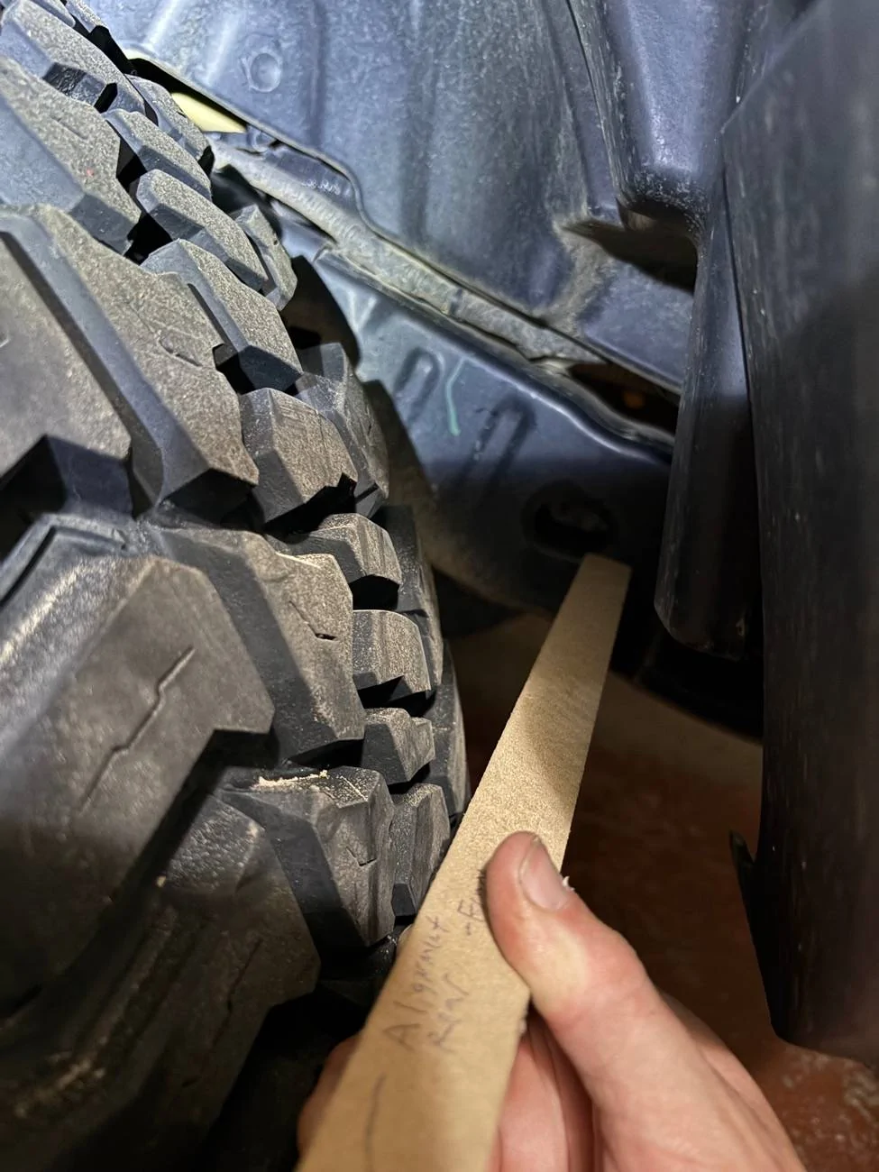

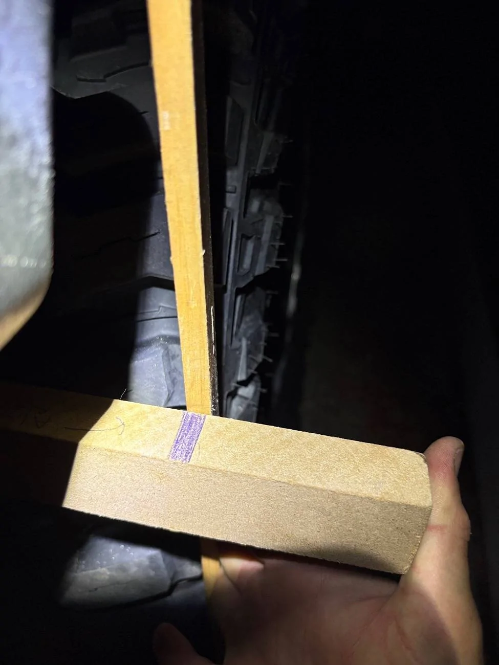

Okay I nerded out today after work. Lengthing the track bar moved the axle out to the driver side. Shortening it moved the axle to passenger side. Did a measurement from the frame to edge of the back of the tire. My track bar was only off by one turn to the passenger side, was a bit too short. I used a straight edge and block of wood. Thoughts? Cowboy way of doing it.
