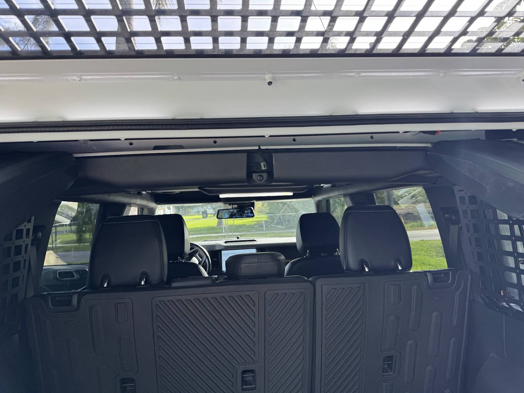

Welp, everything is finished. All button up, cam mounted, brake light done, everything else adjusted. Took the wife out in her and she was pleasantly surprised. Being in Jessa with the soft top, she already knew how much noise it made. Now it was nice and quiet. Of course, she had to question the rear molle, but she was impressed by how rugged everything looked. She stated that if someone hit me they would be in trouble, and she was happy that I had a top that would probably stop me from getting seriously injured if I rolled over on a trail. So a thumbs up!
Living this molle life now. The rear cam came out pretty well after it was all said and done. Some pics of how it looks, and my DV8 rear pocket molle. Honestly, the video is clearer than what it looks in the pic, but you can see whith the system off, that is my view. The slant back, plus,my lift cuts the view, but Cam gets everything.

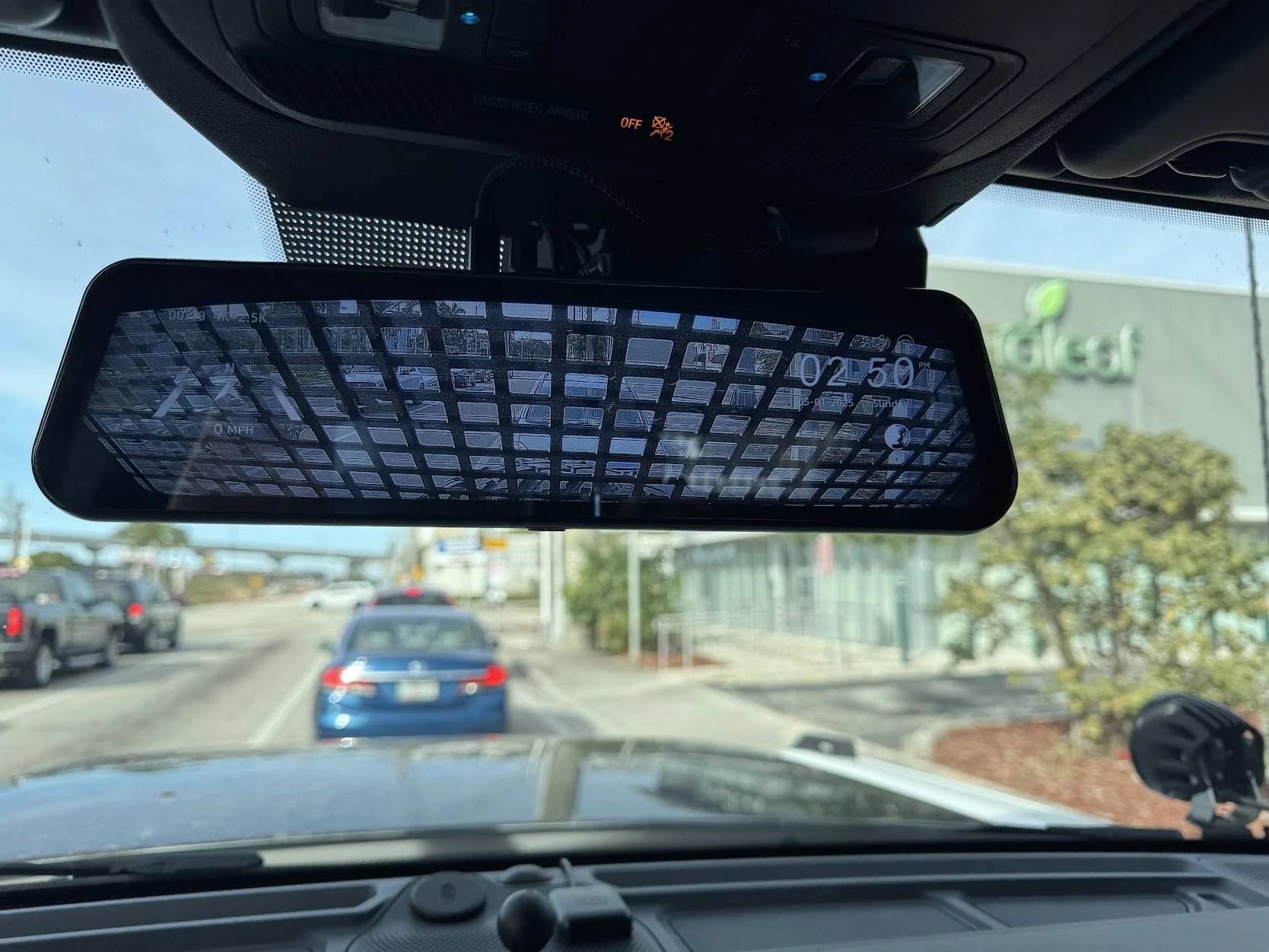

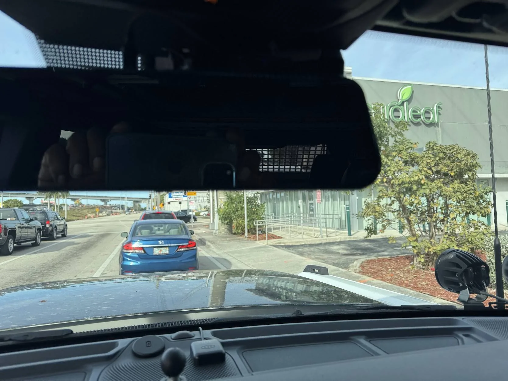

Thanks for posting. It looks awesome. I also have the wolfbox mirror and on the OE hardtop have it mounted behind the rear glass. I find I need to use the wiper to clear the window quite often. This had me thinking I would make a hooded mount and attach it to the exterior above the molle panel and upgrade the fourth break light to allow for the wire to pass inside. Does it look like you could route the wire through the 4th break light wiring hole? Have not seen a good picture of it yet. Thanks again for posting!
Hmm that is not a bad ideal. I know it comes back inside behind the rear lid, I think there would be enough room, I would have to go look.

That would annoy the hell out of me! I would mount the camera outside and have a clear view out of the mirror. I love the top, but if I end up ordering one myself, it will be without the rear molle.
I have seen more than one person comment that they get bad night glare on the Wolfbox mirror when they are mounted outside. I am mounting inside, but I don't have the molle problem David does. And actually, I think the minor tint on the back OEM window is what prevents getting night glare on the Wolfbox. I'll be able test my theory after I install this weekend.
But this isn't the right thread for that so sorry for posting here folks.

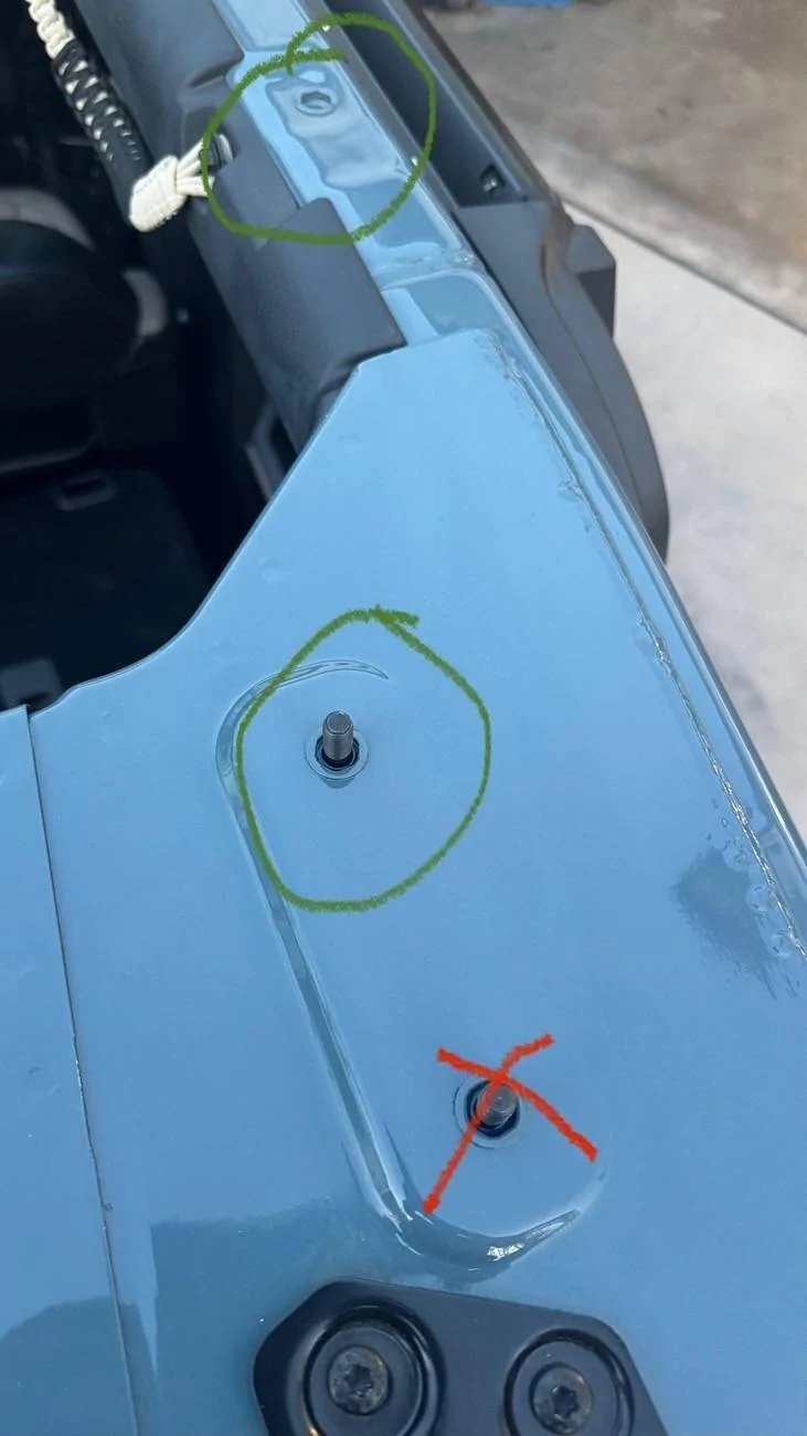

Ford Bronco Armadillo Designs Aluminum Hardtop 1736261399488-dg
The install was simple. The ONLY confusion I ran into is that there were only 4 bolts versus 6. Fabian responded nearly instantly to let me know that I only needed the 4 (video showed 6). But the area where I have the RED X, no bolts required, so I removed them and put them in the holes where the green circles are in the photo. I had to do NO extra drilling, or widening of holes or any of that. It was as simple as removing the soft top and brackets/bolts. Placing the 4 bolts in place, and getting enough muscle to get the top up into place. Everything step by step in the video is spot on regarding the other bolts and clamps. Break light simple as per the video. The defroster was a little confusing only because there are little install clips on the top for the zip ties to go thru. Once I figured that out, it was plug and play. Zero extra headaches or complications. It just went into place. I have zero rattles or squeaking...

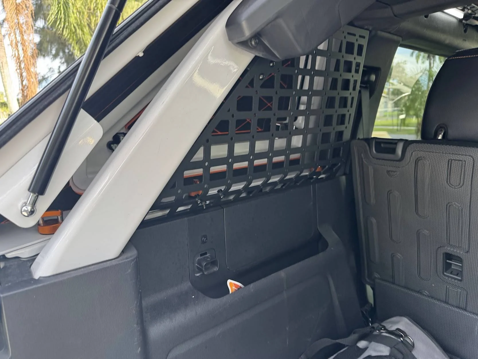

1. Overhead DV8 molle panel/Cross Bar: You will need to remove the overhead section to get this top on. The two inner front screws for the top will not be accessible with this one. The crossbar...well Fabion had told me I needed to cut a part off the bar, that overlapped into the plastic. (It's like a piece that slots into the frame) I did not need to do this. The top sat down just outside of this, and it did not interfere. So no cutting. The overhead section will be a pain to put back on if you have big hands. I was able to hold the nut in place with a finger whie I got the screw in. (Yes it was a pain, but it got done) So just a heads up on that.
2. DV8 Rear Pocket Molle. No problems, worked fine. Just note that they call for a T50, and it's not. It's a T45 for the seatbelt bolt. The RockWorx works just fine with their molle, and you can still use the strap mounts. (Honestly, I bought these a WHILE ago, and I was going to use them dammit! Plus they look cool.)

These interior panels really give a lot of useful storage. Between those and our toolbox I’m not worried about the loss of storage going slantback at all.
