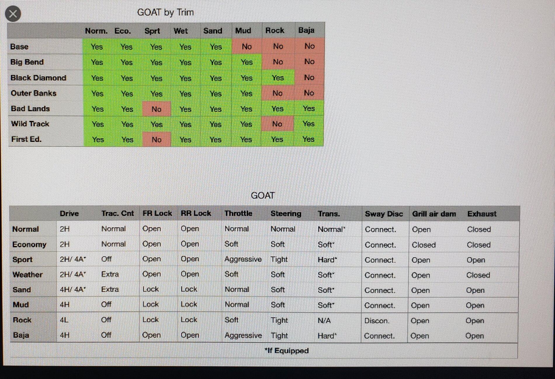

This is interesting. So for those of us getting a BL, we can use Baja instead of Sport for aggressively getting to work on time? Too bad about the 4H being tied to that though.
I believe they said those settings were predefined starting points, but could also be manually adjusted?
I cant remember why but I thought there was a valid reason not to use Baja in place of Sport mode on BL. I will try to dig up the post/thread if I can find it. Something to do with Baja mode allowing for sliding in the sand and not meant for pavement, but I could be completely wrong.

Guess you didn’t read the posts above. Ford says when you put the traction mode to rock crawl it automatically activates all the lockers. And as you know when the front locker is in, the turning ability is severely limited. I did say “can’t turn” but limited would probably have been better.
I manually activate lockers as you said above “when traction is needed”. But with the mode selector if you choose rock crawl rear is mostly fine but front I can see mostly turned off and used specifically when needed.
Pretty sure Rock Crawl Mode only automatically locks the REAR locker and NOT the front. Also disconnects the sway bar…. I’ll check it out this morning and apologize if I’m spreading incorrect information. I do not believe any GOAT mode locks the FRONT differential. It is only driver selectable.
Flip or one of the other Ford guys on here has posted a chart (from the owner’s manual?) indicating the throttle, transmission and steering response settings for each GOAT mode.
