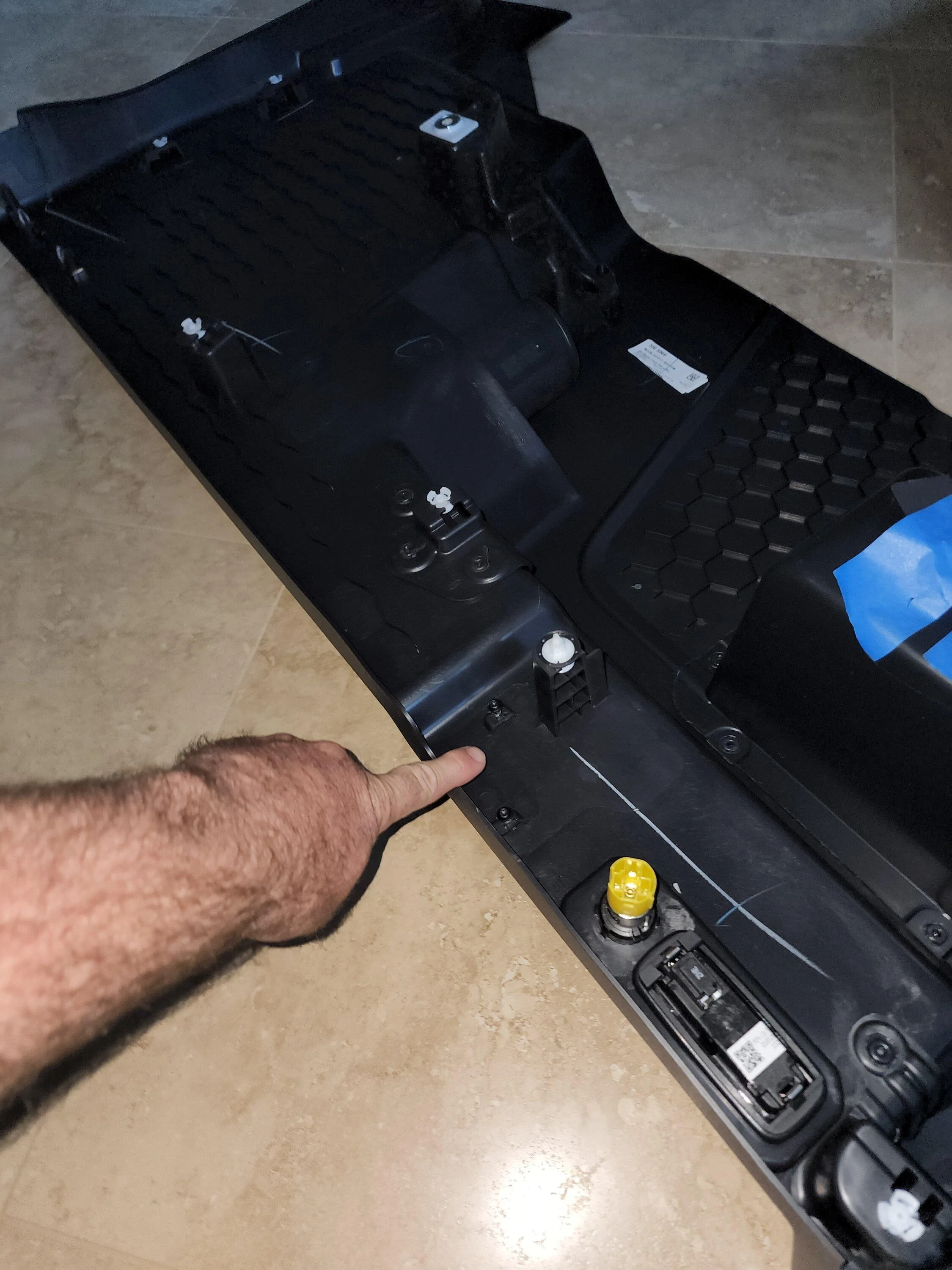

Bad connection on the back behind the side wall plastic panel on each side the Antenna was no connected properly,,,,, Reconnect the 2 module properly and it work fine now

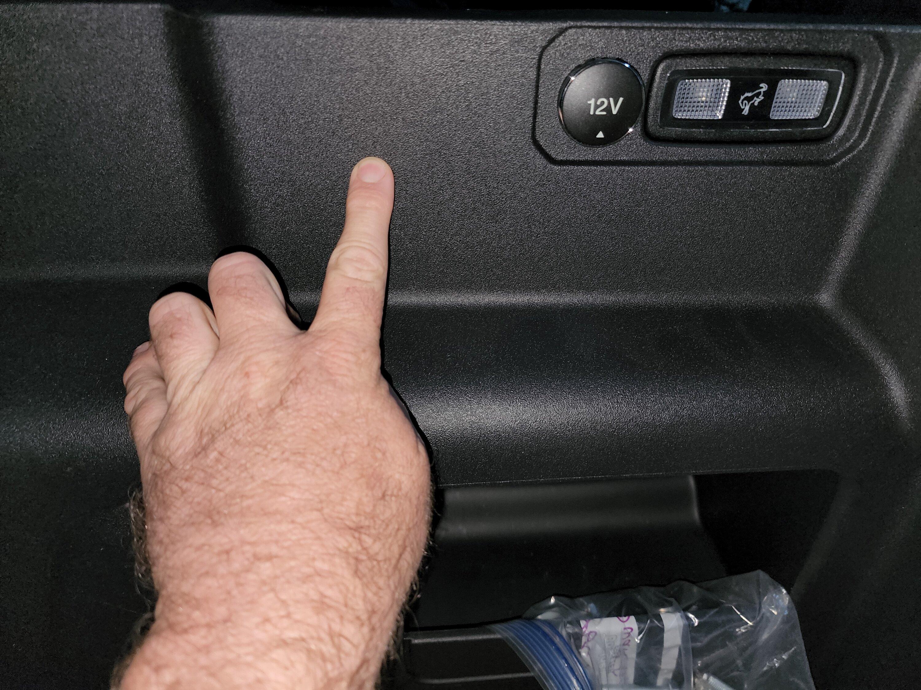

This location is on 2dr Bronco ,,,, might be little bit different location on the 4dr
The picture from the inside with the 2 screw I am pointing is where the Antenna was located,,,,, I decide to install the Antenna without reinstalling the panel for the moment
FYI they have 2 Antenna one on each side
Let me know if that help
