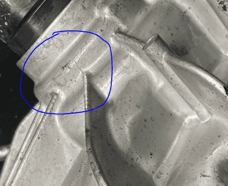

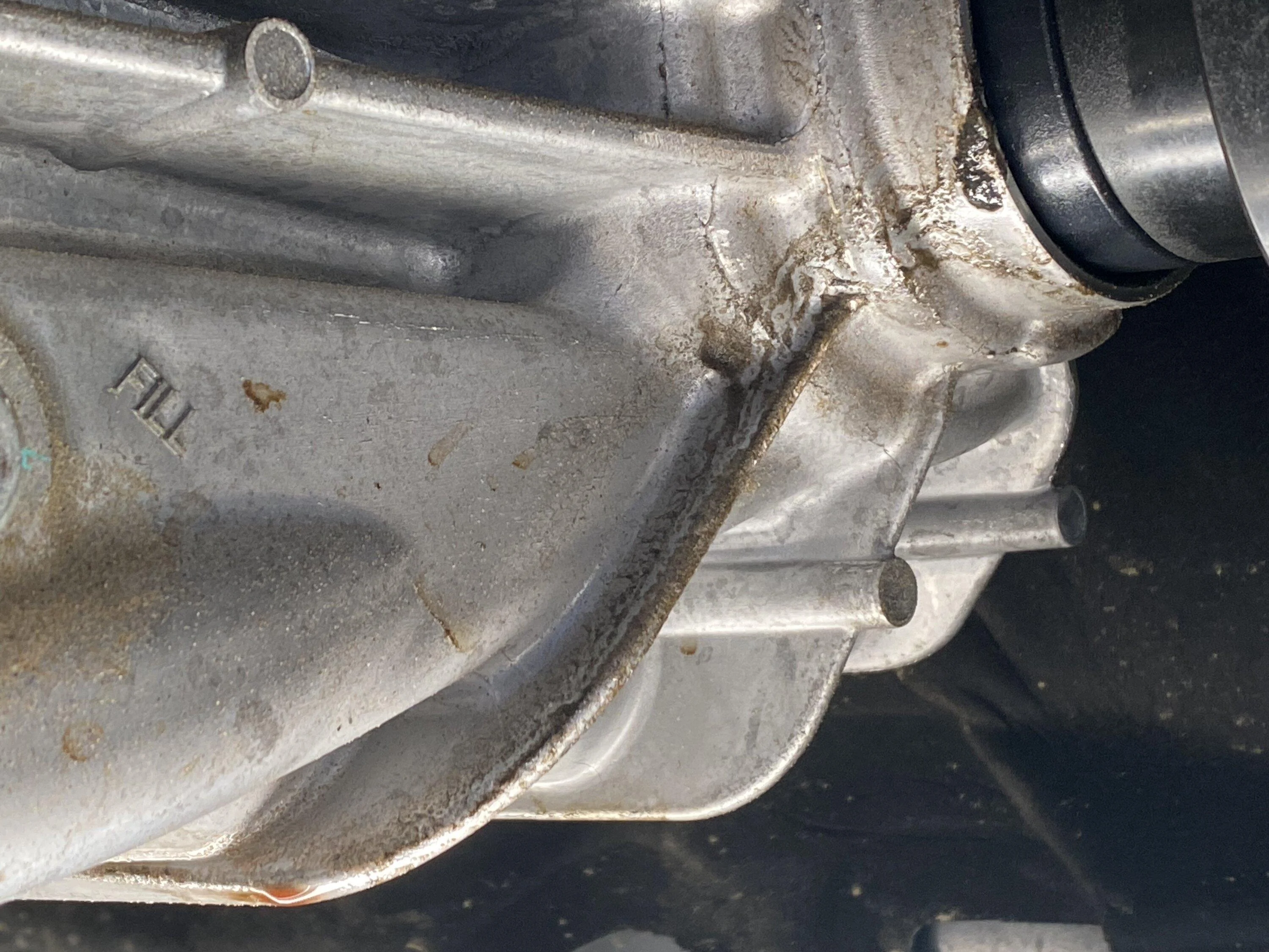

It would seem mine has been leaking for a while.... dealer looking into it ...

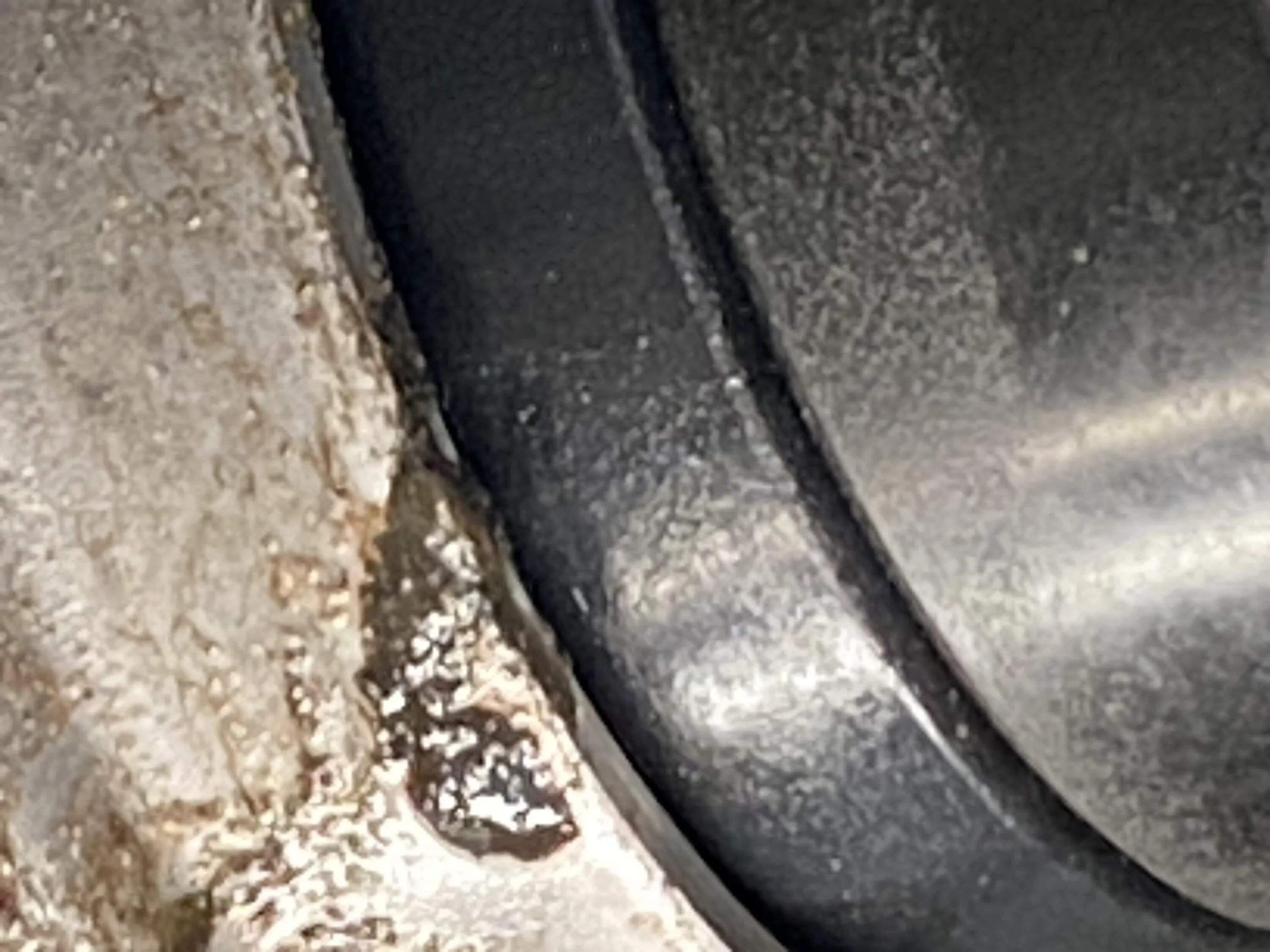

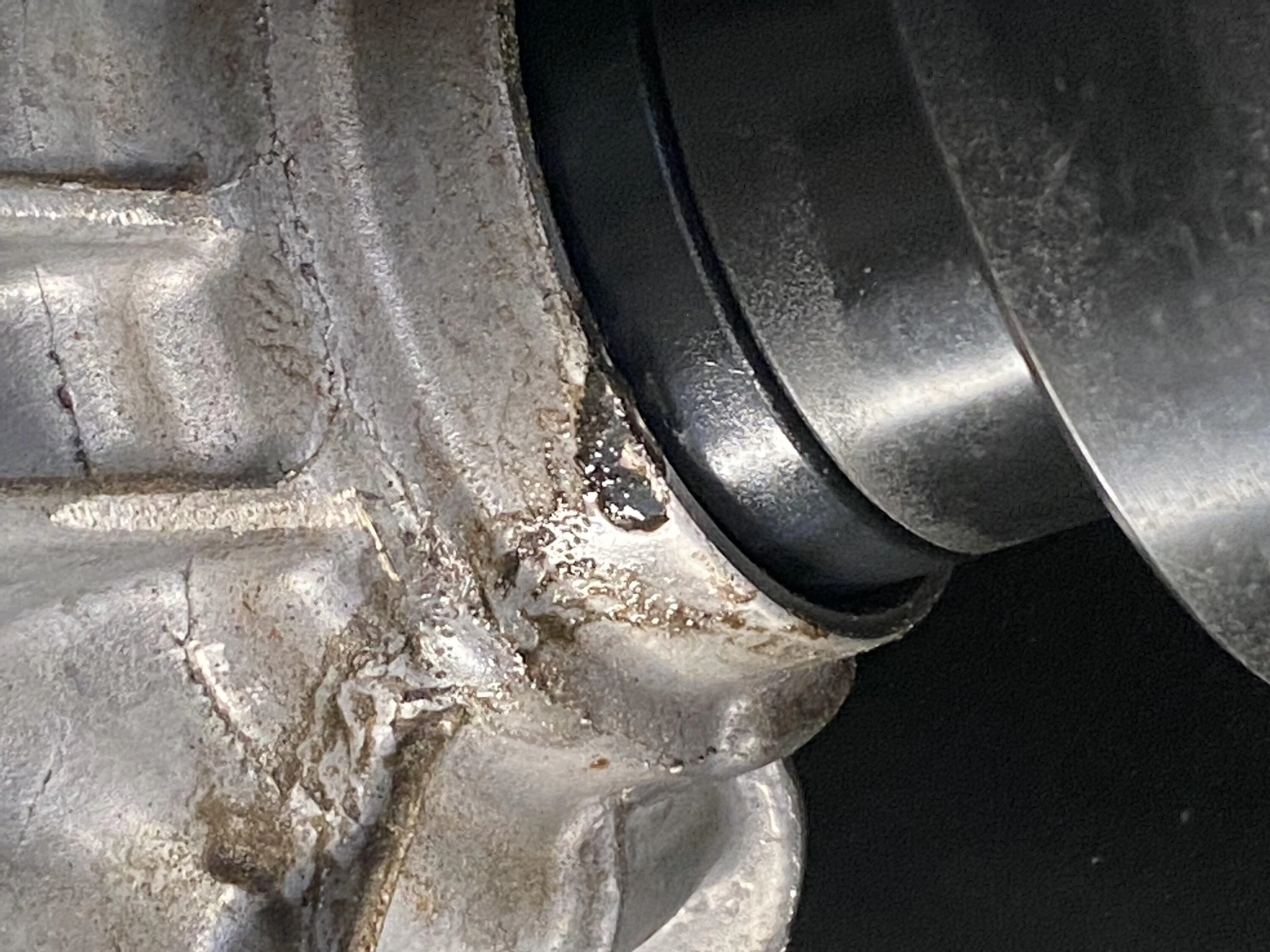

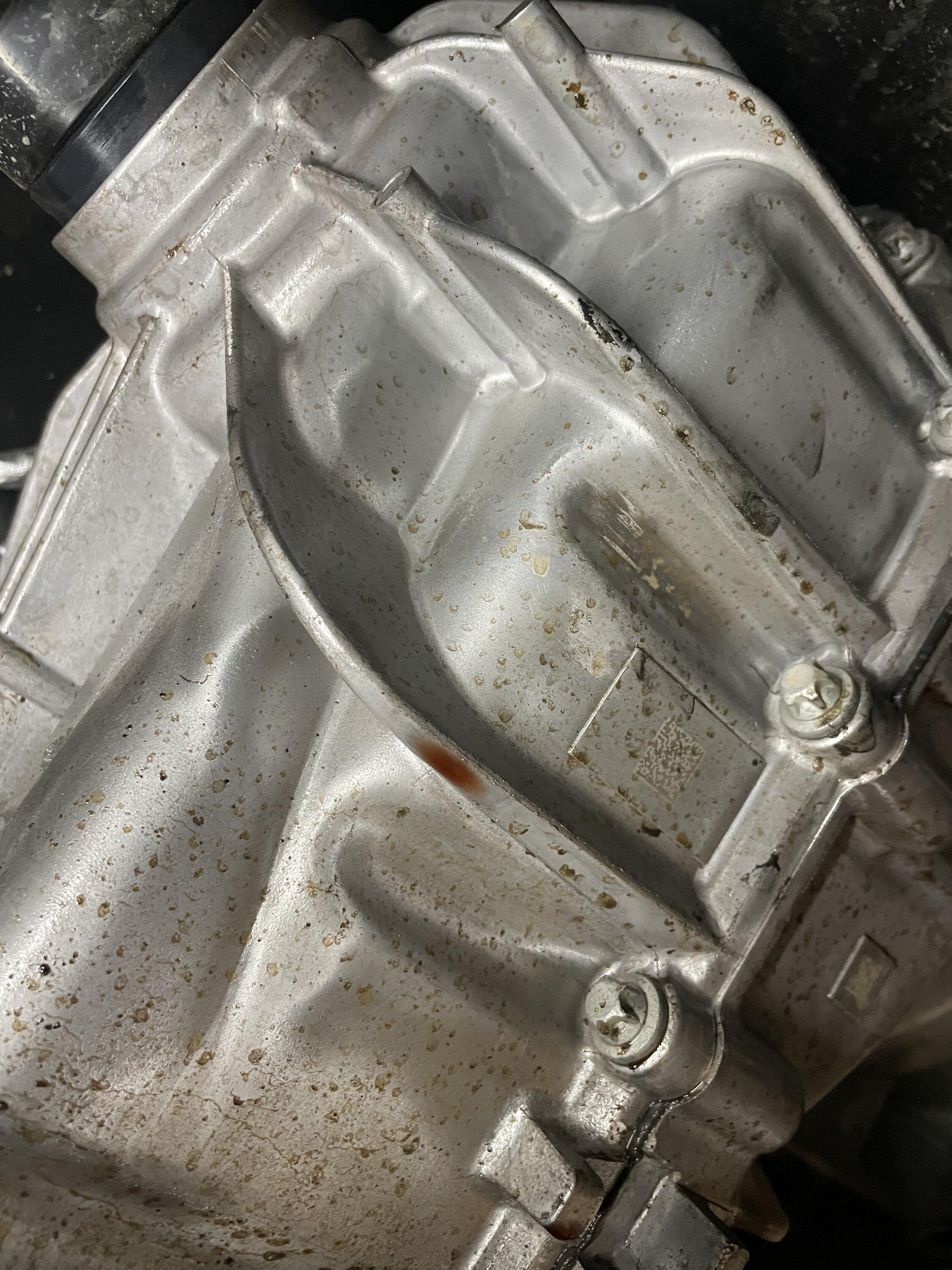

What came of this? Noticed a leak on mine today, def coming from the drive shaft area.
Sorry I never updated. They had to replace the whole T-case. It was damaged when installed or something. Dealer said that he could tell it wasn't damaged after install as the crack was on top of the T-case.

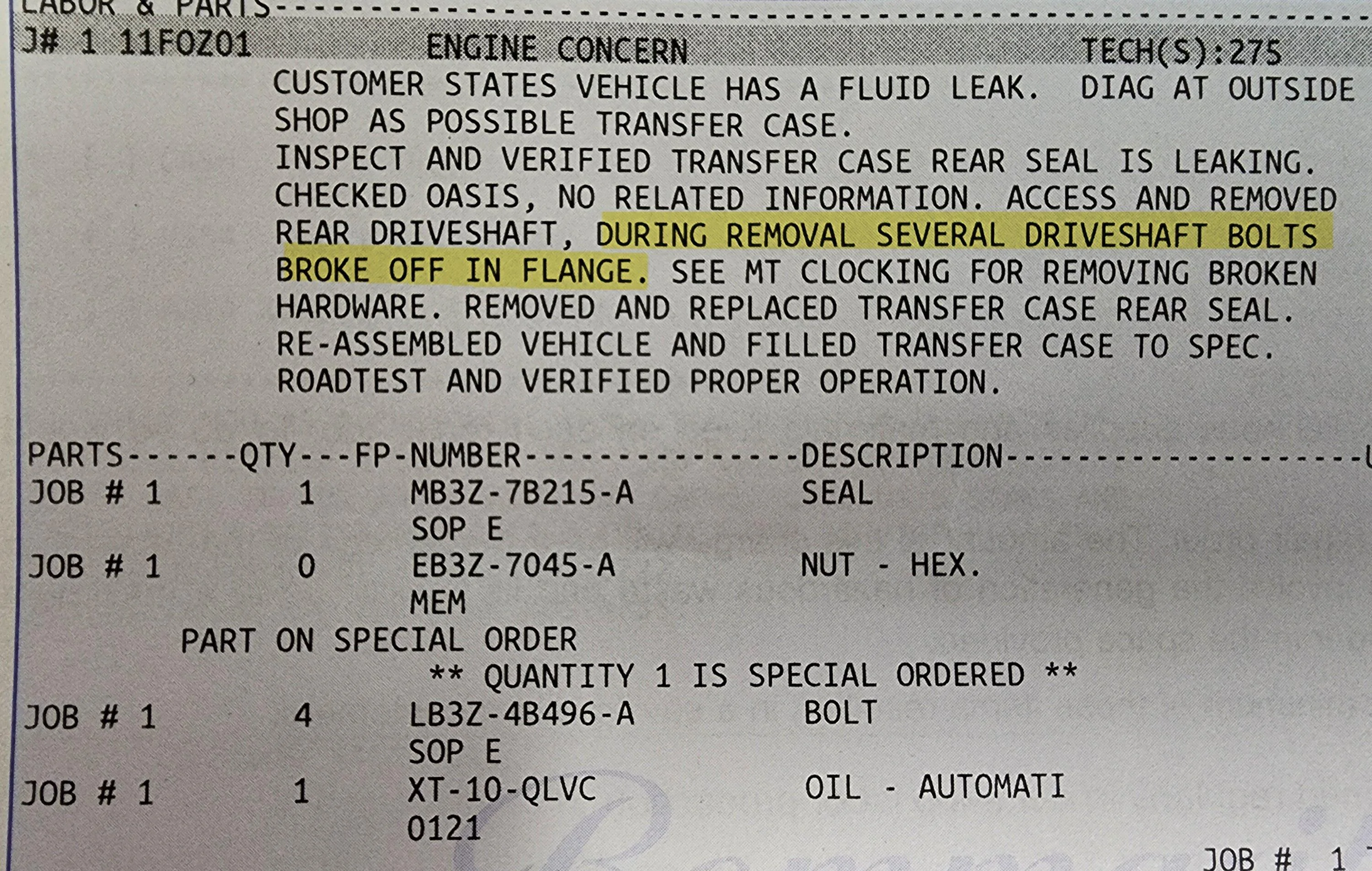

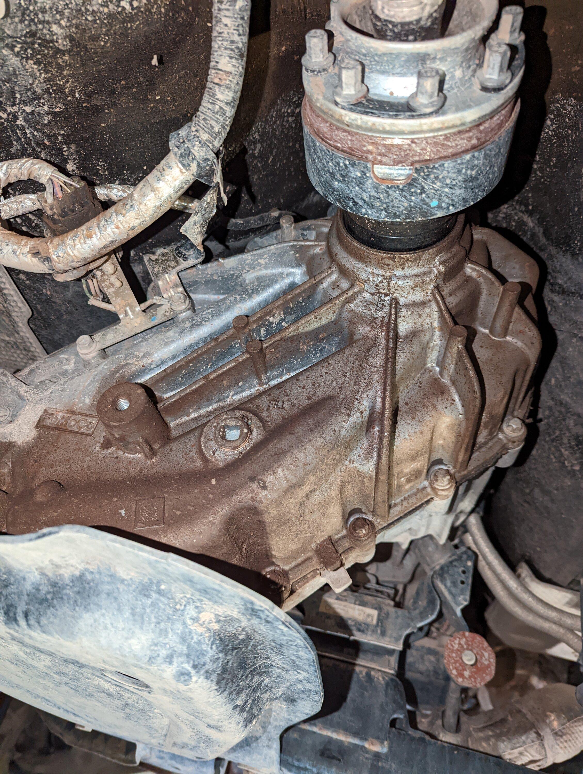

Dealer replaced my seal
Ford Bronco Anyone else have a Transfer Case leak? 20230106_132034
, took about 2 weeks, they also broke drive shaft bolts removing it which I think slowed them down

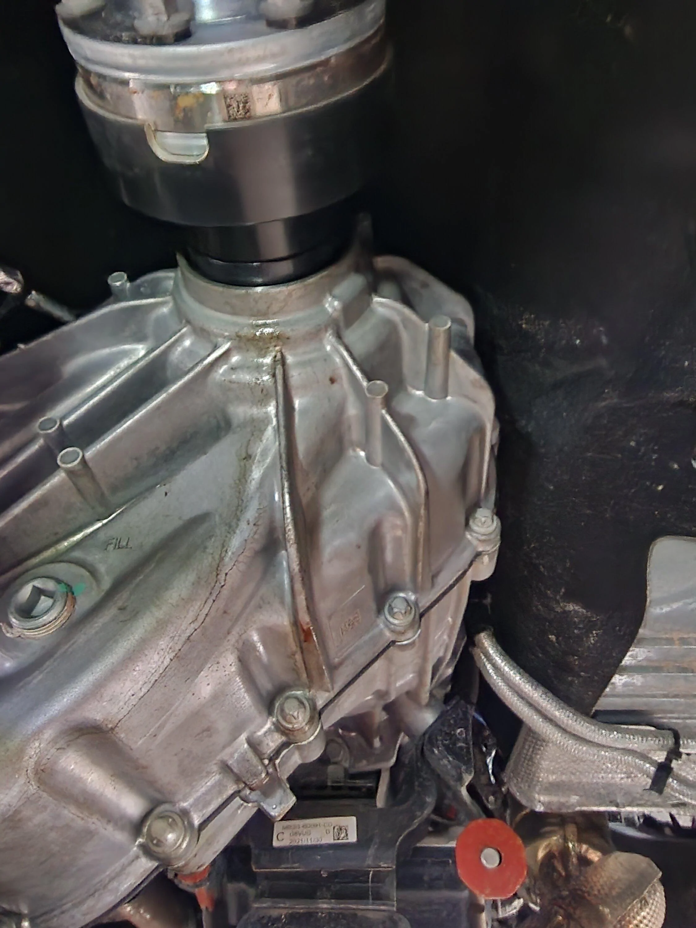

My rig is at the dealership for this same issue right now. Been there for a week. I think it’s just a seal, we’ll see.
