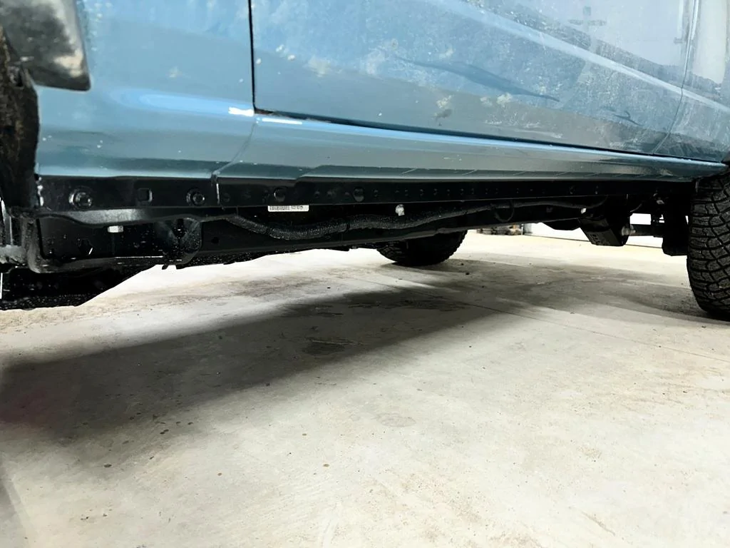

Not intentionally, just the pinch welds prior to installing the RCI sliders.
But they likely caught some overspray.

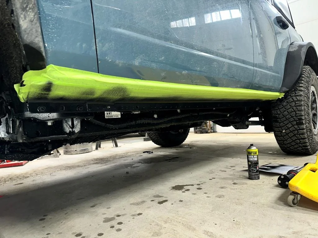

Im in the Desert South West, but I just taped off, scuffed it with some 220 grit , and painted it with Krylon flat black. I have GOAT Fab sliders which hide most of it. Ive had no issues at all, self car wash sprayer and all???
I just bought the Krylon Fusion paint and was going to use that as well. I’m torn between that and using some under coating spray or bed liner. I’m sure I’m over thinking this for such a small barely noticeable area lol.
How did your paint hold up?

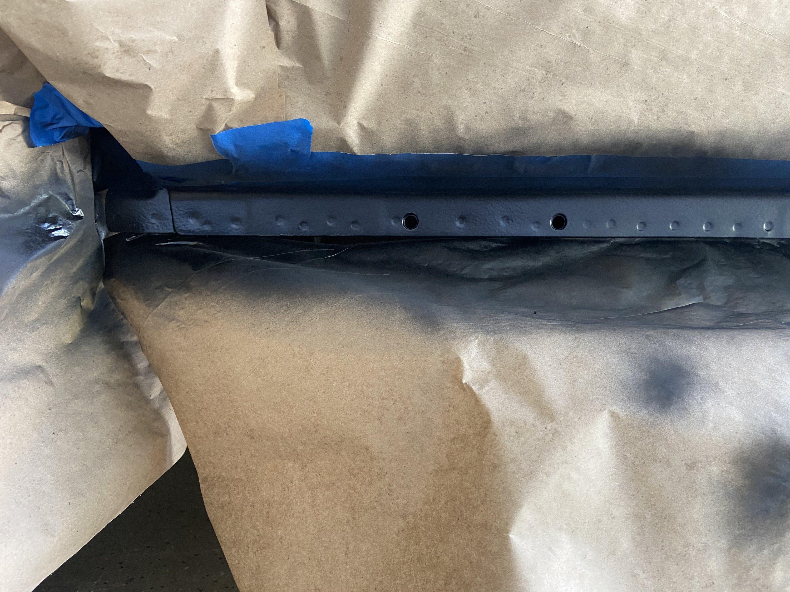

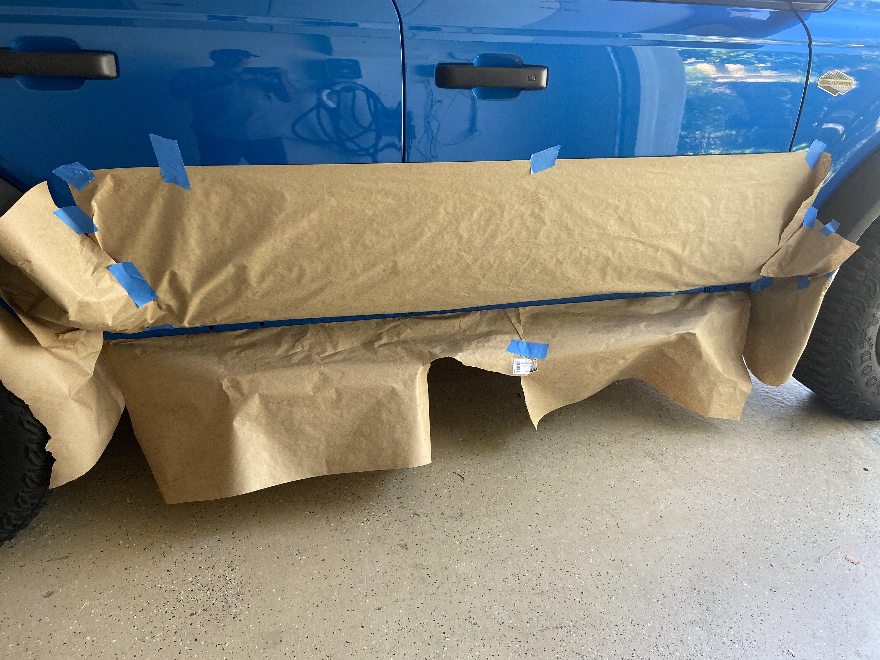

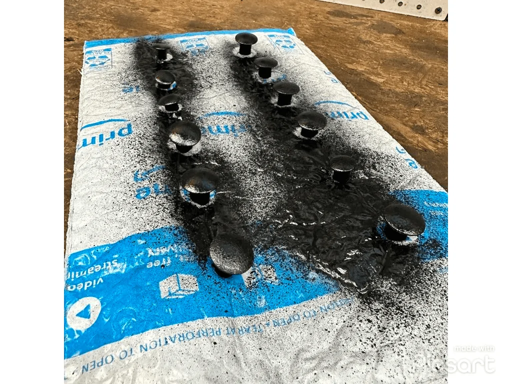

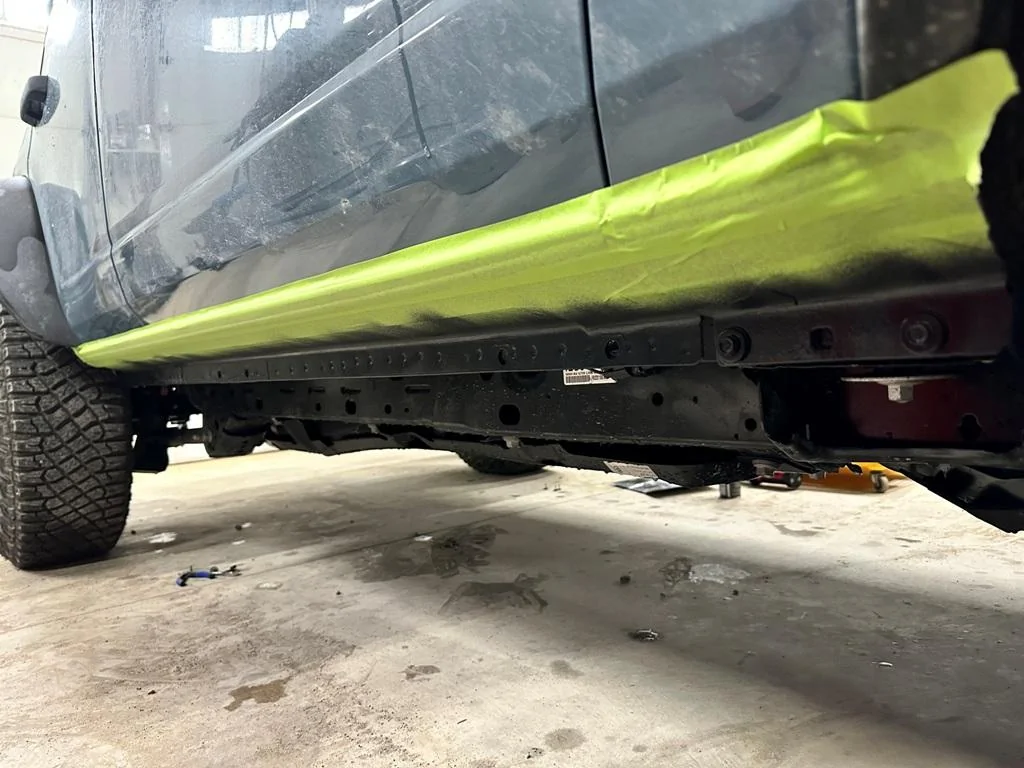

I just used rattle can bed liner and plastic plugs from Amazon.
I’m painting mine as we speak, but now I’m wondering if I put my tape in the best location. I ran it right at the start of crease where the metal is bending and going horizontal. I’m interested to know if people stopped there or went under the door sill more.

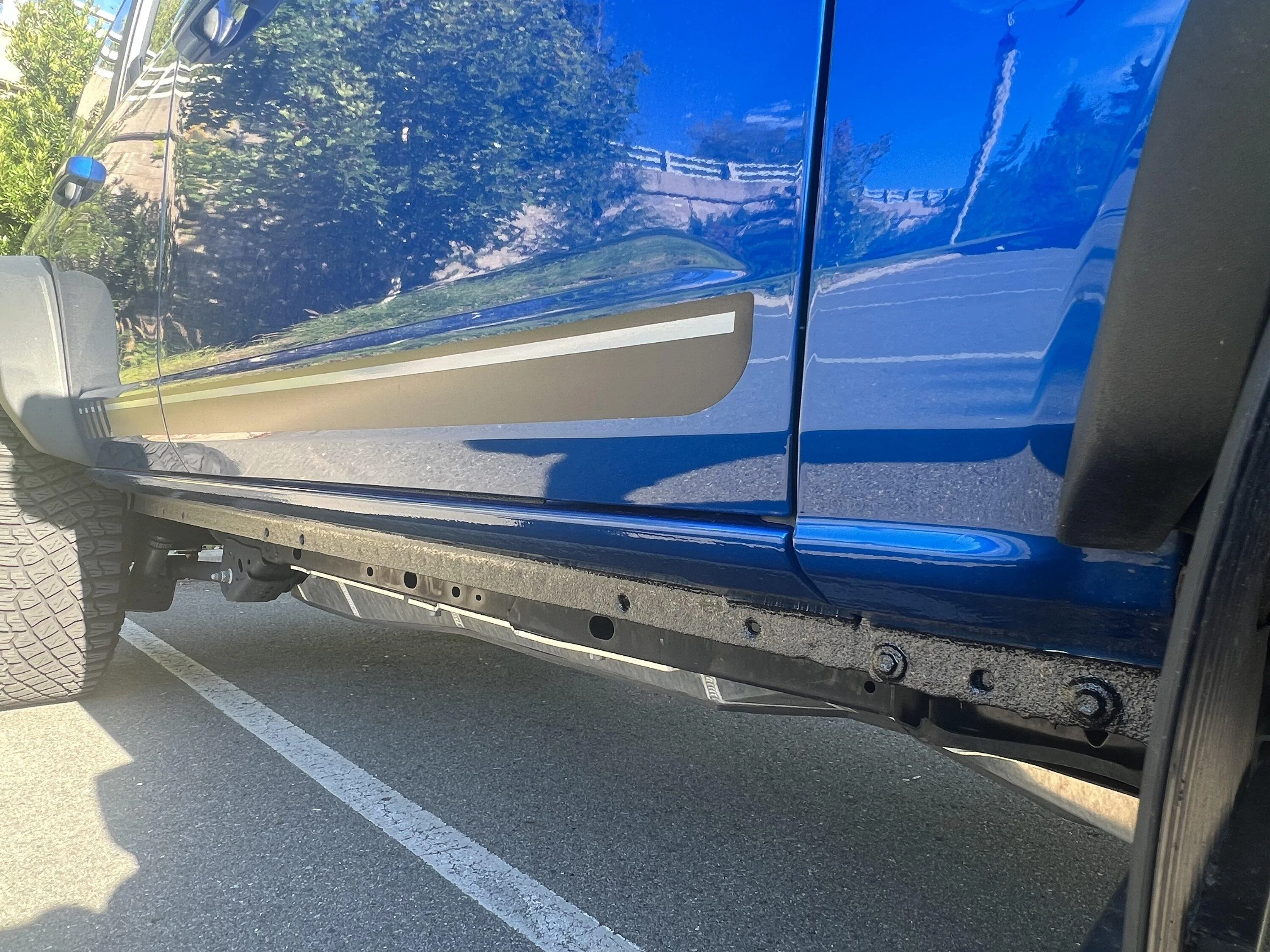

Rattle can undercoating…

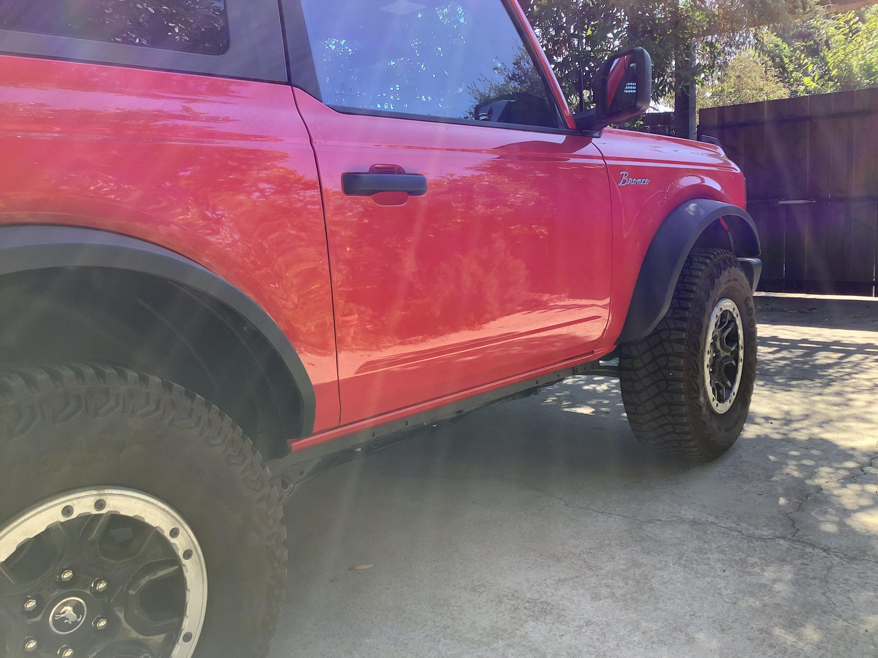

I had Line X applied for a variety of reasons, but I am pleased with results. It’s not cheap because they masked the whole vehicle. My coworkers brother owns the shop.
