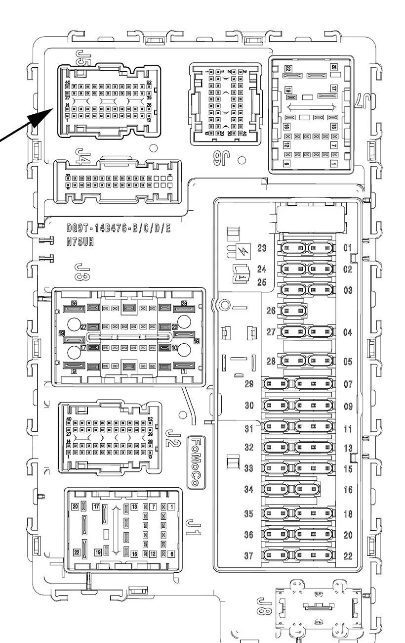

The fuse panel is DG9T-14B476-B/C/D/E which is shared across a wide range of vehicles and years, just wondering if the J3 plug is also shared. (Ignore the CHMSL J5 with the arrow, it was just a better picture than above)

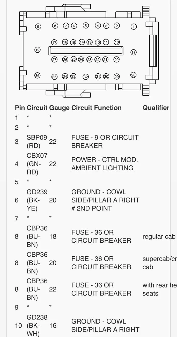

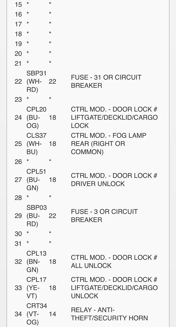

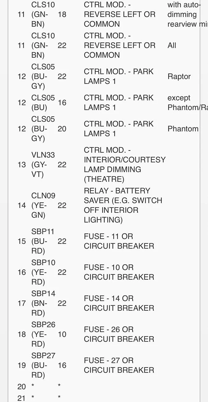

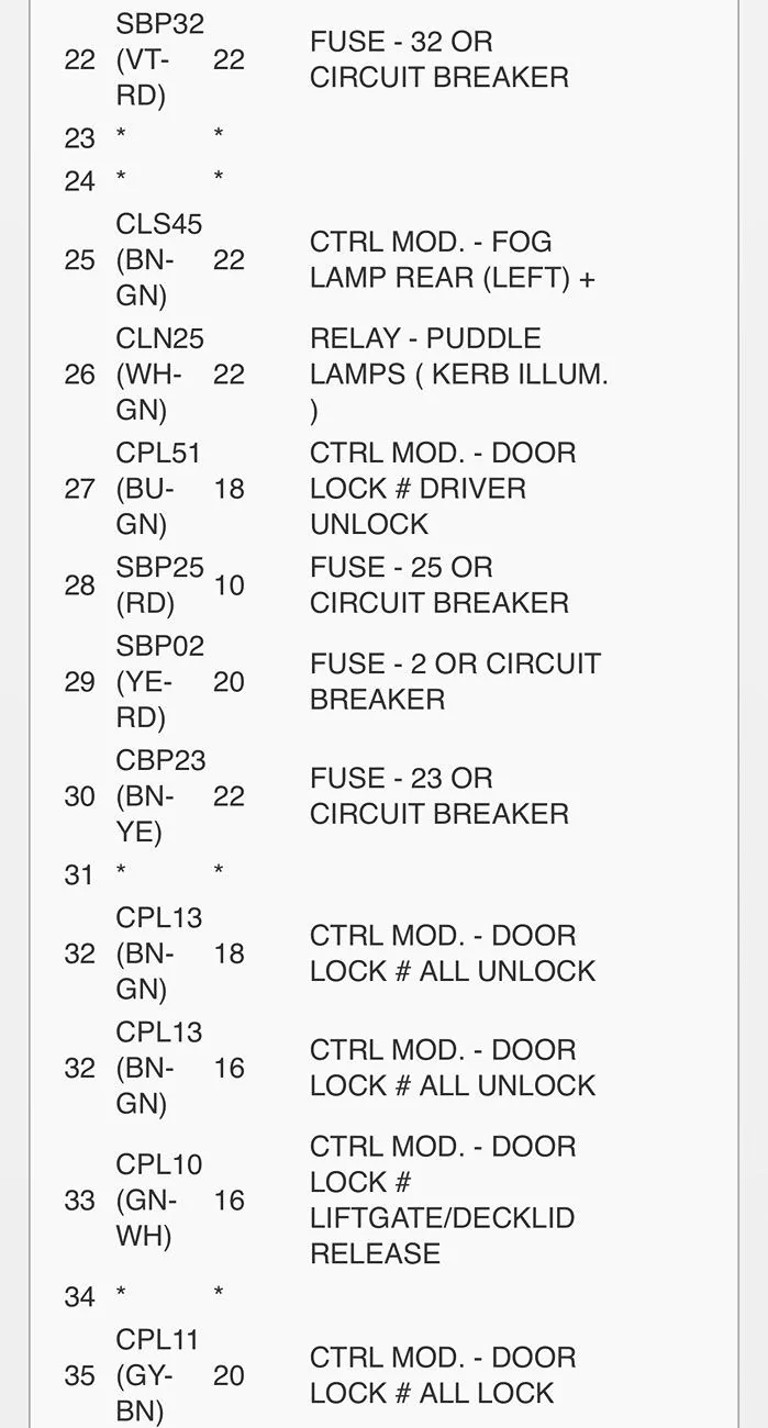

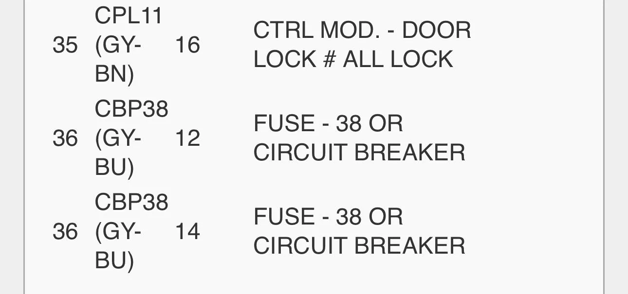

They both have the same connector, but the pinout isn’t exactly the same. I have no idea if it would work 🤷‍♂️
F-150:
Ford Bronco Anyone been in the BCM lately? Speed Turtle module compatibility IMG_4124
Ford Bronco Anyone been in the BCM lately? Speed Turtle module compatibility IMG_4125
Ford Bronco Anyone been in the BCM lately? Speed Turtle module compatibility IMG_4126
Ford Bronco Anyone been in the BCM lately? Speed Turtle module compatibility IMG_4127

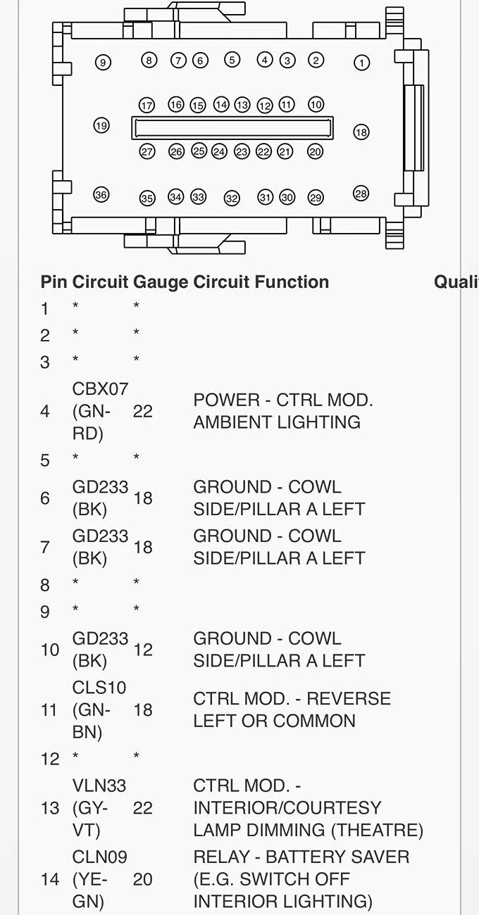

Bronco:
Ford Bronco Anyone been in the BCM lately? Speed Turtle module compatibility IMG_4128
Ford Bronco Anyone been in the BCM lately? Speed Turtle module compatibility IMG_4129
Ford Bronco Anyone been in the BCM lately? Speed Turtle module compatibility IMG_4130

Thanks for the chime in.
That's bonkers. According to both pinouts, the device should not work at all 😅
It's a flasher (emergency strobe) module, so parking/head/brake/turn signal lights should be all the circuits it affects.
According to that pinout, the Bronco would be in goblin poltergeist mode: locking/unlocking the doors, flashing the interior and ambient lighting, locking and unlocking the tailgate and flashing JUST THE LEFT rear reverse light. 😭
