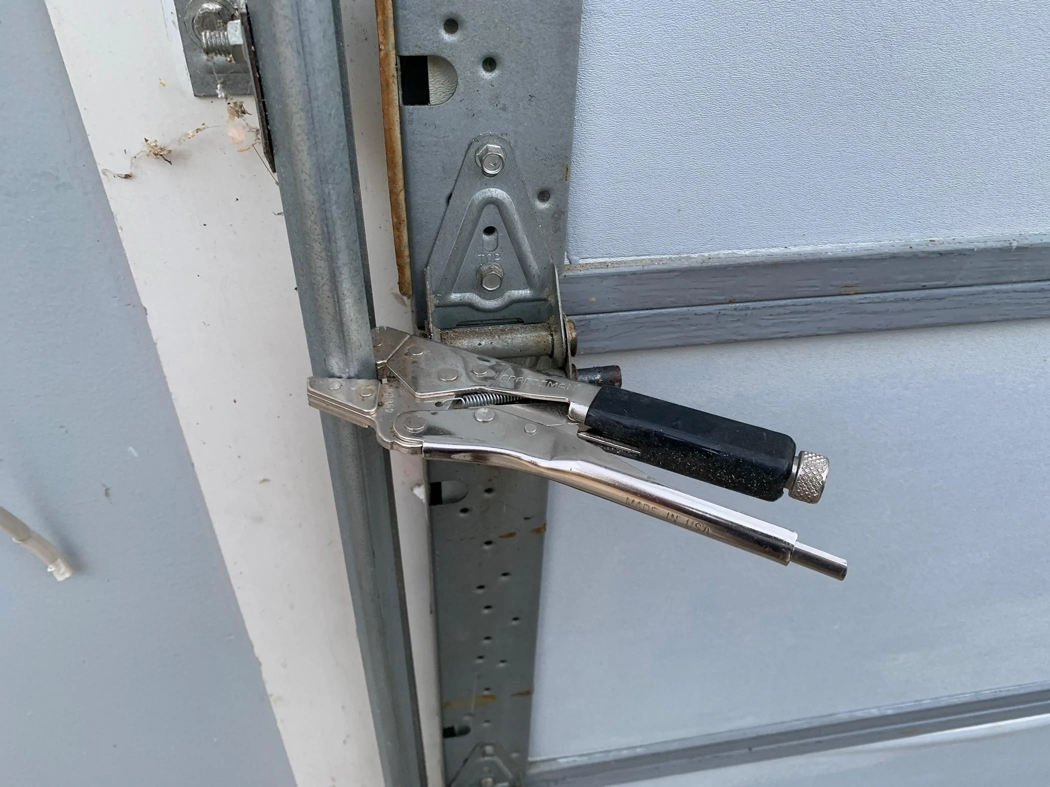

Ford Bronco Any tricks to "locking" a garage door open? IMG_1980
This works great, easy on easy off. It will lock it so it won't open, or if open it won't close. Just place above your hood or as high as you want above your hood. I know someone else stated this already, I figure I would just ad a picture

I would have pre cut wood that fit tracks for each side between floor and first roller. Place in track and clamp in place or have pre drilled and a single bolt through board and track. This will guarantee door can’t come down. Never relying just on a vise grip holding weight of door should spring break, which it will one day. You also won’t be relying on door motor or any sensors.

Safest bet….just unplug and disconnect battery if on backup. Putting blocks/restrictors in or on track could spell disaster if the obstruction pressure sensors not working right then you’ll have entire door come off rail and fall on who knows what!!😬
