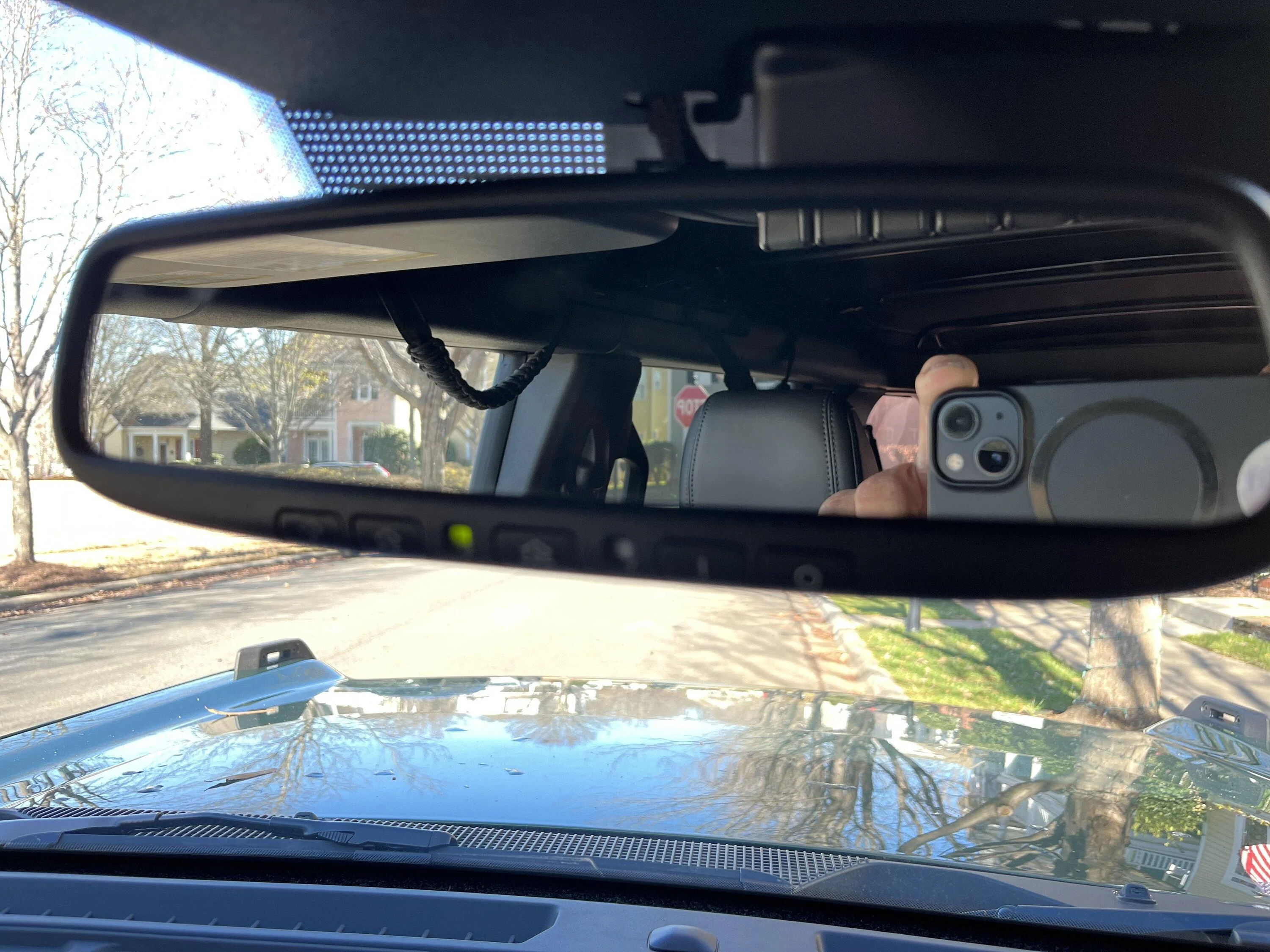

Ford Bronco Garage door opener? 1A307407-305A-4E97-B709-5CF34ADD0951
I added a Gentex mirror with Homelink. Cost me $40 on eBay and took 10 minutes to swap out. Looks totally stock.
That sounds like a great solution and dots look like it could be original. Well done! I didn’t get the lux and I’m not willing to spend hundreds of dollars for ford’s Homelink visor. Is there to the compatible mirror and any installation instructions for the bronco?
It’s a Gentex 453 off a Nissan Altima, only has 3 wires. Ground, one pos for Homelink and one pos wire for auto-dimming. I wired both pos to the keyed power in the back of the bronco mirror. Soldered and heat shrunk my leads. Done.
