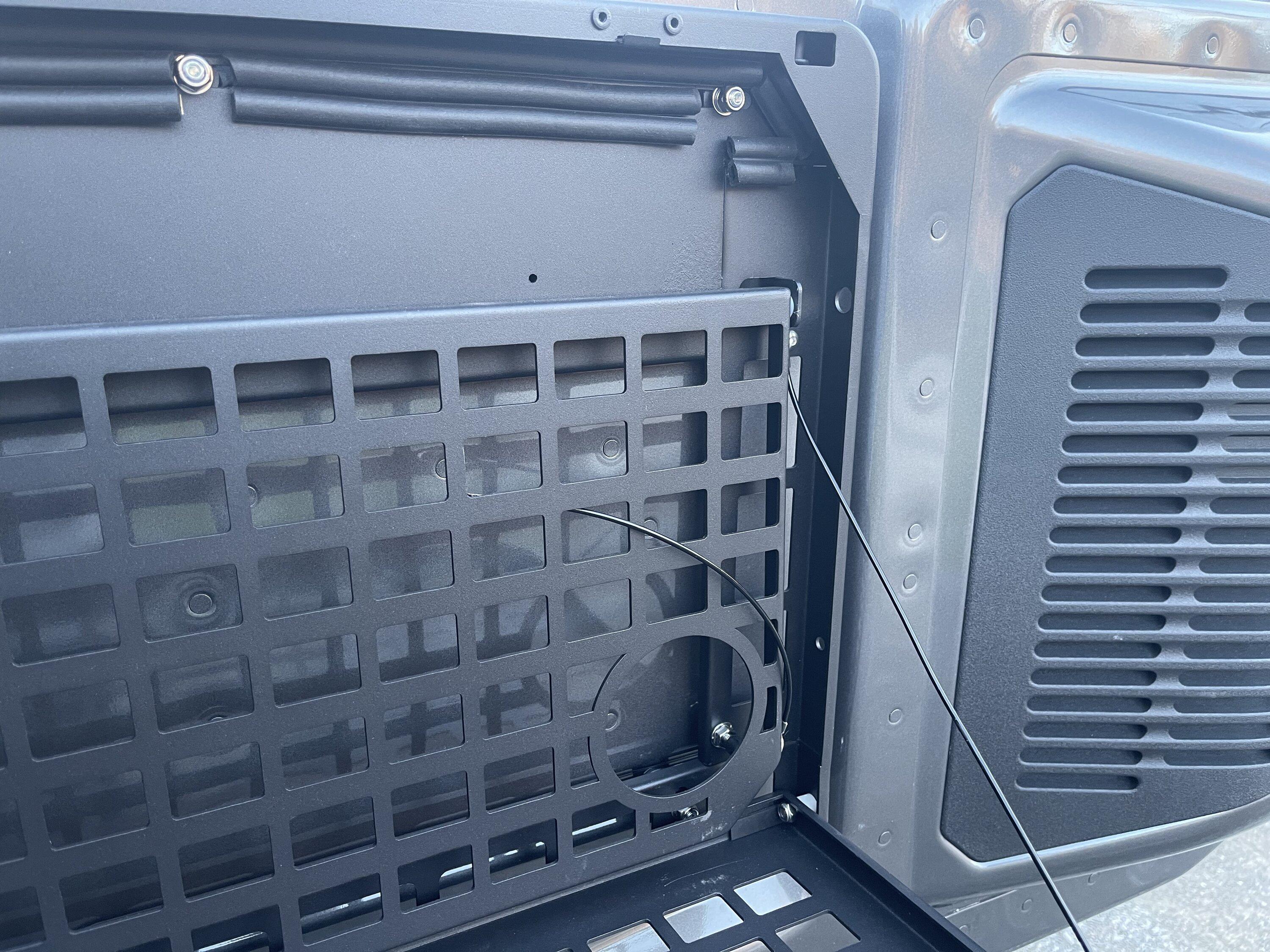

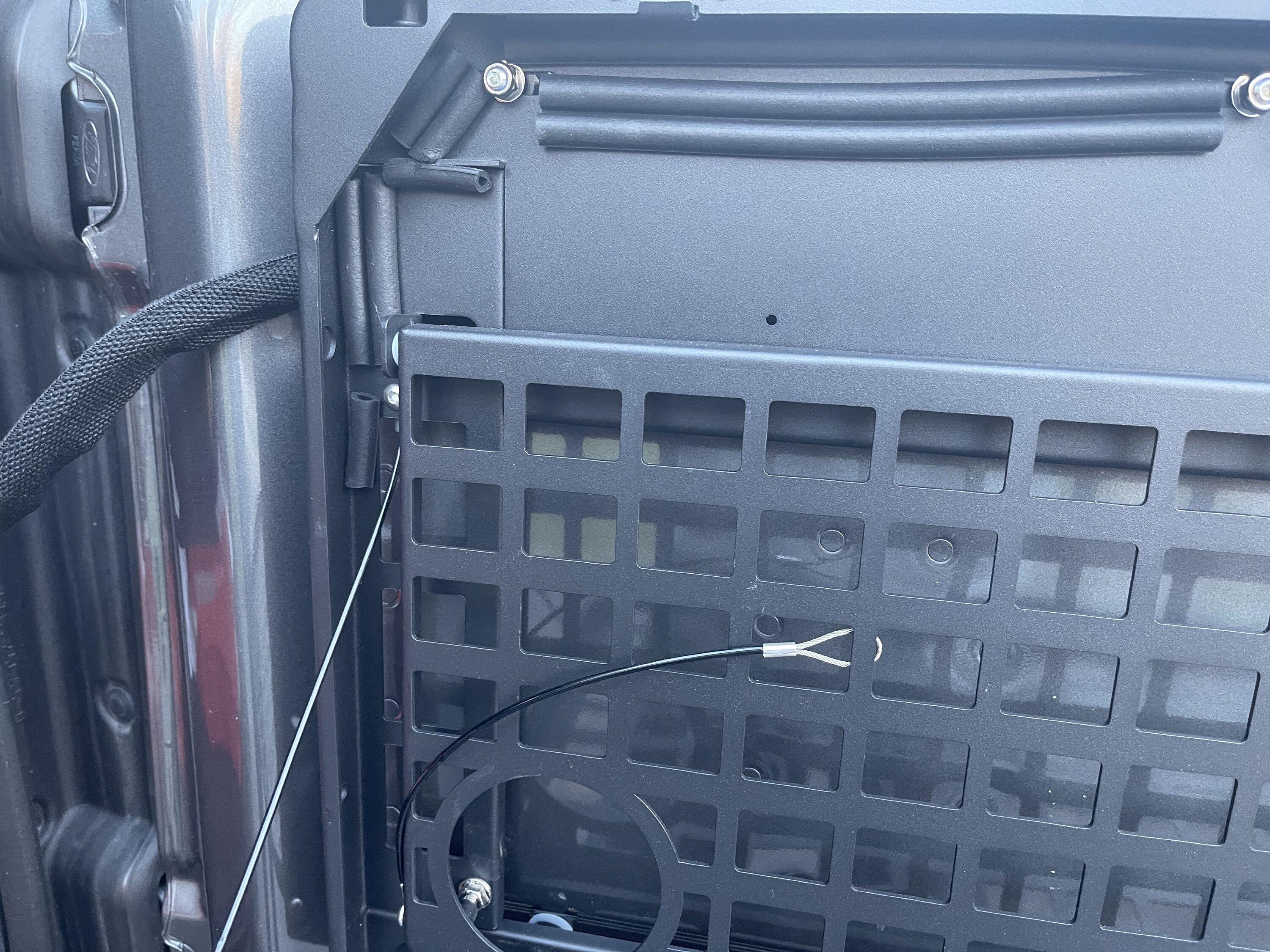

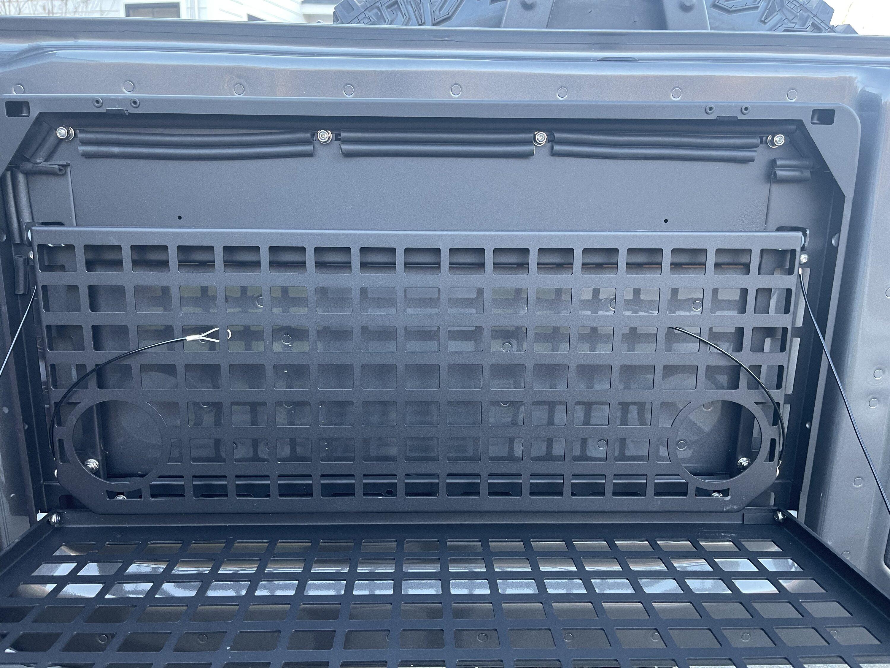

Just ordered the folding table and wondering about rattling. Anyone have one installed? Just wondering if I should rig up some rubber stoppers to insulate vibration or if I should even bother.
I put rubber adhesive backed strips around the interior perimeter. Worked like a charm.
