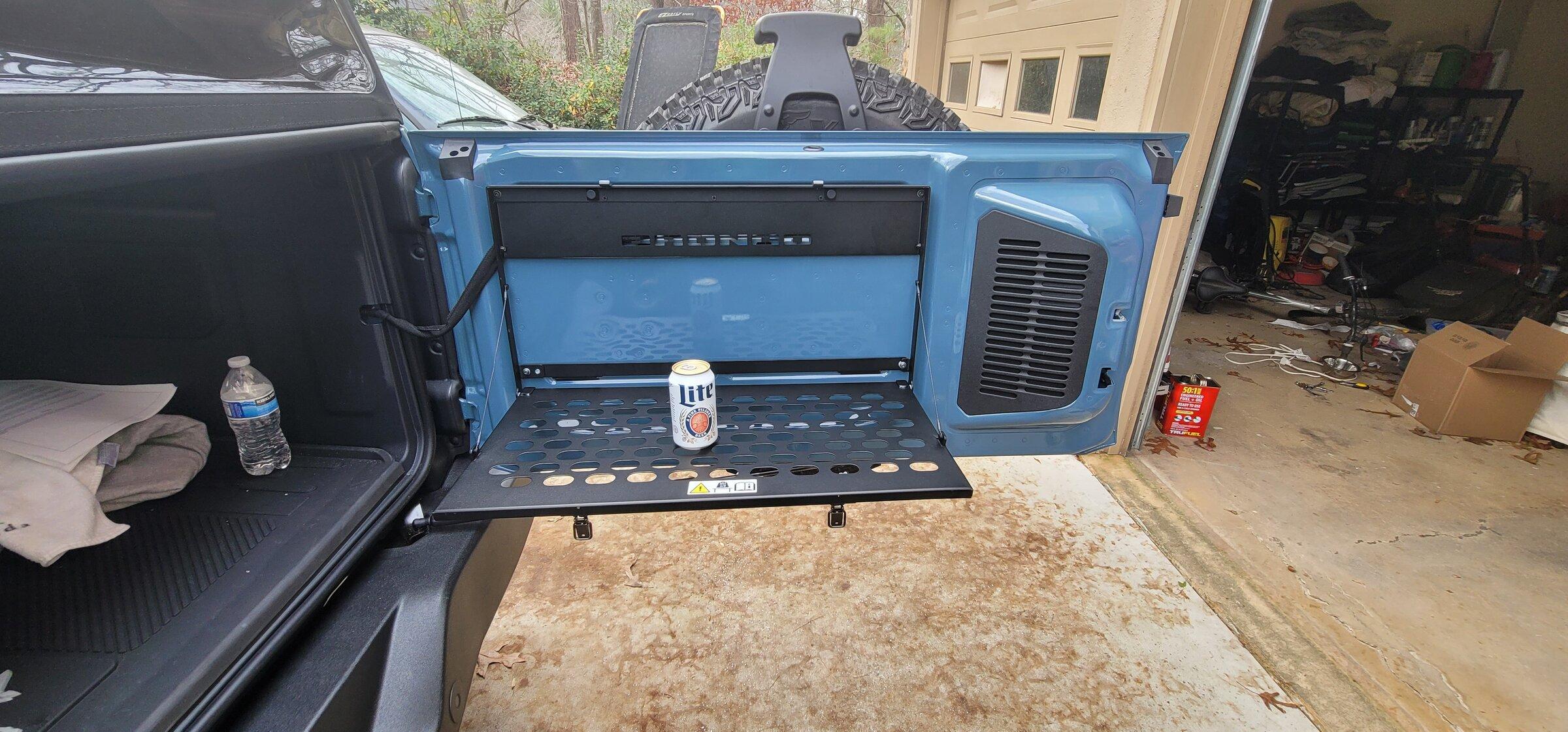

Any suggestions on how to get the last jack nut tight? The last one will not set all the way.
SAME ISSUE I HAD FIRST TIME I TRIED IT. PROBABLY IS FUCKED, TAKE IT OFF AND ATTEMP TO SET IT WITHOUT THE TABLE ON. IF IT WONT IT WILL NEED REPLACED. SORRY ABOUT THE CAPS, I AM ON MY WORK COMPUTER AND OUR SYSTEM ONLY USES CAP LOCK.
Thanks. How did you remove the jack nut to replace it?

Ford Bronco Any rattling issues with Ford Folding Tailgate Table? 20211228_142213
Got it installed. Had to use some needle nose vise grips, but got the nut locked down.
What? You can't and should not try to set the nuts while attaching the table! That's what the holder tool is for!
