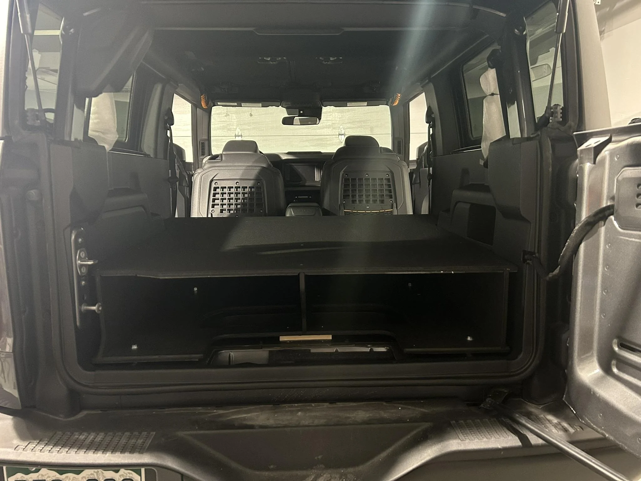

I couldn't find the right aftermarket solution for my rear cargo area (plus I'm cheap and like using tools in my driveway), so I took the common "flat load" or "goose gear-ish" ideas and modified to better suit my needs. Some key design considerations:
  1. Cost efficient: While I don't consider myself cheap, I refuse to pay a 10x markup on something I can build myself.
  2. Flat load surface with more space for cargo:
    • Honestly, it's embarrassing that I got more cargo utility out of my Prius than the Bronco before removing the rear seats and adding this platform.
    • Yep, 8-10' sticks of 2x4's or PVC pipe fit in the Prius better than the Bronco still... but that's what multiple vehicles and trailers are for I guess...
    • My last Bronco was a '90 that had so much more cargo space (especially since I kept the rear bench out most of the time).

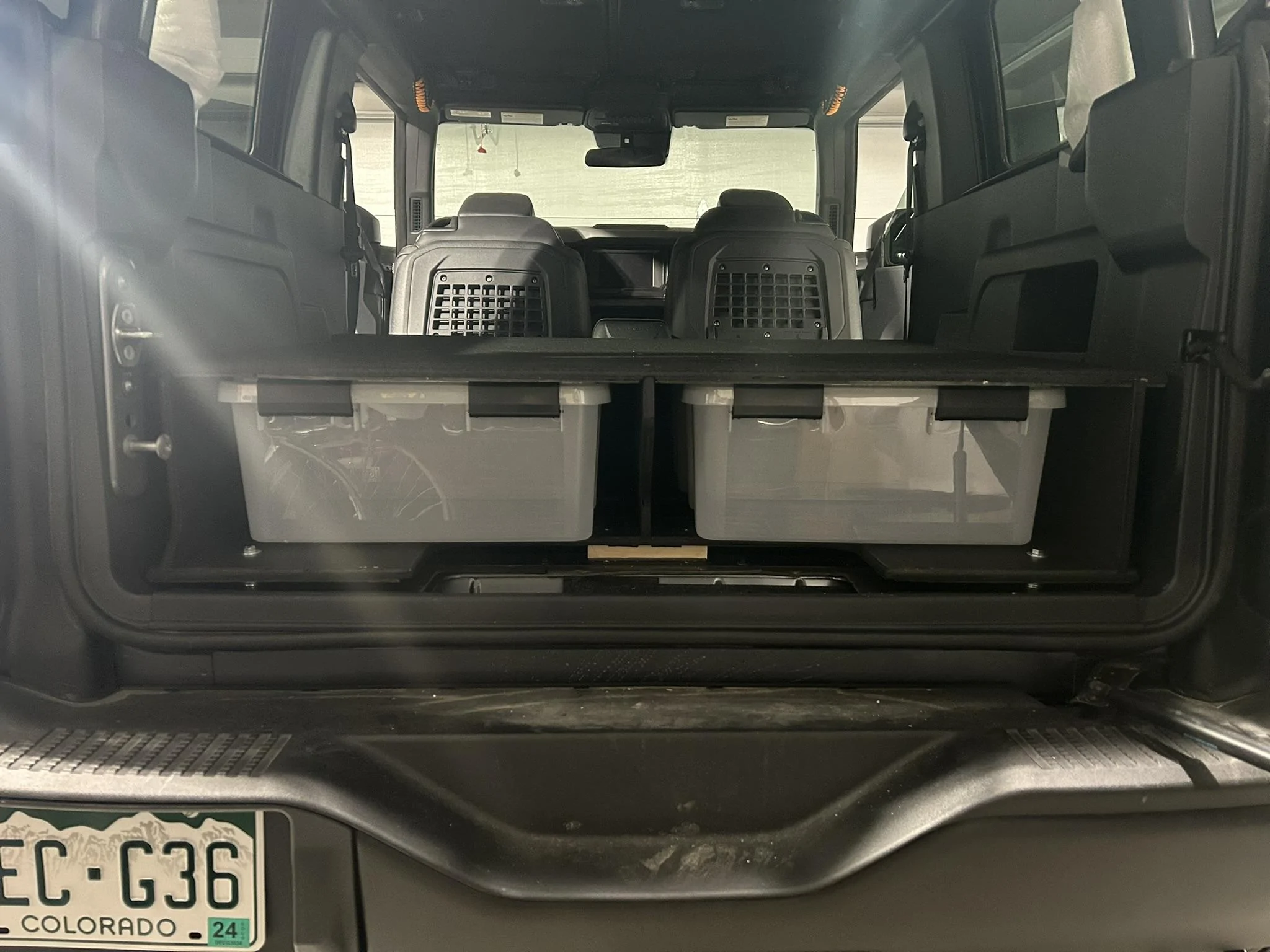

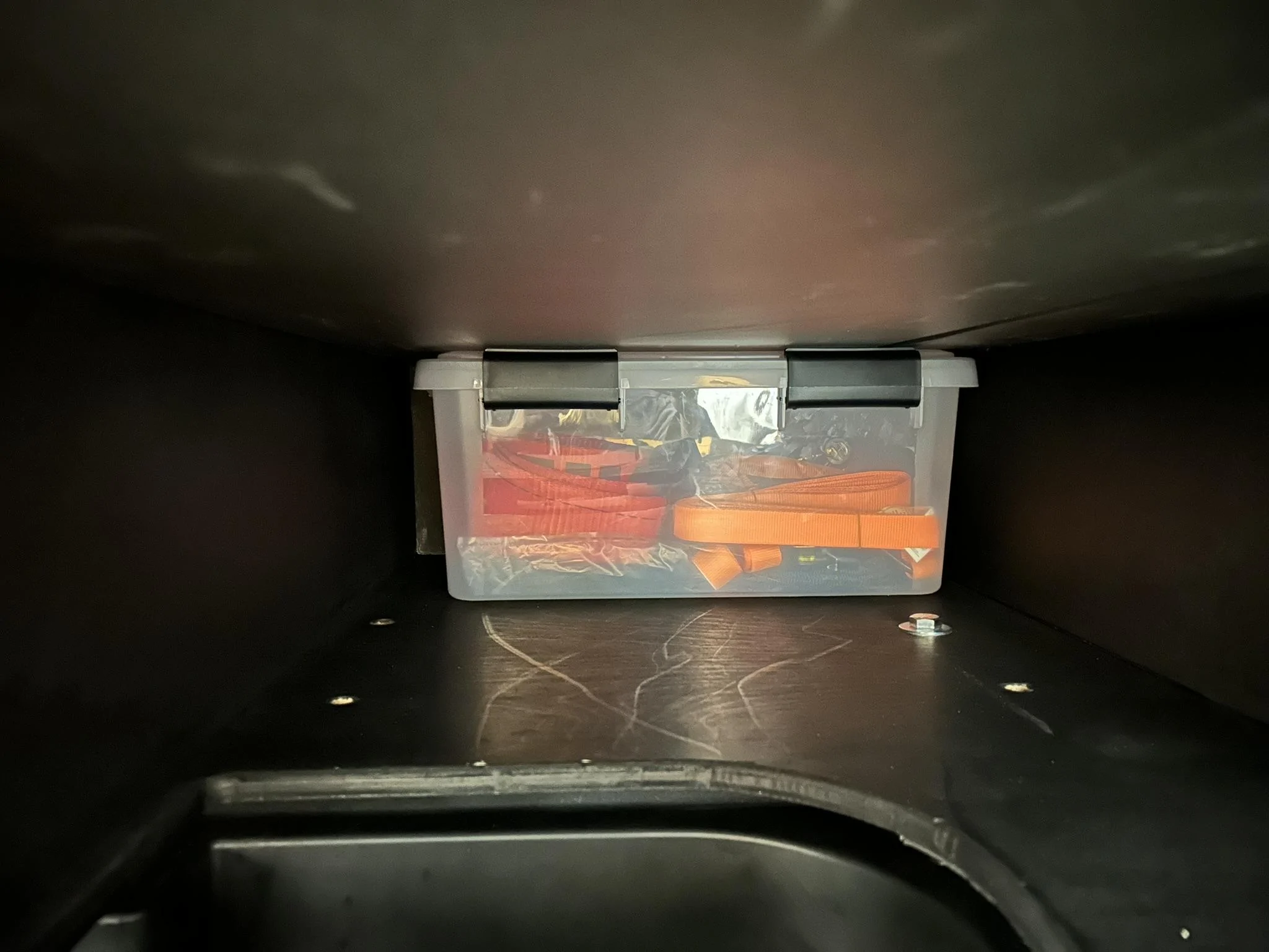

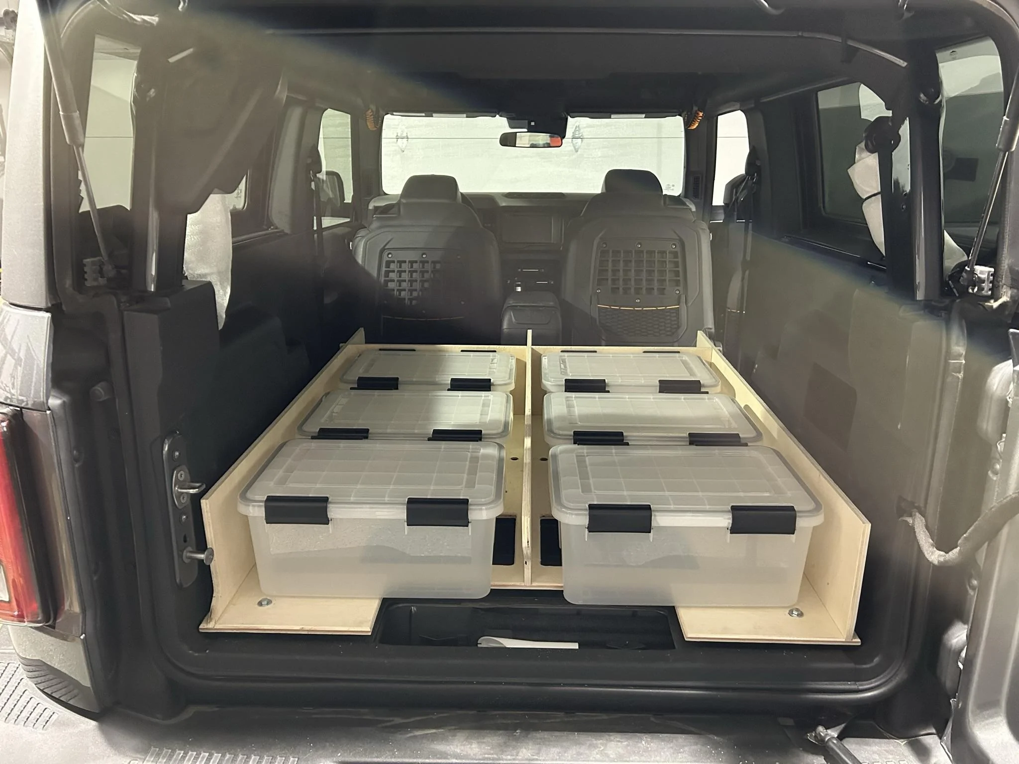

  3. Additional "stowed/permanent" storage capacity for recovery gear, camping gear, groceries, etc...
    • I tried keeping a tote or two in the cargo area for a while, but loose totes just fly all over the place and mark up the tissue paper quality interior panels.
    • I wanted to keep totes instead of drawers since those work well for camping (pull a tote and bring it to the picnic table).
  4. Secure storage area for when the roof is off (most of the summer unless there's an out of town camping trip).
  5. Retain quick/easy access to the sub-floor storage compartments from Ford w/o hinged compartments/latches/fumble ducking around

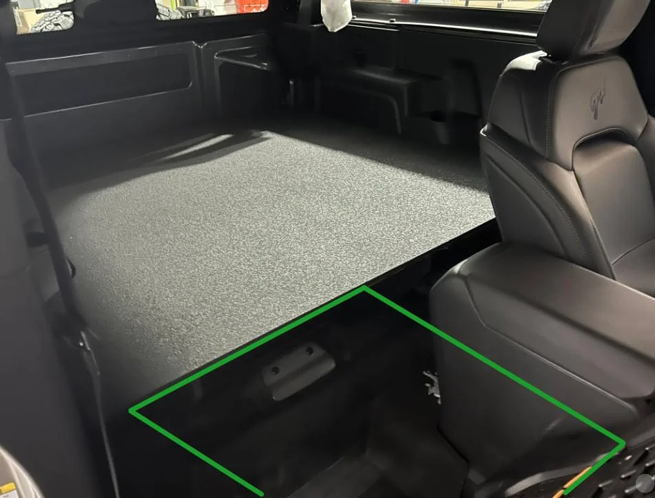

  6. Ability to sleep 2 people (while I typically tent camp, a quick overnight stopover in colder weather is easier in an enclosed vehicle than busting out the tent).
    • I'm Mitchell Watts and I'm 6'3"... ok not really, but I am 6'2" / 215 lbs and this works for me +1 much shorter/smaller camping companion.

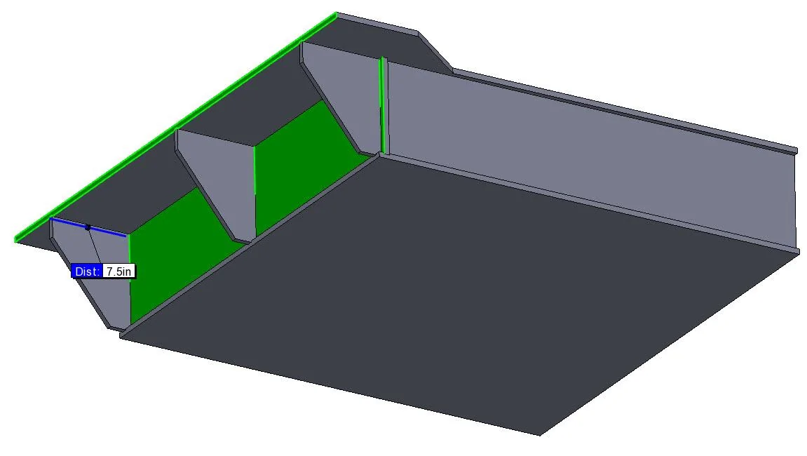

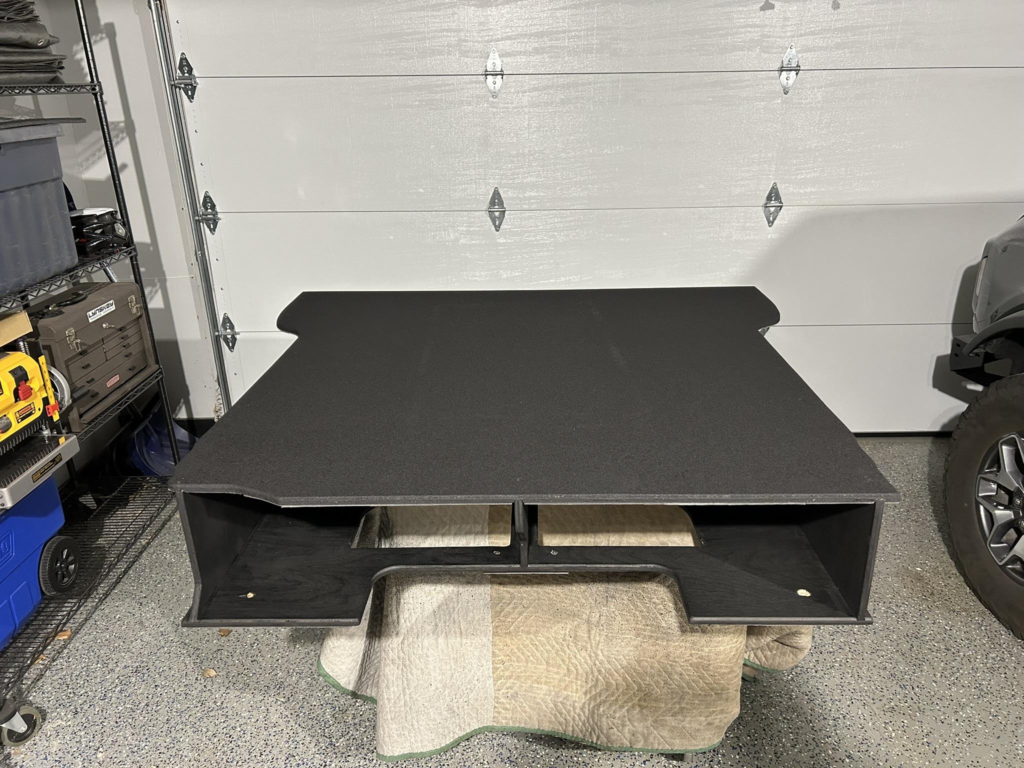

I've included a few pictures here of the almost final product and build process. Not yet pictured are the "drop in" sleeping panels that will bridge the gap between the permanent top sheet/platform and folded front seats. Please feel free to ask questions, but here's a few topics I'll try to anticipate ahead of time:

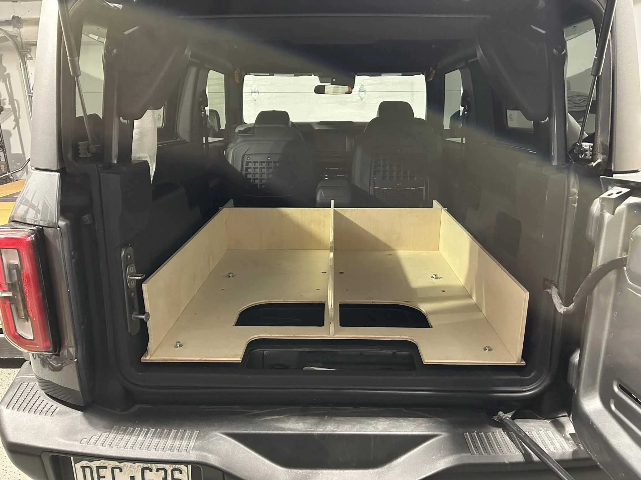

  • QTY 2 - 4x8x1/2" birch sanded plywood sheets ($120)
  • Wood glue (on hand / $10)
  • #6x1" wood screws (on hand / $5)
    • note, you can stop here if you want to keep it simple
  • wood stain (on hand / $15)
    • used for the bottom sheet and vertical walls of the enclosure
  • bed liner ($53)
    • I used one full can of Bully Liner for the top sheet/platform only (sourced locally at Walmart): https://www.walmart.com/ip/Bullylin...XiUI&athancid=884238998&athposb=0&athena=true
    • bare wood / stain / carpet / horse stall mat / your bed liner of choice are all acceptable alternatives
    • I would have loved to use HDPE or another similar material for the full enclosure, but the lack of available local options and overall price after shipping didn't compete with the simplicity of wood with a couple coats of Bully Liner

  • QTY 6 totes ($90)

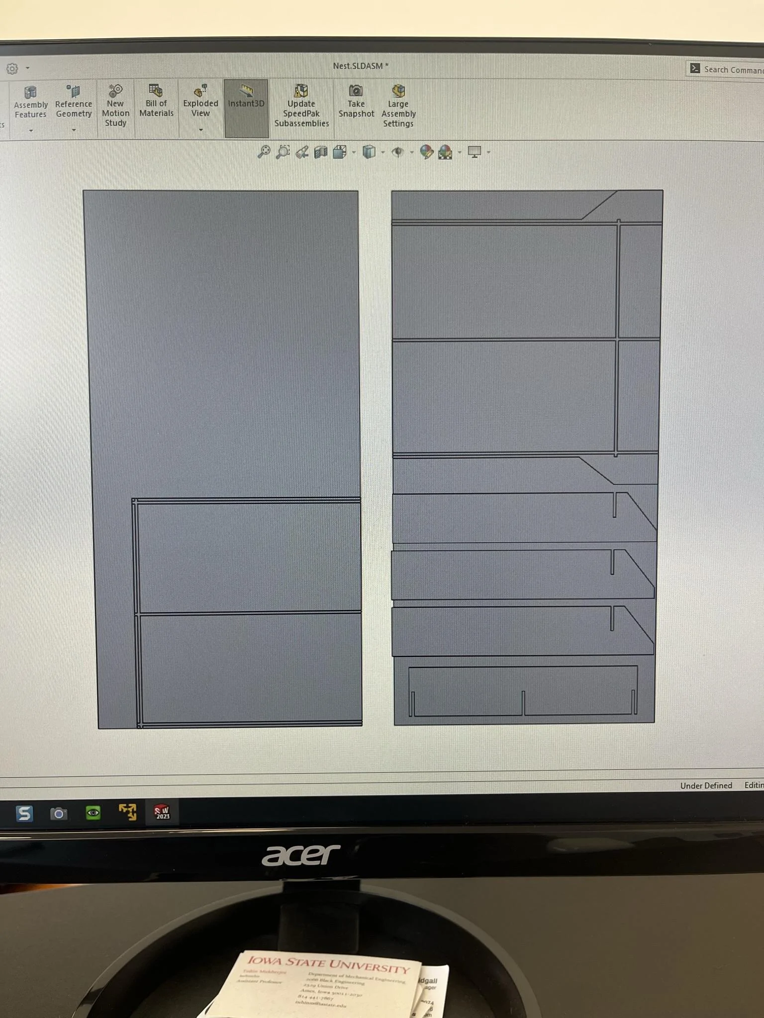

  • solidworks for design

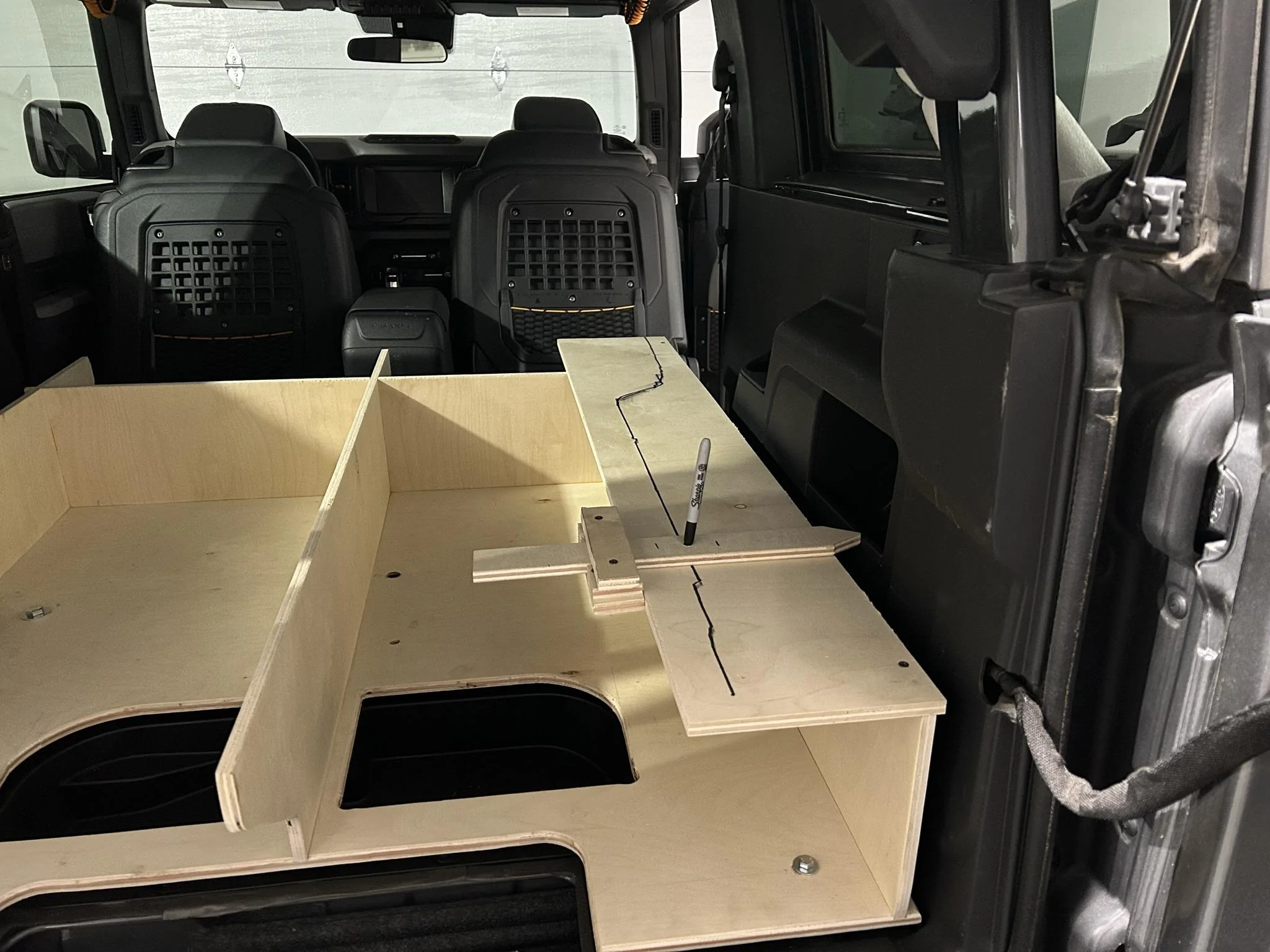

  • custom "tracer" made from wood scraps, but a compass would also work great

Post a follow up with picture when you get the "drop in sleeping panels". Also, do the front seats tilt all the way back?

Will do.
I chose the maximize the length of the platform at 48", which means the seats will not fully recline at the rear most slide position. But, they do still reach the slide end of travel in a comfortable tilt position.
Reducing the platform length by 7.5" would entirely remove the overhang and likely still allow for full recline at the rear most slide position. That would also simplify the design/fabrication quite a bit if you're willing to make that tradeoff.

I like it! Curious how you plan to make sleeping arrangements work. Hammock strung up to the windshield? Very nice job. I like making stuff too.
Thanks! The sleep panel will drop where the green box is below. The plan is to use the titled seat as a headrest and drop in my thermarest directly on the platform (no hammock required, but that would be an interesting option, especially with the top off).

Very clever. Now I got to get the tape measure out to see if my six foot wife would fit. And then figure out where to store the back seats. Thank you for sharing.

Very cool! I’ve been thinking about building something very similar. Love it!
I built a DIY raised platform a while back that fits 3 storage boxes and still allows access to the underfloor cubbies. However now I’m itchy to delete the rear seats and change it up.
I’m daydreaming about a very similar set up, including the passenger drop in sleeping box. I’m considering removable covers for the underfloor cubbies and the ability to easily remove the top raised platform section, but haven’t figured that part out yet. This way I can run a basic carpeted rear platform most of the time for the dog / life and then drop in the raised platform for wheeling / camping trips. Not sure I can pull it off to my satisfaction. I’m a fair carpenter but not at your CAD design level. 🤪 Smart sharpie jig.
- Did you build the drop-in passenger sleep box?
- Any leaning moments with the platform now that it’s done?
- Any clue how much it weighs?
- Was final assembly competed inside the truck? I’m just thinking about how you would remove it if needed.
