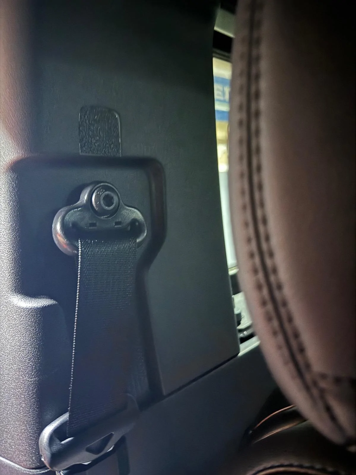

Ford Bronco Annoying rattle over driver side left shoulder IMG_1688
Dan-O
Dan
Jun 19, 2023
620
705
Fountain Hills, AZ
Pulled plastic seat belt shoulder bolt cover off and put 1/8” adhesive backed foam rubber on back of cover and snapped back in place…….killed the rattle completely!
