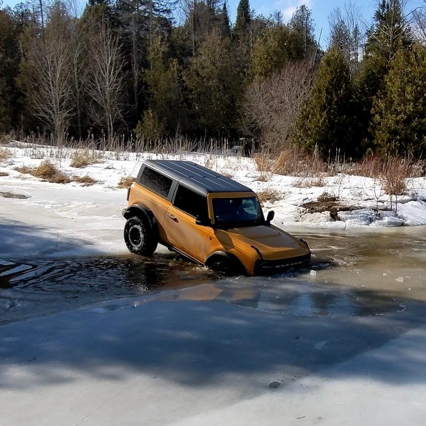

The alternator is located on the bottom of the engine. My understanding is that Jeep and the Land Rovers have them on top of the engine. Apparently if the alternator gets wet, it will fail. Ford advertised a 33.5” Water Fording ability but the alternator sits below 33.5”. This is a major problem for those that bought a Bronco with the thought of taking it off-road. The Bronco is a very good trail vehicle but any mud, puddles, water that reaches the bottom of the chassis should not be attempted. This is very frustrating. I sold my Defender 110 and purchased a Badlands to be my new daily driver/trail vehicle. I don’t even know if there is a way to fix this as it is not likely to have a new mounting location for the alternator. I presume we will see the water fording numbers to significantly decrease.
Is my alternator under water here? 🤷🏻
They can get wet, pretty sure...
Smart alternator, brushless (obviously), exciter/induction. I think if you get muddy water in the bearings, it'll fail. Otherwise, you're not doing it any favours but it'll still work.
