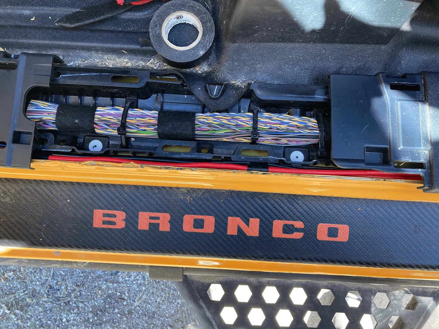

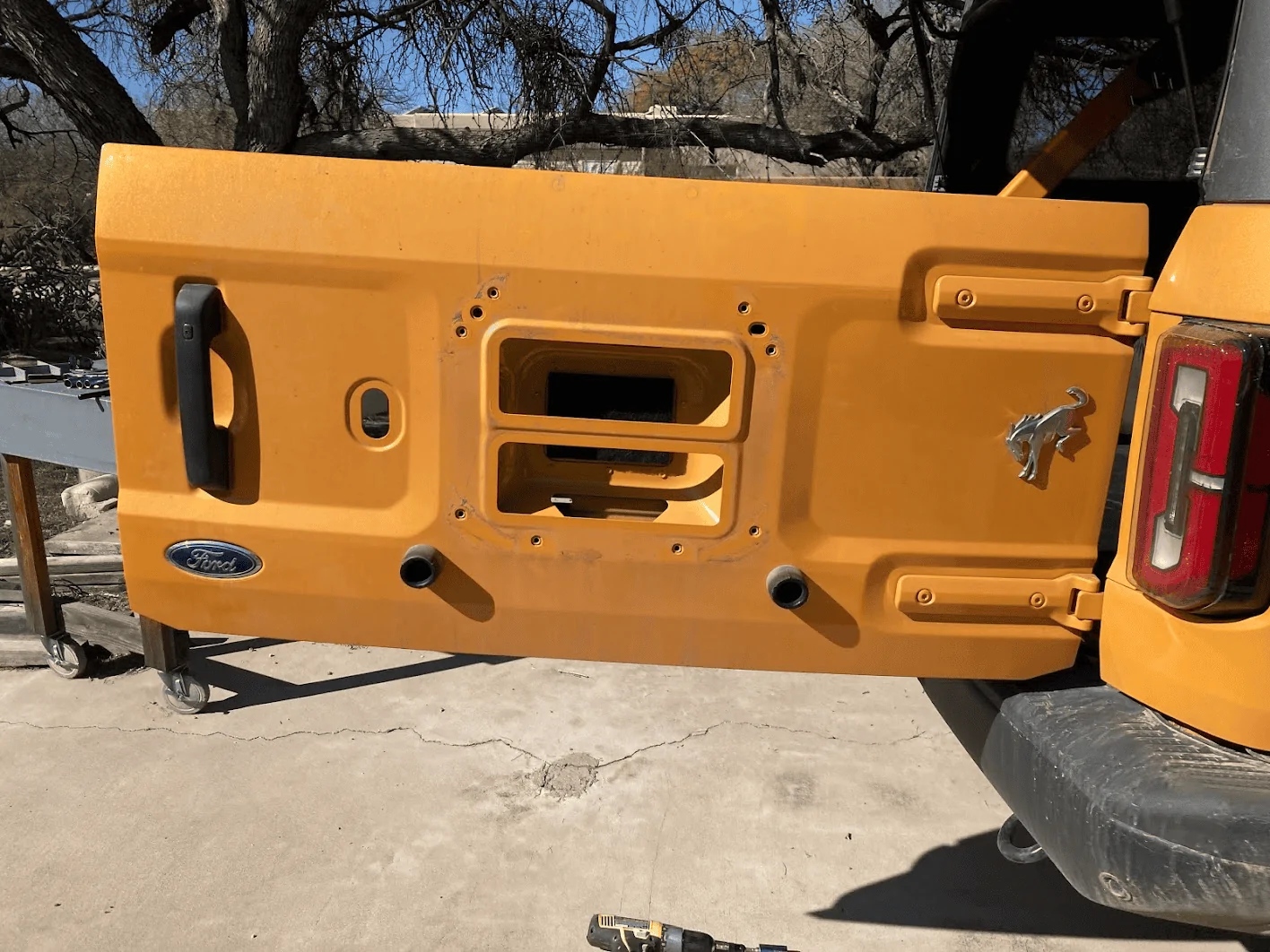

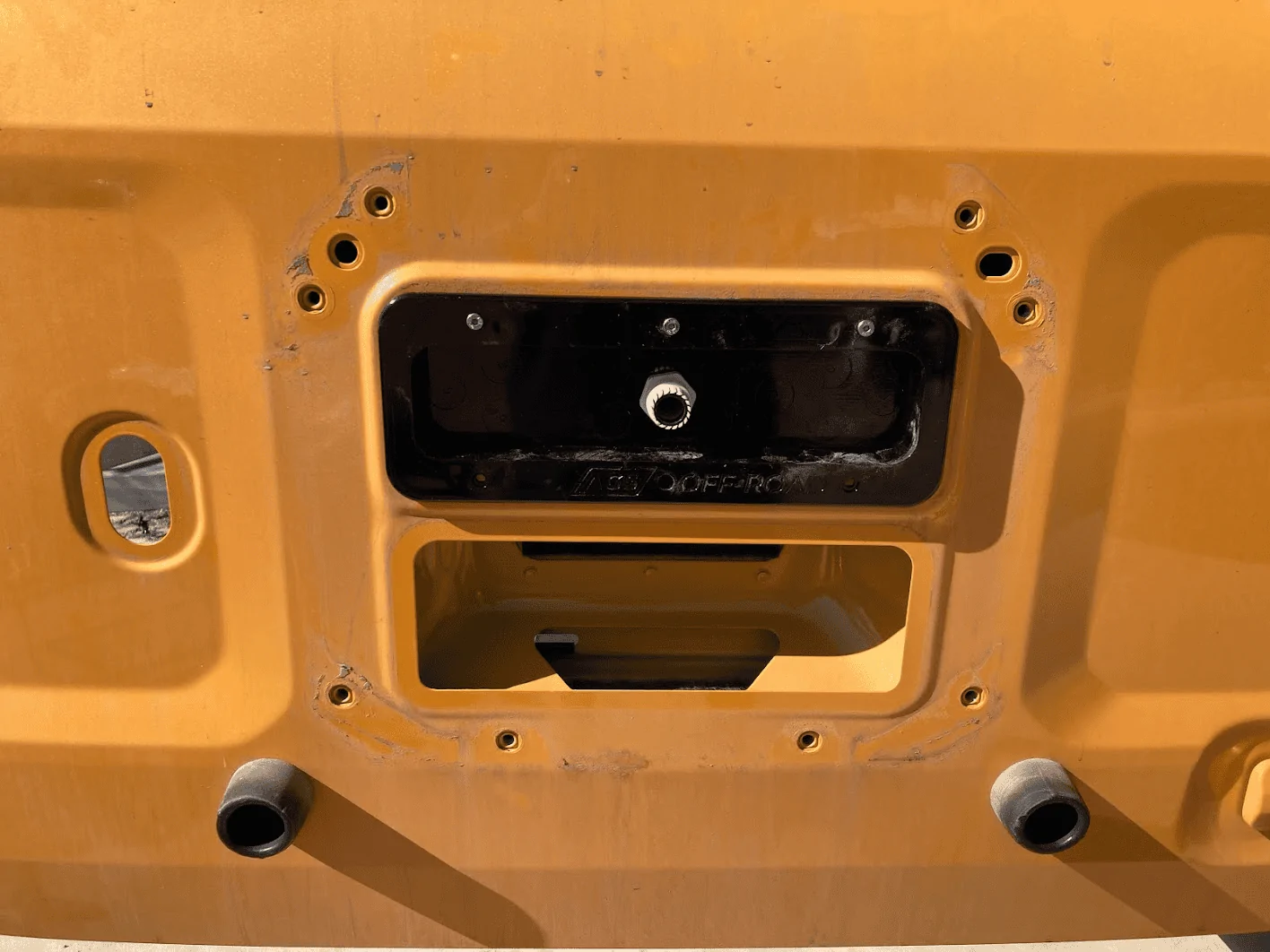

So I'm finally done. I had already installed the Expedition Essentials (EE) extension harness back around August and I installed the tailgate reinforcement/compressor mount with my pop over Christmas. All that was left was connecting the ARB harness to the EE harness.

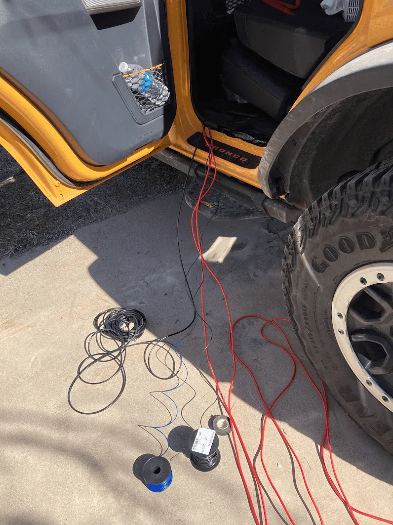

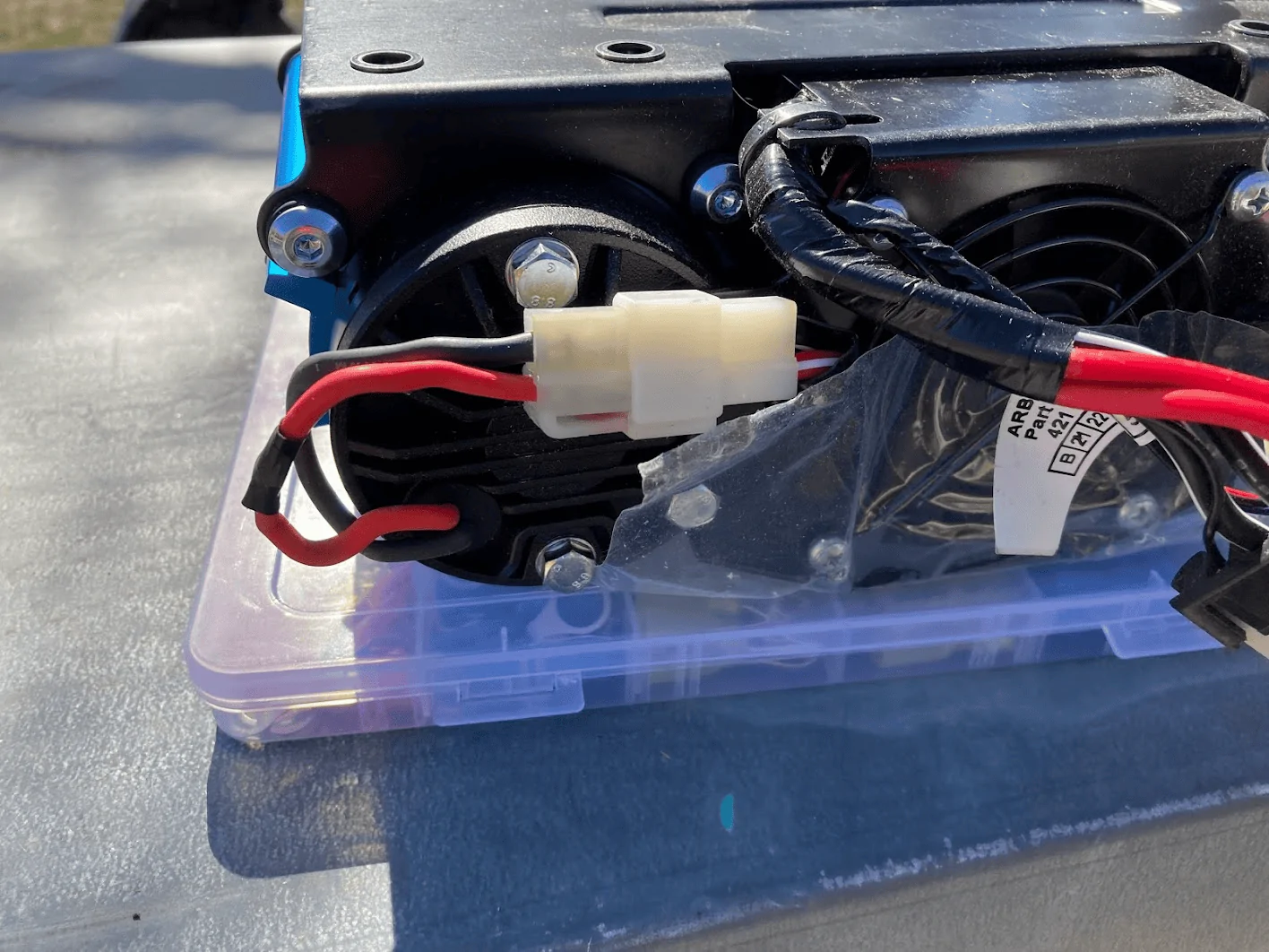

Today I pulled the plastic trim from the driver's seat up to the driver kick panel. I had already prepped my ARB harness by removing the connectors. And my wife helped me pull the protective sleeve off and then re-sleeve it with the switch wire bundled in. This was a huge pain in the ass. Huge! Very thankful for my wife's help.
Just a tip... For the switch wire, the ARB kit comes with a harness for how you would connect up a locker that has a matching connector for the EE harness switch wire. So I cut that connector off the ARB locker harness about 2" back and used a solder connector to fuse it to about 7' of 16awg. I took the connector off and lined it up with the other wires and pulled then all back through that protective sleeve.

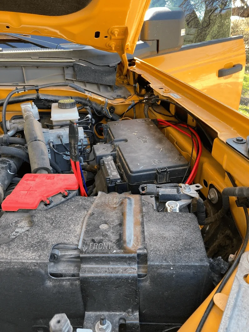

I pulled my modified harness through the firewall and put the connectors back on and they both plugged in perfectly to the EE harness. On the engine bay side I got my switch wire attached to upfitter #5, and then extended the two power wires and the ground with 8 gauge and ran to power and ground. Cranked the car and it came alive.

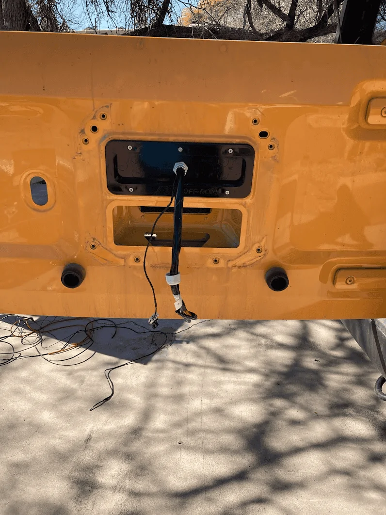

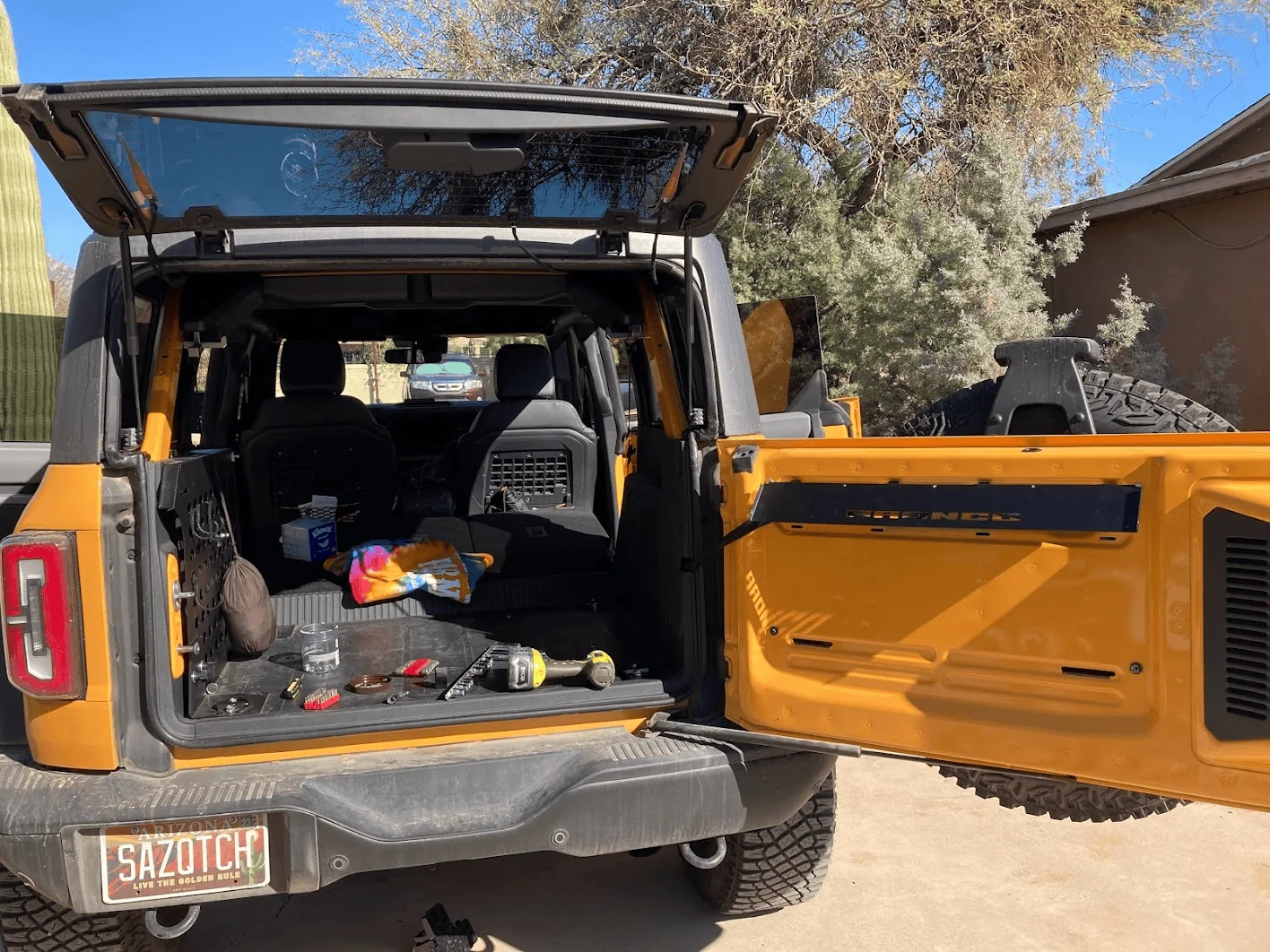

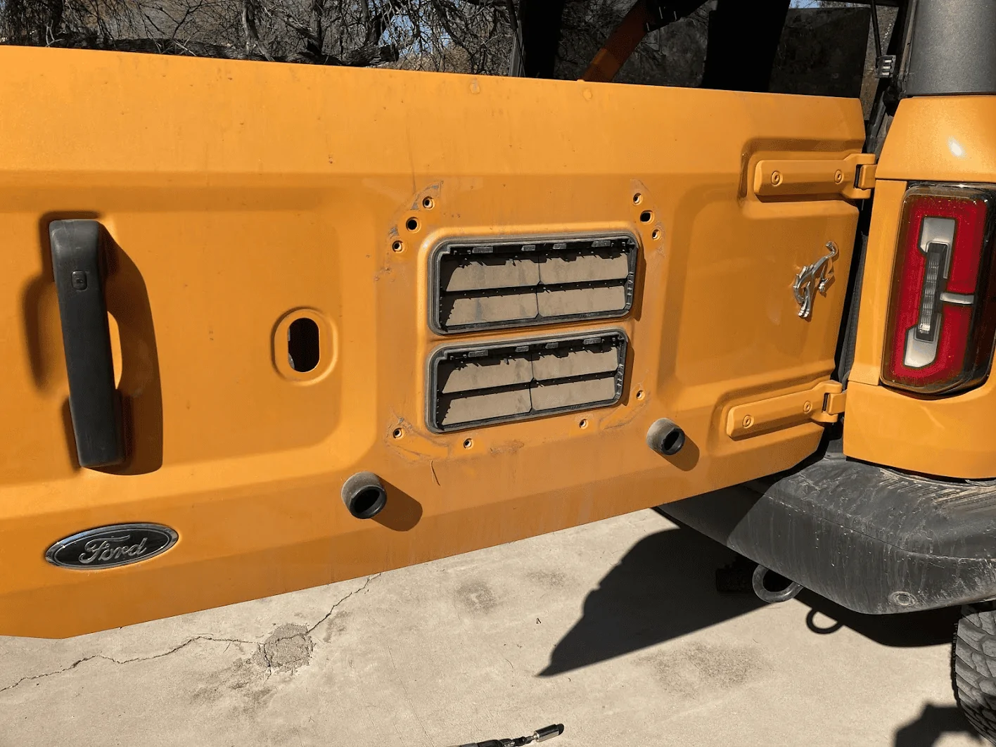

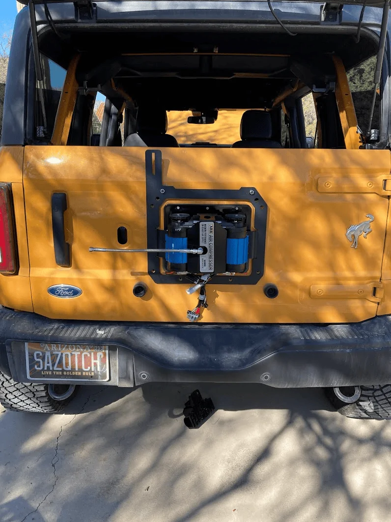

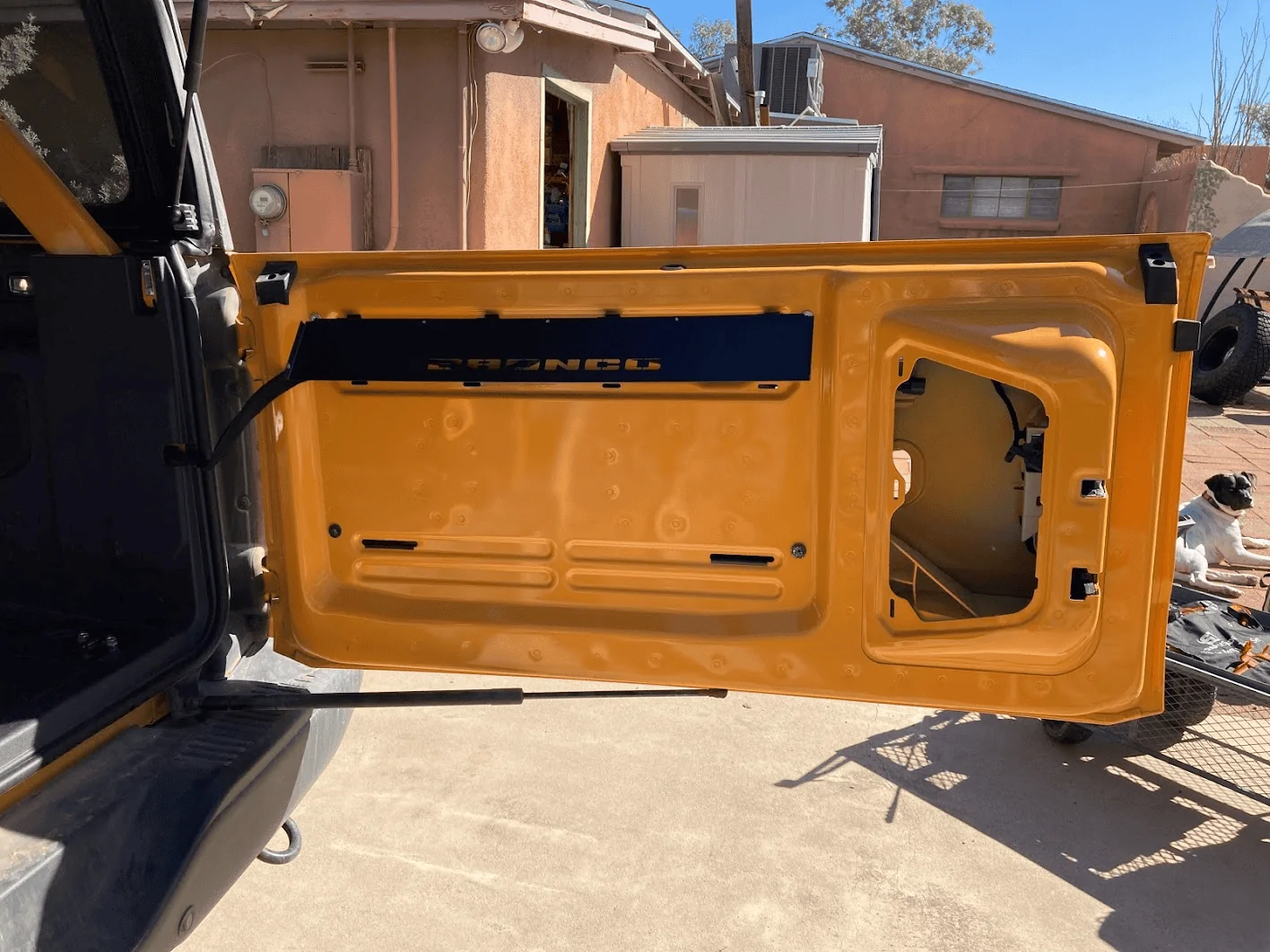

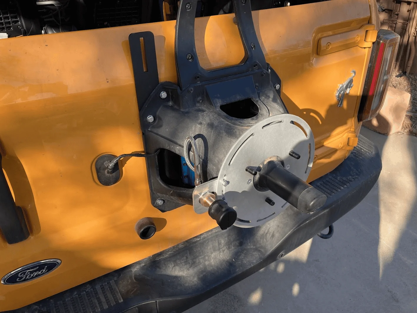

It came yesterday so today was like an ad infinitum of wiring. Install of the unit was relatively easy but I had to remove our Tuffy lock box and our tailgate table to do the wiring in addition to all the other little panels. Also, the ARB compressor I got on eBay looks like it had a tiny bit of usage but we didn't pay full price--just nearly full price.
I have to say the AGS install instructions (a video) were great and always explained tool sizes for every step. Burnt through my phone battery having to keep bringing it up but not sure written instructions would've been as good even though I usually prefer that.

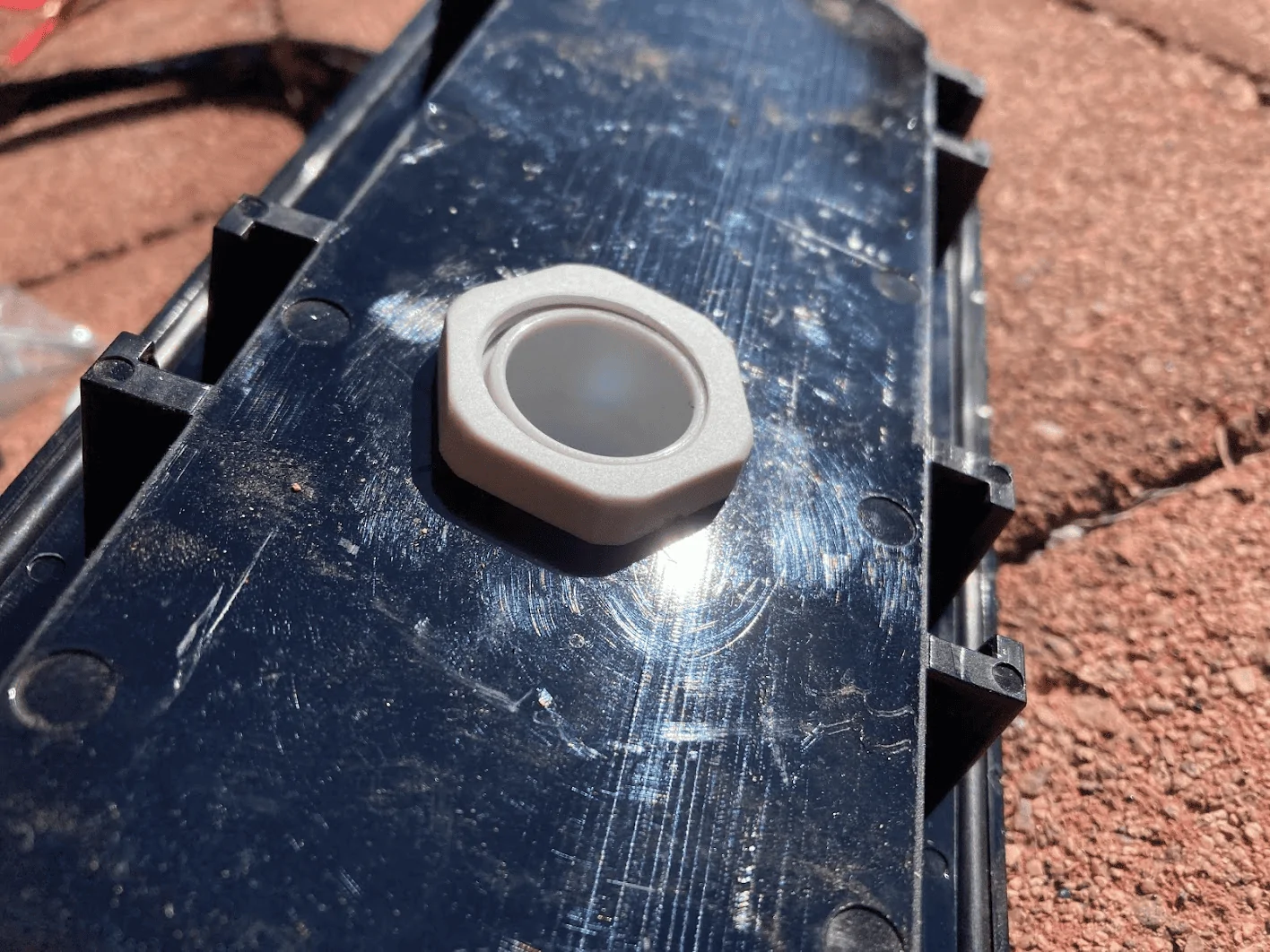

All parts seemed duly constructed. The only one that scared me was the cord passthrough gland. Just barely had enough thread to grab on the inside. I cleaned up my hole pretty good (eww) to be sure it wasn't some trash around the edge.

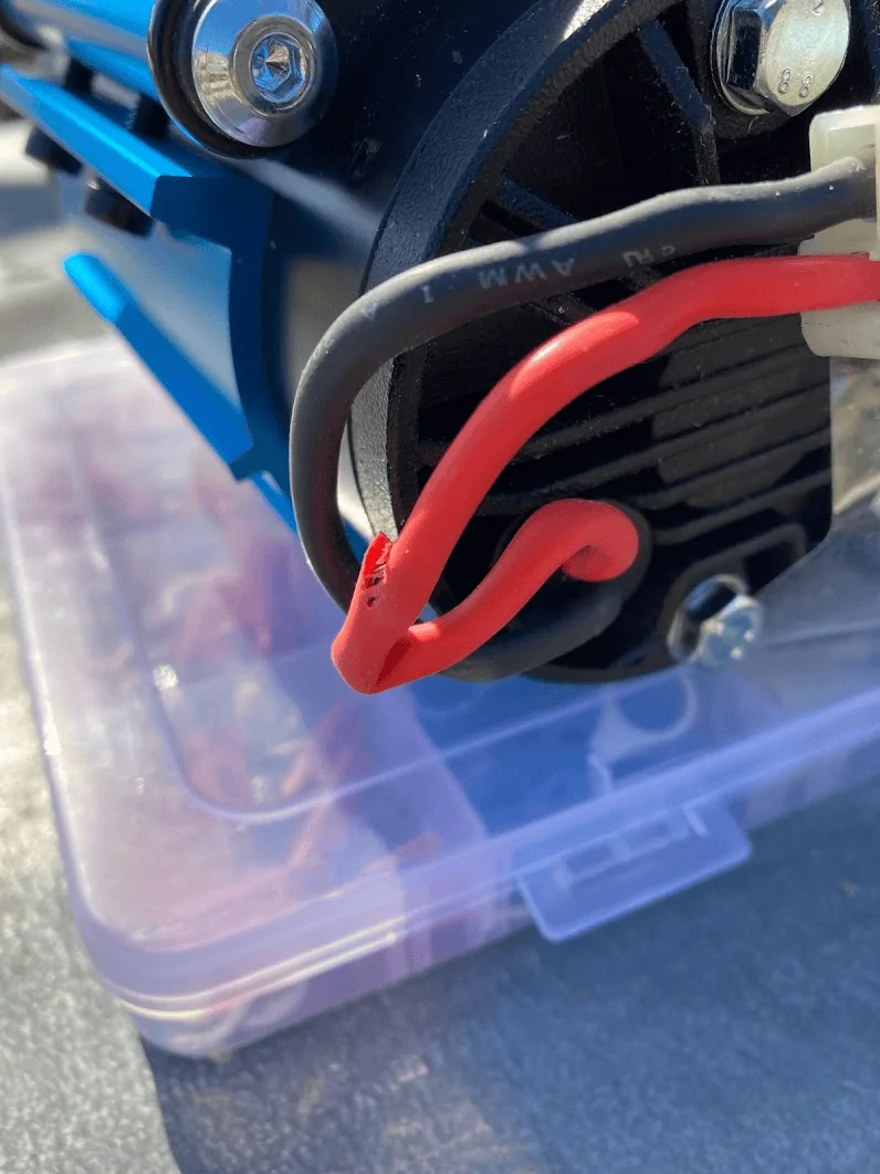

My annoying mistake was, although I was trying to be very careful to not have to depin the connectors by prerunning the wires, when I was done, somehow I had passed the large wire harness through the passthrough but I had not passed the small (purple wire) harness through so I had to depin that connector (only two pins thankfully but shame).
