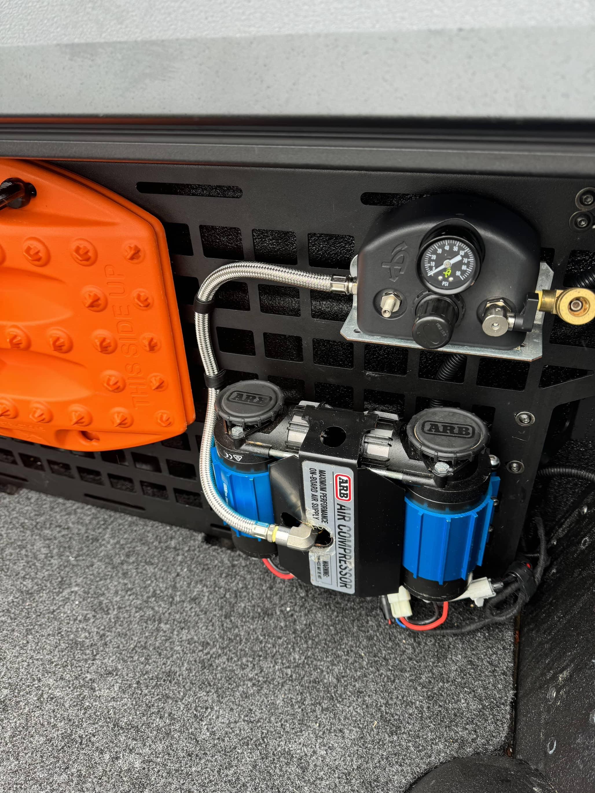

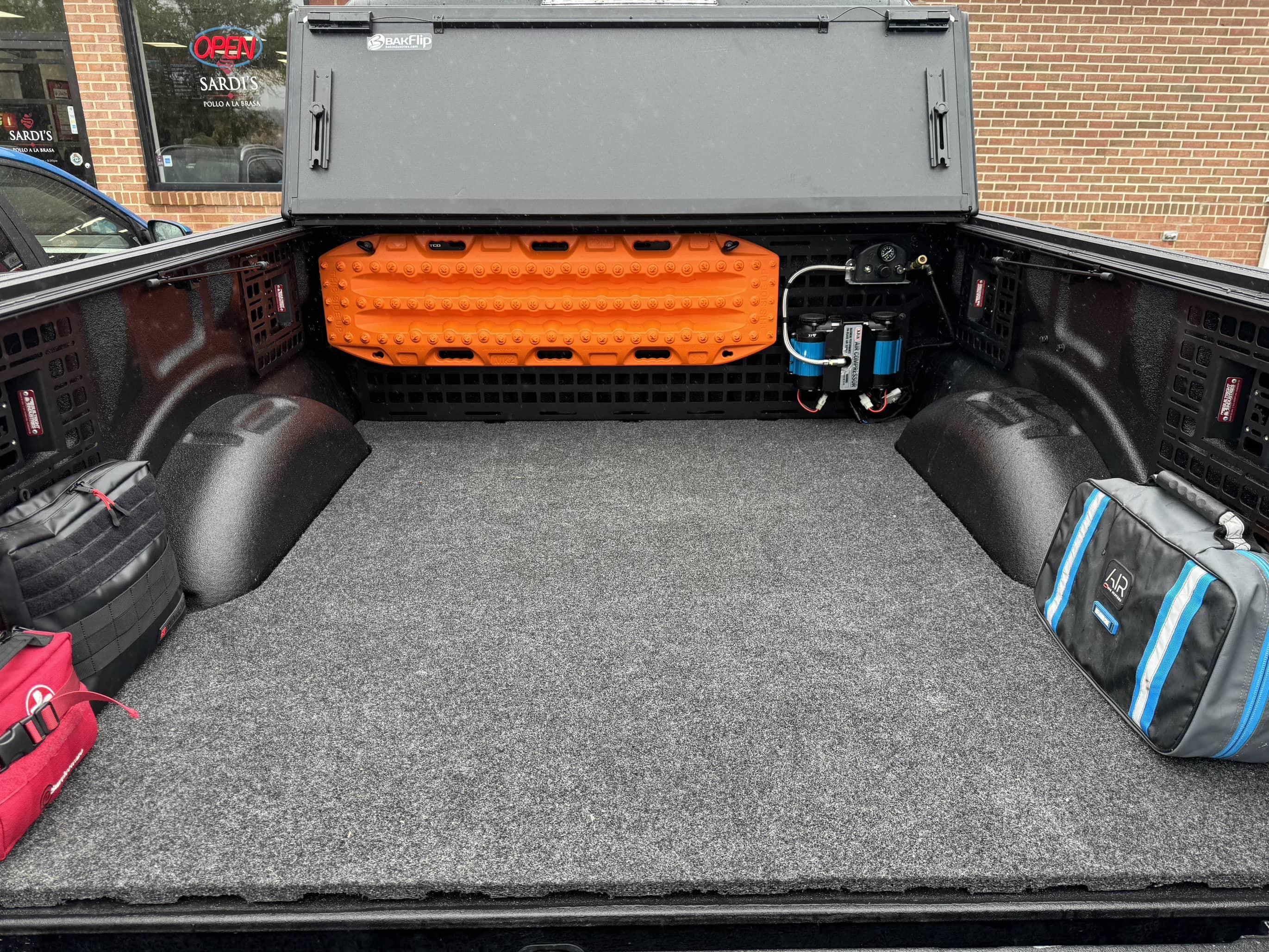

For what it’s worth, I’ve had this exact compressor in the bed of my F150 Raptor for years. No issues with the wire run and I used an extension harness initially and later cut it to size with WeatherPack connectors when I relocated it to a bedside molle panel. I never even blew a fuse with that setup. I’m no electrical engineer, but I can speak to a similar use case and share my experience, for whatever it’s worth.
I’ll add that the Raptor doesn’t have an engine mount option that I’m aware of so this is very attractive to me.

Thanks for the benefit of your experience. I haven't had any issues yet either though I've probably only used my ARB heavily 12-15 times.
But wow. What an awesome setup you've got in your Raptor!
I really envy all that panel storage surface not to mention the overall storage area.

Kudos on the nice, clean install. And the clean bed.
Your ARB is still inside an enclosed space against the cab wall (your bed cover encloses it). It is not mounted on the exterior of your bed gate. If it were on the outside of the bed gate, that would be a similar mount to the AGS mount. ... I do commend you on using a more protected location, in line with its IP rating.

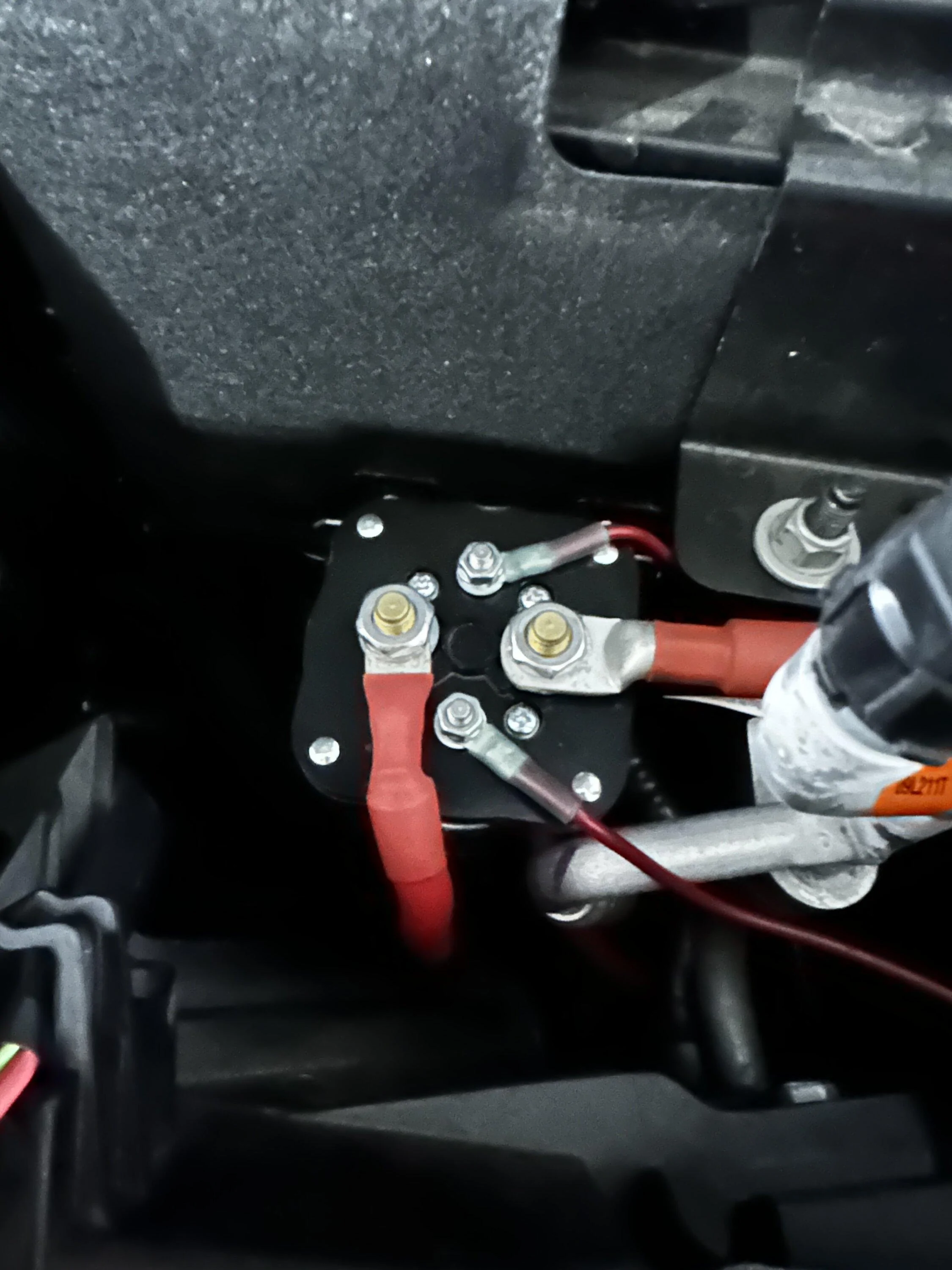

I was considering running power/ground/switch wire to a 500-amp Stinger relay similar to how I have run my winch. I’m assuming I can’t use the same relay and will need to have a dedicated relay for the compressor, right?
This is from my winch install. Winch power cable and upfitter switch wire in; power cable to battery, and ground out.

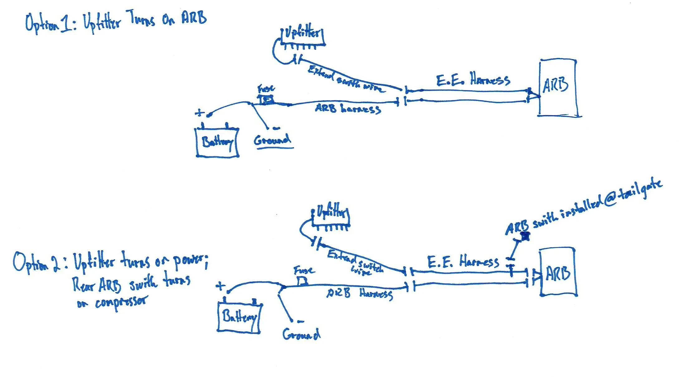

Please bear with my kindergarten grade schematic, but I thought a visual may be helpful. These are the two options I'm thinking through now unless there are other recommended options.
1) Your winch may have controls on it that would enable even a passerby to just start winching. That wouldn't be the case for the compressor assuming the switch is in the cabin somewhere as there are no such controls on the compressor itself. Just saying that. I don't think that's your concern but just wanted to throw that out there.
2) So, in early EE (I changed to CSc so that's all the EE I'm working with), I was taught electricity flows through the wires. Now-a-days, I hear it's much more complex involving fields and I don't totally get it. That said, conventional wisdom was that, unless switched on, there should be no draw through the device. Presumably, its internal relay requires power from the switched power and the relay itself is off when there's no power (using no power to stay in the off state). We don't really get to see the circuit inside the compressor so who knows if there's a capacitor charging constantly or something--I have to trust ARB that there's not. I'm not sure this is your concern either.
3) Totally separate from that, we have a long wire run. This does use some of our potential but, as far as I know, that power loss is while the device is using the power (i.e., it is switched "on"). Again, going back to inductance and the field that may be created by the potential of electricity running through that long wire that I don't understand, there may be some potential loss when off but I really think it's negligible.
4) Finally, maybe you're just uncomfortable with that 40A potential going through that long run--every inch increasing the probability it'll get pinched, cut, or melt. I totally get that. In this case, we have to trust our breaker (non-auto-reset in my case as I have my trust issues too) or fuses. If you don't trust that, maybe you do want it manually switched and I don't think you're crazy if you do.

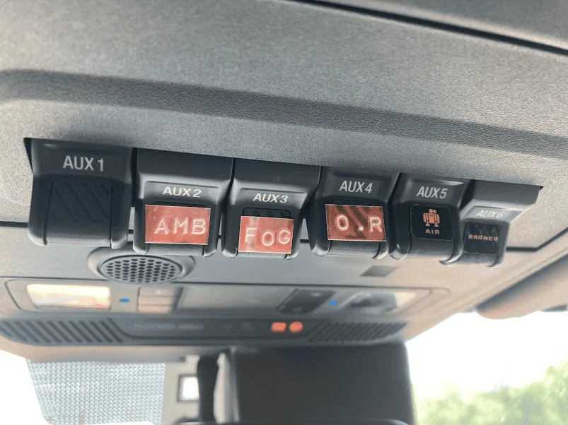

Which upfitter did you go with? I have 30, 15, and one 10 left.
Too lazy to go outside right now so luckily smart search is a thing ;)
Looks like I used Aux 5. I kept saving the heavier current ones as I went and (not shown in this image) is I used Aux 1 for our mirror ditch lights which are the only thing I'm using that don't have a built-in relay and are powered directly through the switch--they are very low draw.
