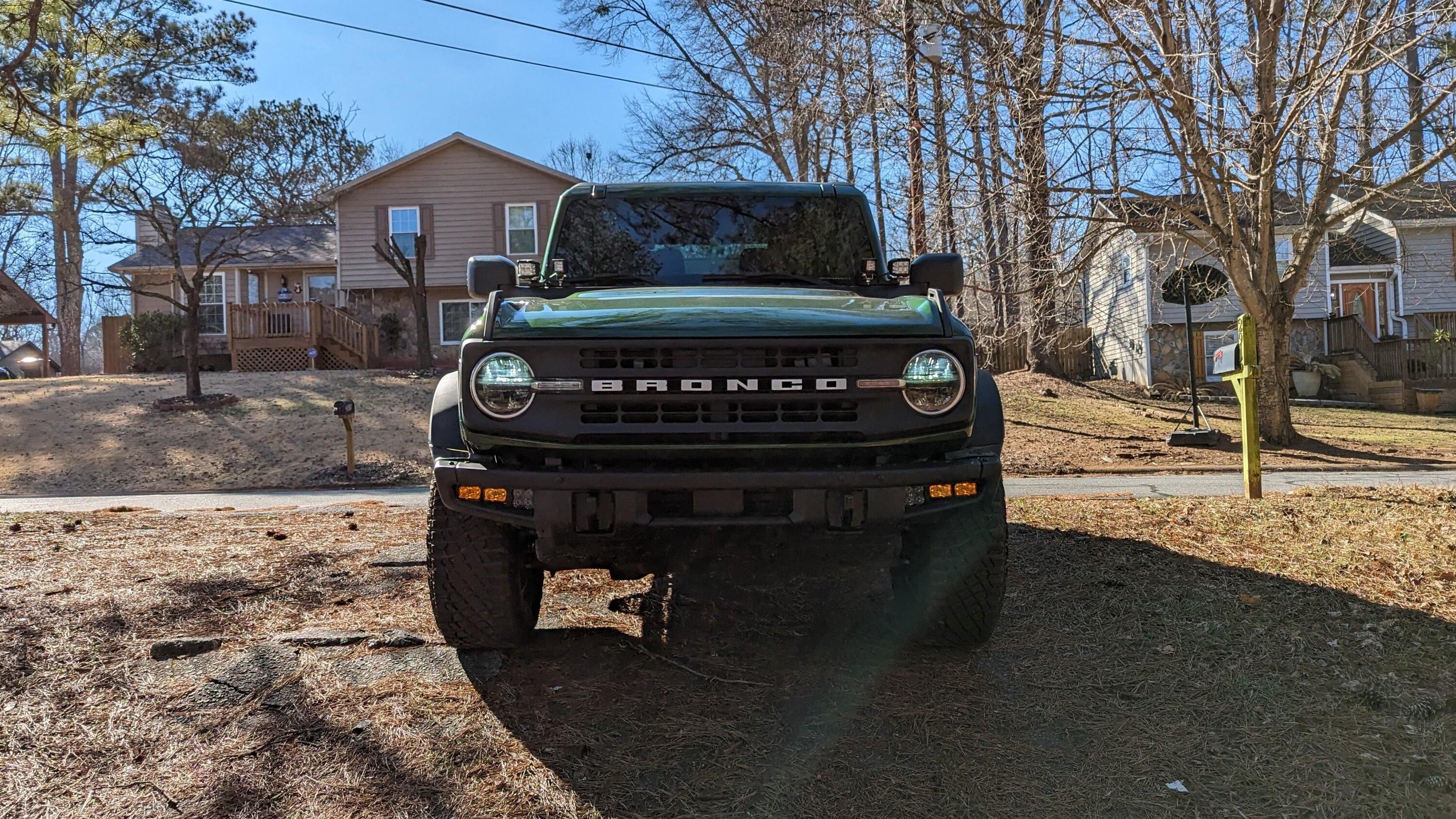

This would add $100 and require some work on your end but this is how I'd do it to avoid fuse taps and cutting factory harnesses:
this harness:
https://specialtyperformanceparts.c...kers-spv-harness-system-works-w-many-vehicles
provides the backlight power, find the diagram and figure out which wire is the turn signal and splice in a wire to that (snip between harnesses and solder or butt connect your additional wire). You'll have to do it on both sides (just for turn signal) to get left and right (hence the two harnesses).

You da man, this is what Im looking for. If I just go with the stationary one, do I need anything other than just the harness?
Billnchristy
William
Mar 13, 2021
34
589
1,303
Georgia
2022 Bmw m440i gc,2022 BD 2dr, 1966 mustang
No, that one taps into the parking lights so just one side needed and hook up the appropriate wire on the light.
Here's my fogs with the harness and wire tapped to parking lights, you can't see the stock ambers because the LEDs flash on the phone, but they're on
If doing driver side, pull the front half of the fasteners for the fender liner out and peel it back and you'll see the harness plugged into the headlight.
Passenger side can be done by lifting up intake air box but I'm assuming you've wired towards driver side like the instructions.
