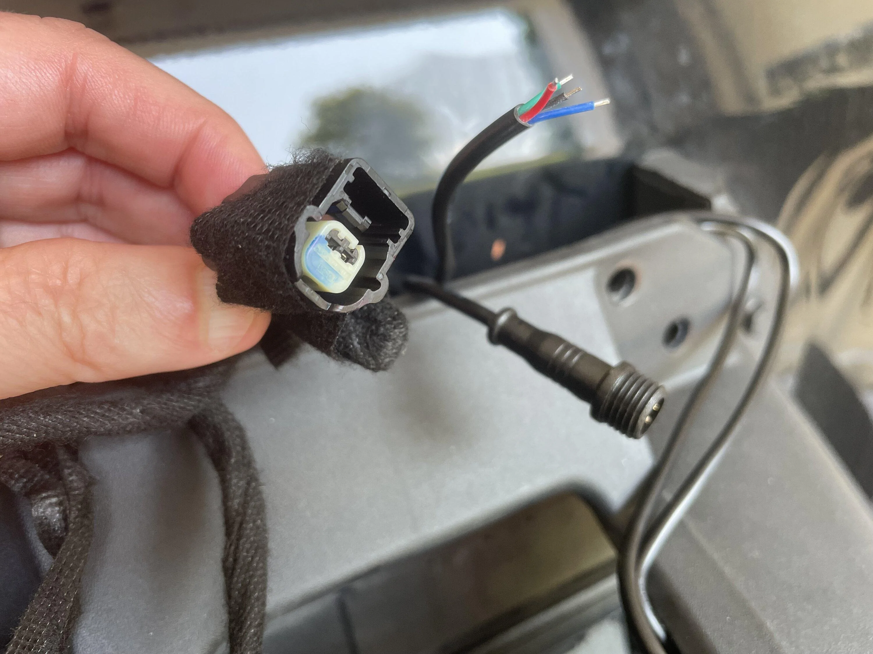

I've gotten the light installed, but in the Oracle video where he casually hooks up some wires using the red to yellow and black to black using some red connectors... I have no idea what to do. The box didn't come with those red connectors. I called yesterday (end of day but they were supposed to be open for support, and this morning, and no dice). I can't drive right now b/c the 3rd brake light is legally required but don't want to put the old one back on.
Pics of what came in the box. I"m not terribly handy, so the connectors were a good part of my interest. Hell, bought the remote thing too and thought someone said somewhere it could be hooked up to a hero switch, but I can't find a youtube video of that anywhere, so I thought I'd just get on the spare tire light first and then do the remote part later.

Afternoon,
It would help to link what part you are installing and what video you are referenceing to.
I belive you are refering to this video
If so, the connector you are holding in your hand is the one that's coming from the Bronco the person in the video cut that off and then use that wiring to splice into the wiring for the third brake light the red connectors you are referring to they're called butt connectors. You can get those at any automotive store in the electrical department all it does is crimp two wires together with a plastic sheeting
Hope this helps

At 2:13 of this video is the connector...
Thanks for the raptor vid... I have a regular 4 door 22 Bronco. Does that change anything?

Ok, so thoses connectors are T-tap connectors, video said it should have came with it. You can get thises at the auto store Basically it lets you splice into a line to 'tap' it for power or signal.
