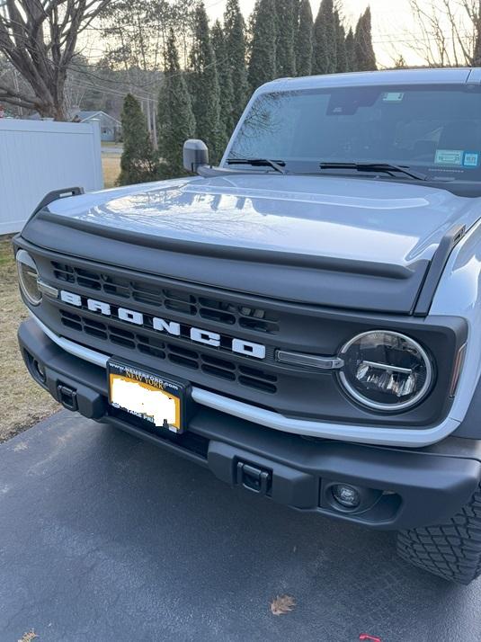

I can provide a photo of the hood protector. Unfortunately I didn't take a picture of the streaks. I'm not removing it now.
U P D A T E - I found another thread and clearly a lot of people have experienced the same problem. Fortunately, it appears that it is not paint damage but some kind of residue from the pad. It can be 95% corrected with rain-X detailer, goo gone or something similar. That makes me feel a little better. Still pisses me off though.

It's probably just wax that the adhesion promoter has pulled off from the clear coat - which is what you wanted it to do for you. I use that stuff all the time and haven't had any issues with it damaging paint jobs or plastic. I won't say it couldn't do it, but I've not seen it happen yet.
