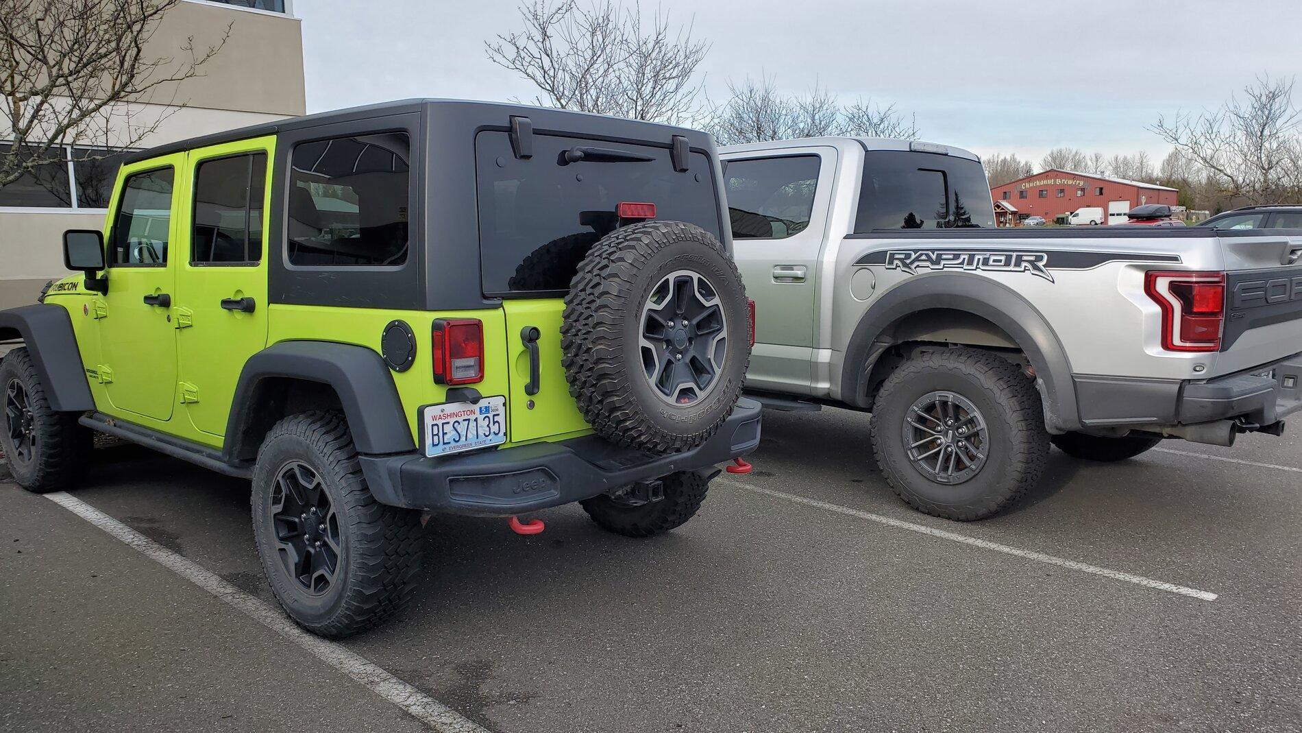

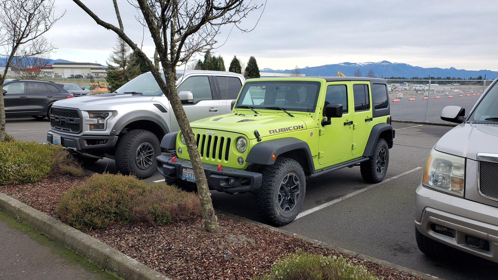

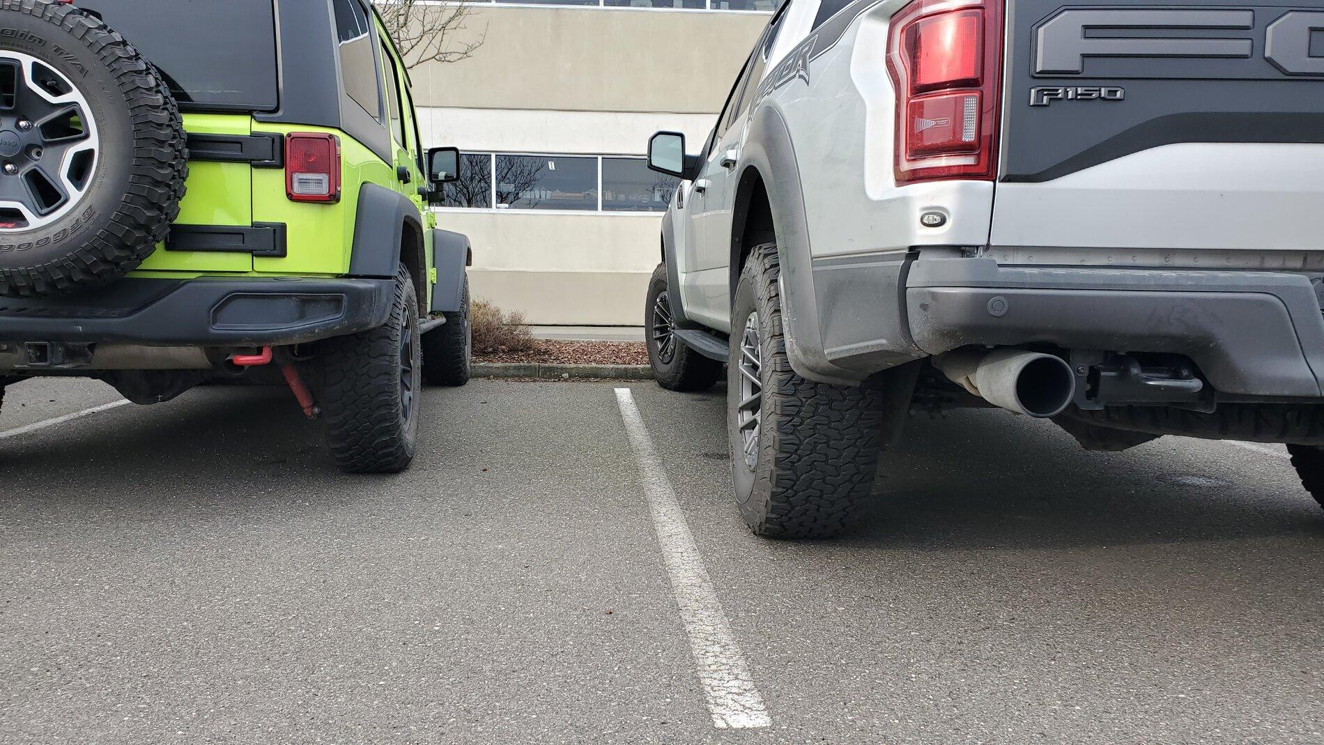

My constant qoute here is always( if you're new to offroading)....you'd be amazed how far 33's and open diffs can take you.
A Badlands on 33's would be probably the consumate "work and play" rig. The driveline is fantastic, but I have issues with the rest of the amenities vs price. My favorite rig right now ....FOR ME .... is the BaseSquatch. The value is awesome for what you're getting.
So I was out today and ran across a Jeep Rubicon (4 doors) and a Ford Raptor parked next to each other. Looking at the wheels, I thought that must 33s on the Rubicon and 35's on the Raptor. I borrowed a tape measure and went back to the parking lot. Nope. The Rubicon had 31s and the Raptor 33s!
Man, there is no way I need 35 inch tires. The 33's on the Raptor looked massive. The 31's on the Rubicon looked plenty big and I liked the thinner look of the tire. And I can't imagine there is anything I want to do that that Jeep couldn't handle. I still may order a Badlands with 33's, but I'll be overdoing it for sure. Maybe I should downgrade...
This is all weird because I have 30" tires on my Xterra and they hardly stand out at all. Nobby tires and one more inch seem to make all the difference.
(Notice how in the third picture the Raptor tires actually look shorter than the Rubicon's. All in the perspective I guess.)
"NO SQUATCH FOR ME! " : )
Ford Bronco Advice for would-be Bronco off-roaders 20210107_134321
Ford Bronco Advice for would-be Bronco off-roaders 20210107_134405
Ford Bronco Advice for would-be Bronco off-roaders 20210107_134018

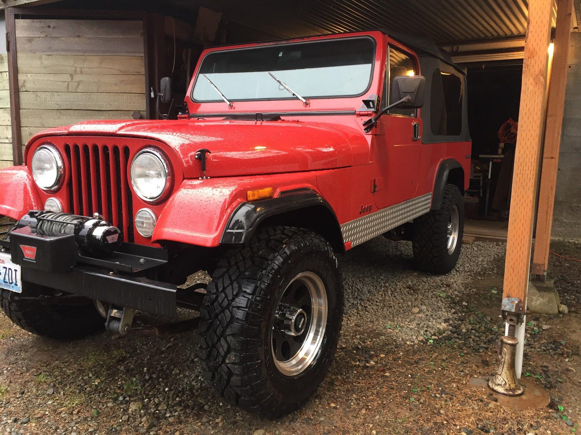

p.s. My friend has 32s on his Scrambler and they look plenty big.
STOP RIGHT THERE MISTER!
Not even sure where to begin.
1. Mearsuring tires while on the vehicle and saying they are "XX" inches is going to be wildly inaccurate when compared to the given specs of any tire.
2. When you hear 35" or 33" tires, it is USUALLY a generalization. Many tires do NOT measure out to those numbers....they are USUALLY smaller.
The "35's" on the Bronco Samsquantch are actually roughly 34.4" inches, as measured mounted and aired up, but not on a vehicle. They are a metric size....315/70-17. Look up the conversion or specs at a site like tiresize.com .
SOME tire brands are true to size, Nitto 33x12.5 as an example, will be exactly 33" ....according to their specs, on the stated rim size etc etc.
3. learn the common tire sizes in the range we are working in.
4. get a picture or memorize the tire size you are looking at and look it up.
5. The stock tire on Raptors is a 315/70-17 ..... also called a 35", but not quite.
It is the same size as the Sasquatch tire.
6. The stock tire size on the Rubicon , lately , is 285/70-17 .... also called a 33" ...but again, not quite ....and is the same size as the Badlands standard tire.
So , unless both of those vehicles have moved to SMALLER than stock tires , which NOBODY does....
those were 33"s and 35"s you were looking at.

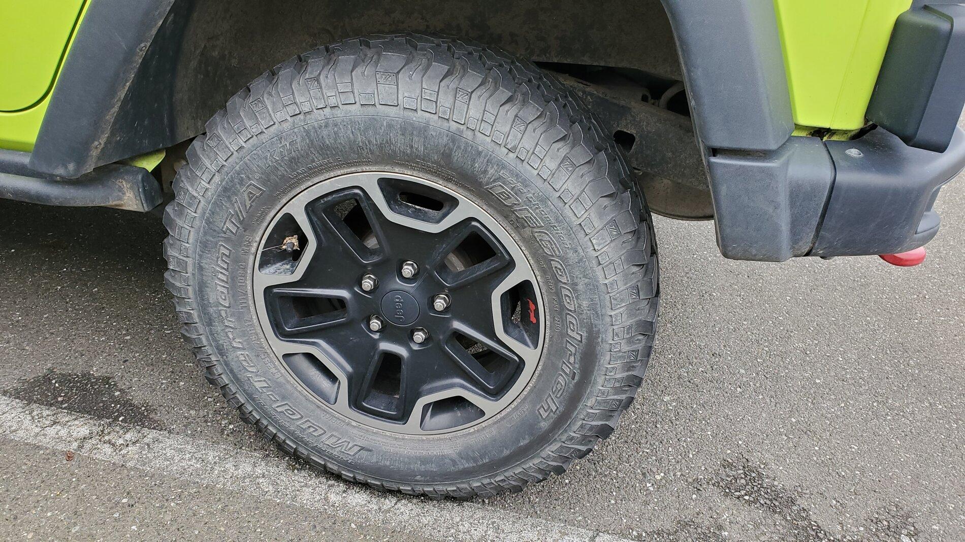

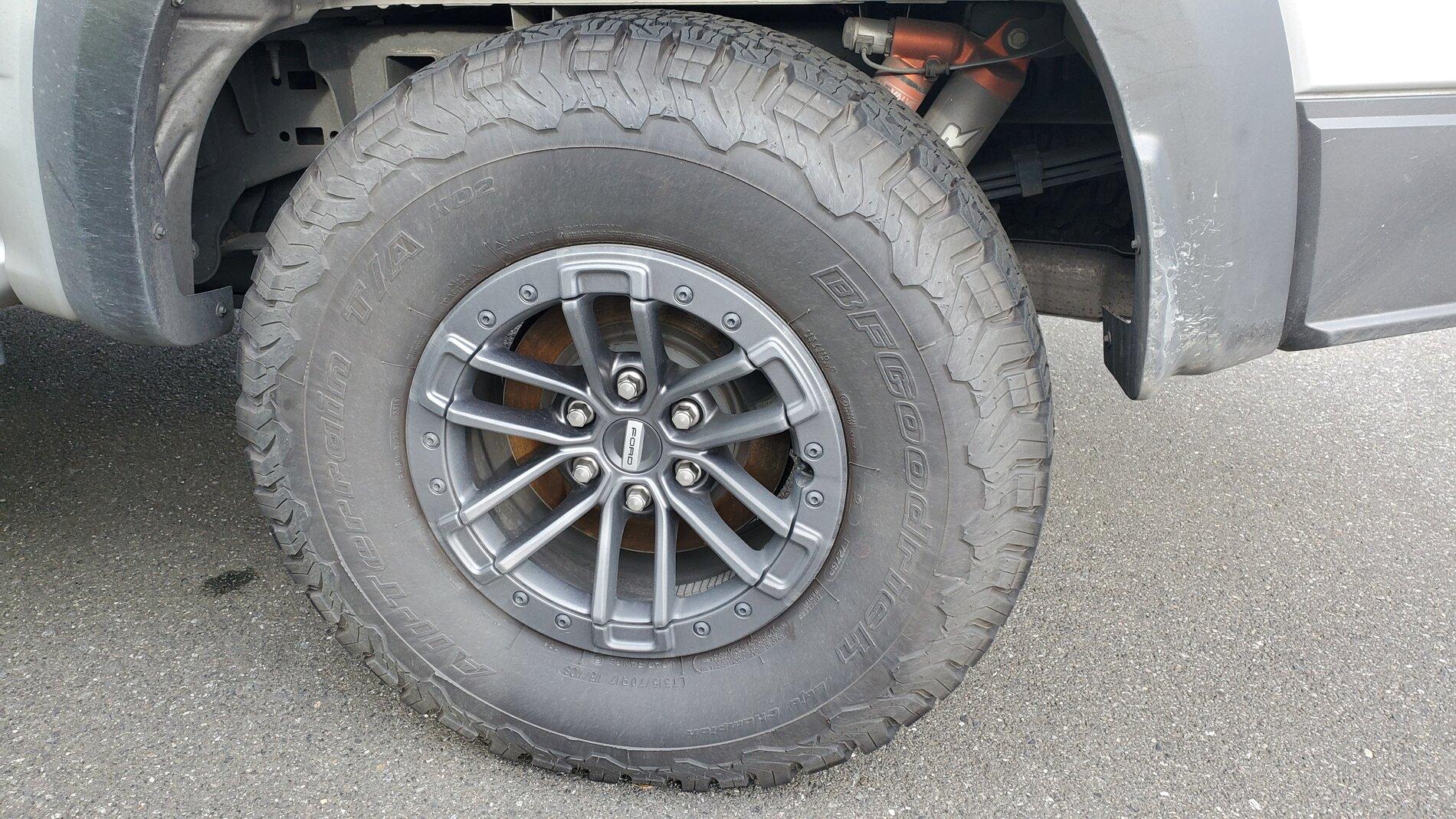

Okay, I admit it. I don't know what the heck I am doing. I plead total ignorance, and I offer up my most humblest of apologies to the Bronco6g community.
But I will try to redeem myself! With HoosierDaddy's help, I can right this wrong!
Here are the tires. Help me dig my way out of this terrible mess I've created. Let me and everyone know, HOW TALL ARE THE TIRES?! HELP ME, BRONCO NERDS!
Ford Bronco Advice for would-be Bronco off-roaders 20210107_134442
Ford Bronco Advice for would-be Bronco off-roaders 20210107_134434

Why not just look at the tires and do the math? Hopefully I'll do this right...
I think I see 255/75-17s on the Jeep. That's 17+255x0.75x2/25.4 or 32.1 inches.
Looks like 315/70-17s on the Raptor. So 17+315x0.70x2/25.4 or 35.0 inches.
Cool. Thanks! (y)
Where does the 25.4 divisor come from?
P. S. Anybody who's gonna roll on “32“ inch tires shouldn't worry that they look too small.
