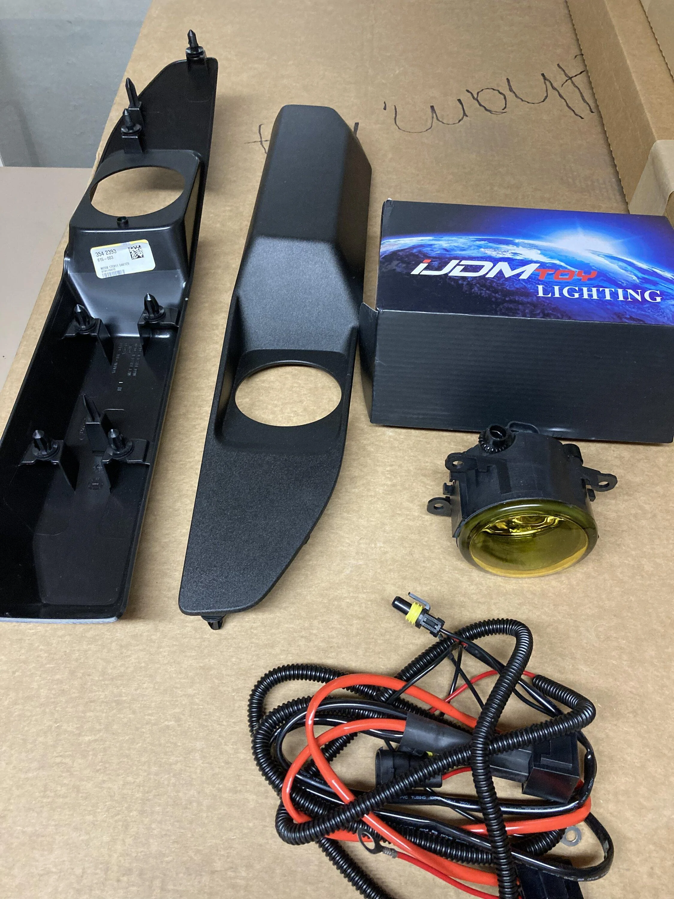

Looks great. Can you share the link to the lights?
I’ve got the entire setup.
Bumper trims with fog light holes, fog light knockoffs, and wiring harness. Complete write up on here if you do a search.

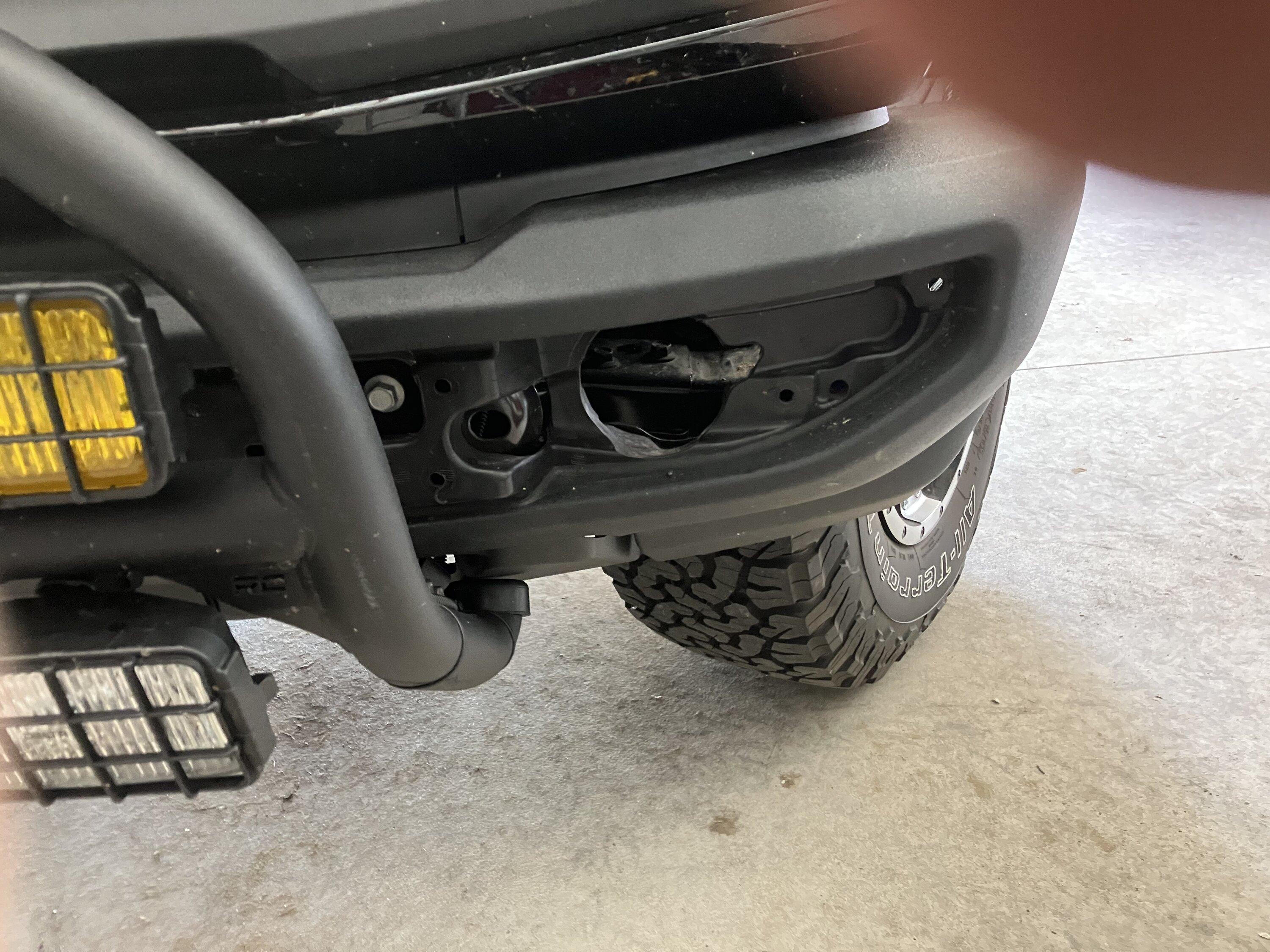

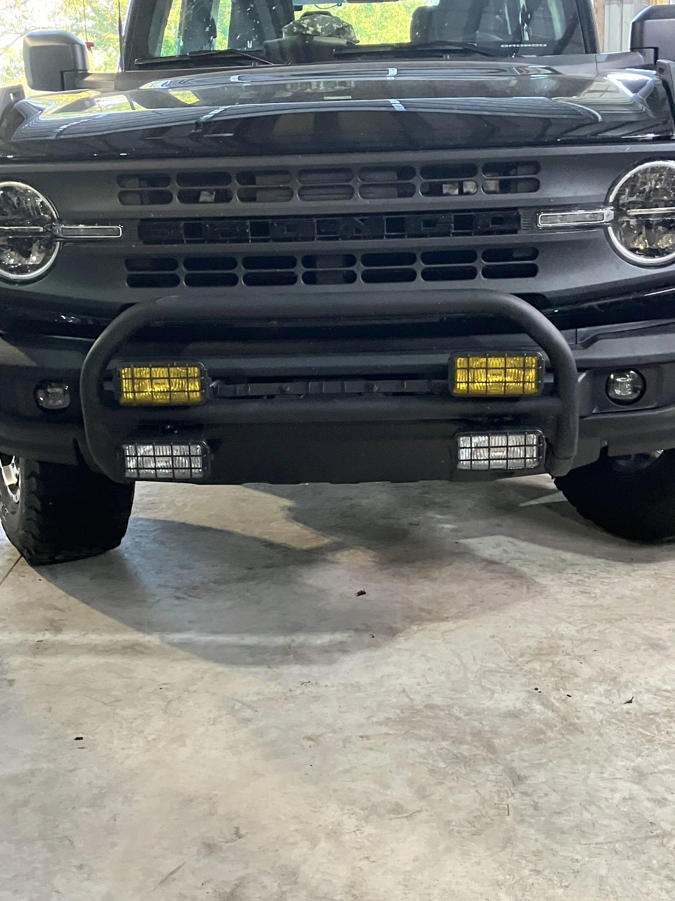

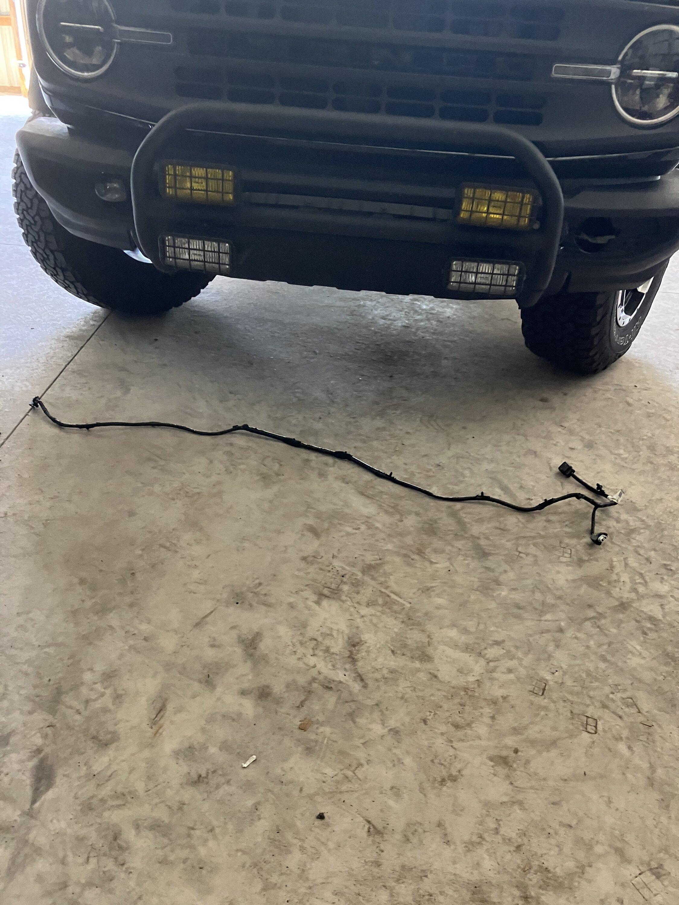

Can you take a pic and show me?
Ford Bronco Adding Fog Lights? IMG_0210

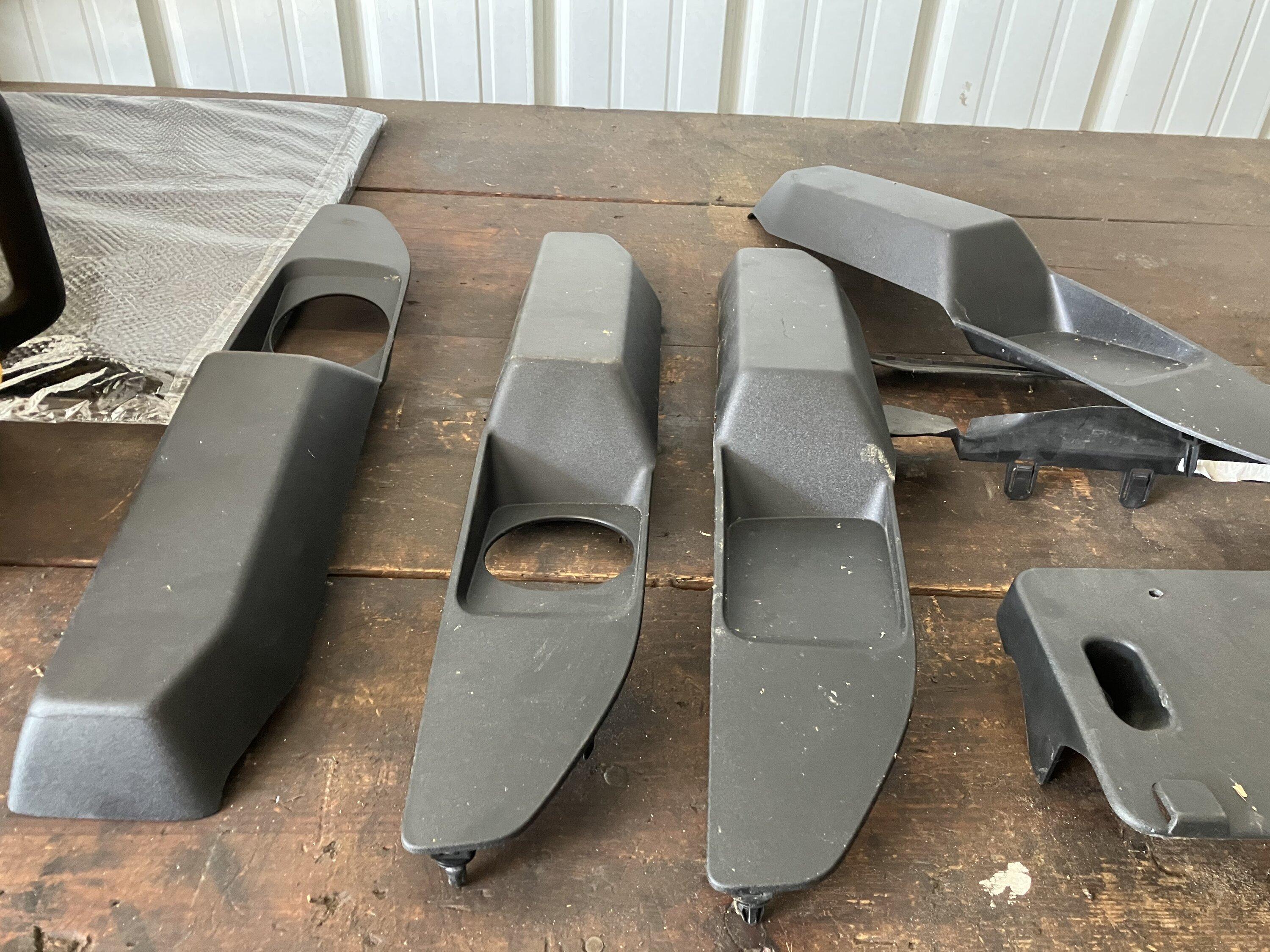

I just took the Harness, covers and lights off of the BB bumper and installed them on my Base Bumper. Hooked them into my aux switch. About a 2 hour job.

This in incorrect, also. No need to cut holes or buy a new bumper. While his tone may have been incorrect, his information was spot on.
