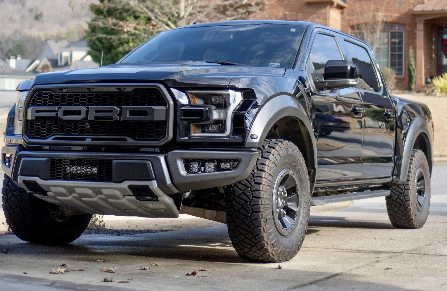

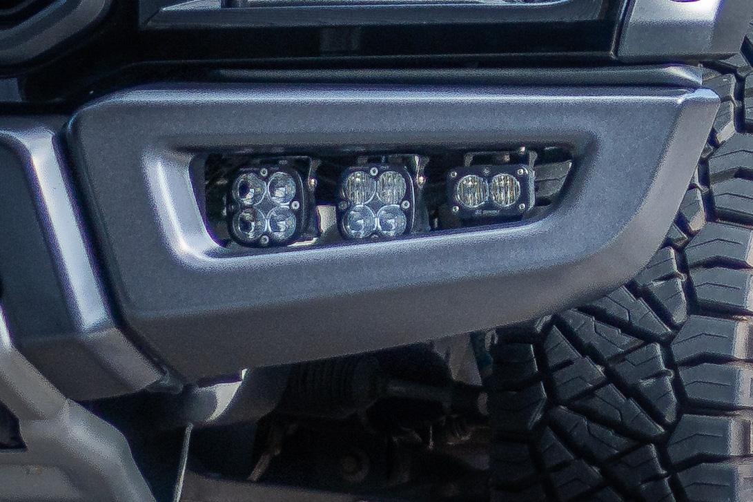

From the looks and shape of the modular bumper the BD kit should work much like the Raptor kit, only a little smaller overall. And the aux switches are very likely to be the same. Learned a lot doing this project. This is my setup with an additional 10in BD ON MY 2018 and excited to reuse with new brackets on my new Bronco. I am thinking, only one of the Squadron Pro cubes and the smaller one will fit Bronco. Use the other squadron Pro spot cube up by the mirrors since they so kindly provided a space just for that!
I‘d be interested in your review of the kit in terms of practical uses and scenarios where it can come in handy, light output, etc. It certainly looks cool.

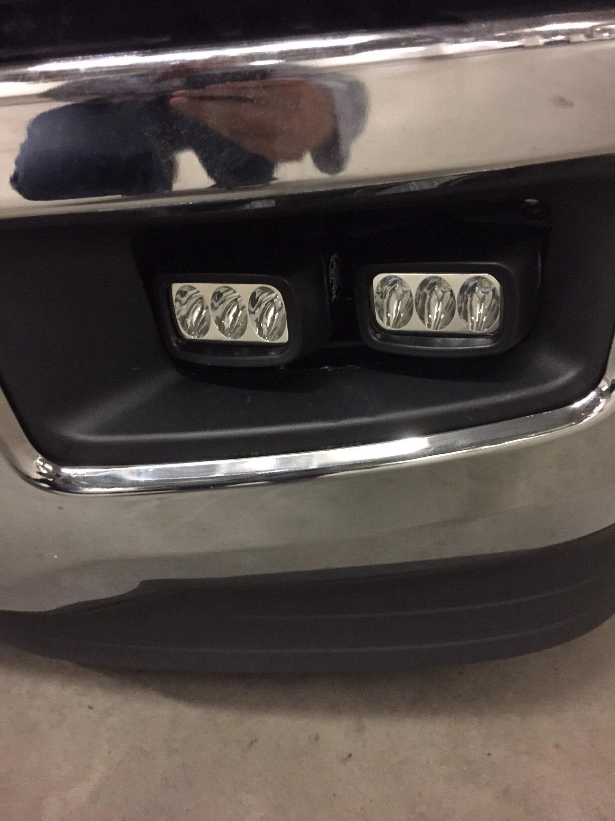

I put these Rigid Industries pods on my 2015 Silverado - The OEM fog lights were awful. These were 1000x better and well worth it. I'd love if I could do something similar with my modular bumper on the Bronco. I like the pictures above from the Raptor!

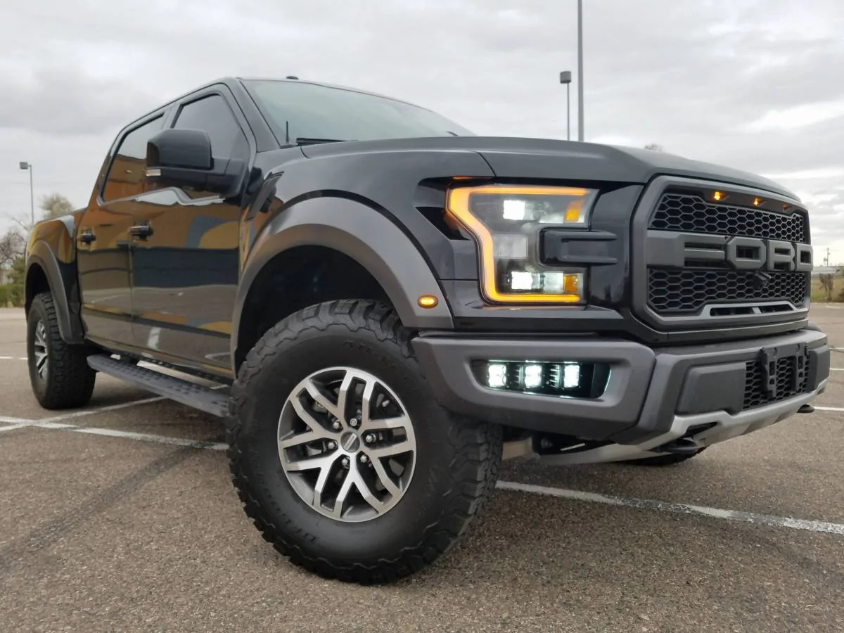

Rigid makes a nice setup for the Raptor. I emailed them and they will have a solution for the Bronco this summer. The Raptor setup has 3 lights per side
Link to those, so I can get an idea?

The problem with the pod lights mounted like the Raptor is that you lose the ability to remove the bumper end caps for extra clearance. It will leave the lights severely exposed to damage off road.
If someone is okay with that, then its the best area for fogs.
One solution is to have a pocket cut in the bumper and flush mount the lights. Some manufacturers offer a kit for flush mounting.
I think im going to mount them on the top of the bumper where the bull bar would attach. Not the most ideal spot, it could be lower and further to the corners, but I think I'll like the look.

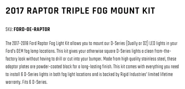

It's not clear by the description. Does the mount kit include the brackets for both sides?
I believe it does include both sides. The description states that is is fits 6 D-series lights....3 per side

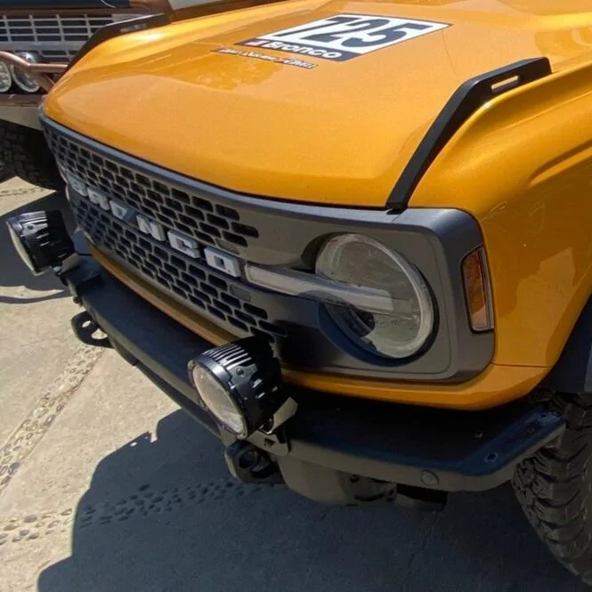

I know those integrated kits look really good, but I'm going to go old school with the round fog lights. Just saw the BL bronco racing in Mexico right now has lights right where i want to mount mine on the modular bumper. Looks like some brackets are attached to the stock bumper bolts and the lights are attached to that. Hopefully someone makes a bracket just like it for sale.
This times a million! ideally, I'd like to also see a super simple straight(ish) bumper, maybe a stubby!?
